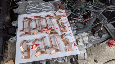

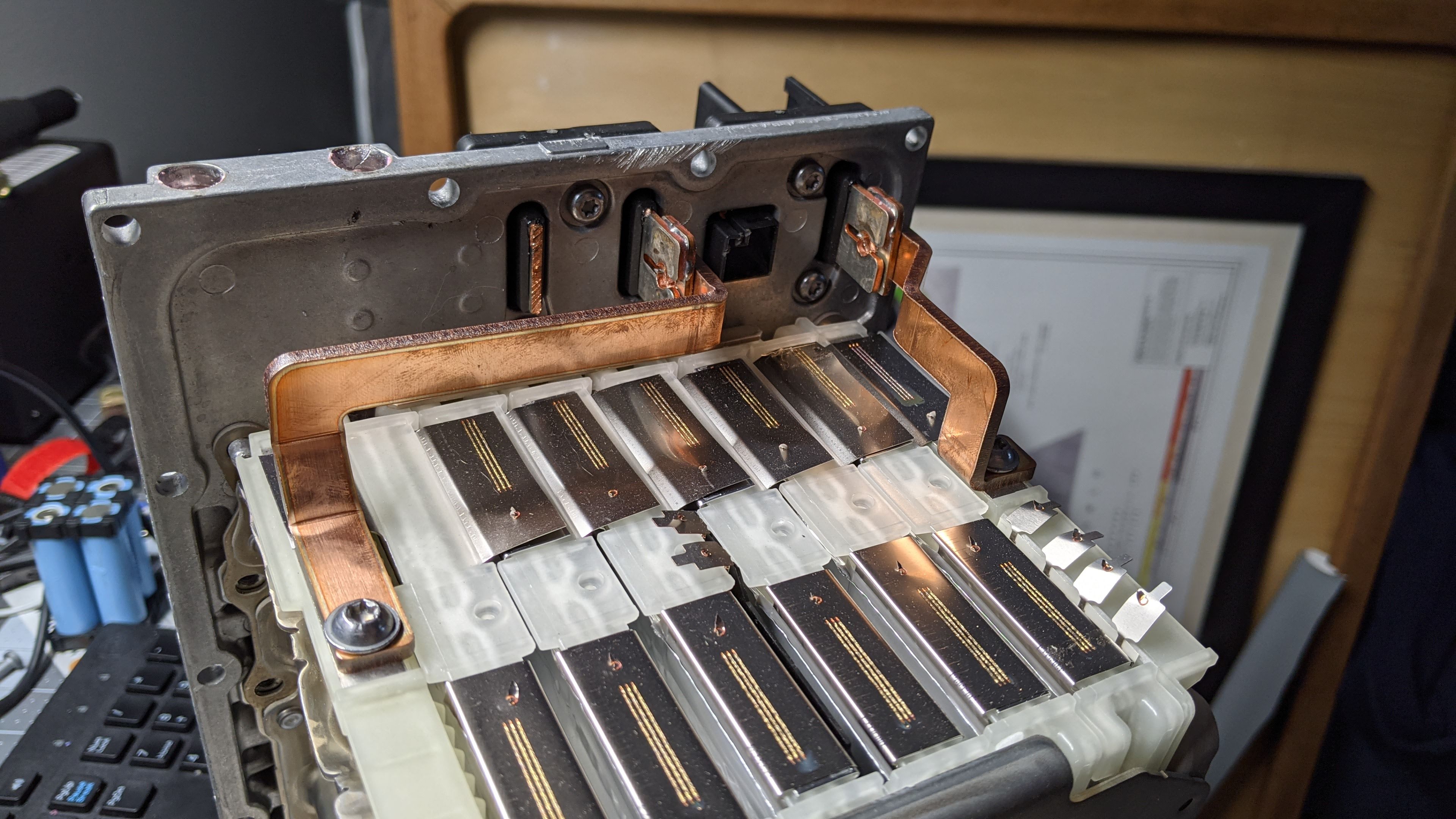

also, i decided to go with custom busbars for my batteries, instead of cable, since they will be VERY inaccessible when installed and it will make me worry a bit less about my crimps :)

Busbars!

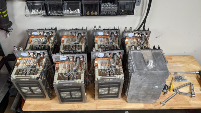

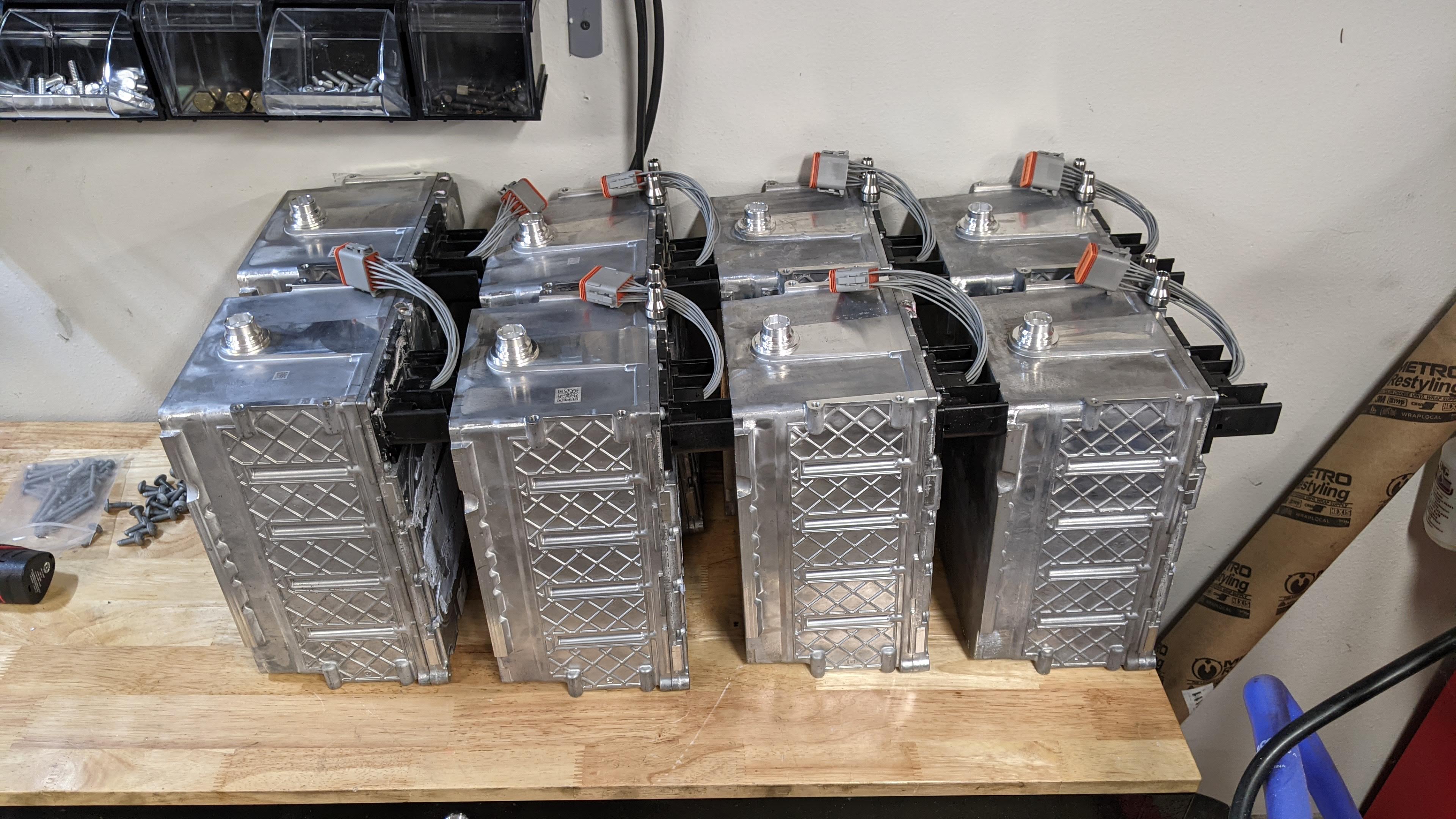

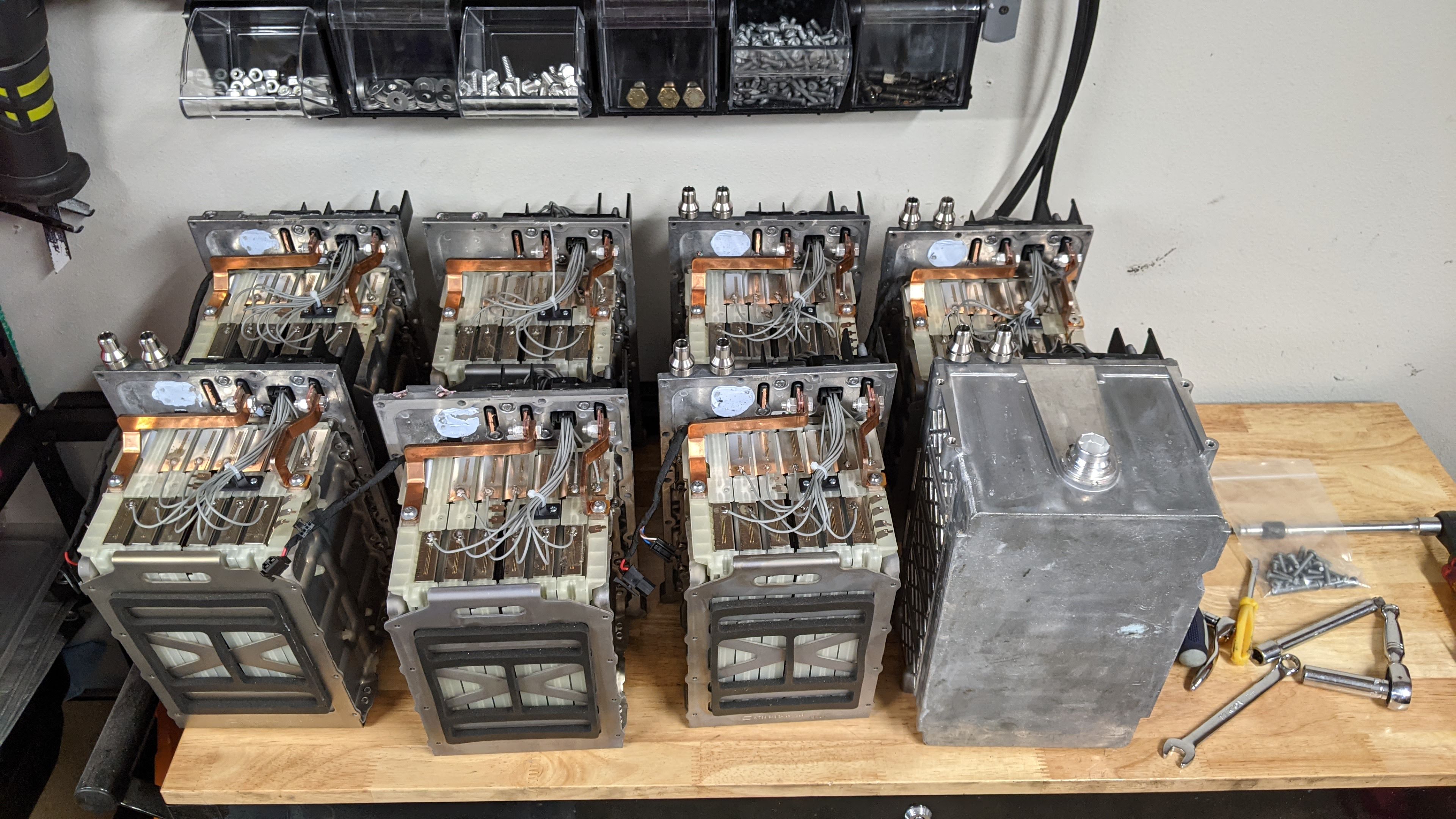

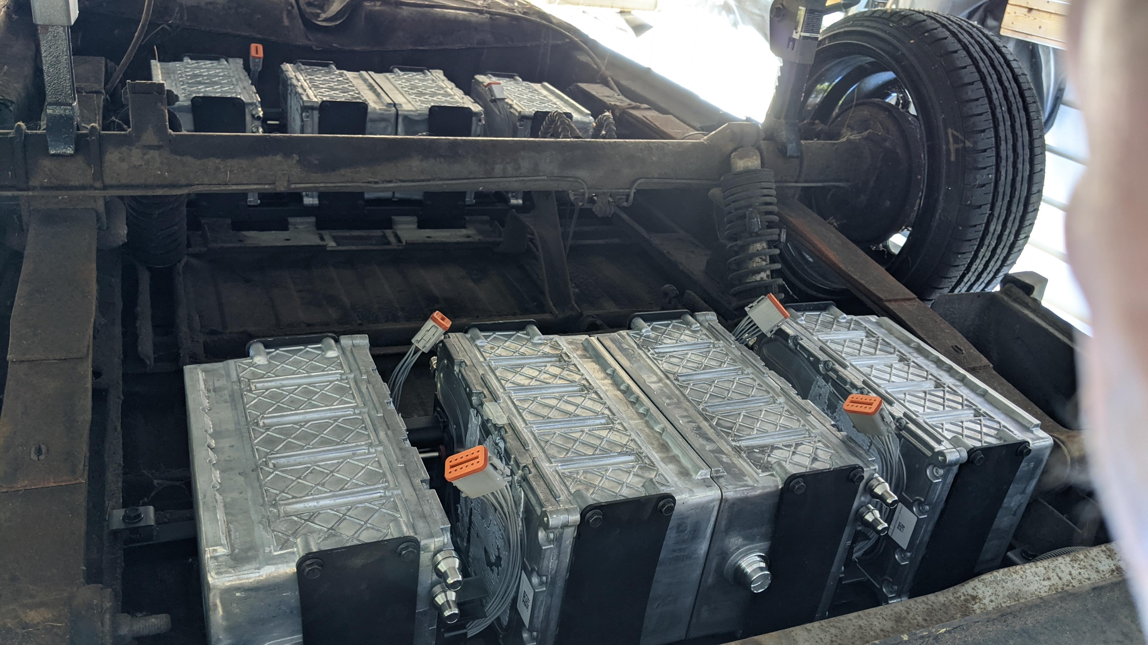

battery reconfiguration done, and installed under the truck. TDL is still very long.
Again, this is a very modest battery pack, @ ≈7kWh, that I chose for it's low cost and small packaging that gets me to a 96s pack.
Batteries with all BMS leads and busbars installed:
then back in their enclosures:
installed under the truck, not noticeable at all:

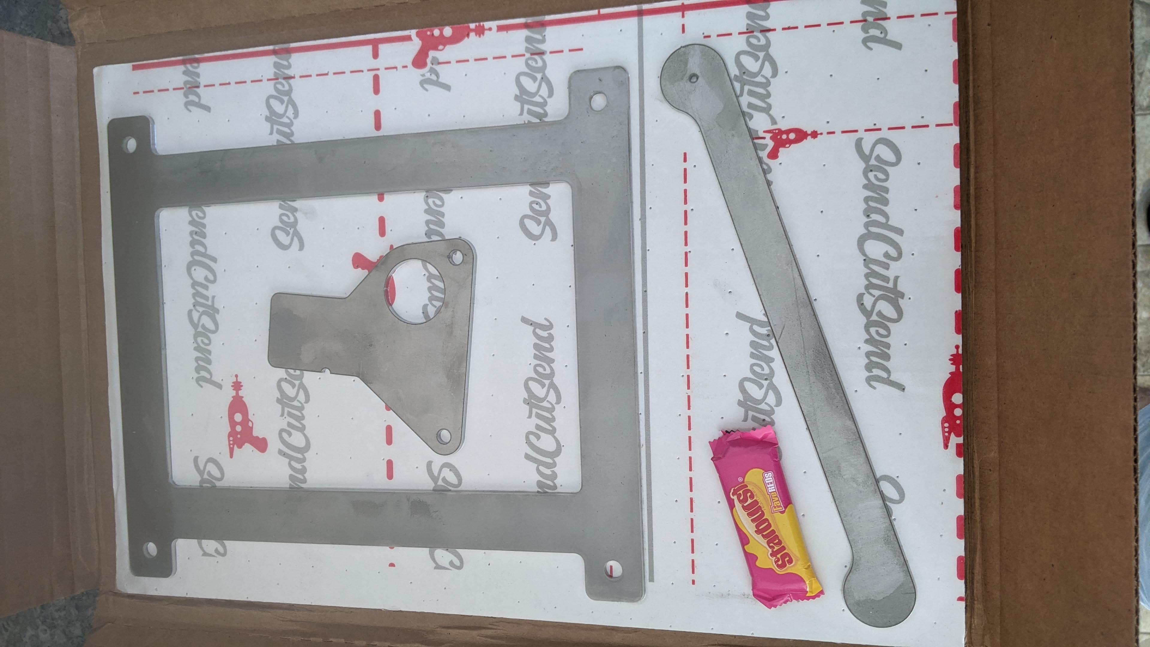

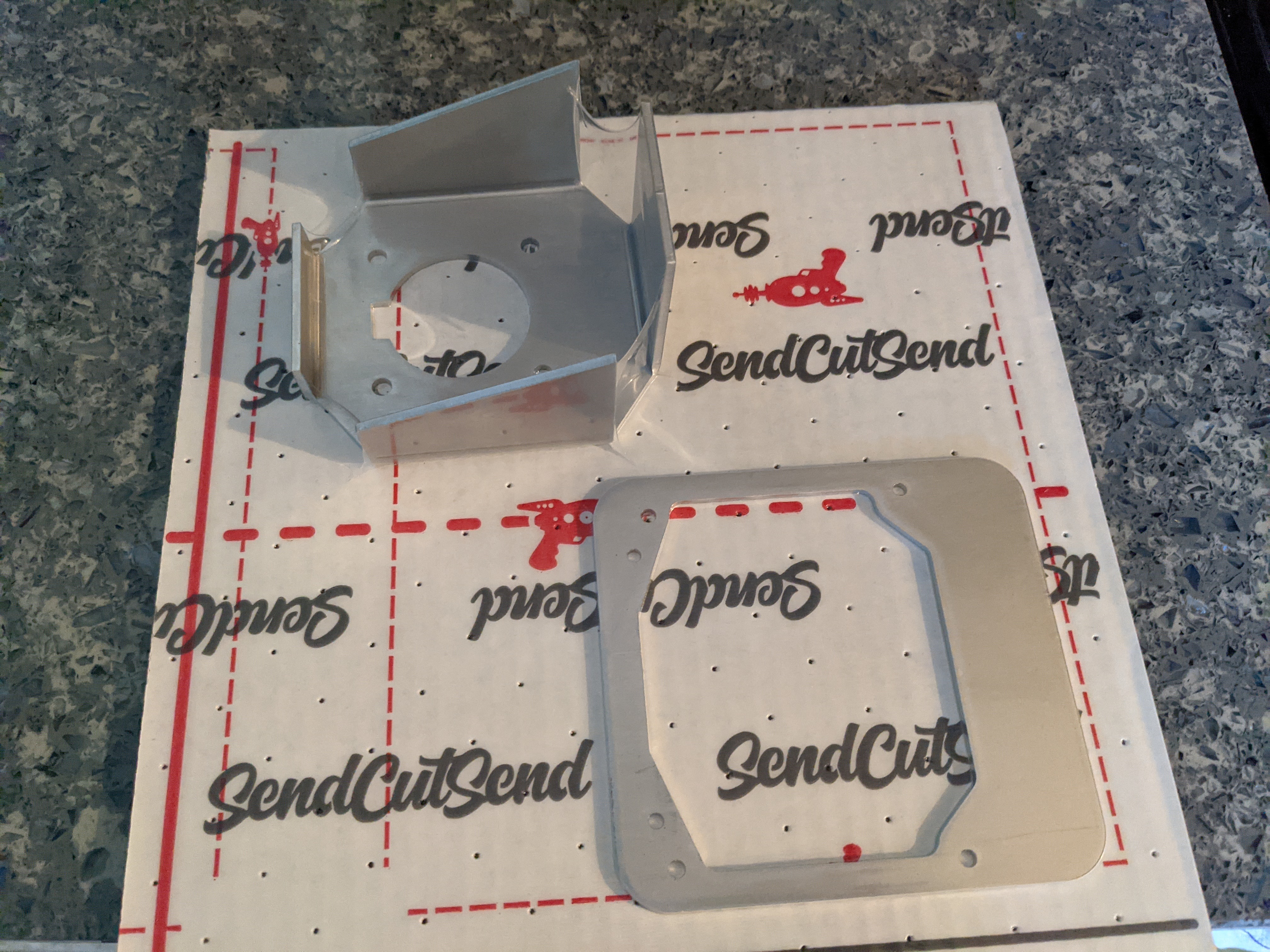

made a little more progress before paternity leave ended.

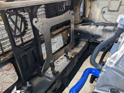

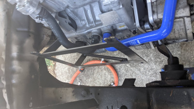

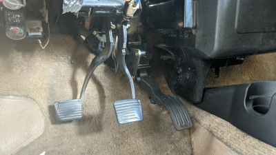

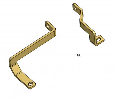

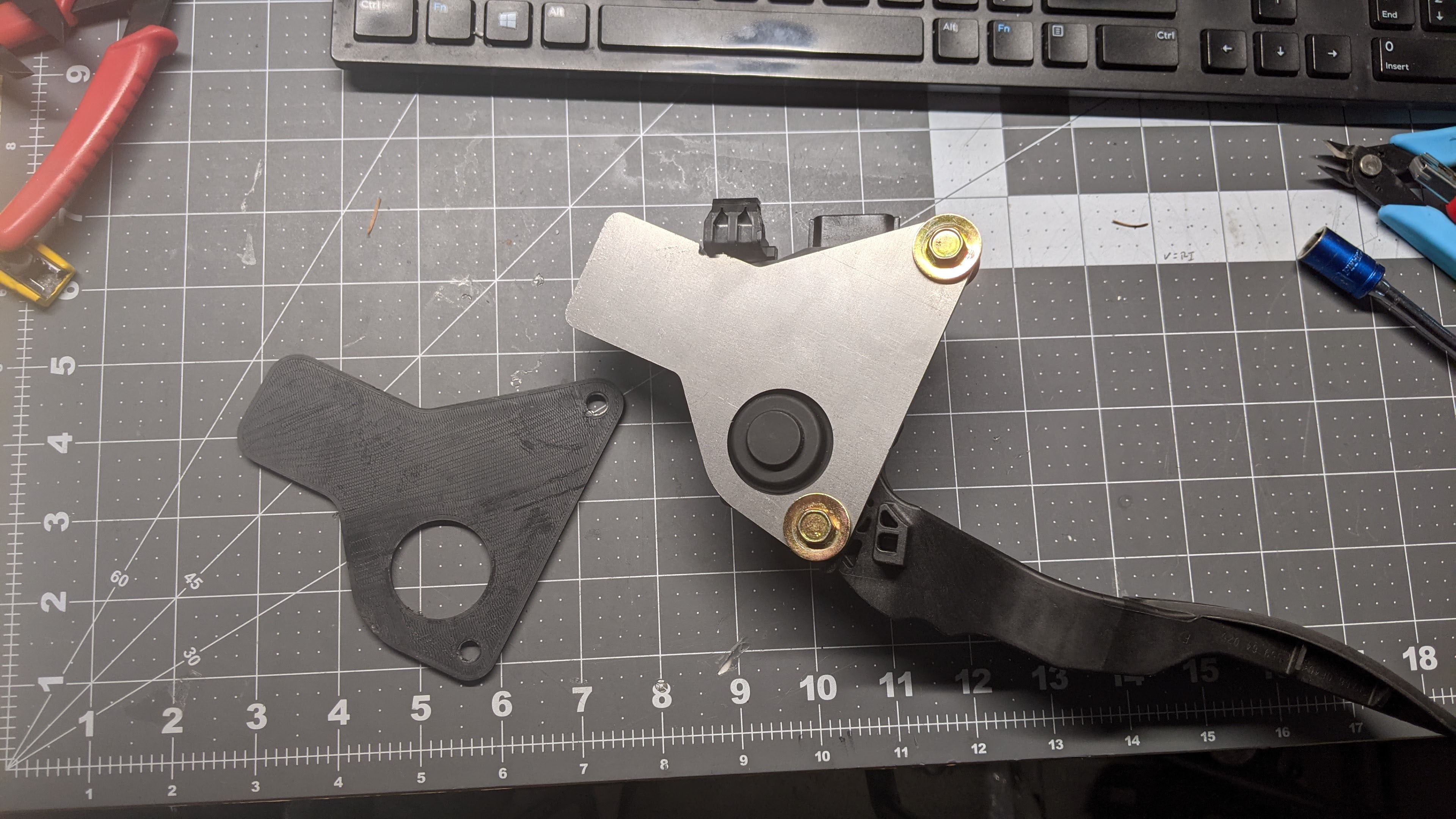

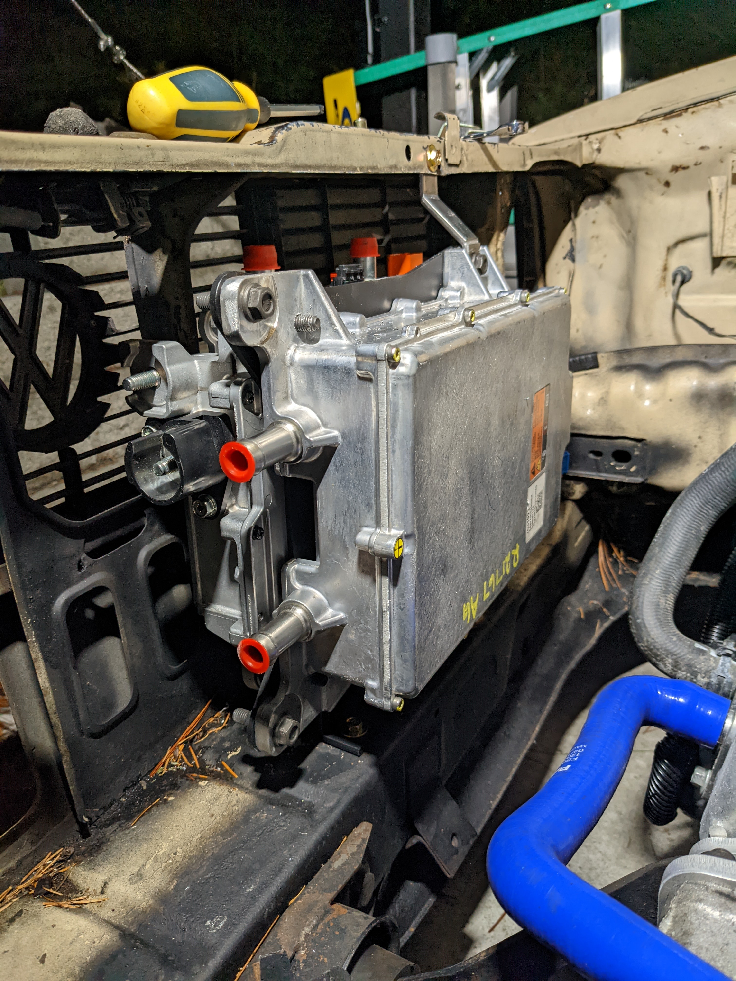

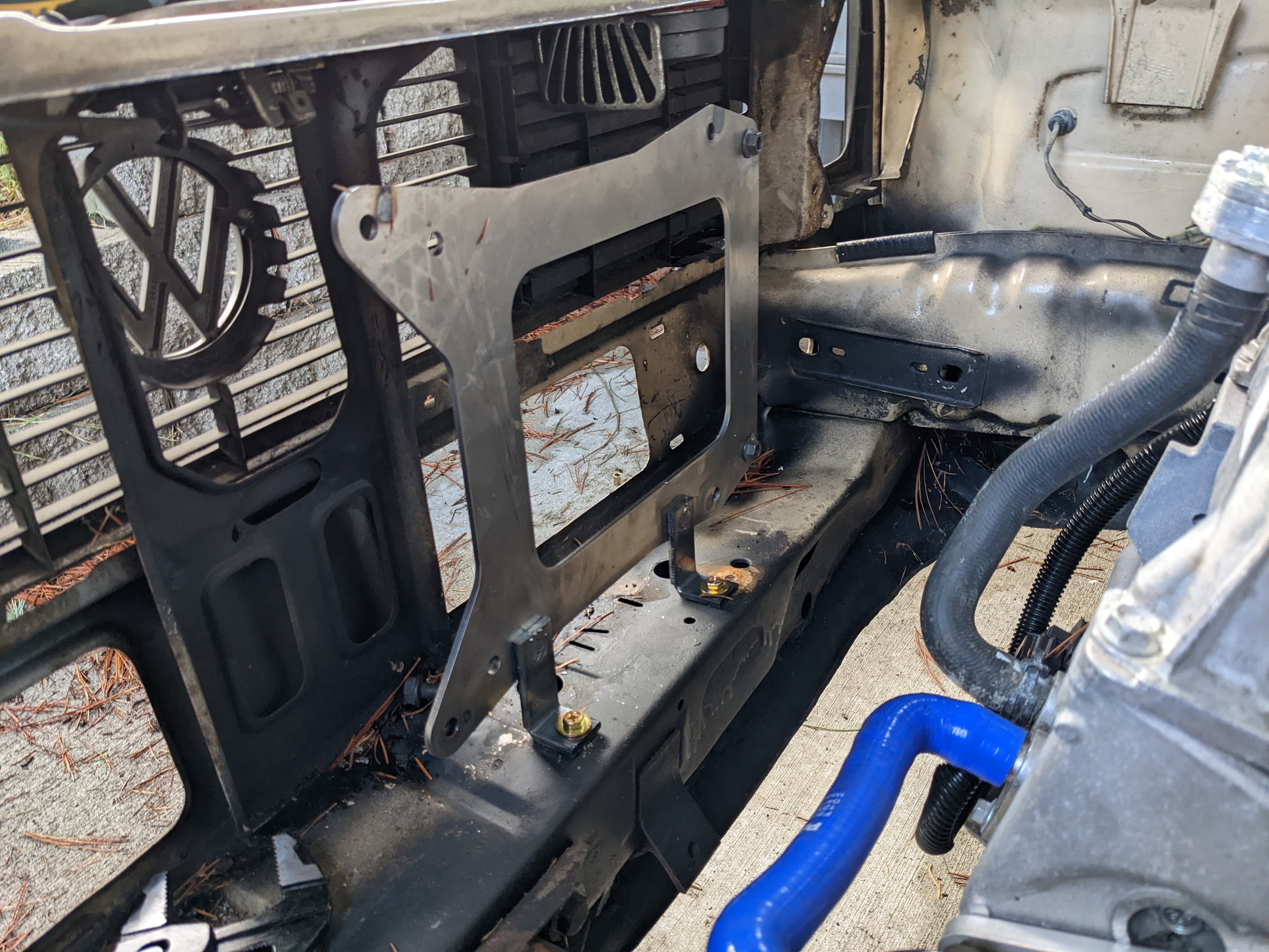

yet again, more laser cut parts from Send Cut Send. Chevy Volt Charger bracket and a bracket for the Leaf acc pedal

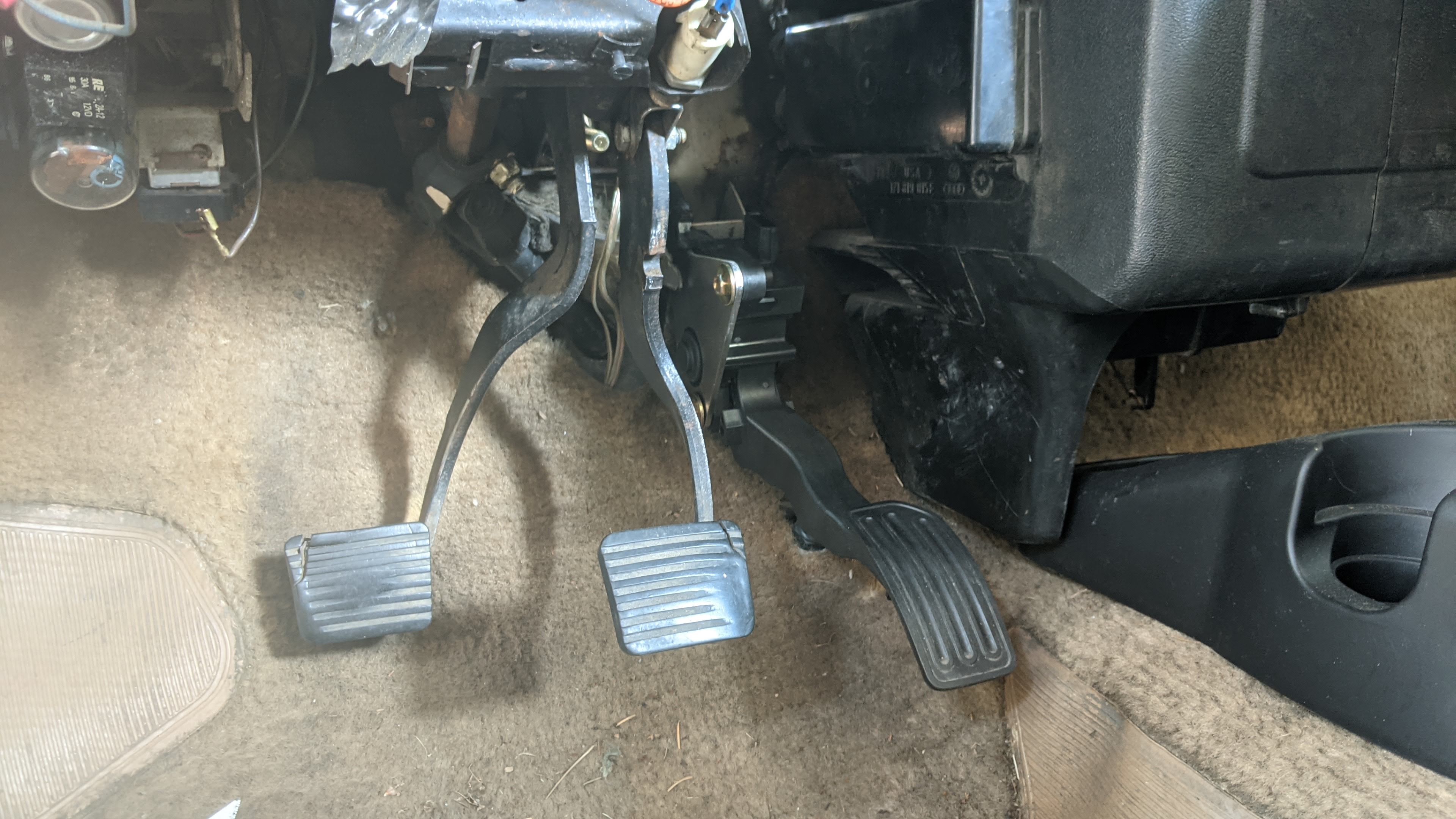

Leaf pedal proto and final bracket. GOT to design > proto > test > design > proto > make
installed in truck:

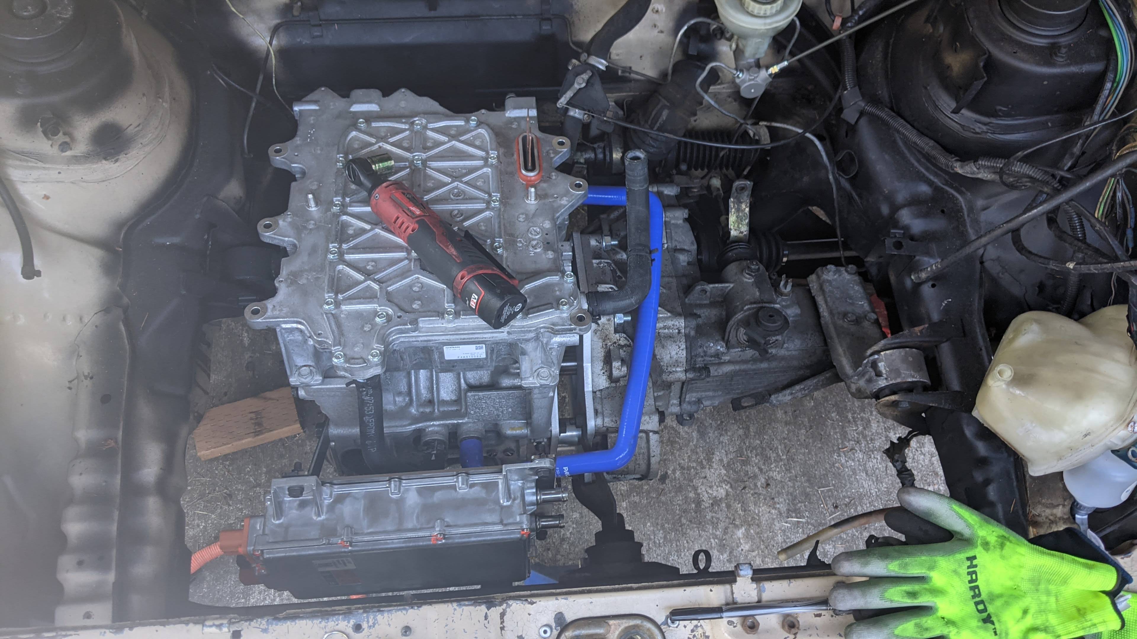

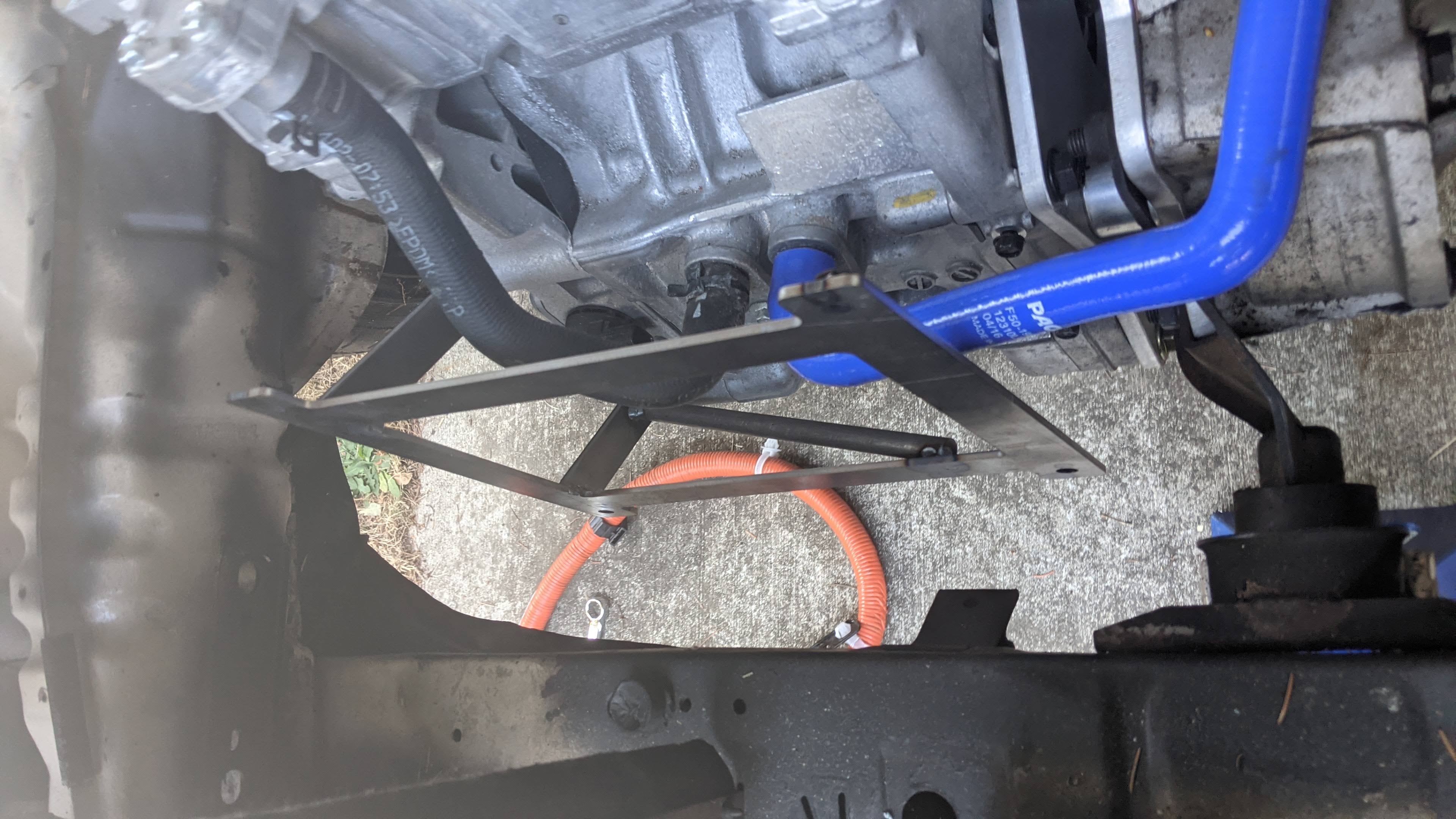

charge bracket mount to Leaf motor:
Installed:

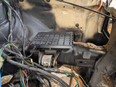

Now I need to get to my High Voltage Junction Box and control system wiring.

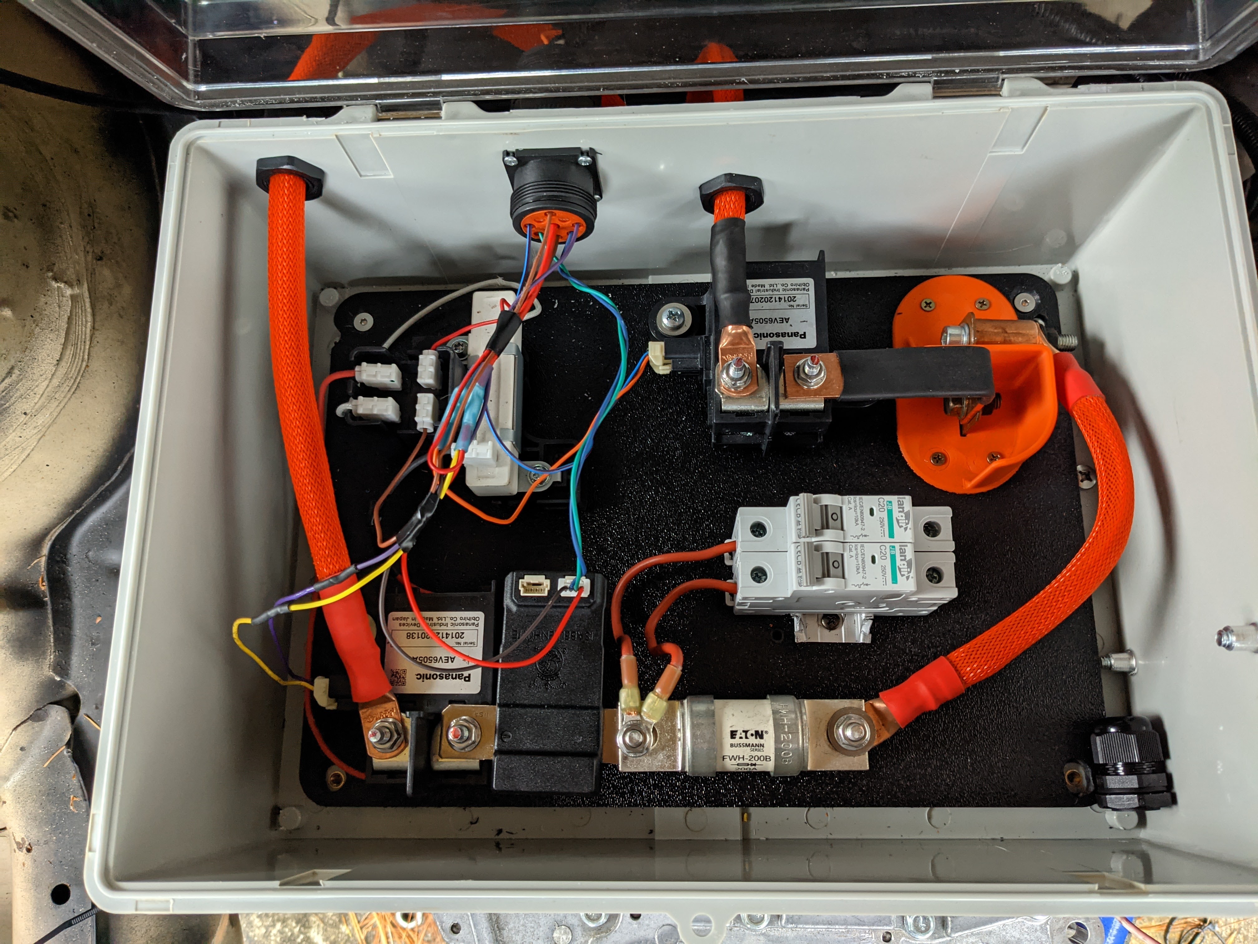

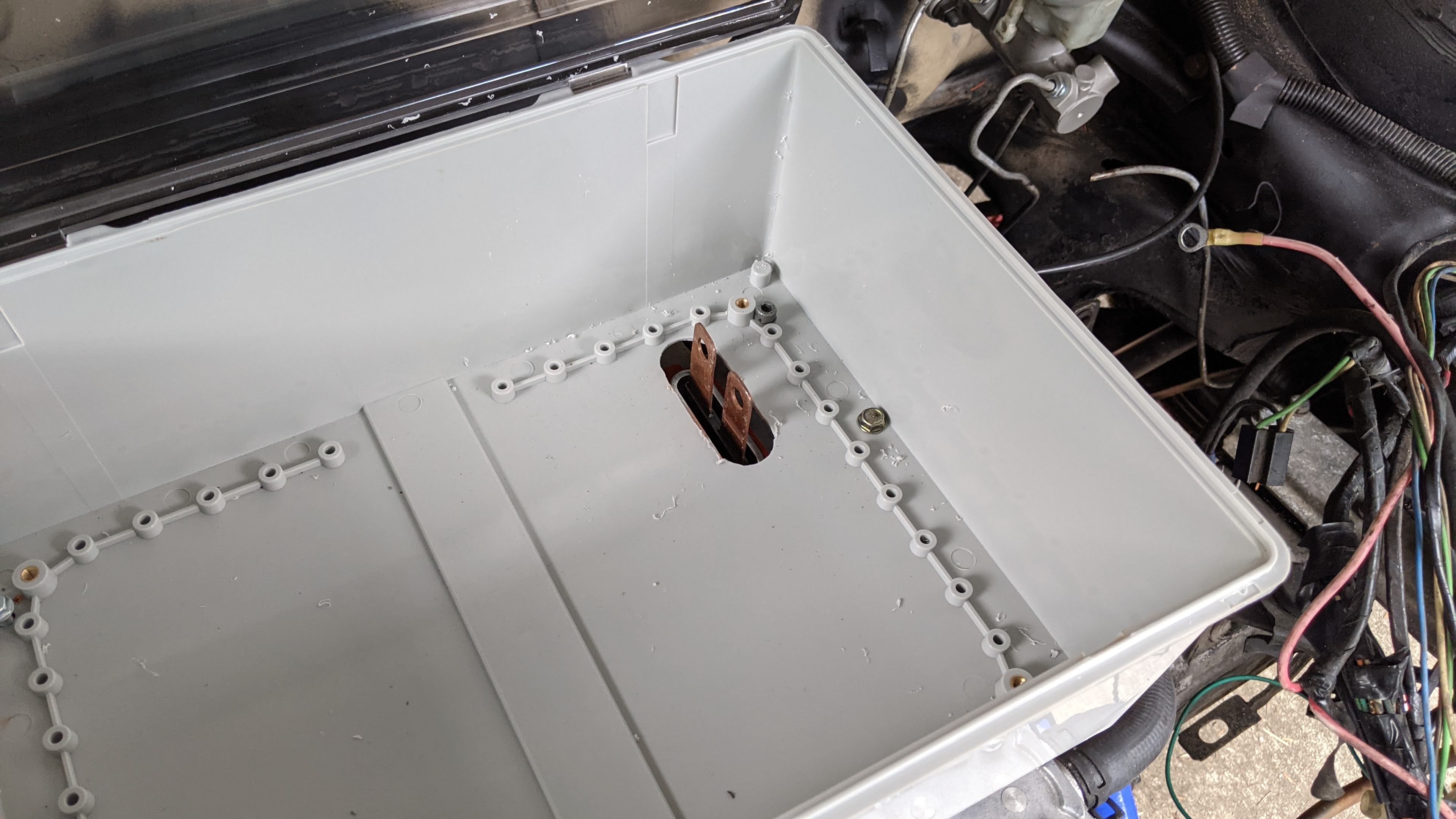

HVJB work has begun:
This is alittle large but i plan for it to contain:
1. HV fusing + distro (DCDC & Charger)
2. pos & neg contactors
3. Isa Shunt
4. precharge relay and resistor
I've 3-d printed mounts so it will fasten directly to the top of the EM57 inverter.
Then the DC input to the inverter will be sealed via this 3-d printed assembly

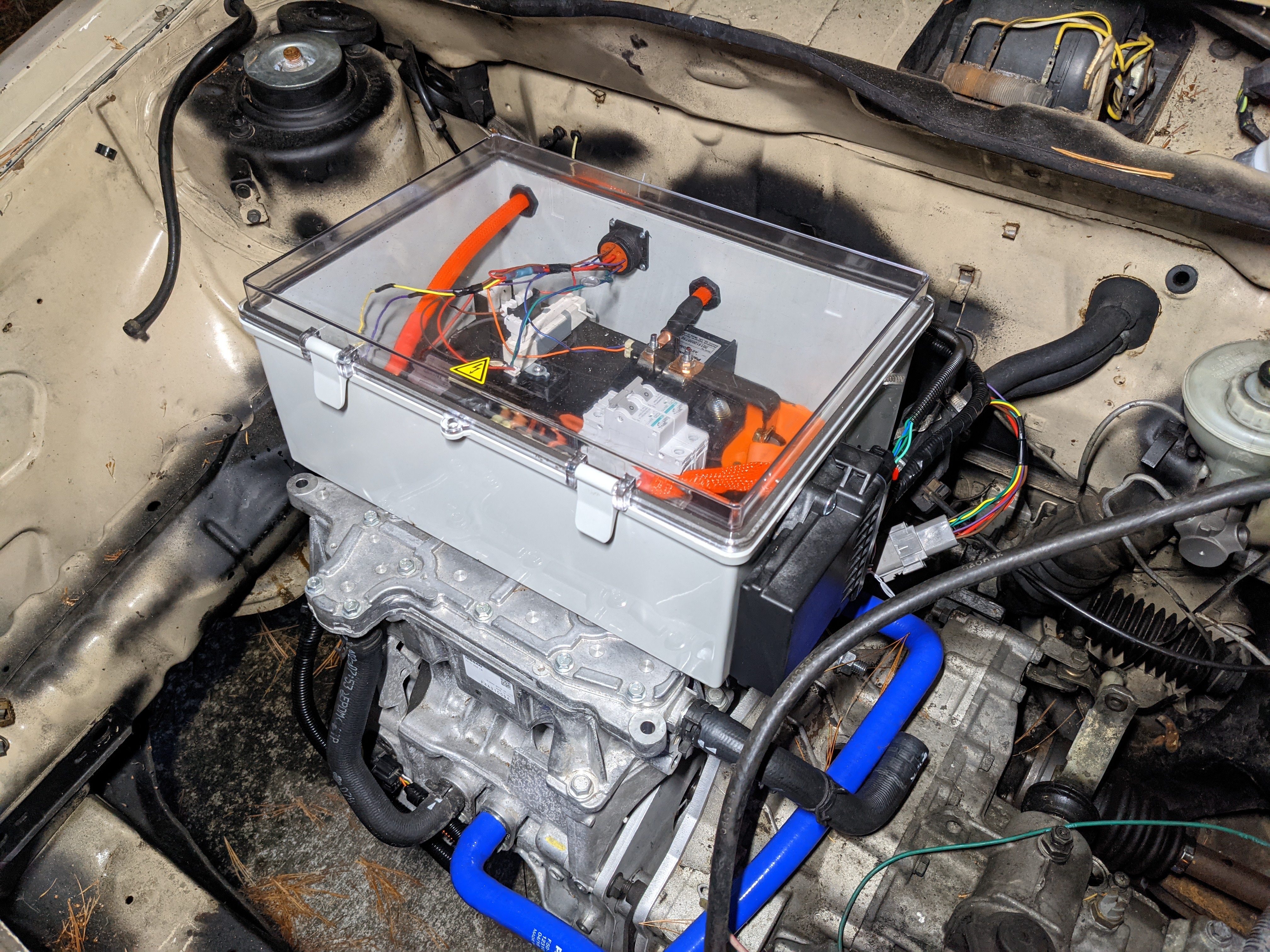

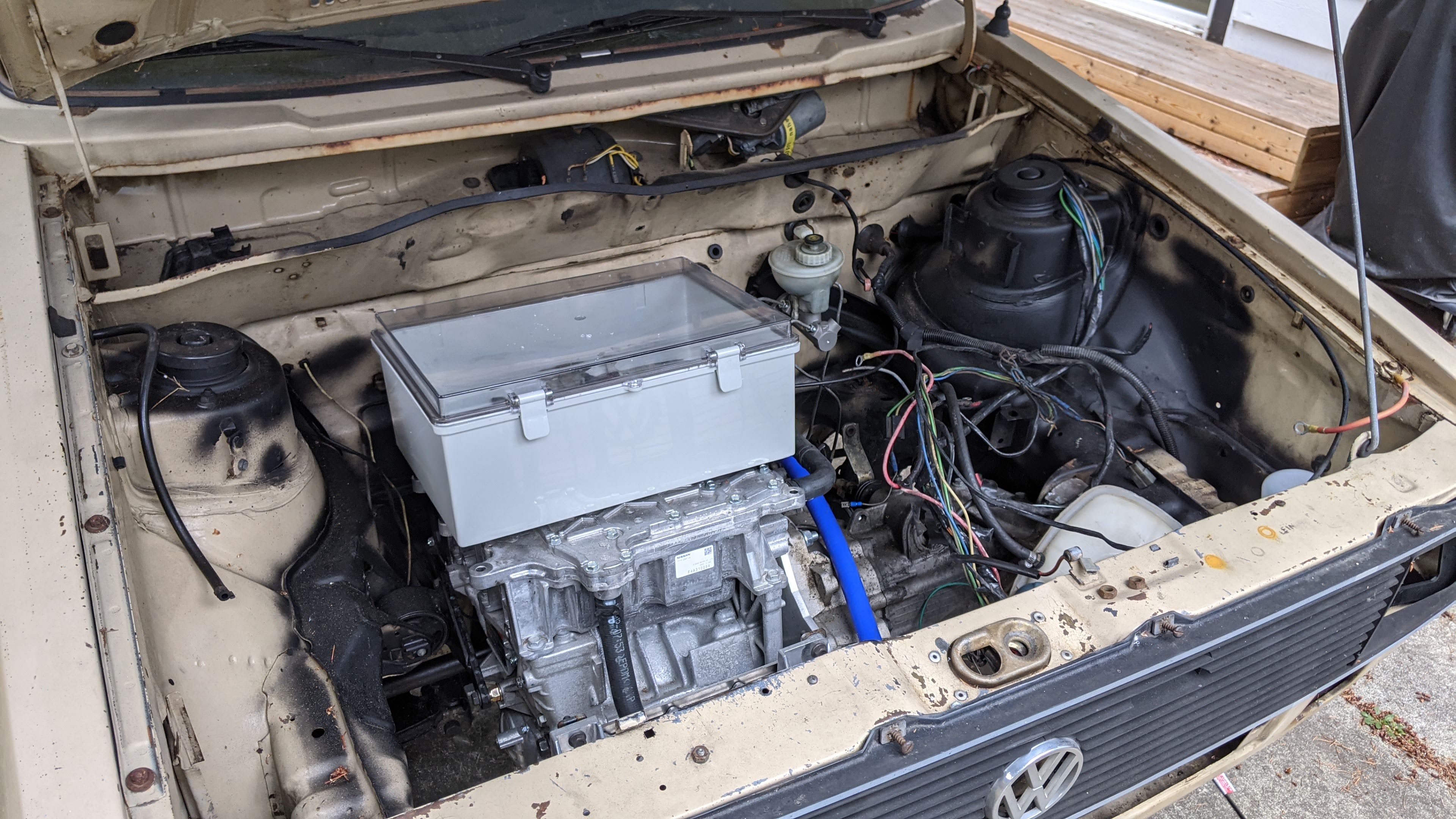

big update:
HV Junction Box is done, installed, and connected to batteries

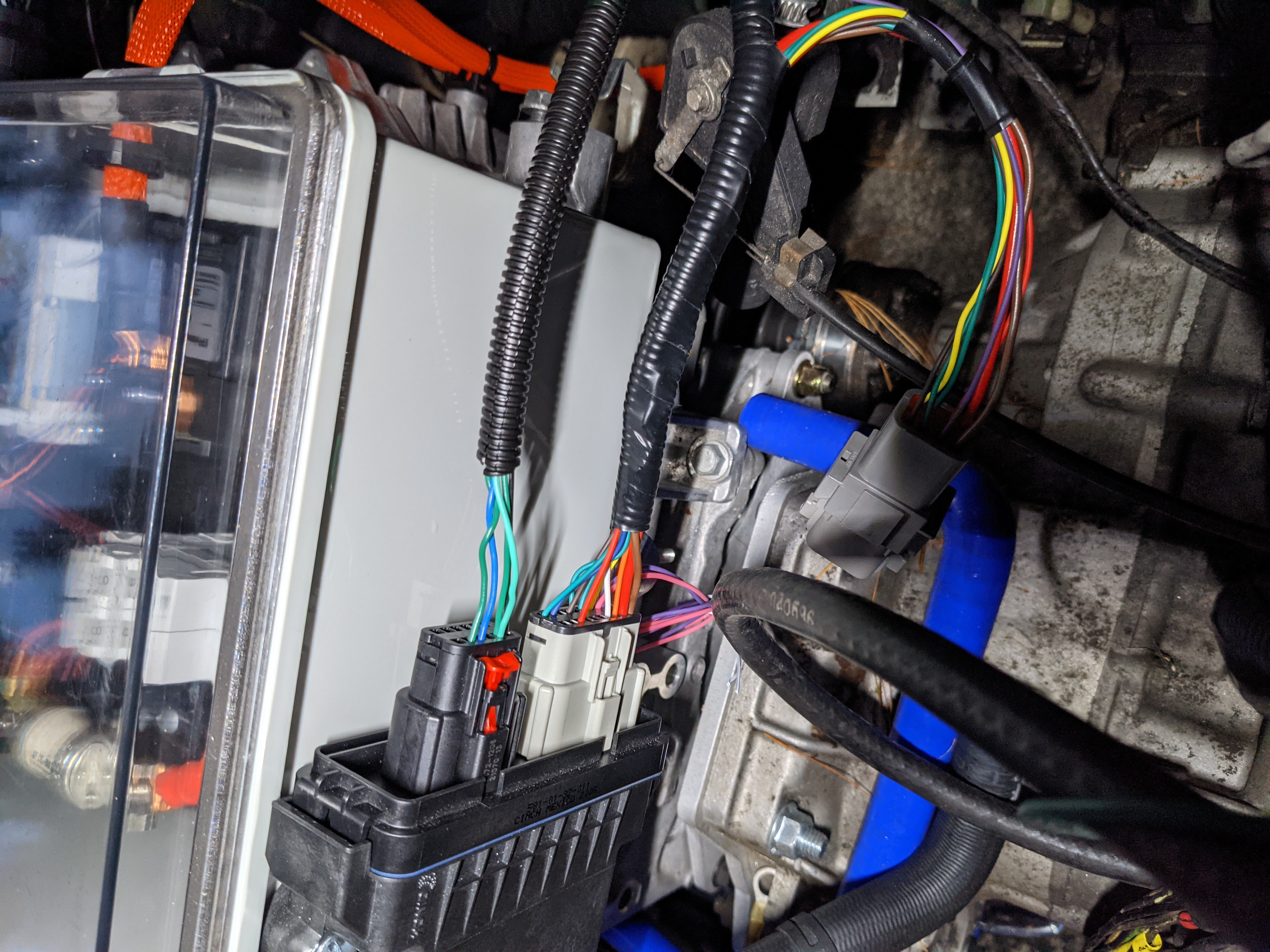

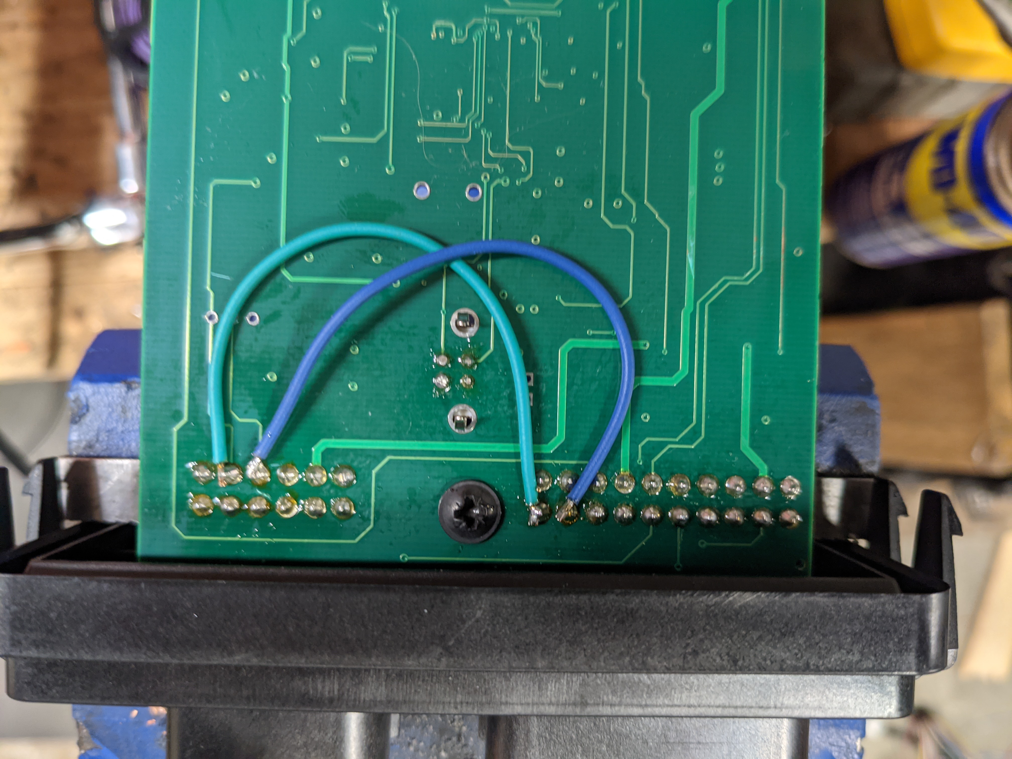

VCU is wired to HVJB and leaf inverter.
VCU CAN jumpers from header 1 to 2. to connect the Inverter CAN with ISA Shunt communication to pins on HVJB header where ISA shunt resides. I plan to bring this up in the Leaf VCU support thread. It's my understanding that the ISA Shunt and Leaf Inverter share the same CAN bus. I'll have to look at Damien's code to confirm.

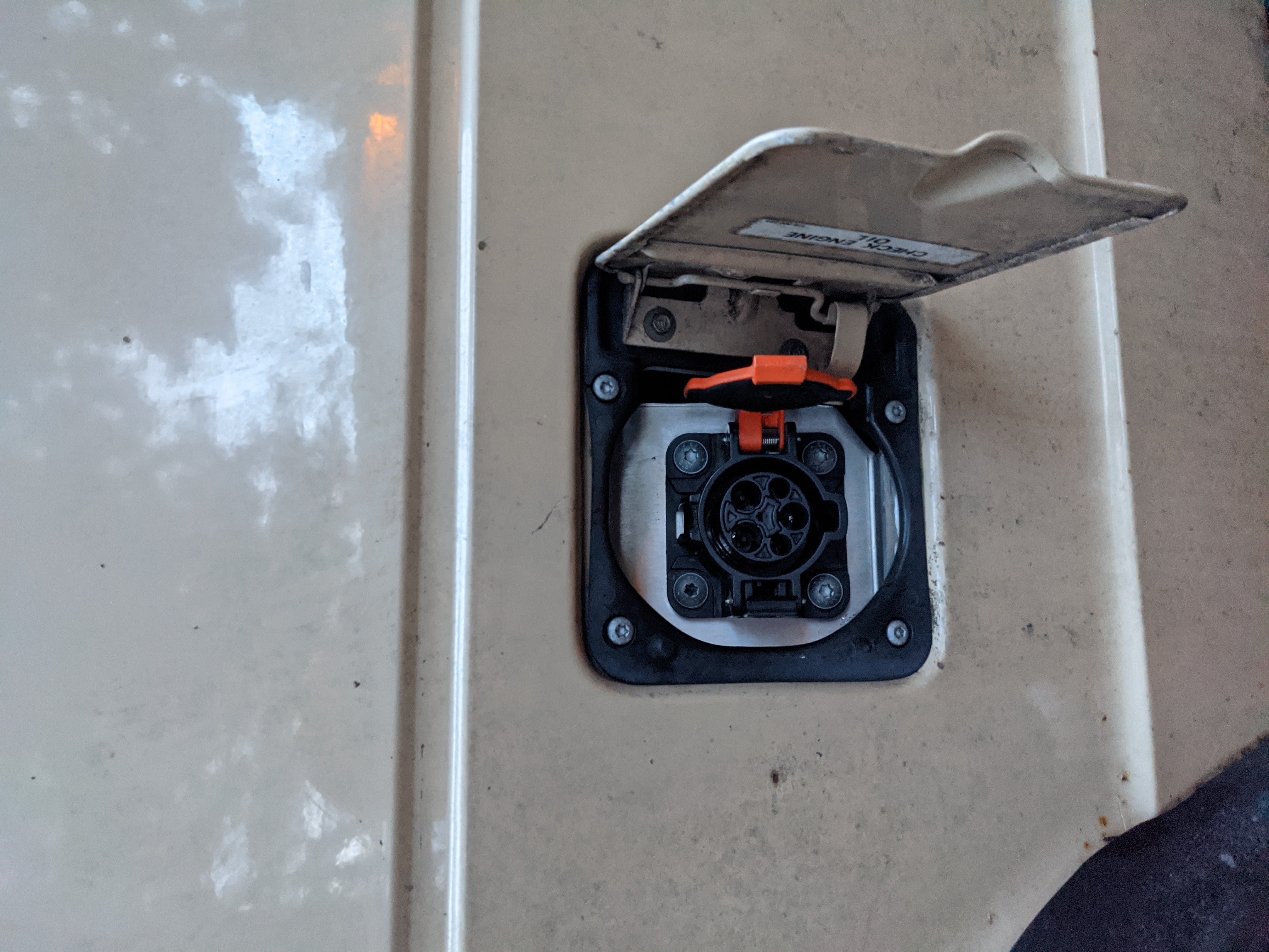

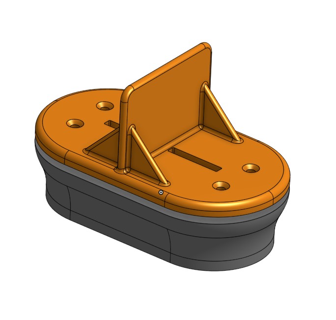

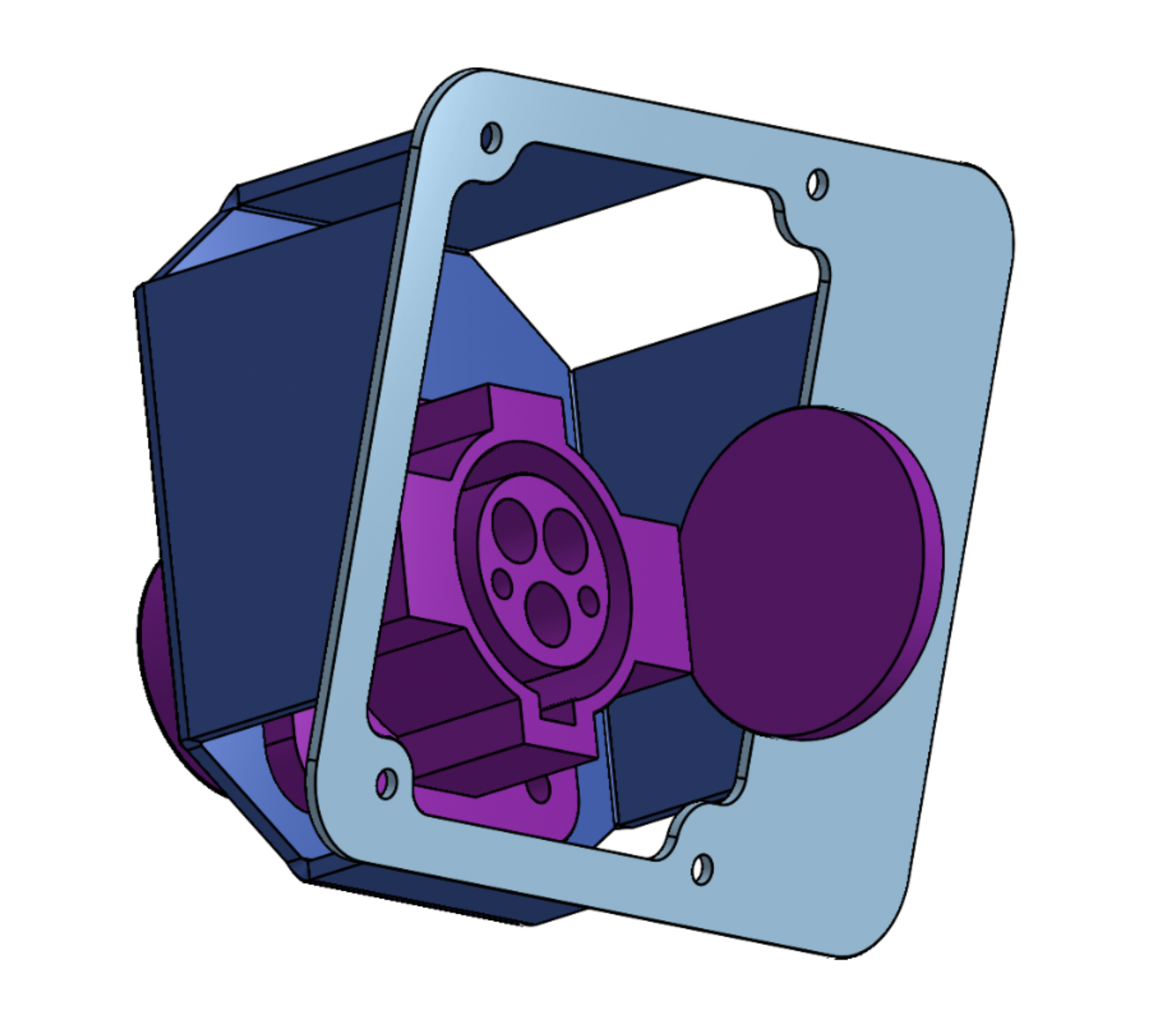

Charge inlet mounting designed and done

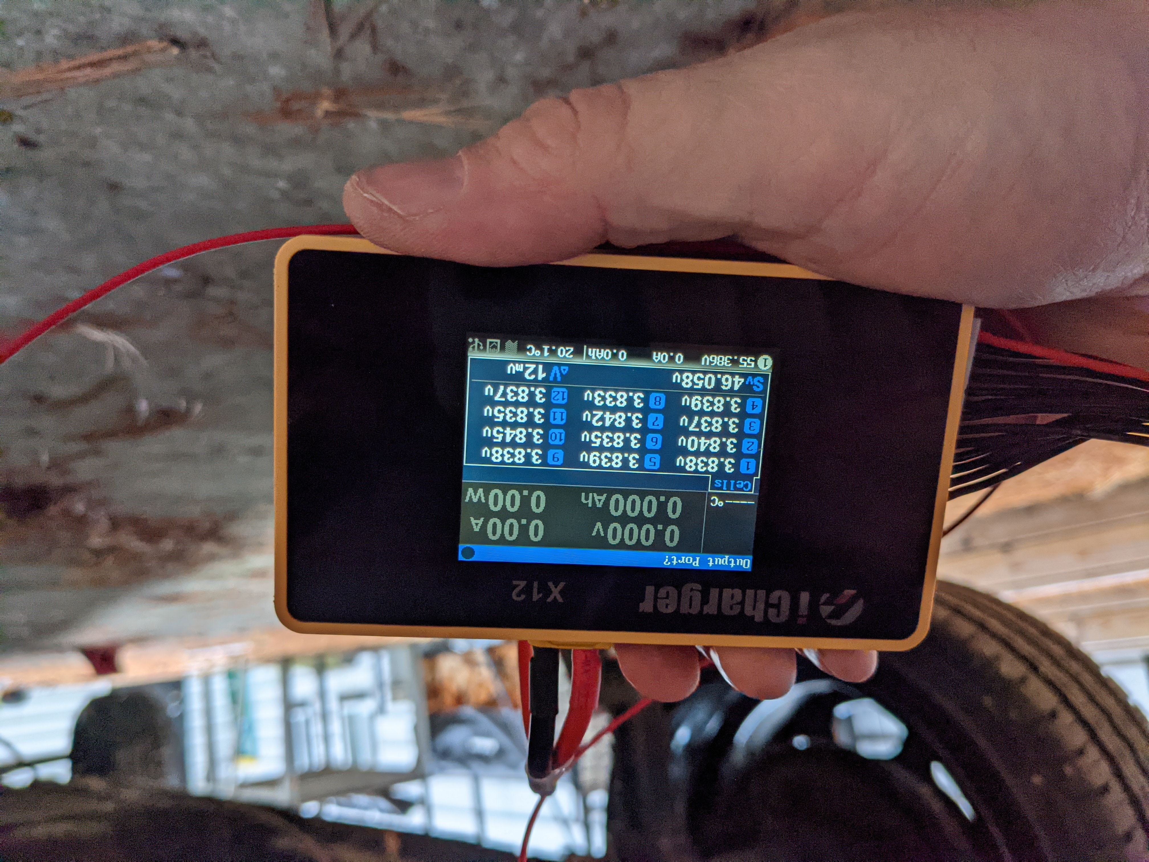

12s battery charger/balancer used to check cell voltages

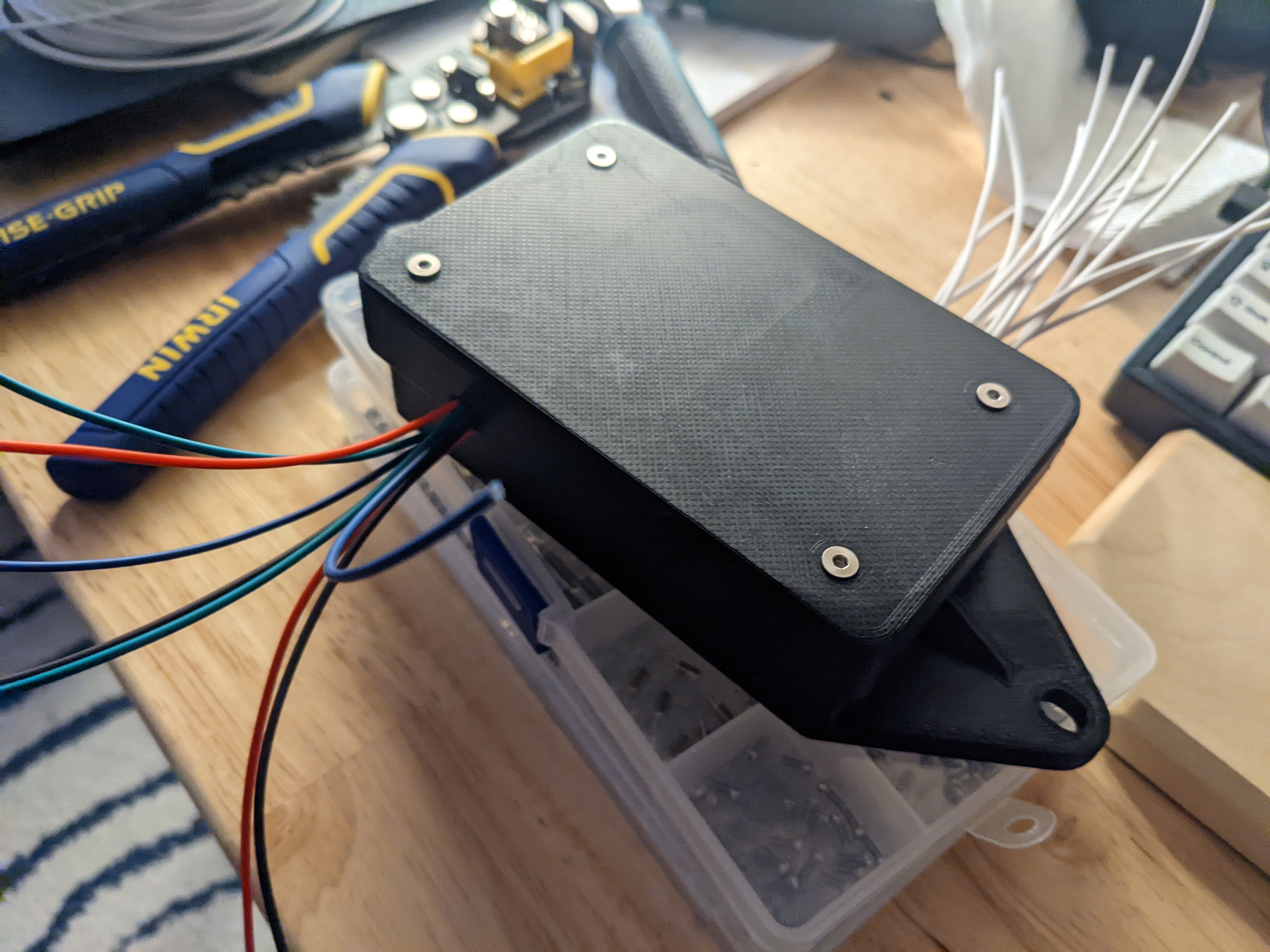

designed and printed a 12v battery tray for a LiFePo4 35Ah

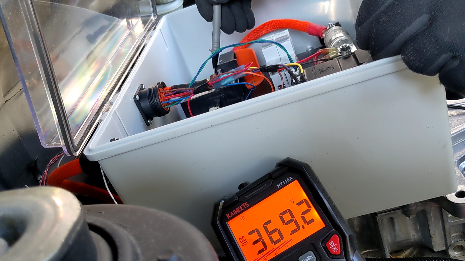

Kind of a big milestone. Full Voltage in the Junction Box.

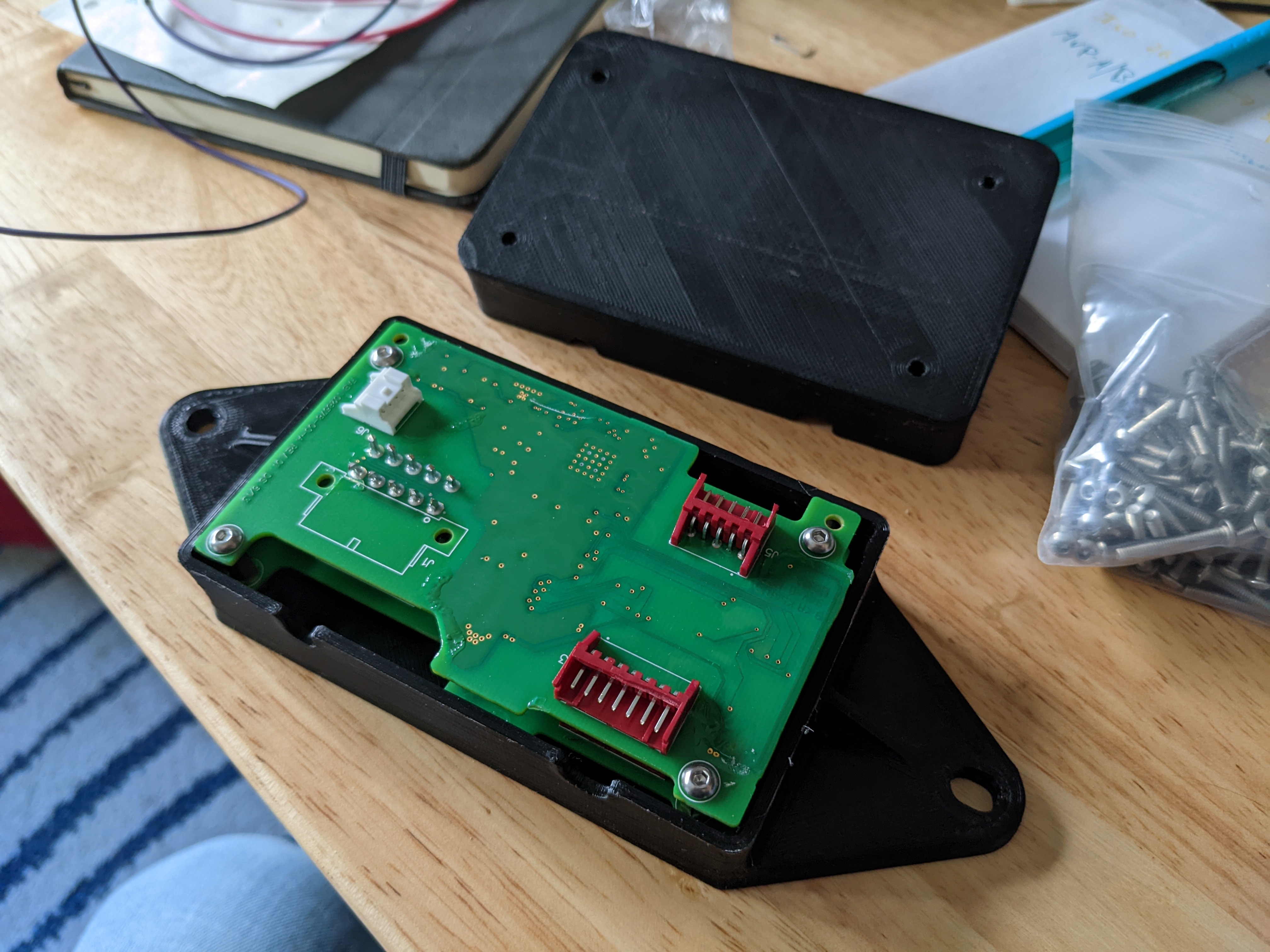

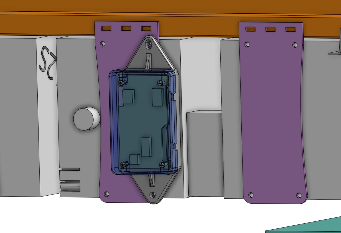

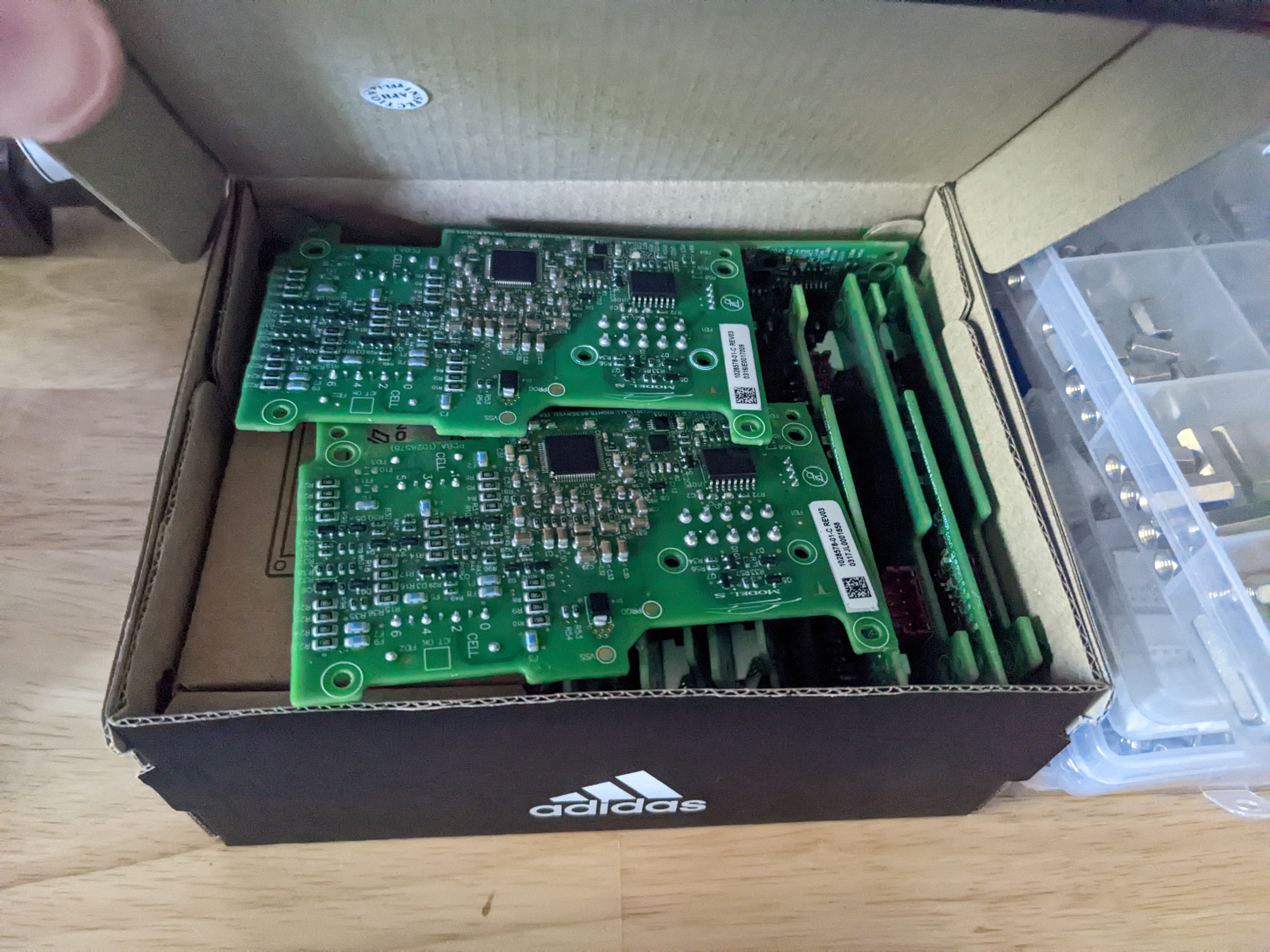

changing my BMS strategy. Was intending on using the Nissan Leaf BMS, but have since decided to go the Simp BMS + Tesla route.
You may wonder how, if I'm not using Tesla modules. Well i just bought a bunch of used Model S/X BMS boards off ebay and am going to wire them to my cells. Combining 2 boards get's me the 12S i need for each of my mercedes modules.

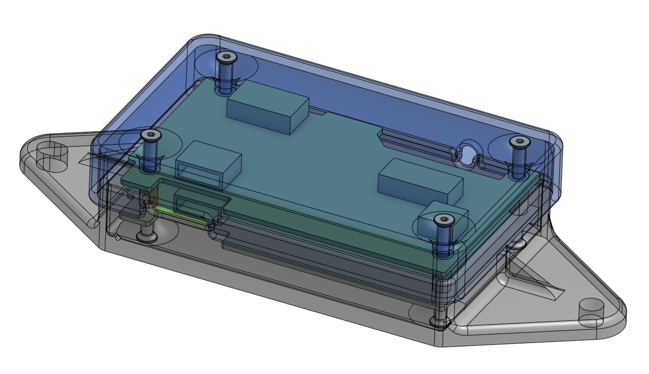

CAD:

Bratitude wrote: Thu Apr 07, 2022 3:01 am Nice, bought a gen1 volt bms to do the same thing. never found a good price for Tesla slave boards, how much did you get the full set for?
So, i knew there would be a bunch of loose model S/X boards out there because of so many people using aftermarket BMSs +adapter boards for stationary, or other, use cases. StealthEV who makes an adapter board for these modules had hundreds of these in stock, which they sold to me for $25ea.
So for 16 modules, needed for a 400V system, plus the cost of the Simp BMS:
Simp BMS from kitoffgrid (only place that would ship to the US): $578
Model S/X modules from StealthEV: $400
BTW, I'm hoping to get it set up to share my powertrain contactors and ISA shunt.
I compared this to the Orion BMS for a 96s system at $2000.
Here is my first 12s sub-module test setup, contains 2 tesla boards:
They will mount to the side of my batteries like so:
