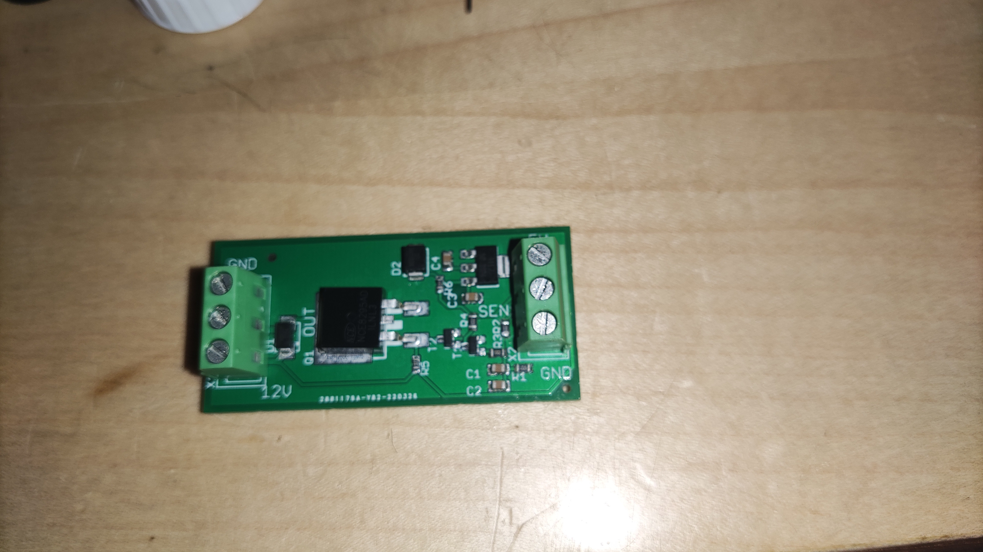

ErikvHilten
- Posts: 3
- Joined: Sun Feb 06, 2022 2:26 pm
Re: Hardware threshold switch for brake vacuum pump
Hi Johu,
Ordered the electronic brake pressure switch and received it yesterday. I hooked it up to 12V car battery and a standard UP28 vacuum pump and vacuum sensor. Worked directly, and got -0.46 bar vacuum.
Hysteresis I found is not so much, maybe 0.05 bar in my case.
Unfortunately when I wanted to show the succes to my wife the pump kept on running. I now measure 12V on the 5V output.
On the 5V regulator it says 1117 // 50 2045. @Johu, can you help out? Is the regulator or a capacitor broken?
- Been thanked: 1913 times
Argh, that sucks. It is already the newer regulator that can take up to 20V supposedly - maybe they don't all work up to spec. I think I need to revise the design and put a resistor and TVR diode before the regulator.
Can you order a new regulator and I refund you parts of the price? Let me know the order number
ErikvHilten
- Posts: 3
Hi Johu, I prefer if you can send me a replacement regulator then I'll try to solder it on. This would save high shipping costs and minimum order qty many part suppliers use. My order ID number: 709. How would you suggest to connect the resistor and TVR diode? Do you think it is possible to adapt the board and solder it on? Thanks.
Ok, I will send you a board with a regulator I sourced locally (no more regulators left). For starters a TVS diode across the reg input would already help.
So for anyone who haven't tested their board yet: solder a roughly 15V TVS diode across the outer regulator pins.
So all modules I send out now will have this fitted.
My vacuum switch died. I hooked up everything on the Bench and it was working fine.
I disconnected 12V from the board while the pump was cycling and I saw a small spark on that 1117 component.
Now the 5V terminal is outputting only 1V.
Oh, then the turnoff spike had nowhere to go. Is the version with TVS diode protecting the 1117? If in doubt post a pic
eee291
- Posts: 42
- Joined: Sat Feb 01, 2020 4:09 pm
- Location: Austria bgld
- Has thanked: 13 times
- Been thanked: 4 times
I bought it like a month ago. I'm pretty sure it has the diode in there.
If I try this again I should switch power from the pump directly, right?
ok, that one should survive most mistreatment. Can you check R6? Should be 10 Ohm
eee291
- Posts: 42
I think R6 is dead, the resistance started at 6Mohm and it just keeps climbing up to 11Mohm and beyond the longer I measure it.
I'll try with a through hole resistor that I have and report back.
ok, just replace it. Acted as a fuse so to speak
