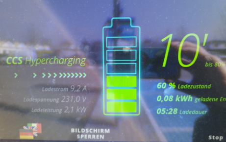

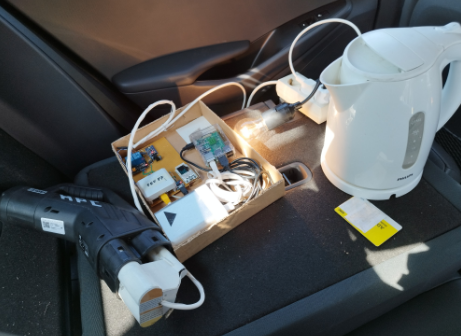

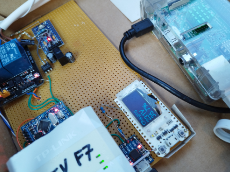

Some small progress on the Tesla SuperCharger: SLAC and TCP connections work perfect, also with the headless Raspberry3 as controller. In contrast to the other chargers, the SuperCharger use only 8 characters session ID instead of 16. This case is not yet considered in the OpenV2Gx. At the moment the SuperCharger complains (correctly) about wrong session ID. Updates are ongoing.

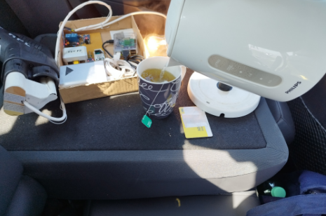

In cold days it's always a good idea to have a hot tea during the charging breaks. And here we go:
Version v0.6 released.Github: http://github.com/uhi22 --- Patreon: https://www.patreon.com/uhi22
