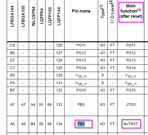

Re: Foccci wakeup/sleep discussions
Had a look, nothing obvious found so far. Setting the PB1 to high works, so no idea so far why the PB4 gets a pull-up.
Edit: Found a hot candidate. The pull-up of the PB4 starts quite early, ~3.5ms before the PB1 gets high in initialize_pins(). This means, this pull-up seems to come quite early in the start of the bootloader. But in code, I did not find anything. Could it be pull-up per default? Bingo. The data sheet says: This means, the PB4 is configured to alternate function, and that's why the writing of the GPIO during initialize_pins() is pointless.

Edit2: In https://www.keil.com/dd/docs/datashts/s ... f10xxx.pdf Table 33 they explain that "freeing" the PB4 is confibured in SWJ_CFG[2:0]. The clara application seems to configure this in main() by gpio_primary_remap(AFIO_MAPR_SWJ_CFG_JTAG_OFF_SW_ON, ...) Could this be taken-over into the bootloader?

Yes, that's the reason! Bumped into this before with the version check of the Gen3 Leaf board. Will add this to the boot loaderuhi22 wrote: ↑Sun Jun 16, 2024 5:31 pm Edit2: In https://www.keil.com/dd/docs/datashts/s ... f10xxx.pdf Table 33 they explain that "freeing" the PB4 is confibured in SWJ_CFG[2:0]. The clara application seems to configure this in main() by gpio_primary_remap(AFIO_MAPR_SWJ_CFG_JTAG_OFF_SW_ON, ...) Could this be taken-over into the bootloader?

Boot loader fixed: https://github.com/jsphuebner/stm32-CAN ... s/tag/v1.1

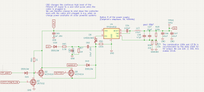

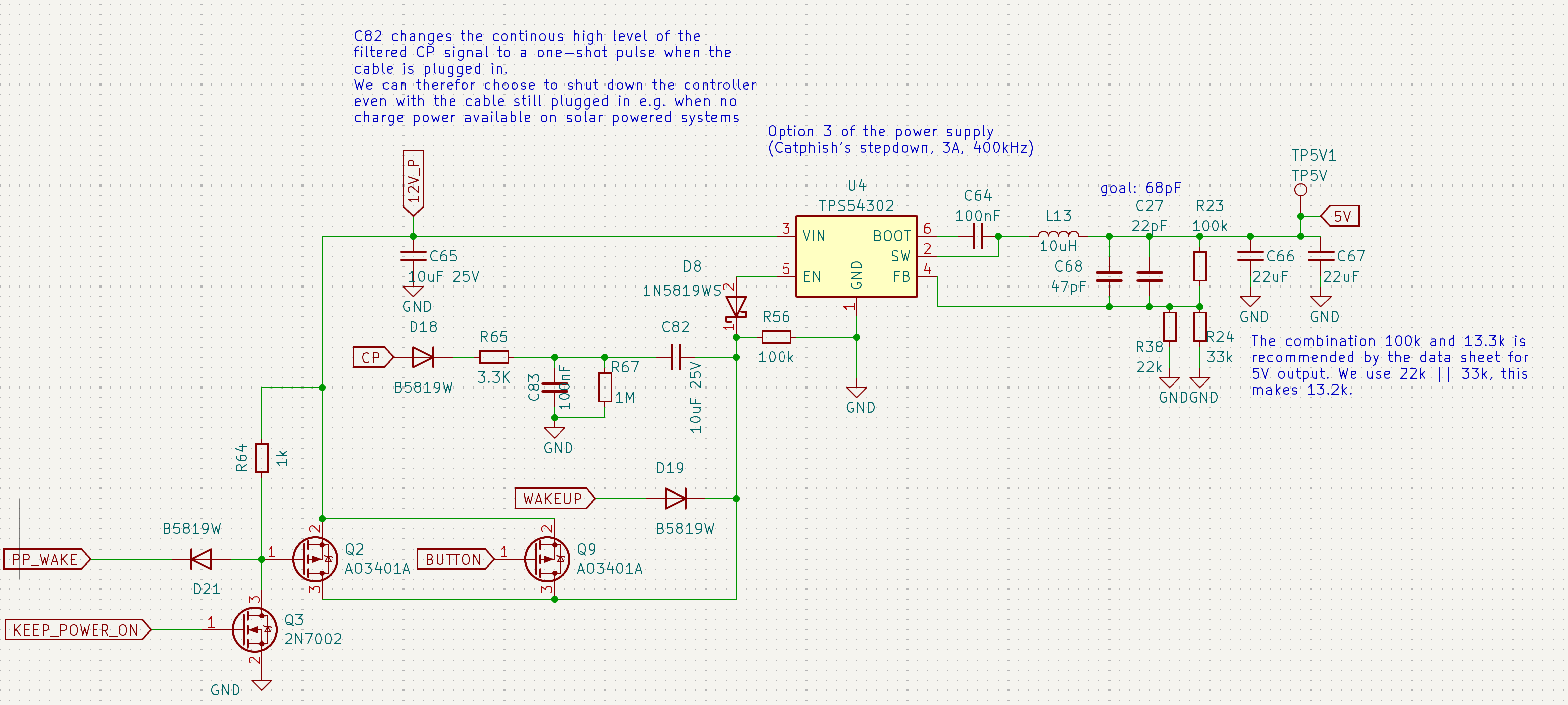

I try to understand the wakeup circuit.
The EN pin of the TPS54302 (U4) needs ±1.3V to power on. And it accepts absolute max 7V.
What does the 40V Schottky Barrier Diodes 1N5819WS (D8) with the 12V wakeup signal?
I would expect a voltage divider or an opamp circuit to limit the voltage for the EN pin.
- Been thanked: 1914 times
D8 ensures that EN is never driven high by anything. It has an internal pull-up. The various wakeup signals can allow that pullup to actually pull EN high. If no wake up source is active EN is forced low by R56
