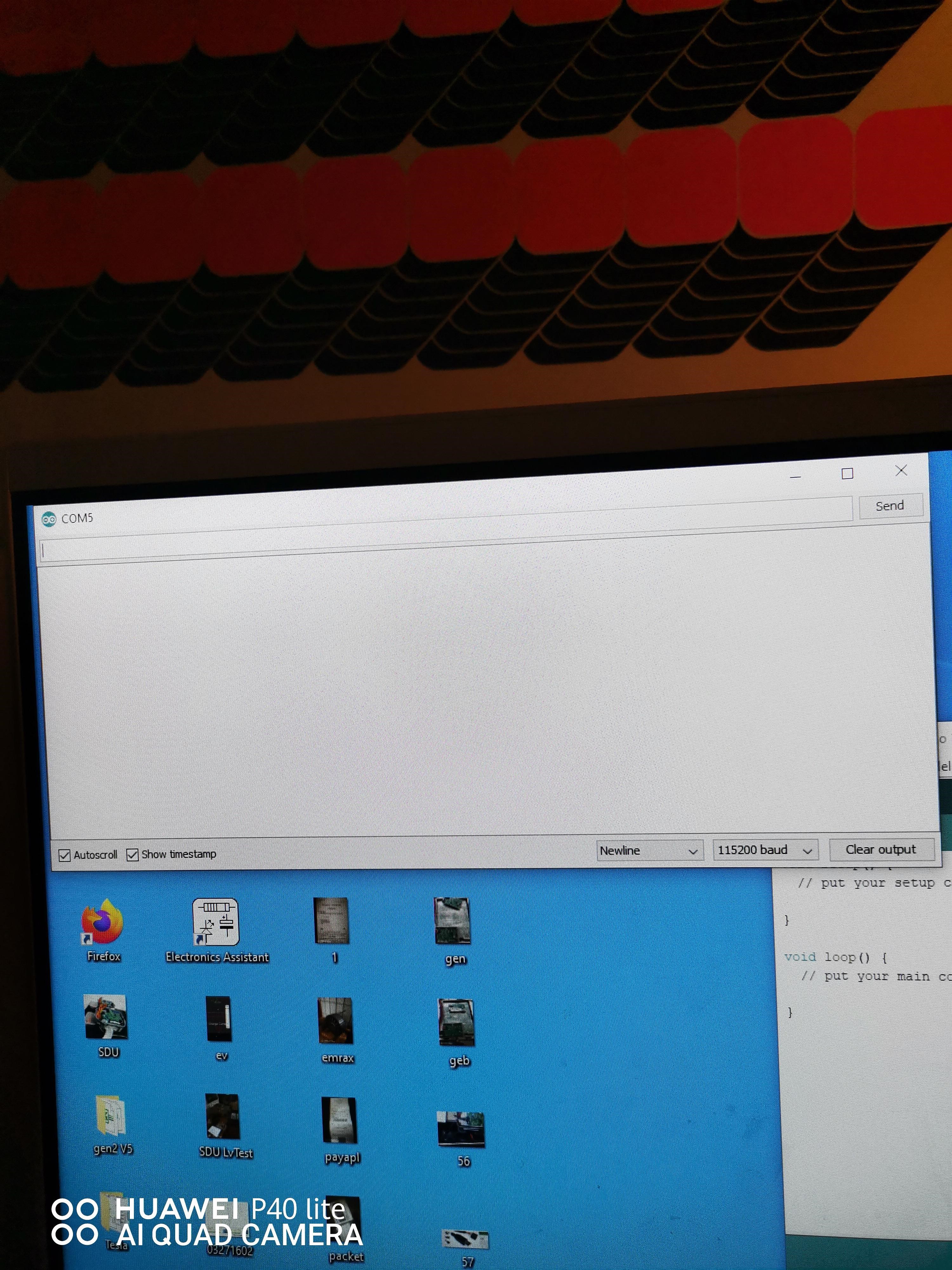

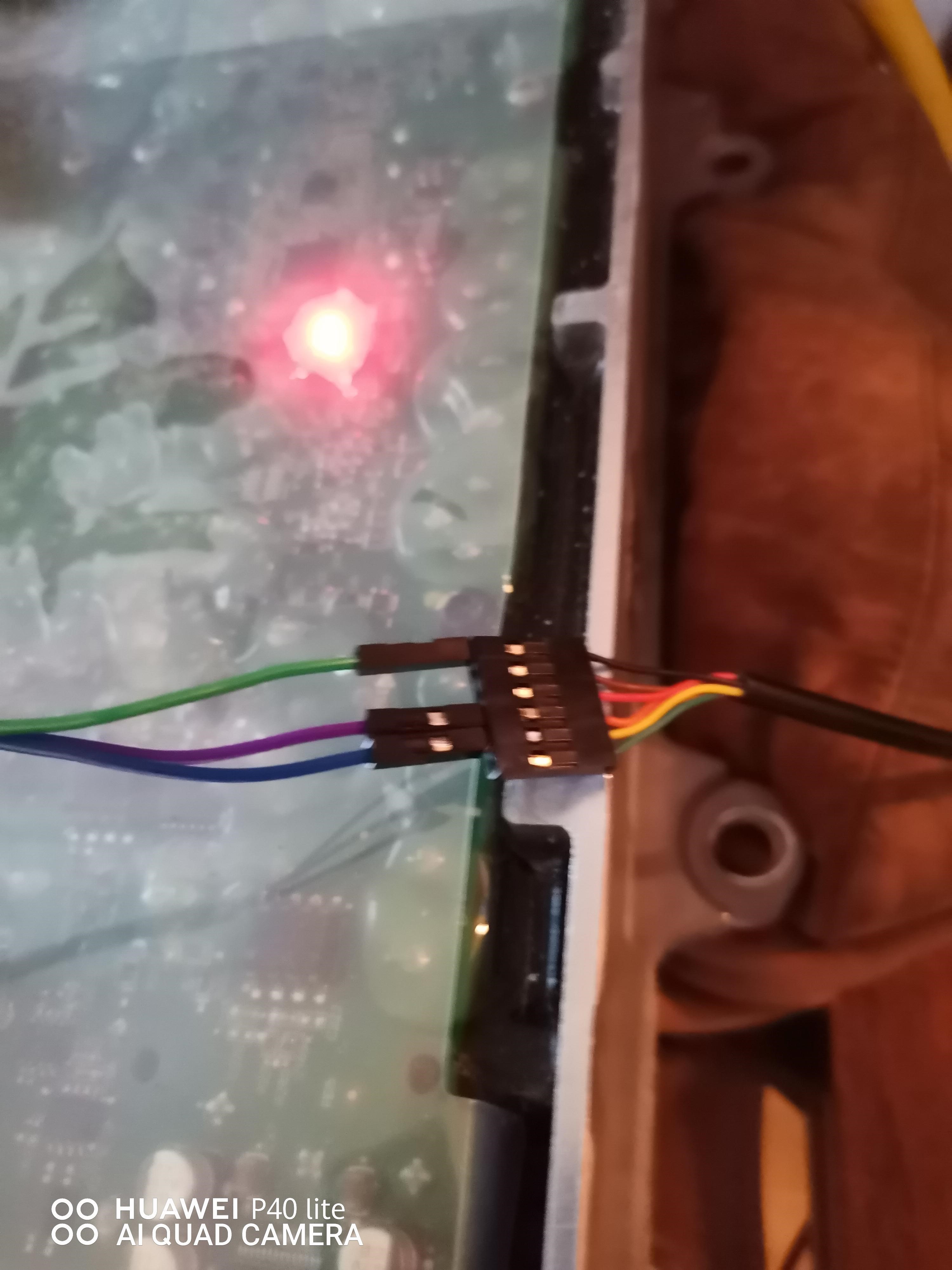

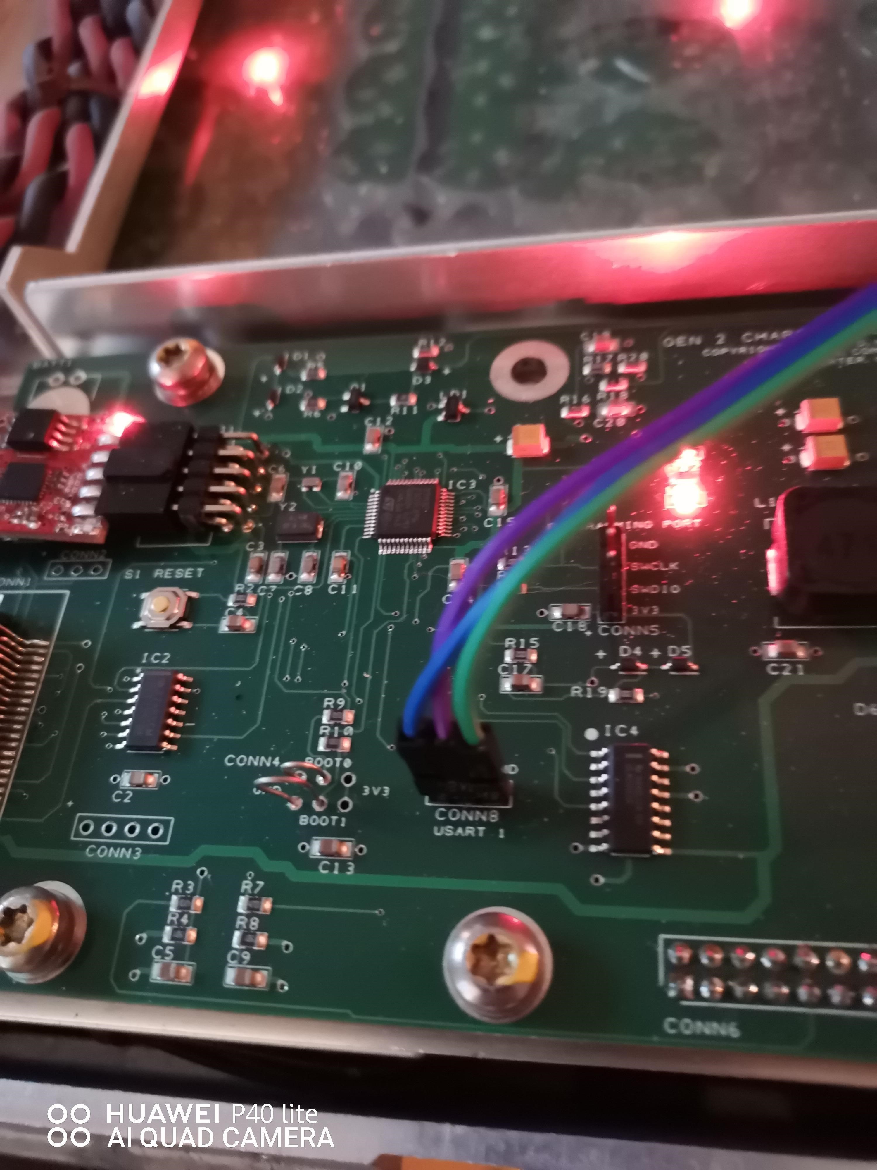

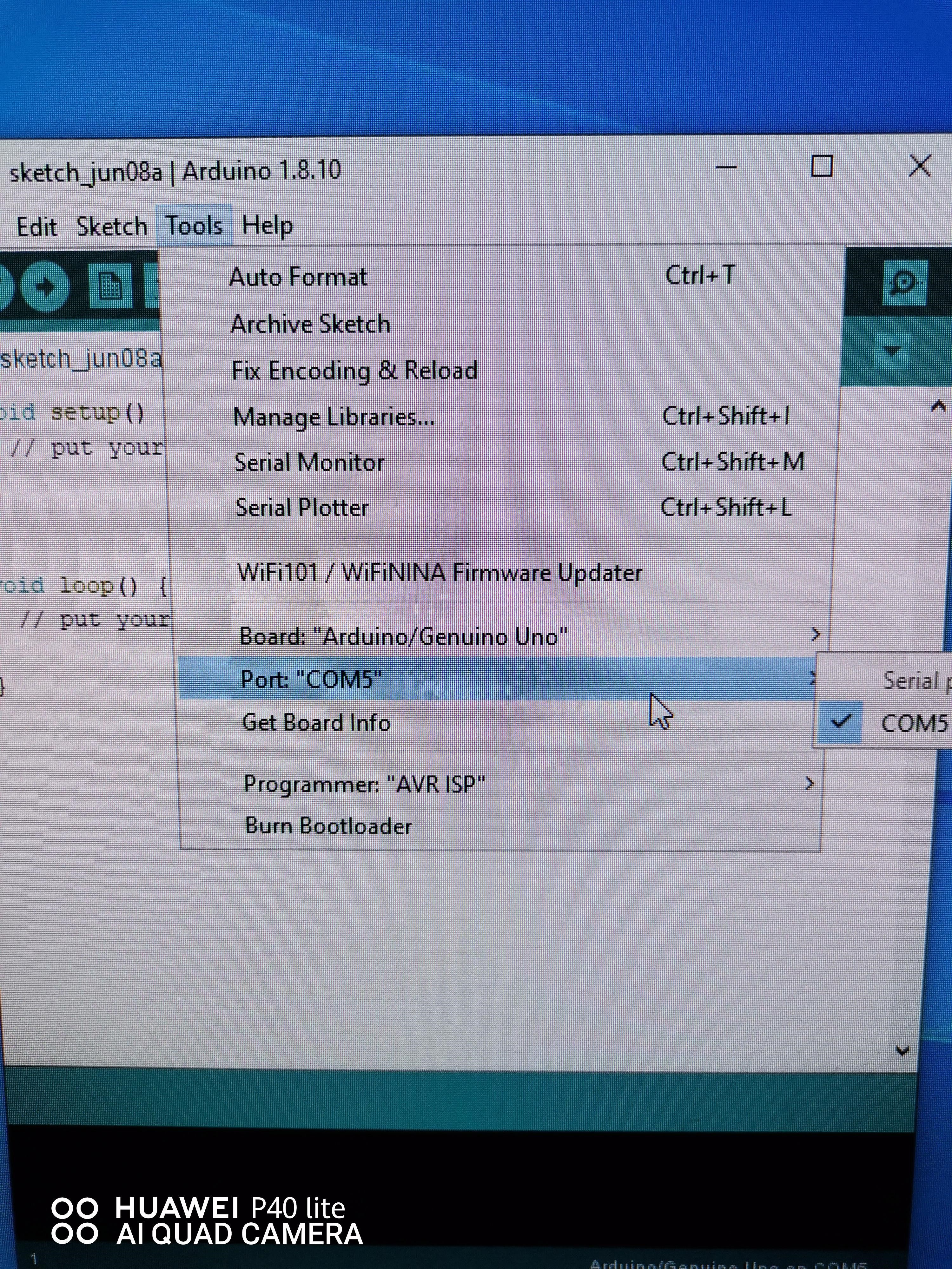

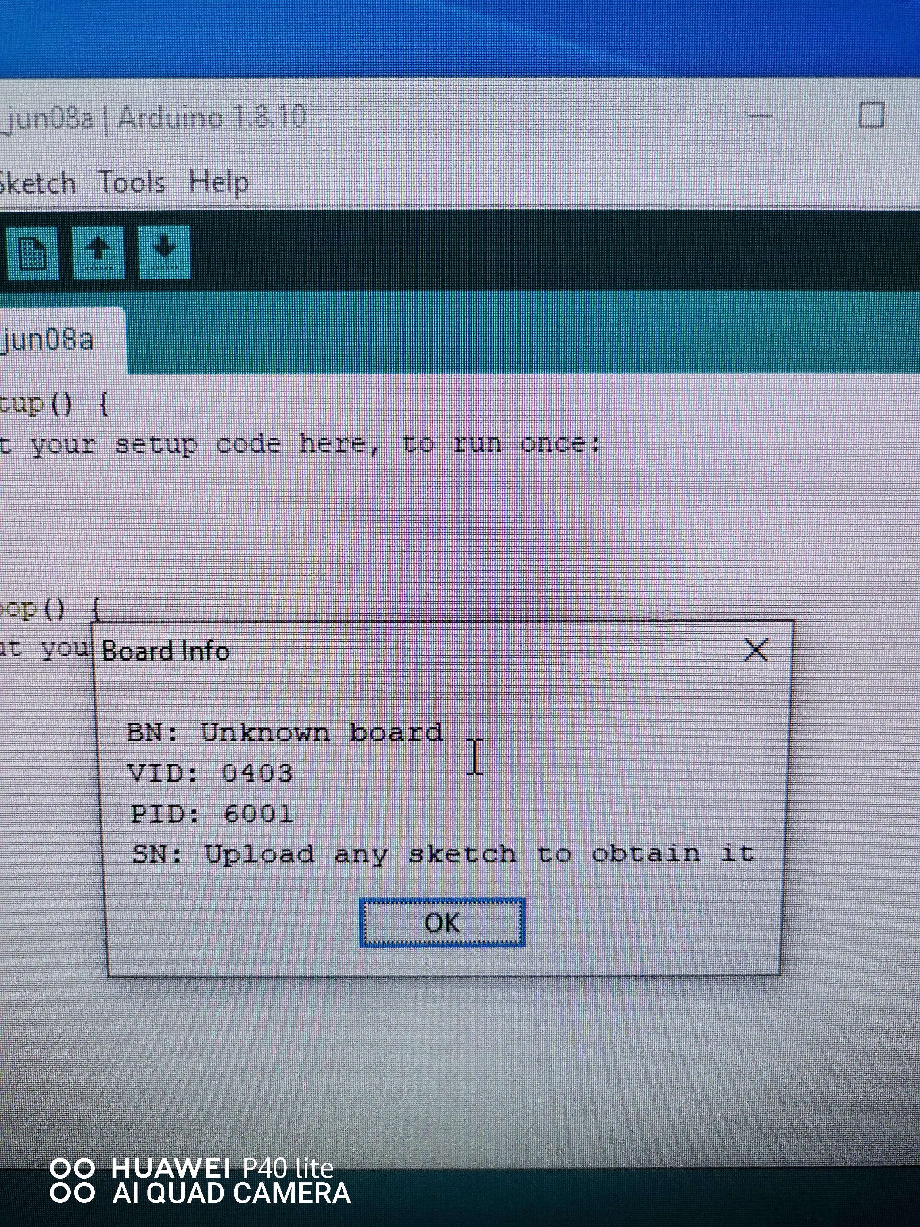

Good morning
I having problem with serial monitor or uart cable.I got no debug info.
i connect black-GND,orange-RX,yellow-TX,it open the monitor window (also in PuTTY)and stays empty.
baud is 115200
what can i do?

Try swapping rx and tx
nesto1972
Posts: 48
Joined: Sat Jan 11, 2020 7:14 pm
Location: Austria
Re: Gen 2 Charger V5 Software Development Thread
Post by nesto1972 »
Tryed! not better!!!

Was this after uploading code? If so, youll need to hit the reset button on the board or cycle power.

Its a tested board of Damien!
Posts: 4007
Been thanked: 1139 times
I no longer provide built and tested boards. It is a kit and is not a final product as stated on the webshop :
"BETA RELEASE FOR DEVELOPERS ONLY! DO NOT PURCHASE THIS IF YOU ARE NOT PREPARED / ABLE TO ASSIST WITH TESTING AND DEVELOPMENT! NOT A FINAL PRODUCT!!!"
1)You should have 2 red leds on the board.
2)You need to use a 3v3 level ftdi NOT a 5v level.
3)I have only tested with arduino serial monitor so give that a try.
I did load both boards with Jon's latest code and tested serial comms.

Sorry i took the wrong word!My english language is limited so it can happen like this.
I think i have the right cable ordered.
Will also try another computer and the second board!
If you see a wrong setting pls. let me know...:)
Posts: 4007
That all looks good. You should be seeing something on the serial monitor ...
