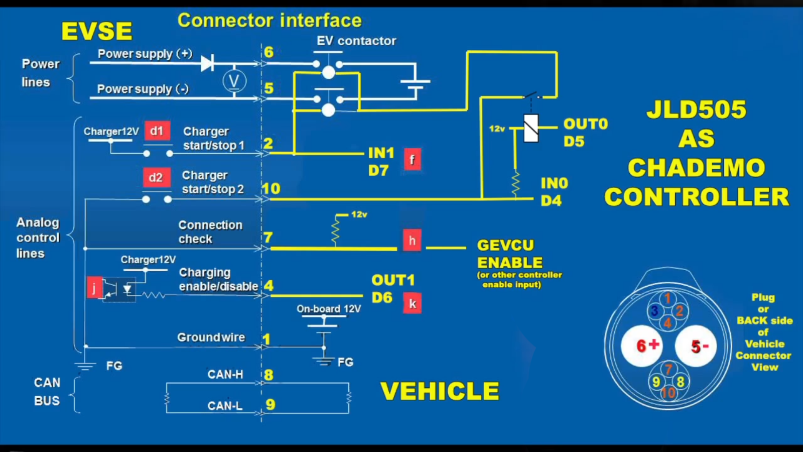

I'm doing some bench testing... Some very weird things happening.
I am testing with my GEVCU hardware, so pins 48-51 are usable as inputs.
For some reason 48 and 50 don't work with the rest of the Chademo code. When read by a simple DigitalReadSerial they read the inputs just fine but when the Chademo code is set to use them, no readings (they stay high).
I'm fairly sure this is caused by some of the libraries in use but don't have the time right now to test all that properly.
The problem here is that the Leaf VCU uses pins 49 and 48 as outputs, so I don't know if those will work, and can't fully test the output side.
(48 and 50 don't appear to work as outputs, 49 and 51 probably do work).

Found the issue with pins 48/50 - the due_can library defaults to using them for CAN enable.
So I'm setting the CAN enable pins to 255 (which nulls them out).
ISA.h also needed changes since it also defaults to 48/50. Modified version is attached.
(That library is weird, it seems to autosave/autorecover amp-hours on power reset. No idea if that works, I don't have an ISA shunt yet).
I also seem to have forgotten that the CAN mailboxes needed to be set up -- I just added that in along with a little more debugging (since there are plenty of bugs).
v0.4 is attached.

Here is a first draft of a dedicated Chademo controller based on the Leaf VCU. Would appreciate it if people took a look over to see if (where) I have screwed up.
-Deleted unused pins and components.
-Added two onboard relays. RLY1 activates 12v feed to the vcu when chademo plug is inserted. RLY2 controls the HV contactors.
-Added pullup to IN1.
-Vehicle connections via the 12way connector. Chademo signals via the 20 way.
Want to keep it as simple and universal as possible so please don't ask me to add support for steering cruise missiles etc.

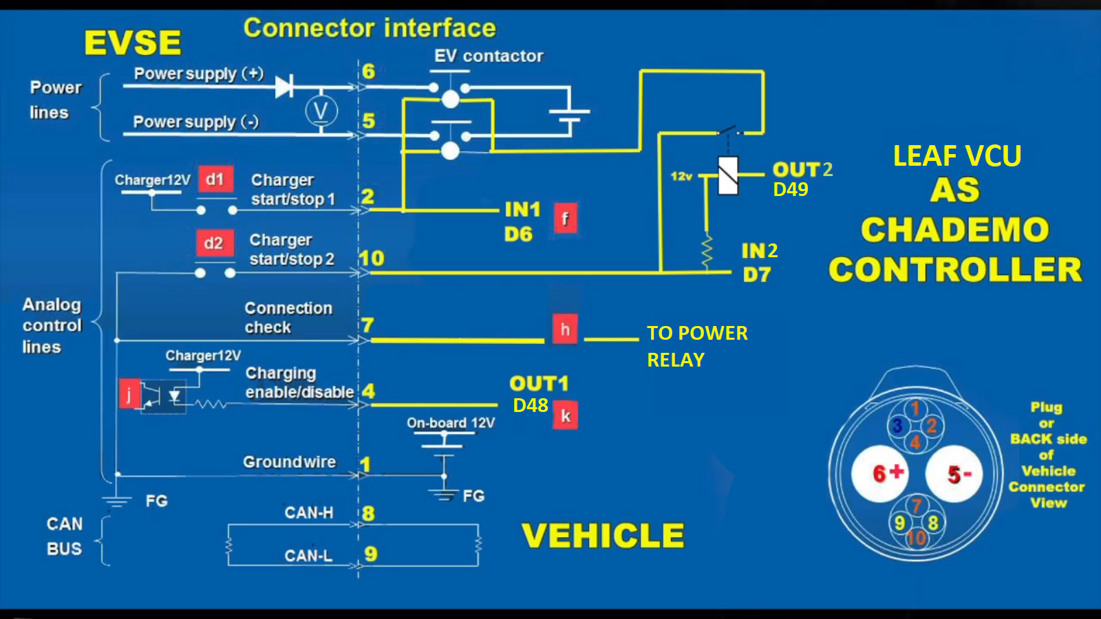

Looks good to me. It also makes me wonder whether my pin assignments are correct in the v0.4 code - they're in globals.h.
IN1 and IN0 may be reversed, would you mind checking that out? For that matter OUT0 and OUT1 might be backwards too. I think I set those according to the first VCU wiring diagram you put up.
Also, how should OUT3 be integrated into the software? I'm not sure what you're planning to use it for.

CHAdeMO VCU from Damien arrived today! Thank you so much!!!
I'll have it wired up in an hour or so and go try it out (just waiting on ISA shunt, that should be here soon enough).
At least I can see how CAN works and whether I set up the I/O correctly.
HV request - that will be in the next version after I've verified correct operation.

So it's been a little more than an hour. I've got the VCU mostly wired up now.
But IN2 has a 1K5 pulldown (part of the voltage divider) which is being annoying (I think I have a 10K, far too weak).
I see on the schematic for the future CHAdeMO VCU that has been changed to a pullup, so I'll probably do the same on this Leaf VCU.
Pin names have been changed to reflect the hardware better, v0.5 is coming after some testing @ station with HV request added.
-Isaac

Looks like Leaf VCU communicates correctly.
Charge shuts down (after closing contactors) because I still have neither batteries nor shunt hooked up, but that should all still work.
v0.5 is attached, with HV request added.
Also edited this wiring diagram to reflect the new wiring.
Anyone else with Leaf VCU, you might want to remove R17 (1k5 pulldown on IN2) if you don't have other plans for the VCU. If not I suppose a buffer or optocoupler might work.
-Isaac
