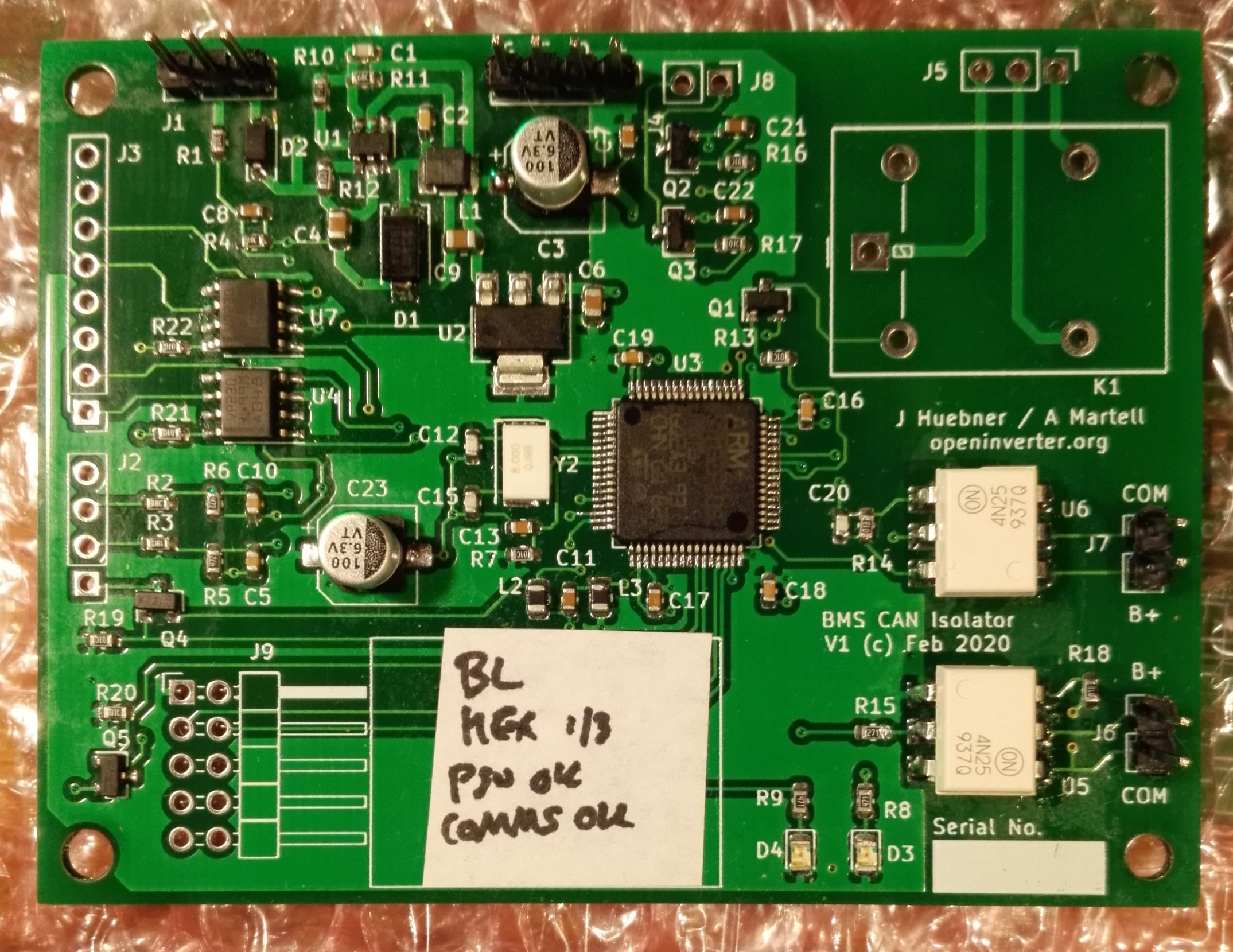

The new BMS master boards are ready, thanks to Andy (=sonachan1)
He did layout and assembly.
I'm getting 10 more from JLC, hopefully they arrive before I go on holiday this Thursday.
2 lessons learned:
- BOOT0 needs to be grounded, otherwise reset doesn't work (processor ends up in factory boot loader)
- The STM32F105RBT6 has a flash page size of 2kb as opposed to 1kb in the STM32F103RBT6 -> need to change boot loader, parameter saving and wifi module update function
2 lessons learned:

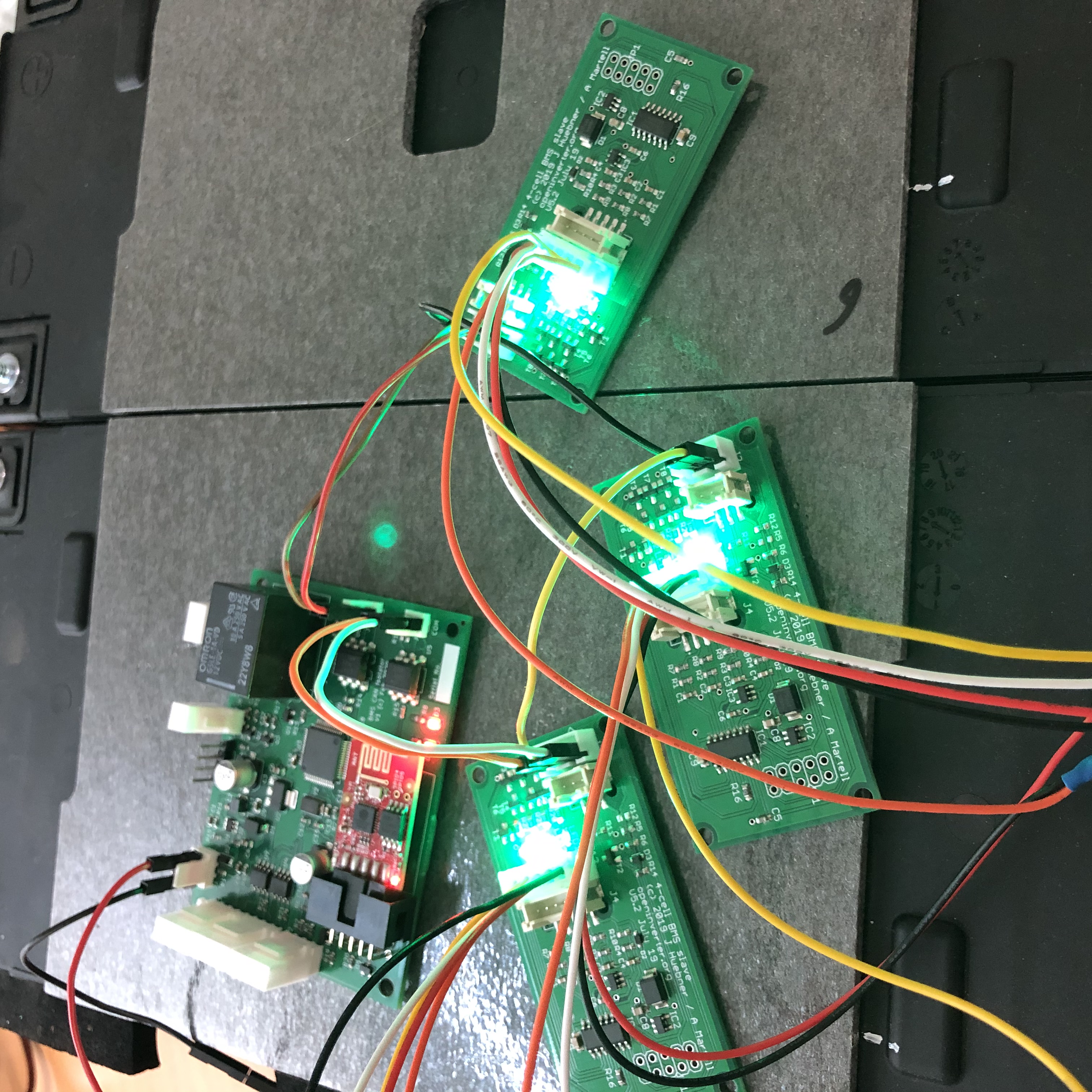

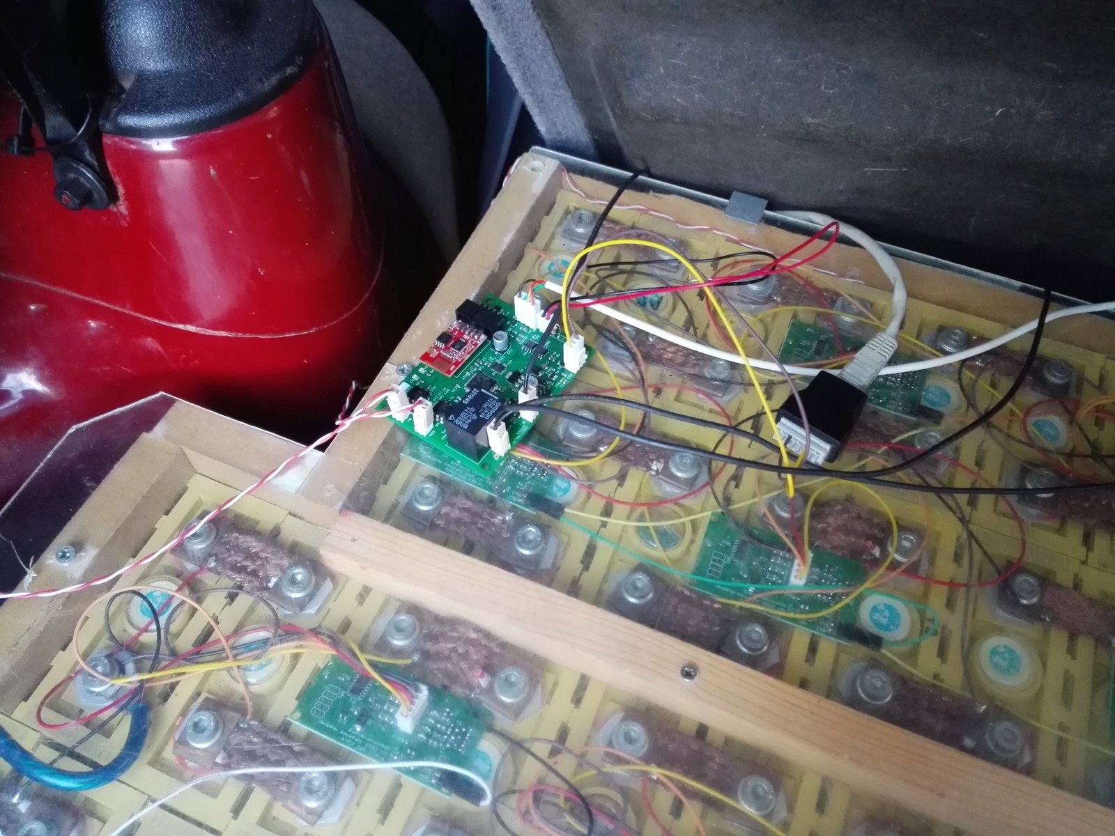

Finally I got to work on the BMS again. I connected it to the 99 cells in the back and also connected fuel gauge, charger (inverter) and a current sensor. All works a treat.
I will build the system up fully with another master unit in the front that acts as a slave to the master unit in the back. Communication is via CAN. With that done I will extend the software to execute more BMS functions.
The BMS presents a challenge when it comes to selling it. The quantity of boards is higher and they are fully build, so not kits. That has a couple of legal implications. Therefor I'm currently working with a distribution partner who will ship out the hardware while I will just sell the master units software.
Slave boards will certainly cost less than 10€, so less than 2.50€ per cell.

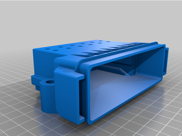

Found mini ModICE enclosure STL for 3D SLA printing. https://www.thingiverse.com/thing:4280286
