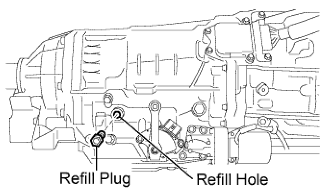

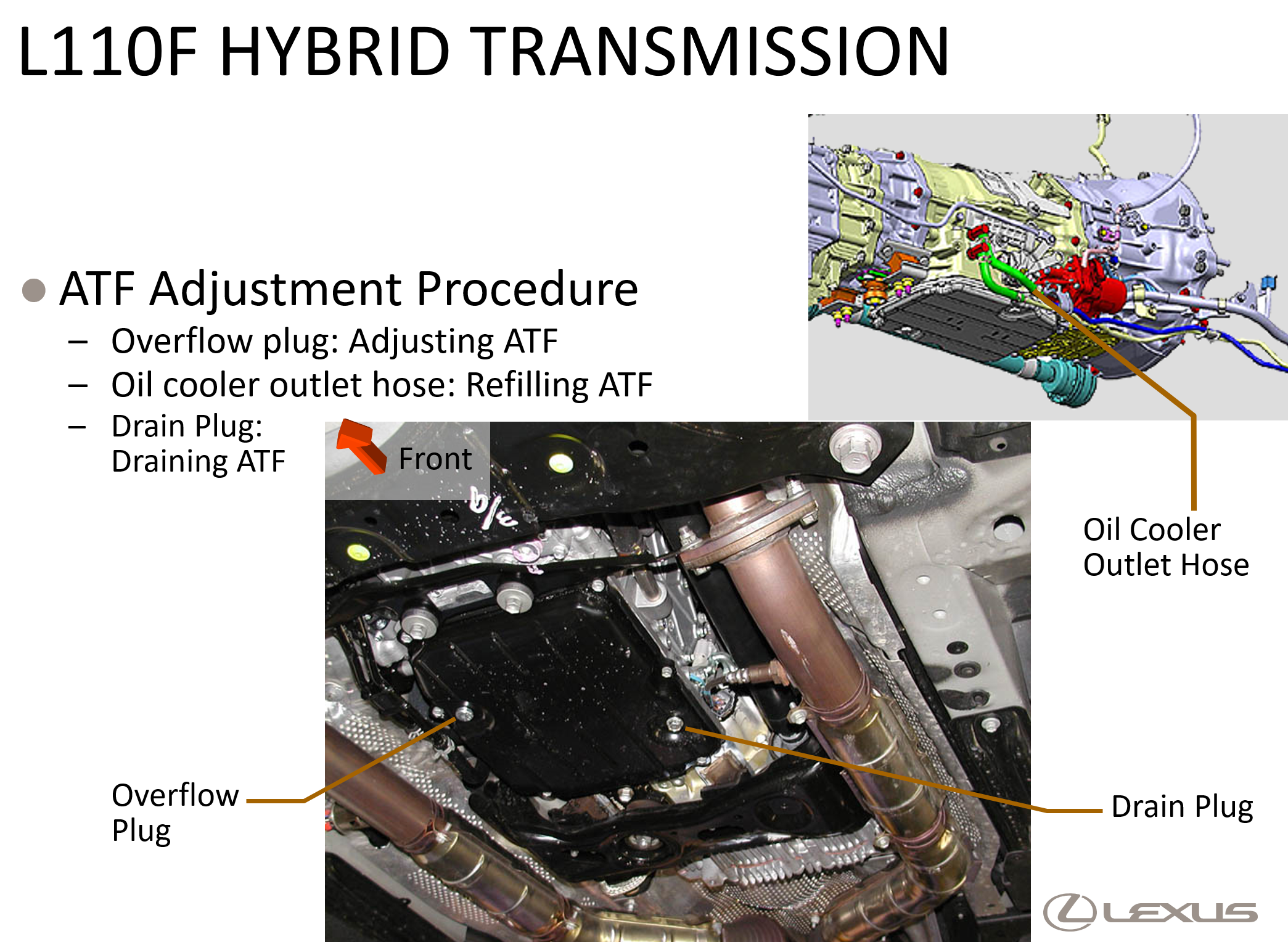

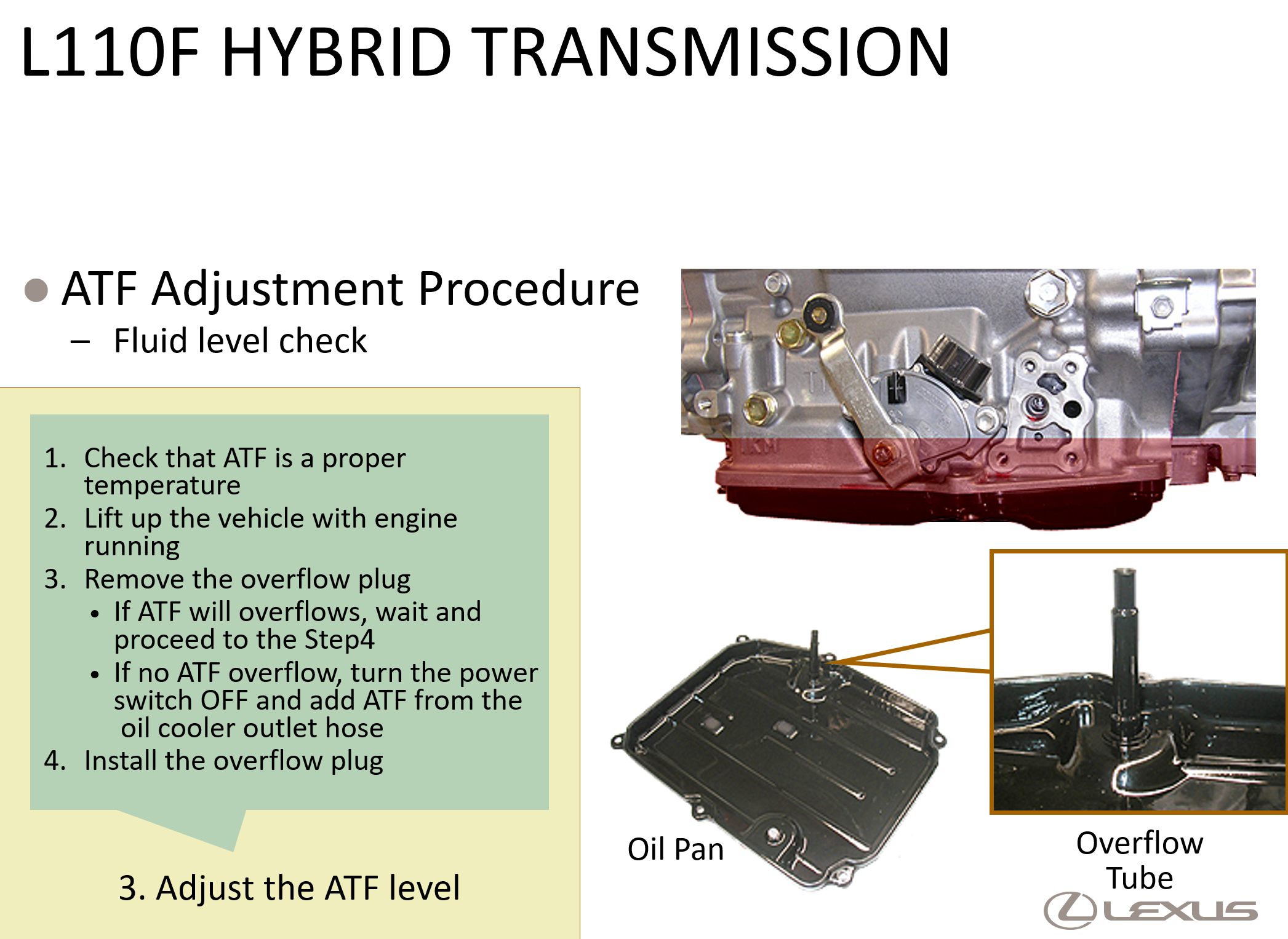

Setting the fluid level is easy. On the sump there are two plugs. One is a drain plug the other is the level plug. Remove the level plug and fill until fluid comes out the level plug. Then run the pump. Rinse and repeat. Your done.

Thanks for all suggestions on checking ATF level. Turns out I was 3 quarts low. I guess scrap yard drained most of the ATF before shipping it.
I also came across those nice pictures. I noticed a lot of people are asking about some of those details. Those are GS600H but same procedure applies to GS450H.
Best to use Toyota Genuine ATF WS.
Specified amount of fluid is 5.0 liters (5.3 US qts, 4.4 Imp. qts).

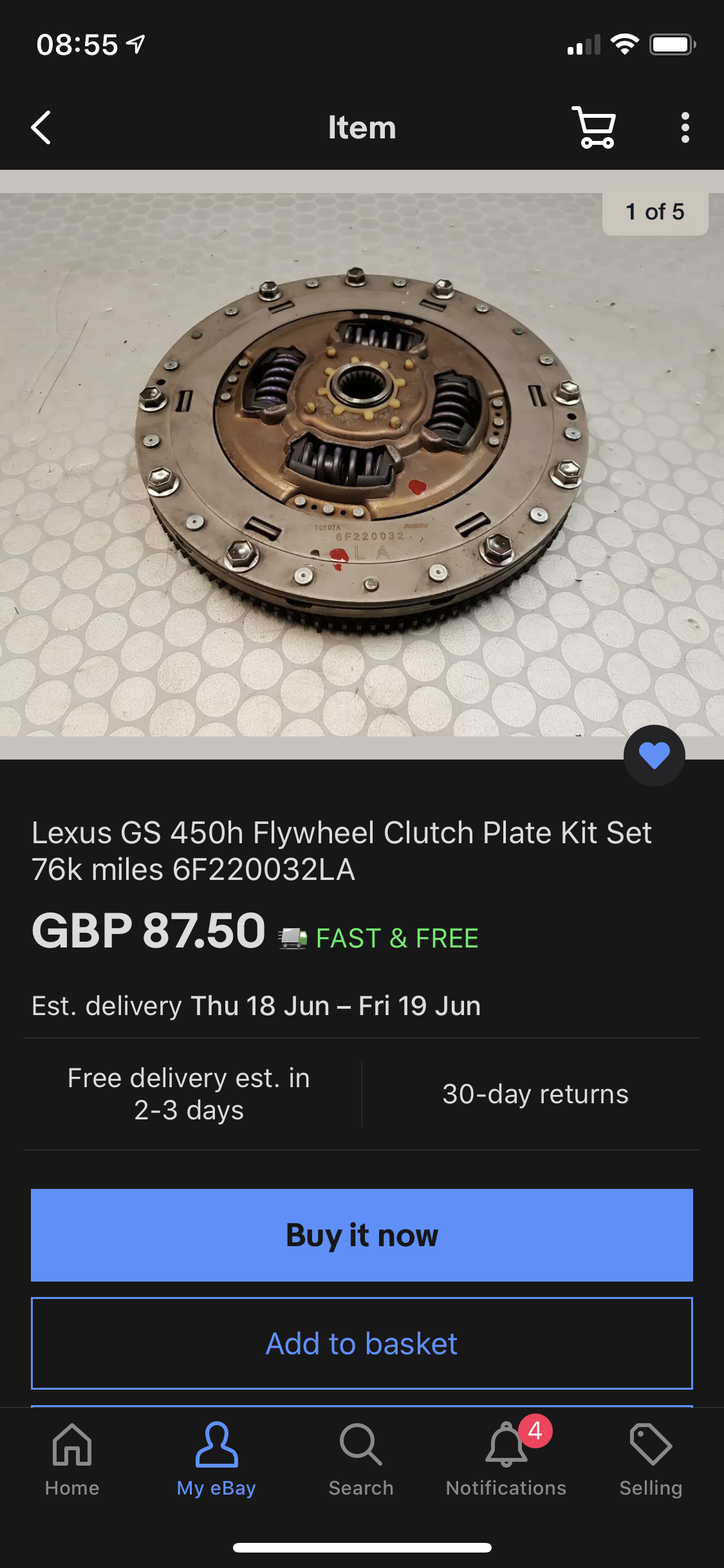

The original GS flywheel/flexplate is often available for less than the price of a clutch disc. As it is not a wear item, there is no demand for replacements.
