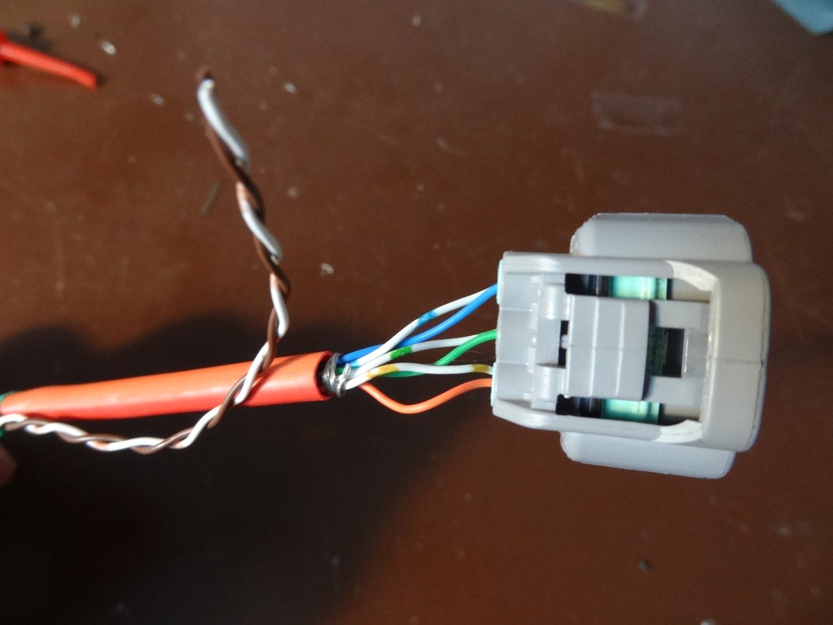

First task done ;) Crimped the resolver wire. Used geduxaz pinout.
Orange pair (pin 1 and 2): excitation R1/R2
Green pair (pin 3 and 4): sine S2/S1
Blue pair (pin 5 and 6): cosine S3/S4

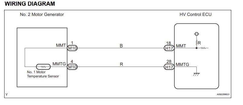

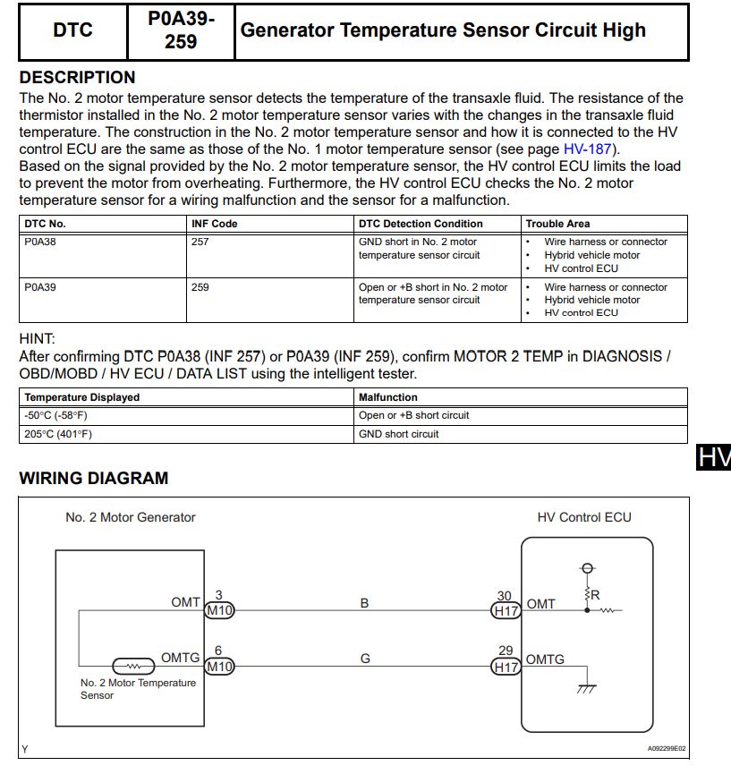

Spliced off the brown pair to reach the temperature sensor. It seems both MG1 and MG2 temp sensors end up on the same connector, does anyone know which one is which?
Also tested it with my old test inverter and it runs nicely.

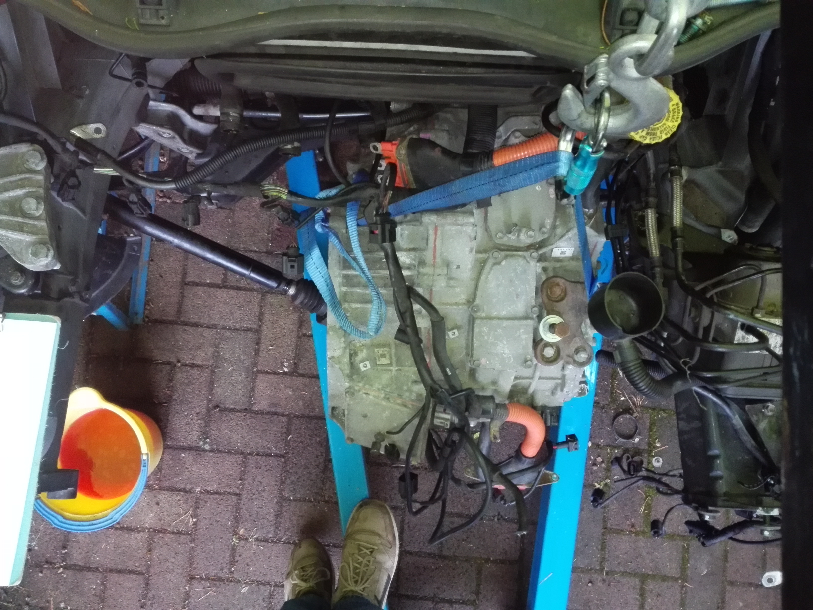

Suspended the transmission from the crane yesterday.
It lines up quite nicely. On the right side (seen from the front) the Audi driveshaft gets very close to the Prius drive shaft cup that Damien thankfully included when he sent me the transmission. So plan is to attach the driveshaft cup from the Audi transmission to the cup from the Prius transmission and then bolt on the original driveshaft as before.
The left side has a hollow shaft that can be widened on the lathe so that the Prius shaft slides right in.
The right transmission mount sort of lines up and today I found the torque arm isn't too hard to adapt as well. Only on the left side there is quite some distance to cover, obviously.

johu wrote: Wed Jan 12, 2022 1:40 pm Spliced off the brown pair to reach the temperature sensor. It seems both MG1 and MG2 temp sensors end up on the same connector, does anyone know which one is which?
Here You go ;)
mg1 temp
mg1 temp
mg2 temp
mg2 temp

geduxaz wrote: Fri Feb 04, 2022 12:27 pm Here You go ;)
Thanks :)

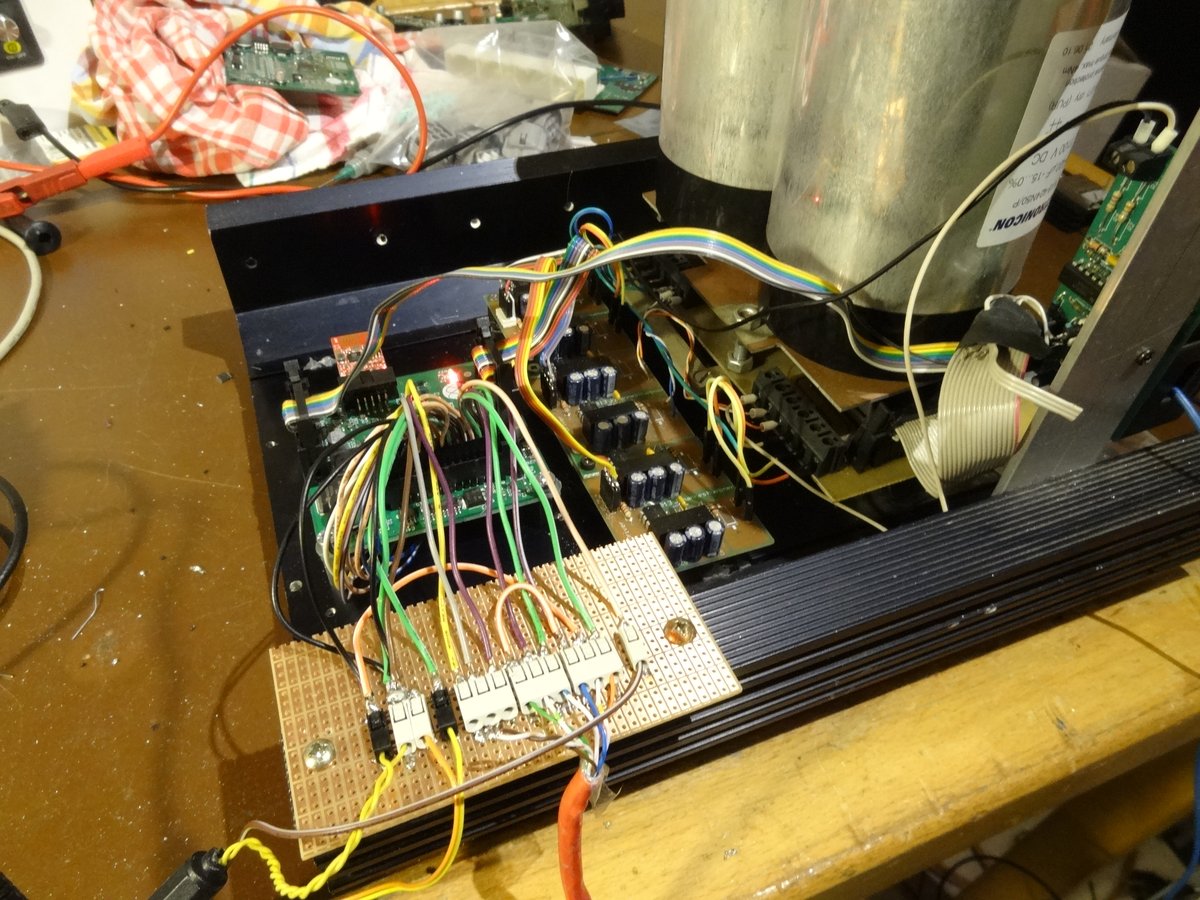

@Johu. I checked your images. I see resolver Sin/Cos grounds (pin 5/6 in Prius pinout) are used as signals and
Sin/Cos ( pin 2/3) you use as grounds (green blue wires are connected together in your board). why?
Been thanked: 1918 times
Re: Audi A2 /w Prius Gen2 Transaxle & Inverter
geduxaz wrote: Fri Feb 04, 2022 11:01 am Nice progress! i have studied all the Audi wiring if you need any help. i have quite a long history with VAG group and Elsa etc.
i use original wiring from four plugs under drivers feet.

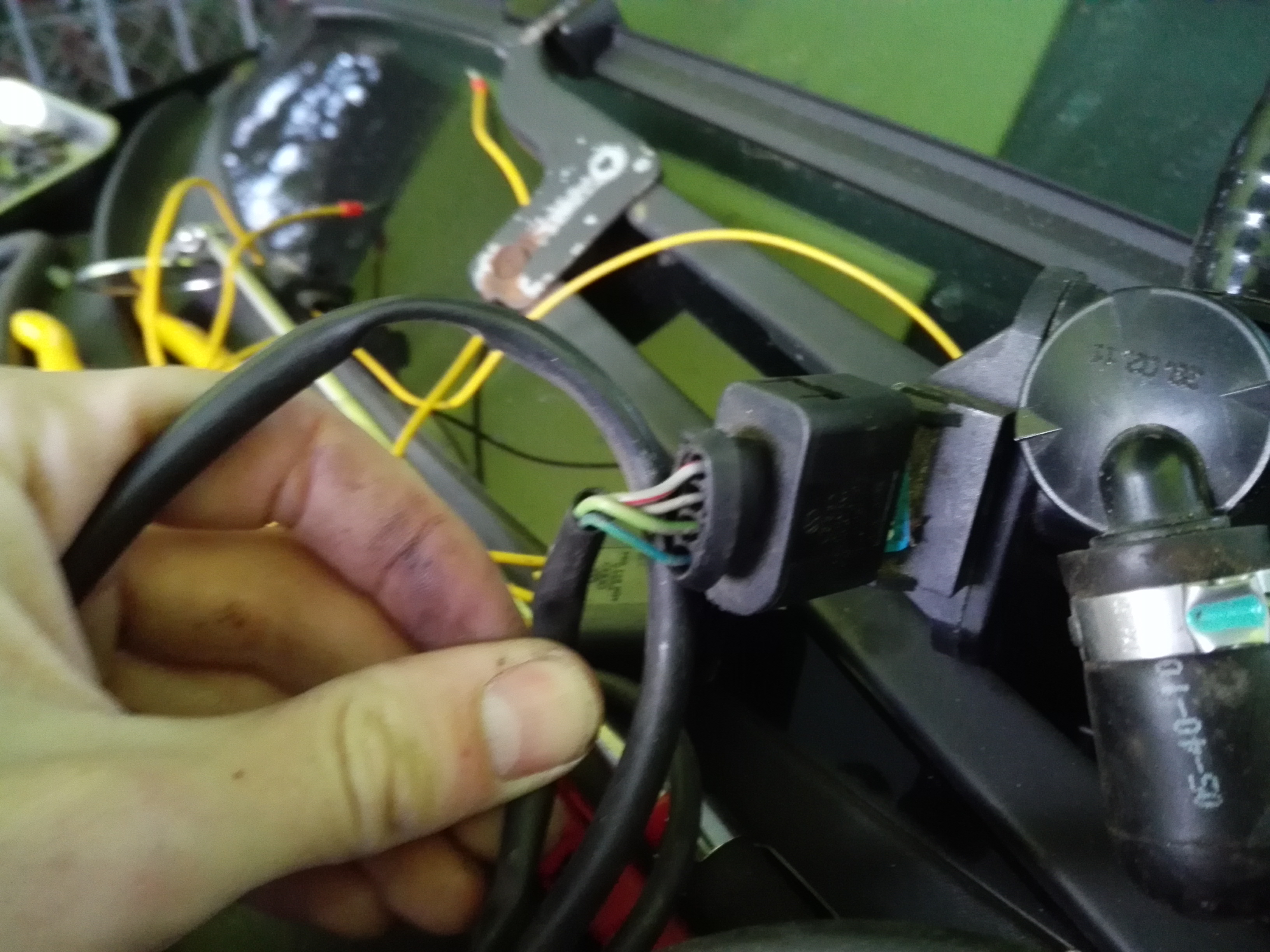

can you identify that one from the image? It's in the motor loom and the only one that has 4 poles. it fits the vacuum sensor so would like to use it for that. Would be good to know where it turns up in the ECU (if at all)
geduxaz wrote: Sat Feb 05, 2022 12:23 pm @Johu. I checked your images. I see resolver Sin/Cos grounds (pin 5/6 in Prius pinout) are used as signals and
you mean I swapped polarity? if so, it wasn't intentional but it doesn't really matter. The supposed grounds are tied to 1.6V and the signals are used unipolar.

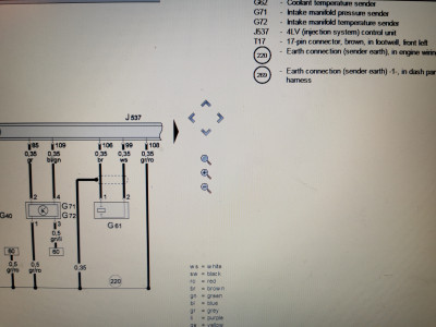

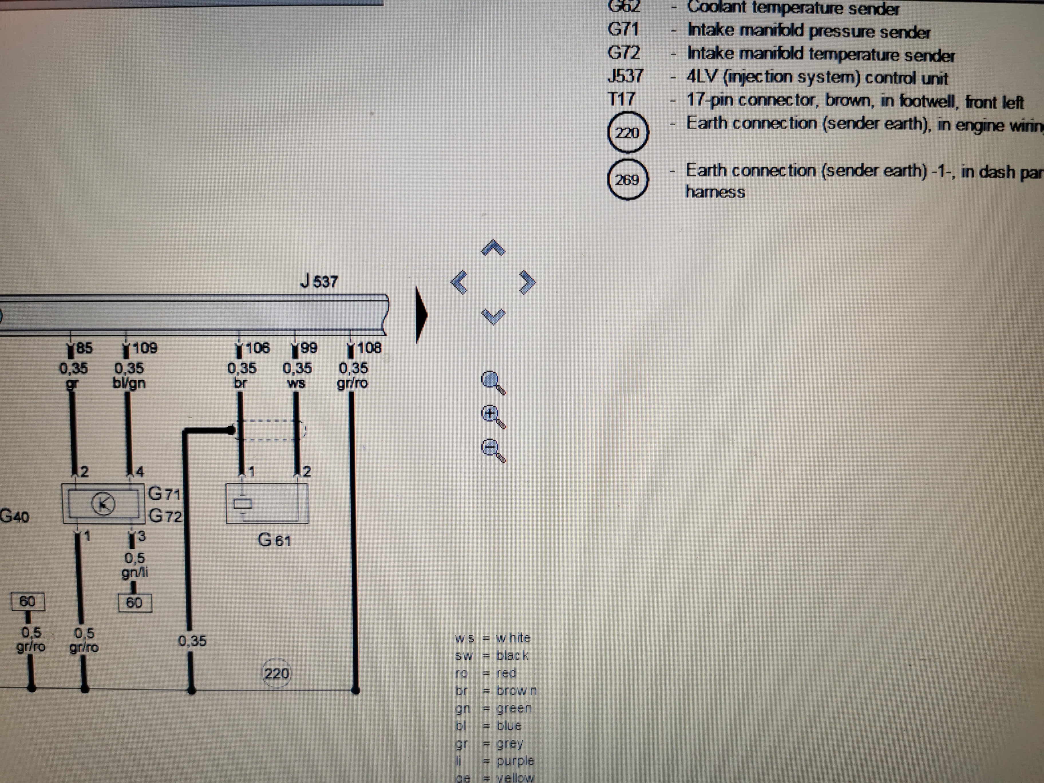

Can you show the sensor itself? Where it was located? If it was in the vaccum pipe- yes it is vaccum sensor.
Mine 1.6FSi had vaccum sensor. On the pipe from engine to brake booster. As FSi use throttle to make more vaccum if it is not enough for brakes.
Yours looks like 1.4i (one coilpack etc) so i think it does not have brake booster vaccum sensor. You might hold a MAP sensor.
In some hours i will reach my laptop with elsa and will make a pdf for your wirring
geduxaz
Posts: 141
Joined: Wed Jun 23, 2021 7:00 am
Location: Lithuania
Has thanked: 13 times
Post by geduxaz »

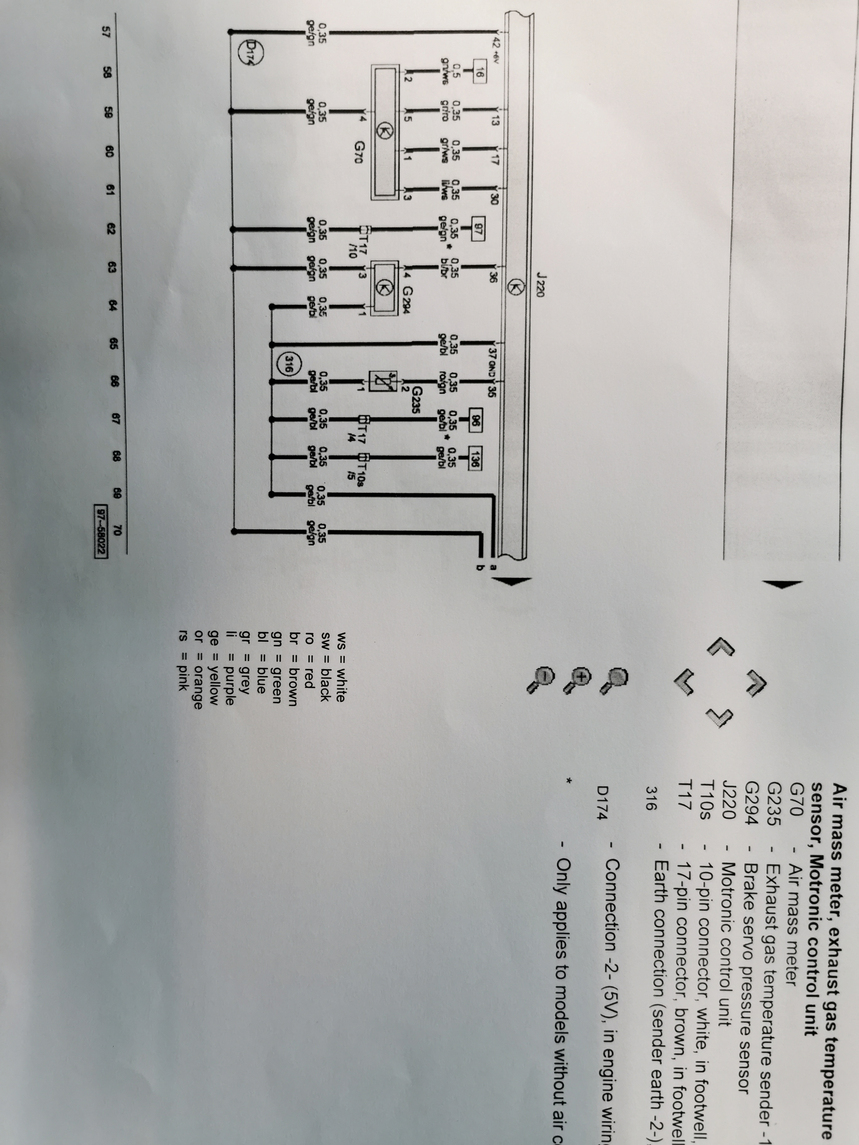

Ok i looked at 1.6fsi wirring i have on hand.
G294 is sensor. But it is 3 wires.
It goes to 36 ECU pin directly.
Posts: 1084

Yours is G71 G72 intake manifold pressure sensor with temperature sensor.
Oh perfect, so there must be that same sensor on the engine. Will check. Although I plan to sell it and it wouldn't be a nice move to raid parts.
