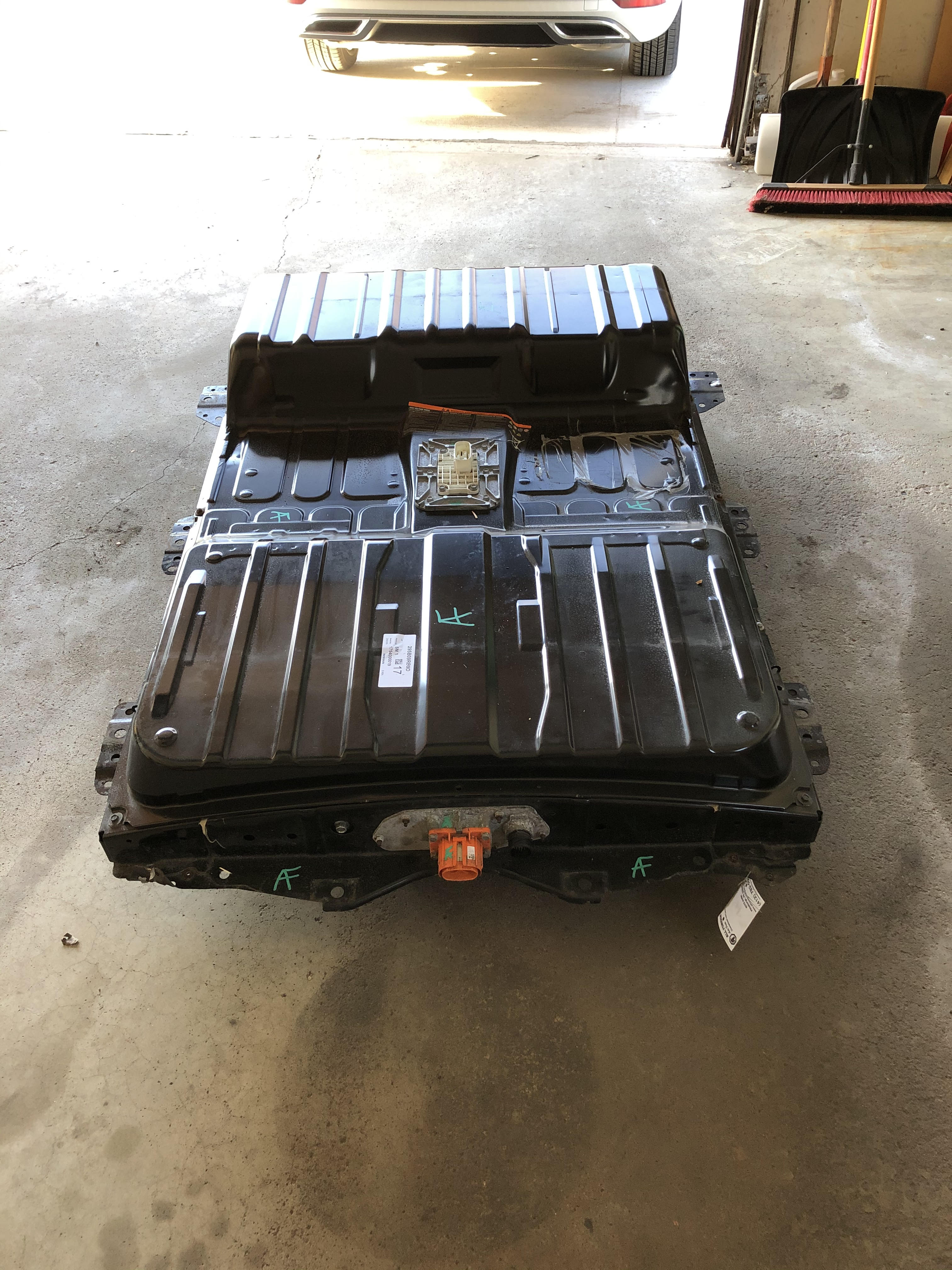

Re: VW Squareback DIY EV
SCORE!
Leaf Pack with Heater on the way
Pack has been shipped, Christmas in April!

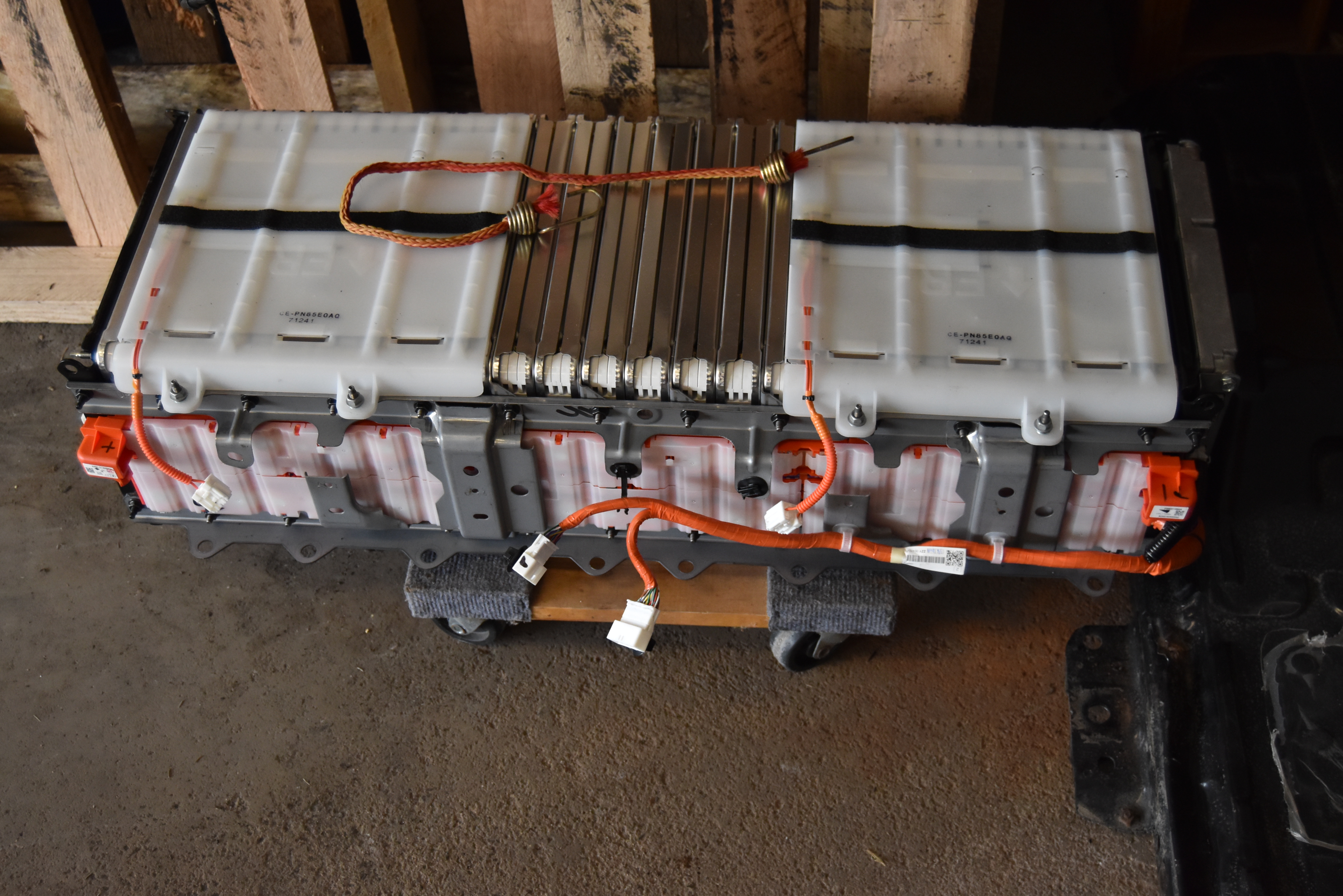

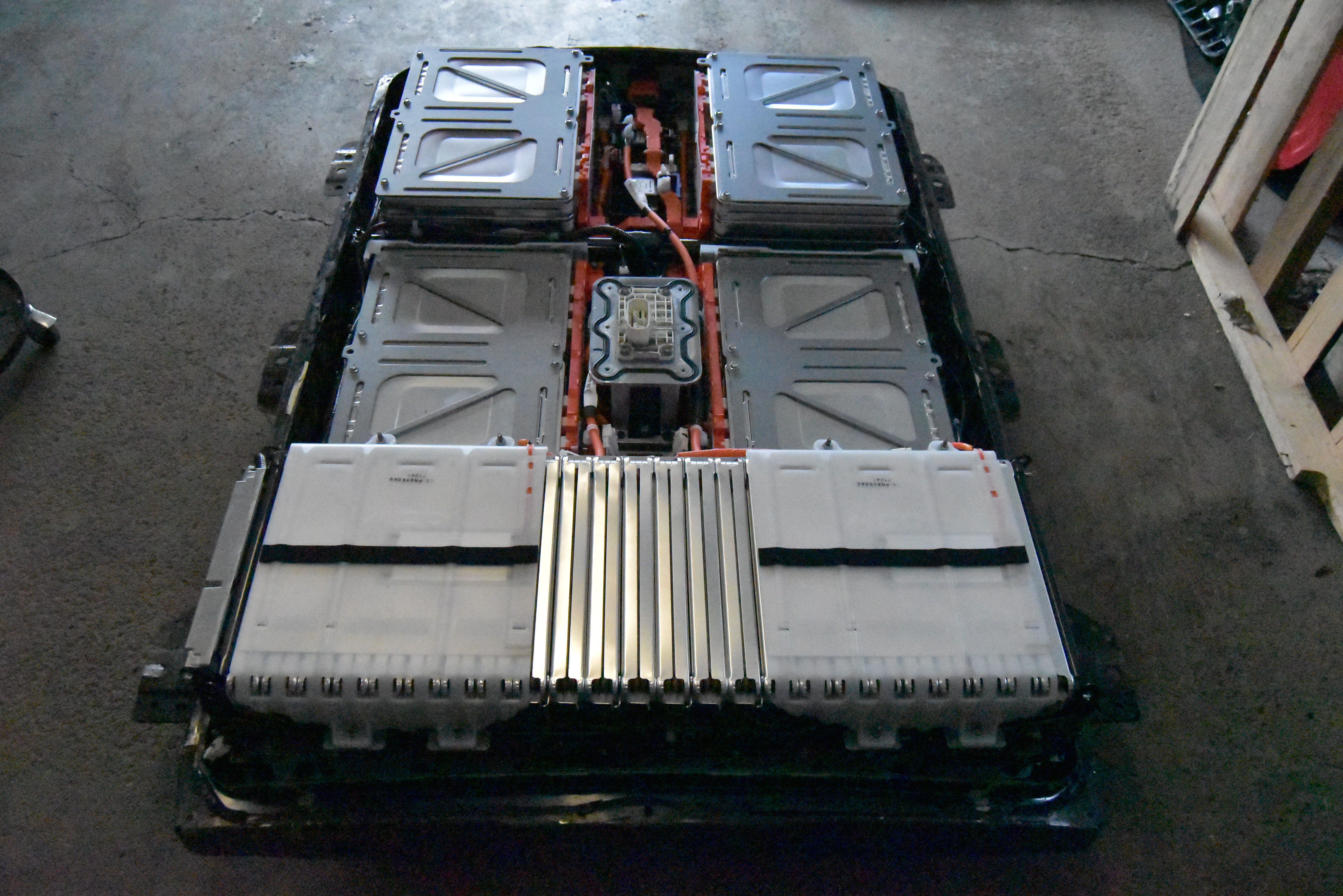

Santa wears Brown in April
Guess what Santa Clause, in his brown summer uniform brought today?
Time for ICE Melt
- Been thanked: 1918 times
Nice, and the connector is not broken. Also interesting to see it doesn't have the auxiliary always on HV output that is normally to the left of the main HV output.
Yup, one small bend on a mounting tab, that is the only damage I found. Did not get the safety switch though, but they are like $40US from the dealer.
So a viewer of my newly posted video noticed this is a replacement pack, dated 2017.
DOUBLE SCORE!!!!
DOUBLE SCORE!!!!

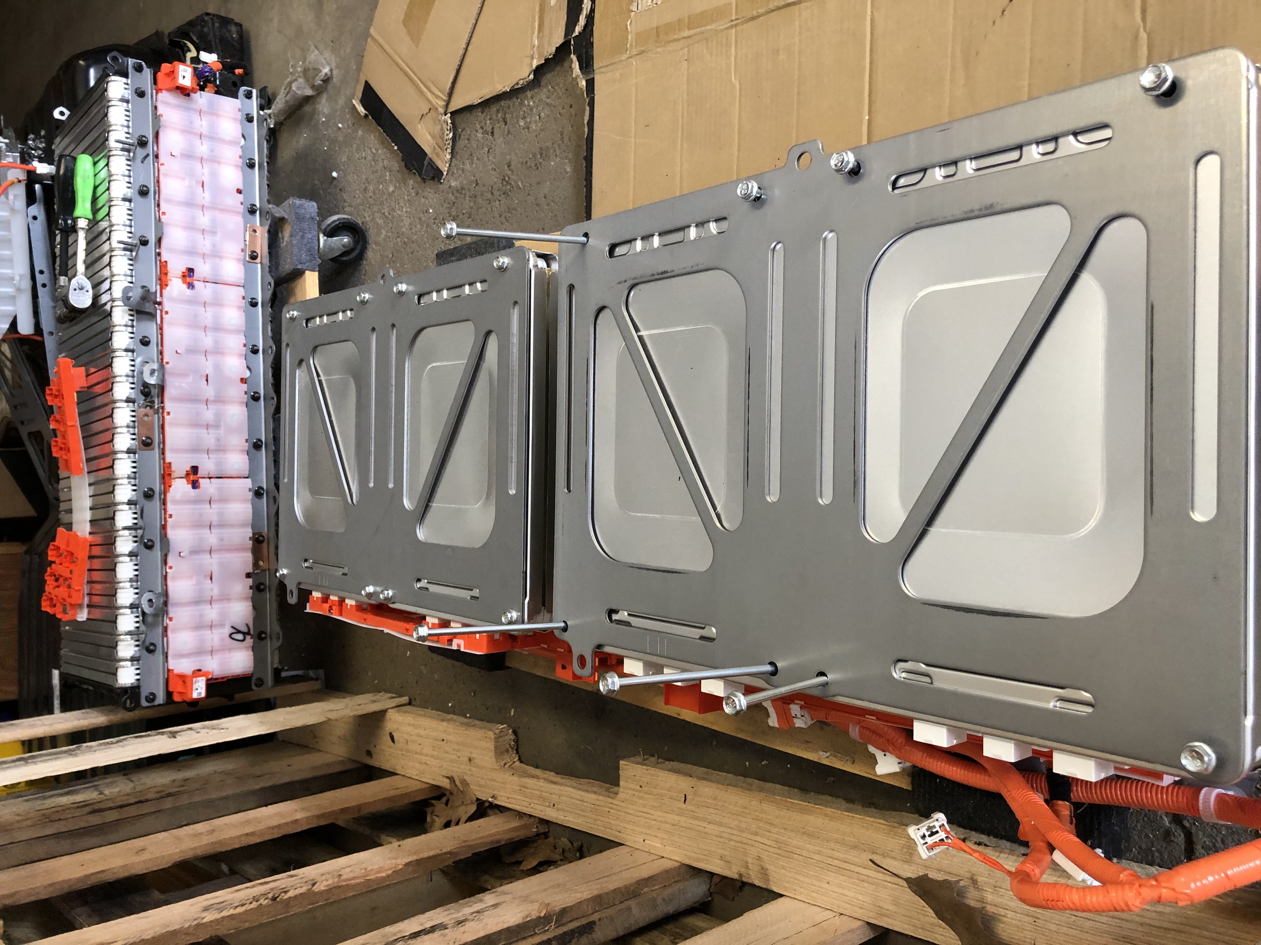

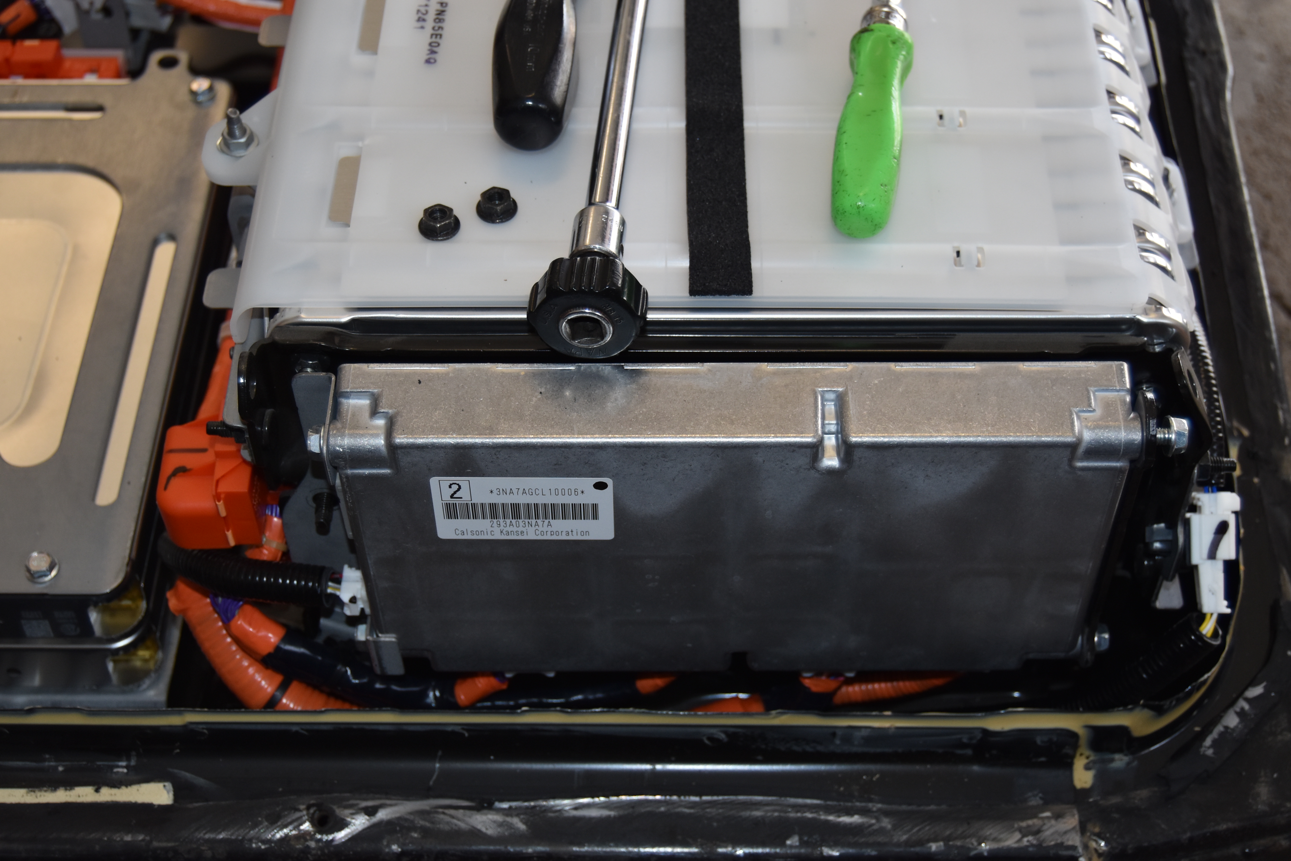

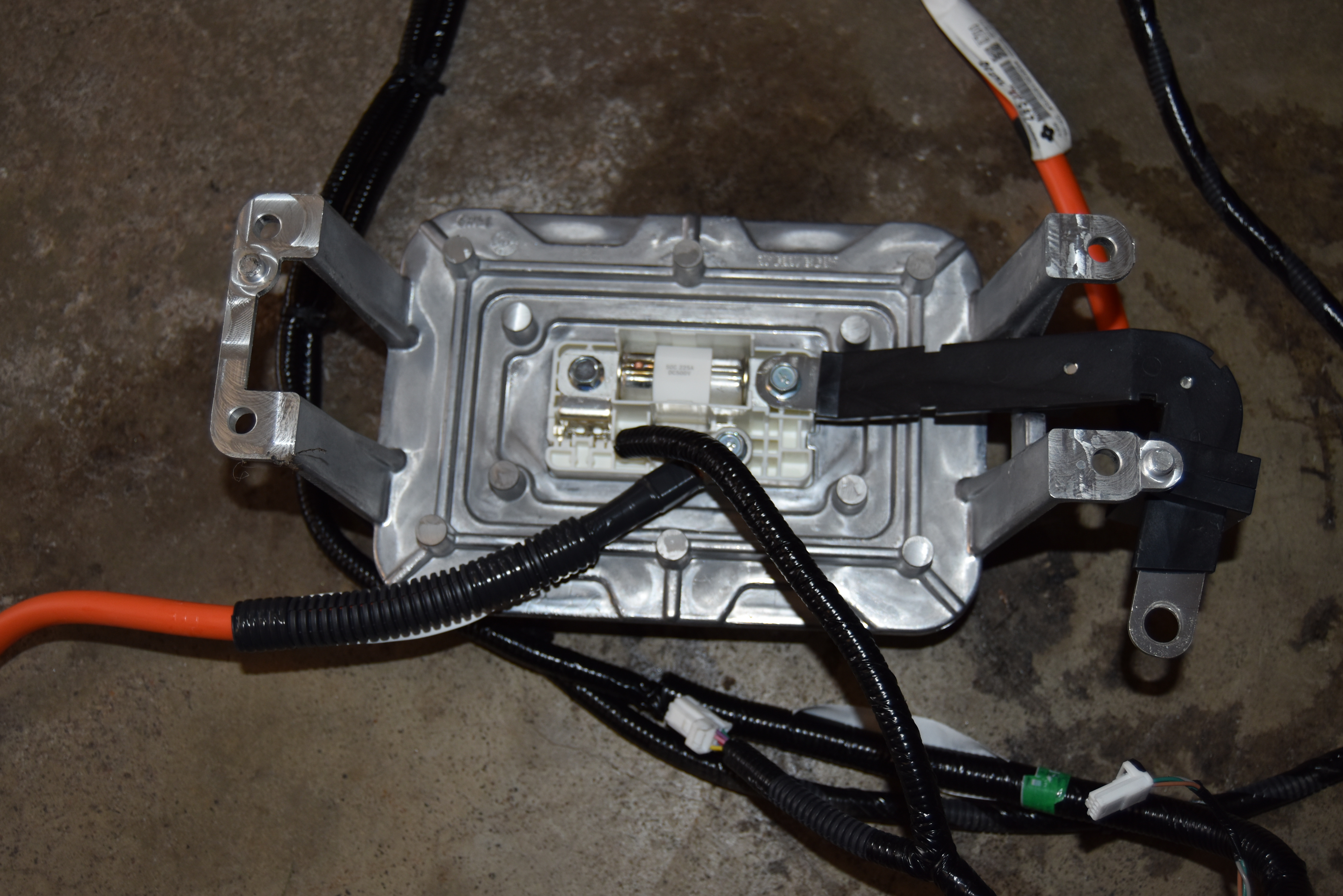

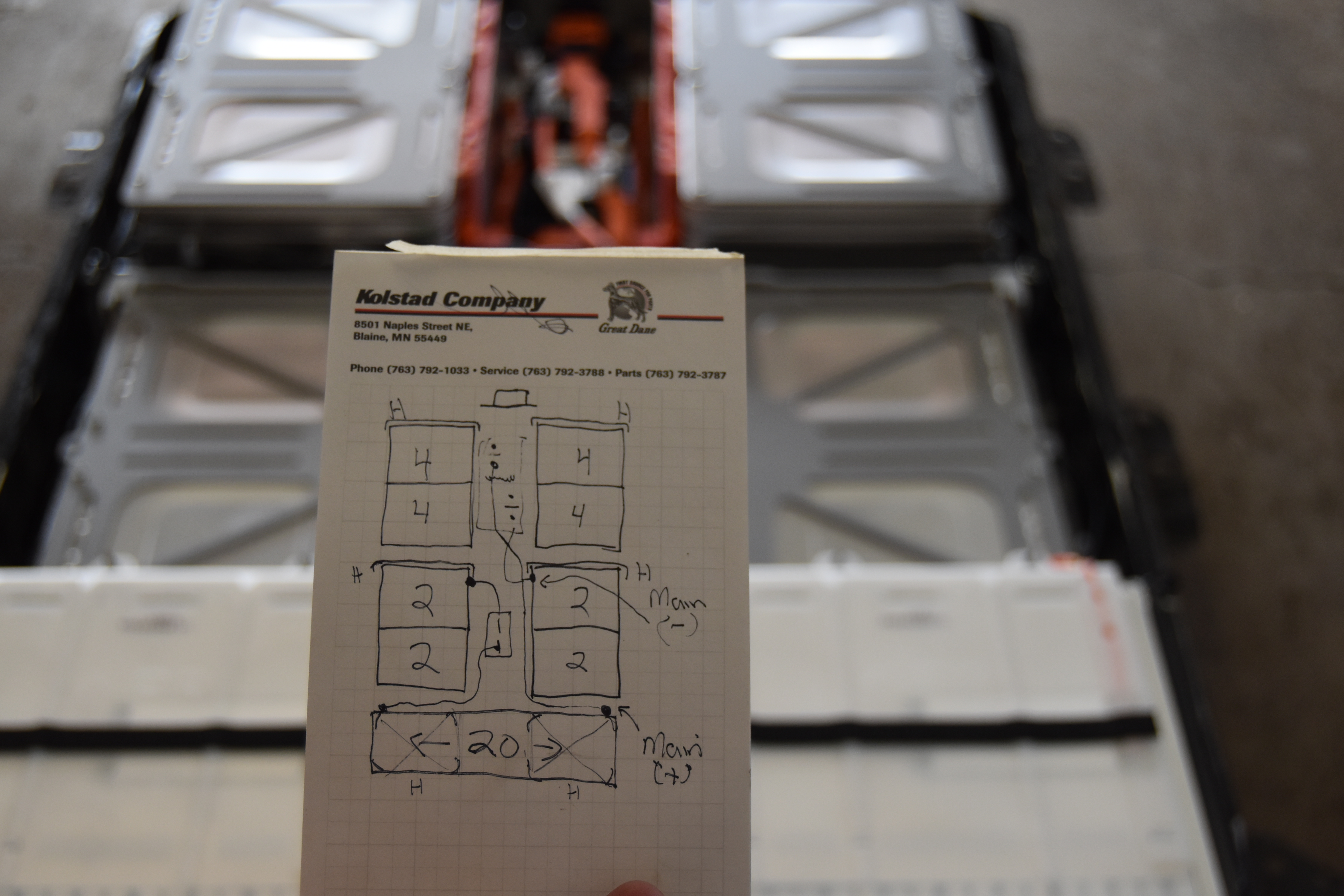

WARNING - Leaf Battery p0rn
Some photos from the day's activities.
What was learned? If you use a DMM and take all due care, nothing scary about it. Dangerous? H#LL YES, but not scary.
<EDIT: Note, on the notepad I wrote 20 modules, the rear stack has 24>
I think I decided to try and fit the 24 module stack in the engine bay and another 16 in the Frunk. This should provide a 320v system and range over 50 miles
You can see how I added two additional modules to each of the middle stacks, to make 16 from 12. 5 modules are sold locally, so now to decide if I will use 2 for the "12v" system or keep it PbNa.
I also plan to re-use the Service Disconnect (presuming a front pack is fitted), mounted in the tunnel ahead of the "shifter". This gives me a manual way to kill the system from the driver's seat.

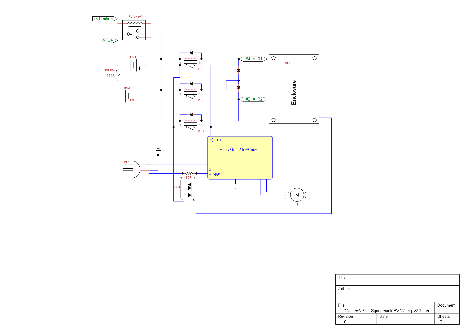

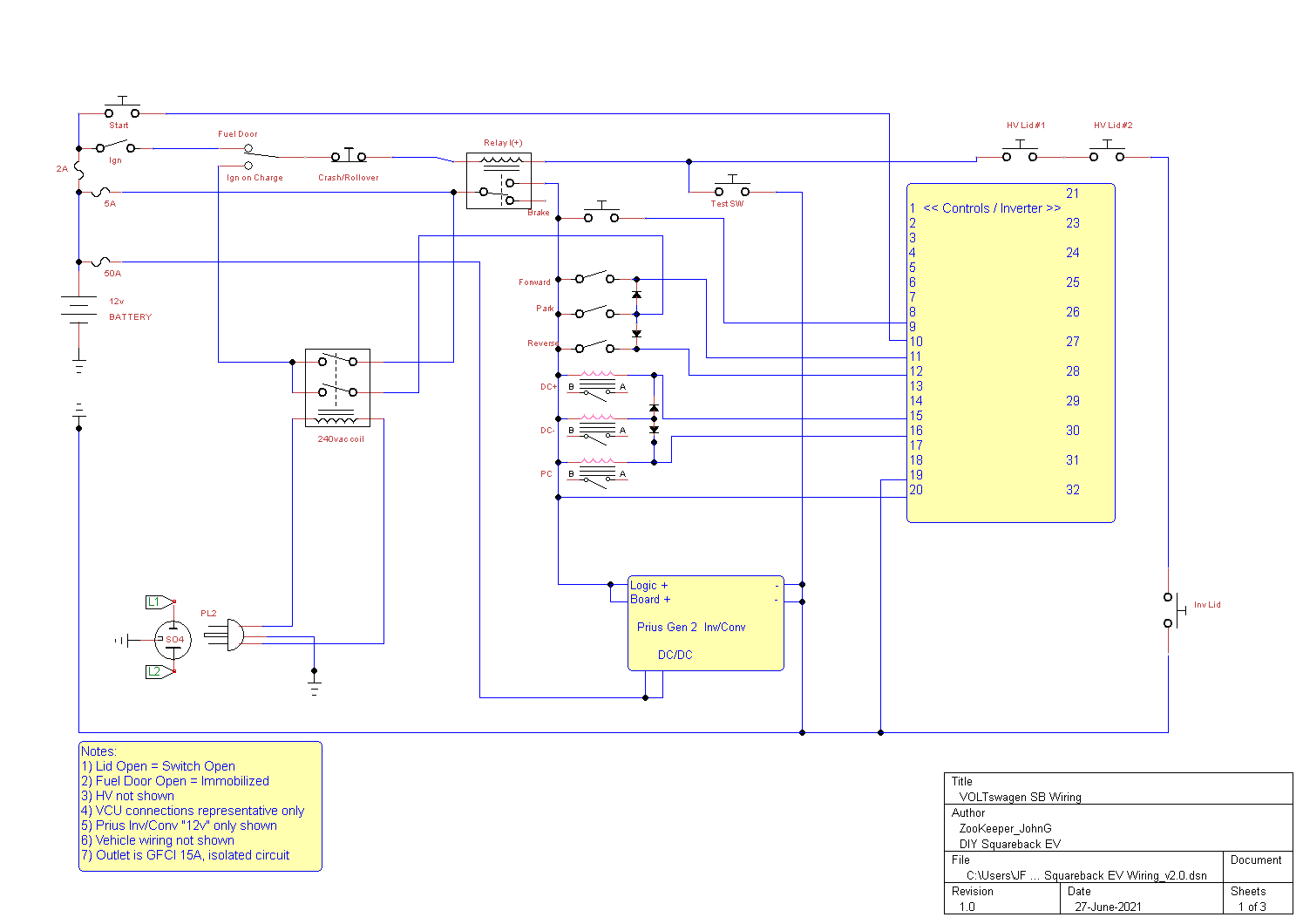

Been working on diagrams since I have no car
This is for the EV unique 12v wiring. Also have the HV Relay control and HV system in the works
Version 1 of the HV Relay wiring plan. I might just use an automotive relay to control the grounds on them to commonize wiring.
