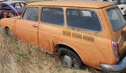

VW Squareback DIY EV
Post by ZooKeeper »
Edit: Photo
Roller :)
Roller :)

Great project :D
ZooKeeper
Posts: 507
Location: USA
Re: VW Squareback DIY EV
Post by ZooKeeper »
Gives me the functionality of an Outback with the coolness of a vintage VW and the satisfaction of "I DID IT!" :D

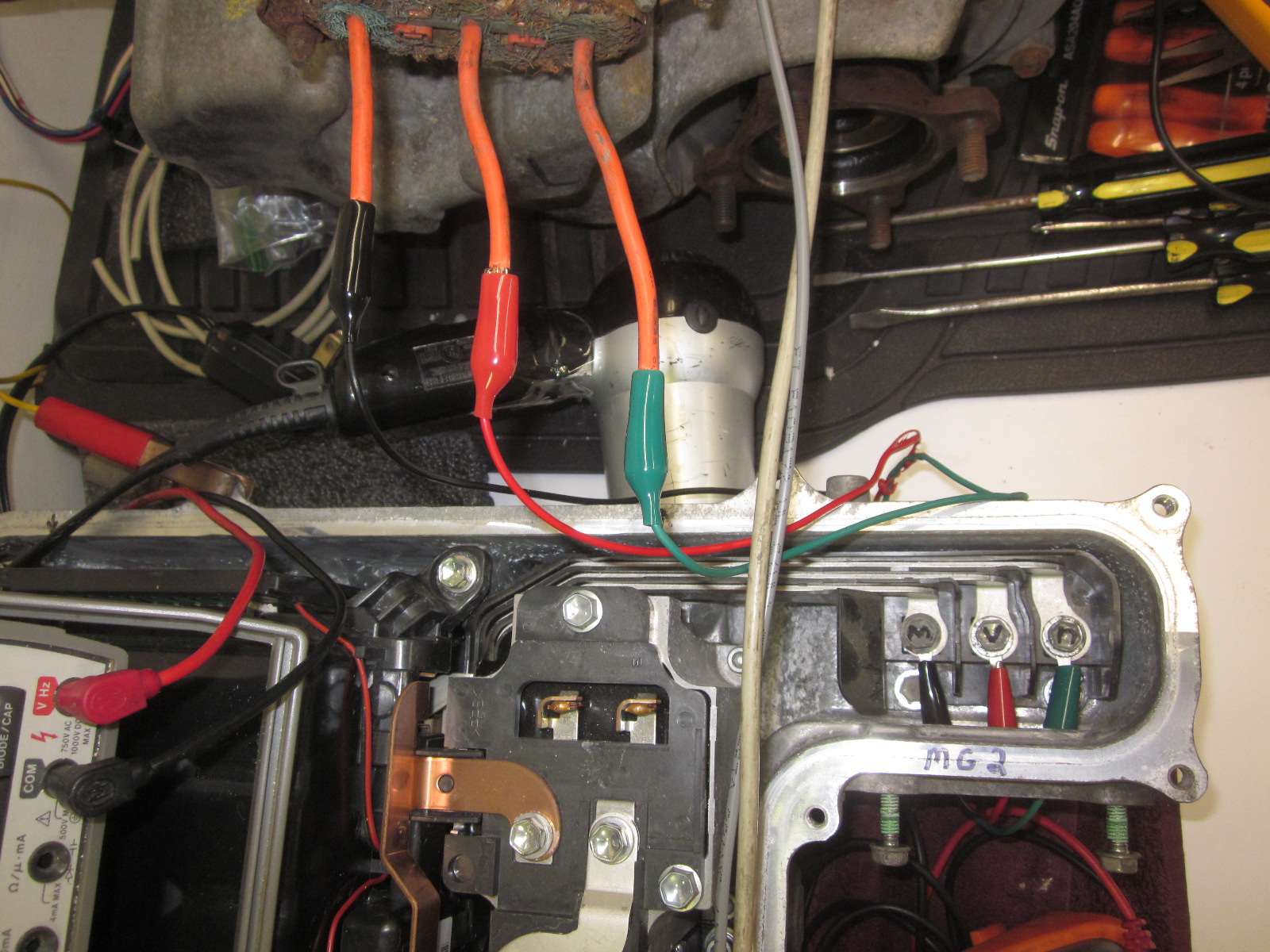

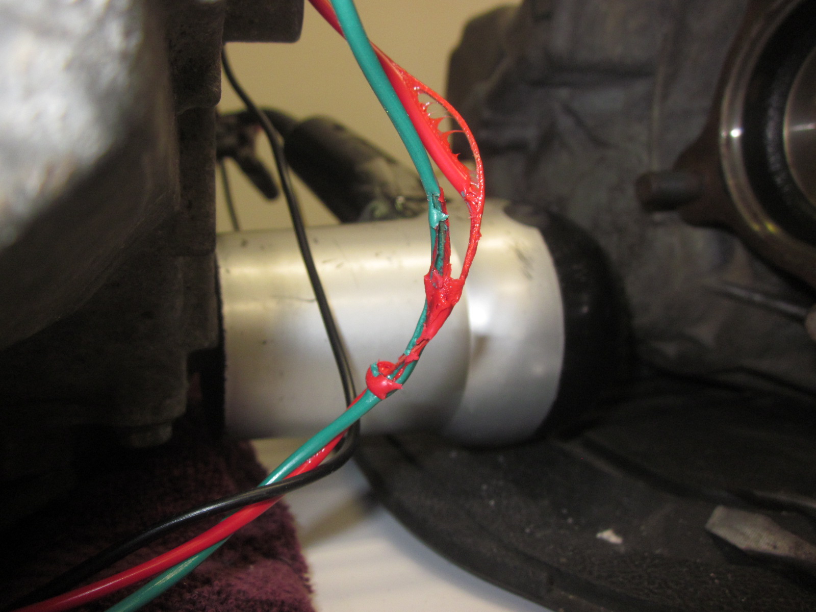

Let the Magic Smoke out :(
Fortunately only the motor jumper wires are affected and have plenty more of them :D
Is my understanding that the Inverter and motor phases are wired the same and that switching the outboard wires will only result in a direction reversal? All my searching suggests that is so, but if anyone knows differently, please do share.

For the MGR you need the FOC software and here it is important how the wiring is. :!:
The inverter must know the position of the rotor in order to control the appropriate coil, so the position and the direction of the resolver (sin, cos) and the phases must match. If the direction of rotation and resolver is correct, you can correct a phase shift with the offset value. In addition, the current direction of the measurement must be correct, otherwise the control will not work either.
Number of pole pairs from the motor should be 4 and 2 for the resolver.

I understood that in "test" mode, the motor should spin smoothly regardless, but I suppose if the incorrect software is used (Sin v FOC), the outputs might not be correct.
