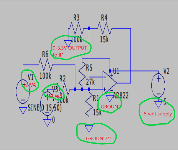

RetroZero wrote: Tue Apr 28, 2020 1:51 pm So V3 PWM outputs are 3.3v.
Main inverter 32 pin (MUU,MVU,MWU) require PWM input signals of 12v. This is where the ULN2003 solves the problem - boosts 3.3v to 12v?
The inverter PWM inputs are pulled high internally to approx. 15V, in which state the lower transistor is turned on. Pulling one of these inputs low turns on the upper transistor. The 'Blue Pill' board used discrete transistors in open collector configuration to pull the inverter PWM inputs low. The ULN2003 is a bank of open collector Darlington transistors.
Then the circuit for dual op amp receives the MG2 (GIVA and GIVB) inputs from inverter (15v p-p), and sends 0 - 3.3v signal to II1
GIVA and GIVB are generator currents, not motor. The A & B channels are copies of each other
You need to use one of MIV(A or B) and one of MIW(A or B); note how the letters, V & W, relate to the phases MVU & MWU.

Thanks for corrections. MG2 = MIVA and MIVB
What I am trying to understand, is the PWM signals. They exit the Inverter and are sent to the V3 board. The inputs cannot be reveived in their original voltages (12v), hence the ULN2003 to convert to 3.3v?

Once again, MIVA and MIVB are duplicate signals.
You need signals from phases V and W, so for simplicity use MIVA and MIWA.
The PWM signals are inputs to the inverter, not outputs.

Thanks everyone - I realise I have been mixing things up...to make things worse.
So PWM pins on adapter board are OUTPUTS of 3.3v that require an amplification to 12v (by ULN2003). Adapterboard to MUU, MVU, MWU for MG2.
At the same time, the Current values INPUTS on adapterboard need to be corrected from 15v p-p(bi-polar) down to 0v - 3.3v.
The current values are connected in parralel, MIVA and MIWA for MG2, via the op-amp circuit before arriving at the adapter board II1
A duplicate is required for MG1 (for charging purposes)
I hope I got it now.

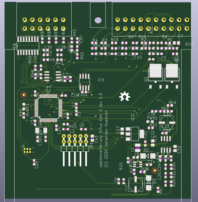

Schematic done, does anyone feel like routing this out in KiCAD?
I've included a footprint for the ModICE connector but I believe there is a better one in KiCAD.
EDIT: I have started layout, therefor removed the Eagle file here.

johu wrote: Tue Apr 28, 2020 5:22 am I would assume +/-600A or +/-15V to be a sensible range. So 30V p-p. FOC doesn't need that good SNR but I agree saturation would probably trigger a current limit.
EDIT: modified your design for roughly +/-15V and two inputs
You know what they say about assumptions! Regarding current sensor noise the engineering teams that designed the Honda IMA, Gen1 Leaf, Volt/Ampera inverters all thought it was important enough to include 3 current sensors in their designs as did the designer of the Lebowski controller.
Cost accountants getting in the way of engineering excellence. Sure we are stuck with 2 current sensors in the Toyota inverters and yes they run just fine. I think it is worth the effort to get the current data going in to the controller as accurate and with highest precision possible and to do that we need to know their maximum rating. Maybe Damien will come to our rescue.
I like the way you eliminated the precision voltage reference on the level shift schematic.

I ain't signin no agreement :P I'll route out the board in Eagle today and/or tomorrow and make it public.

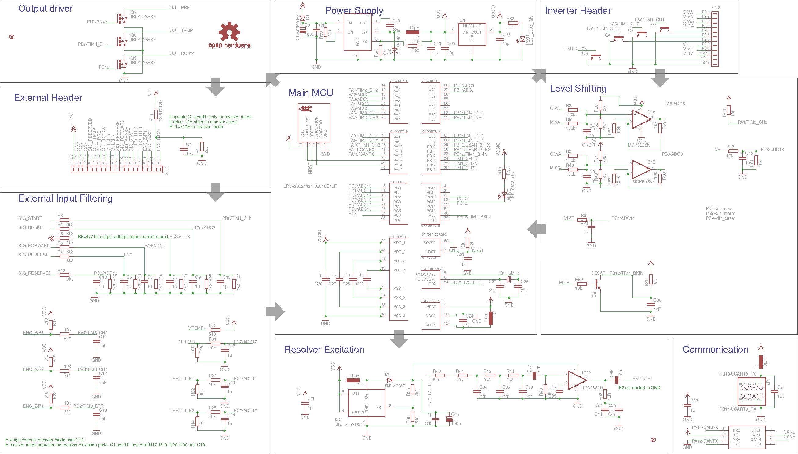

Done :)
Some changes in pin assignment:
  1. GIVA - to level shifter 1
  2. MIVA - another input to level shifter 1
  3. GIWA - to level shifter 2
  4. MIVA - another input to level shifter 2
  5. VH - udc input
  6. MIVT - tmphs input
  7. MFIV - desat input
  8. CPWM - PWM2_N for charging
  9. MUU - PWM1
  10. MVU - PWM2
  11. MWU - PWM3
  12. GINV and GCNV and GND - ground everything here
  1. Encoder channel B/Resolver S3
  2. GND/Resolver center point S1S4
  3. Encoder channel A or single channel input/Resolver S2
  4. Resover excitation R1
  5. Resover excitation R2
  6. 5V output
  7. Throttle Input (0-3.3V)
  8. 2nd Throttle Input (0-3.3V)
  9. Start input (12V)
  10. Brake Input (12V)
  11. Forward (12V)
  12. Reverse (12V)
  13. Motor Temperature Input -
  14. Motor Temperature Input +
  15. DC contactor output
  16. Precharge Output
  17. CANL
  18. CANH
  19. GND
  20. 12V
I use the TDA2822 in bridge mode now, meaning it can do true bipolar output -> Can generate 9V p-p from 5V supply rail. And that means I could remove the boost converter. I also removed the over current comparator since the Prius HW takes care of that. ABZ encoder is no longer supported, don't know of anyone who ever used it.

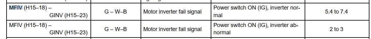

The only unknown is the "MFIV" fault output from the inverter. Don't know yet what it outputs as "good" and "bad". Right now I'm assuming it outputs 12V for bad and 0V for good.

johu wrote: Thu Apr 30, 2020 7:06 pm The only unknown is the "MFIV" fault output from the inverter. Don't know yet what it outputs as "good" and "bad". Right now I'm assuming it outputs 12V for bad and 0V for good.
From the Prius manual...
Been thanked: 1913 times
SciroccoEV wrote: Thu Apr 30, 2020 7:35 pm From the Prius manual...
So it means
normal - 5.4V to 7.4V
abnormal - 2V to 3V
In other word <3V abnormal ?
Not a very nice logic level...

johu wrote: Thu Apr 30, 2020 8:15 pm In other word <3V abnormal ?
I've found that the stated voltages don't necessarily match up with reality on the bench.
Perhaps they do when feeding impedance of the OEM ECU.

Easy, easy :) will get some made at JLC and test them, then will publish the design.

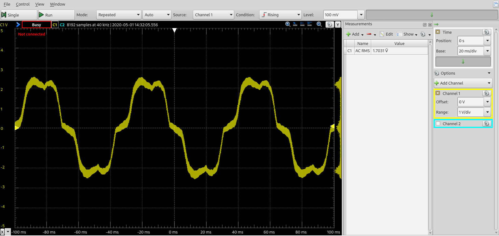

Did a little testing on my inverter, with just 24V DC voltage. So 25mV per A of phase current is confirmed - measured 64A RMS with the clamp meter and getting 1.7V RMS on the sensor output. You can see it's not quite sinusoidal, I think thats because the inverter behaves weird at low sine amplitudes. Still hoping higher voltages to mitigate this.
MFIV signal is 7.2V indeed but I couldn't provoke over current with my worn out lead batteries ;)
