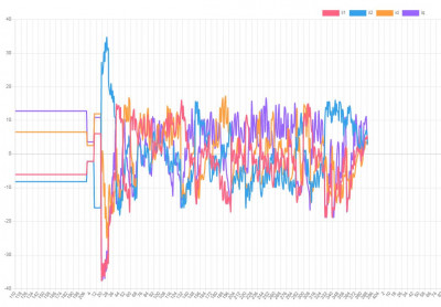

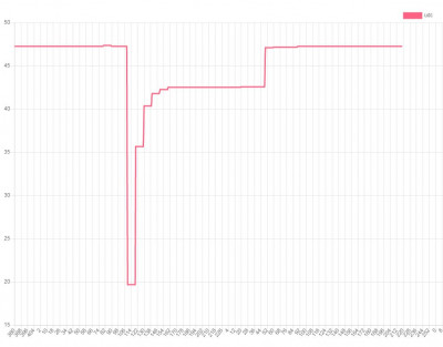

It turns out that upon startup into manual mode, the inverter always stops at over current if I do not have series resistance in the supply.
I used 3.3 Ohm, because this was the lowest value that my electronics load worked with without going into overload fault on startup.
I really hope that this kind of glitch at startup is only a feature of the manual mode and normal run mode ramps up the PWM smoothly.

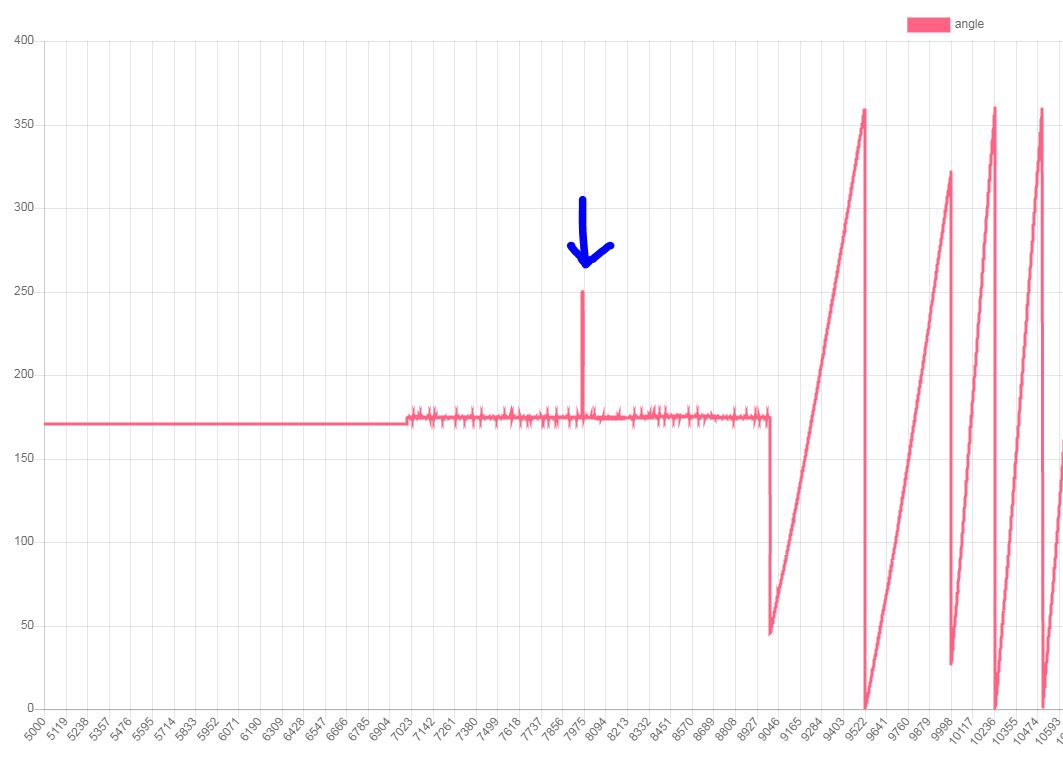

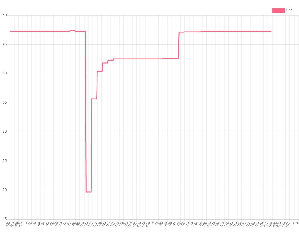

Here is some pictures of what is happening after syncofs tuning and id=0.1A and iq=1A:
This first picture shows the motor angle feedback. The blue arrow points the glitch, when the inverter would go into current limit fault without the series resistance. This second picture shows the UDC voltage. The large dip down to 20VDC is due to the glitch, after which the voltage gradually ramps up. With the second attempt to start, the motor starts to spin smoothly and the UDC settles around 43VDC as there is a voltage drop over the series resistance.
The stepping up of UDC voltage in the end is due to me by passing the series resistor with a high current main switch. This third picture shows the currents i_L1, i_L2, id and iq. I do not know how these should look like. The glitch is not so evident here, but apparently the phase currents would exceed 100A without the series resistance. The ramping down of the currents are in line with the UDC voltage behavior. I am wondering if the id and iq currents are okay. They seem not to be regulated to the set values of id=0.1A and iq=1A. Anyway, once the motor starts, it runs very smoothly even though the currents seem to be all over the place... I thought I'd try normal run mode next and see if the motor starts smooth without the initial glitch and a high current peak.

Not sure what causes the glitch. Currents will be pretty random at such low values because the current sensors are too coarse.

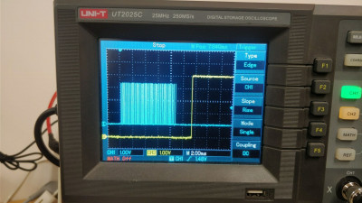

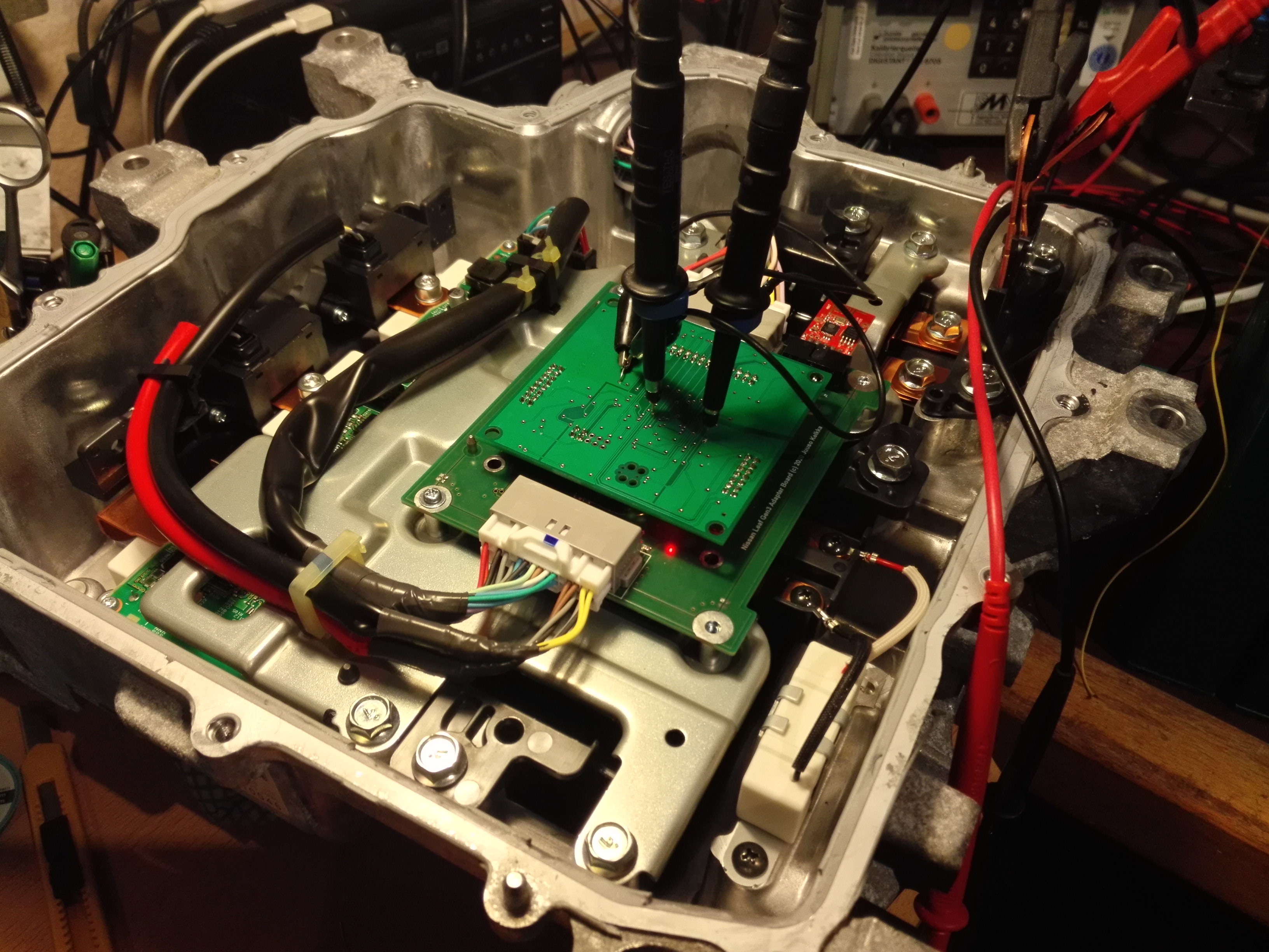

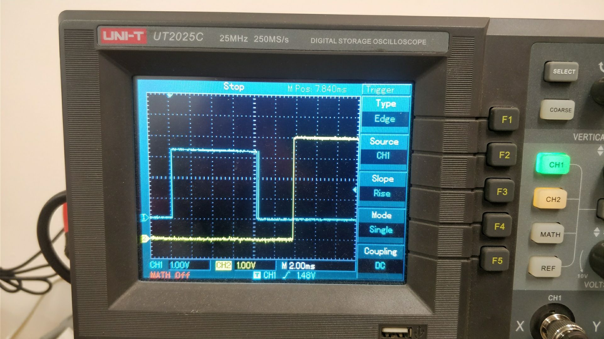

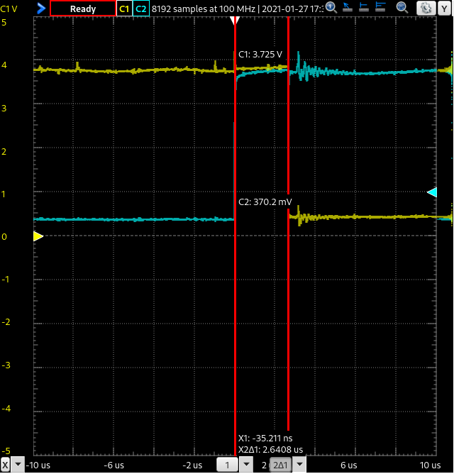

As it turns out, I have not gotten around to check the code.
I did, however, make a small program on an Arduino board.
The target was to blank the glitch.
There is a separate pin on the IGBT board for 5V supply to the input diode pullup. In my blanking test setup, this supply is initially off. The Arduino board triggers an interrupt upon rising edge of phase 1 high side drive. After this, a delay timer is set and once it expires, the 5V supply to the diode pullup is turned on. There is also another timer that switches the output off again, if no new pulses are detected fast enough. This is to secure that the 5V is off to account for another start attemp and keeps it on if the motor is running.
Apparently this arrangement work whenever the PWM happens to start with Phase 1 and the motor starts relatively smooth. Whenever it starts from some other phase, the glitch happens.
I should trigger an interrupt from all three phases to check how that works.
Here are some pictures of the glitch in blue and delayed 5V in yellow. Especially the first capture is quite strange. Definitely no soft start with that lenght of pulse.

Reminds me of an ancient bug in active low mode, where during initialization of the timer all 6 pins went low (=on). But that is long fixed.
Is it only in manual mode? What if you set direction neutral, then manual mode, then direction forward?

I also modified the extra board to trigger an interrupt for all phases, but the glitch remains in manual mode.
I think I can drop the extra board, since it does not seem to help anyway and at least I can start the motor now in manual mode without the glitch with the new instruction.

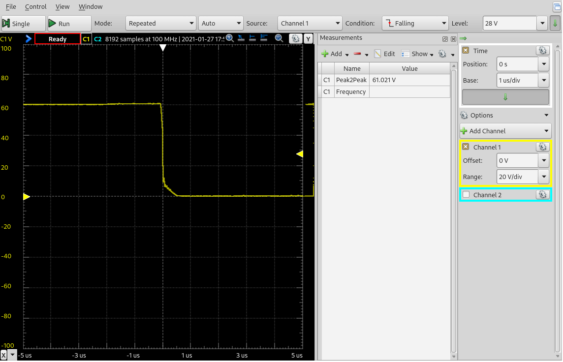

Inverter arrived today. I was charged customs even though it was a gift. Thanks Brexiteers.
First challenge was to get it running from the board Kelju had sent. I thought the inverter chip was broken because all outputs were 0 when the inputs were also 0. Anyway, I removed it and bridged inputs to outputs, then set control board to active low mode. Which didn't work either. Then I found that the original control board outputs 5V on two pins where there was no 5V on the adapter board. So simply added a wire. Now the drivers came alive and sat at 5V. And 3.8V with the control board connected. I'll never understand the concept of those "5V tolerant" pins.
So, some first observations, I think they match with Keljus. When run with the same parameters as the Gen2 inverter (deadtime 78, pwmfrq 8.8) it pulls an insane 2.5A from my 60V power supply. Also the output waveform looks unhealthy. Also tried 128 where idle current is 400mA but the output still rings.
At 255 deadtime (15us) it still pulls 100mA so I'm thinking that is not shoot through but some other gate drive draw or something. The shortest dead time that still yield 100mA draw is 160 or 2.6 us. The output looks good also. At that sort of slow switching I wonder if the inverter better be run at 4.4 kHz. At 8.8 kHz we are loosing almost 5% amplitude to deadtime.
At 4.4 kHz the total draw from 12V is 0.75A, at 8.8 kHz 1 A and at 17.6 kHz 1.8A. Also the driver chips start evaporating their conformal coating, so thats definitely too much
Also 4.4 kHz is much quieter than at 8.8 which is unusual.
Next up is actually running a motor.
