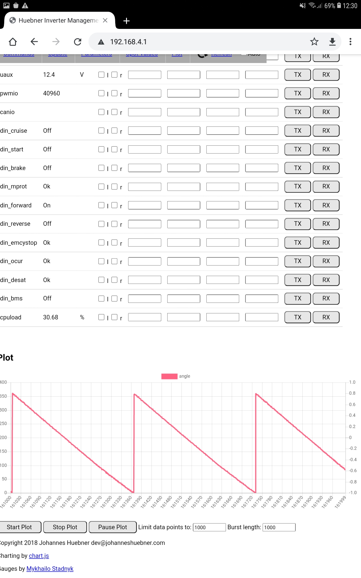

It's been a while since I've been able to make eye contact with my project, but I'm now taking three months off work for other reasons and I'm determined to have something to show for it. Inspiring to see the first Prius Gen 2 projects rolling (well done RetroZero, Golf looks class!)
A couple of days ago I assembled a circuit with 12v - OI VCU - Gen2 inverter - 12v as "High Voltage" - lightbulb delta and went through the procedure:
- Switched the inverter on in Manual Mode
- Set fslipspnt to 1
- Set Ampnom to 75%
- Set boost to 20,000
AND THEN THERE WAS LIGHT.
It worked just as it said on the forum. Lights flicked on and off, and I could adjust the frequency by changing fslipspnt.
Buoyed by this milestone, I dashed off to collect the hefty Siemens 1PV5135 from storage.
I wired this up in place of the delta and swapped the 12v HV for ~ 96volts applied with a 60 watt bulb in series.
As I played around with fslipsnt, ampnom, and boost I could see the lightbulb draw current and illuminate, but the motor wouldn't spin.
I may have just been using the wrong motor parameters (base parameters copied below), but before I could figure it out I got a DESAT error, and MPROT status. Today I checked wiring and could turn the inverter on and off successfully, but after a few moments the DESAT error would crop up again and end the fun, even without any high voltage connected at all.
My fear is I may have damaged the inverter by setting too high a boost with the larger test pack.
My hope is that a brighter mind out there can help me "reset", get passed the DESAT, and figure out what's stopping the Siemens from spinning.
Thanks in advance, feels good to be picking this up again.

I doubt it's that easy to kill a Prius inverter. Is your 12V that you supply to the Prius power stage (not the control board) connected correctly and stable? What's the voltage level of MFIV?

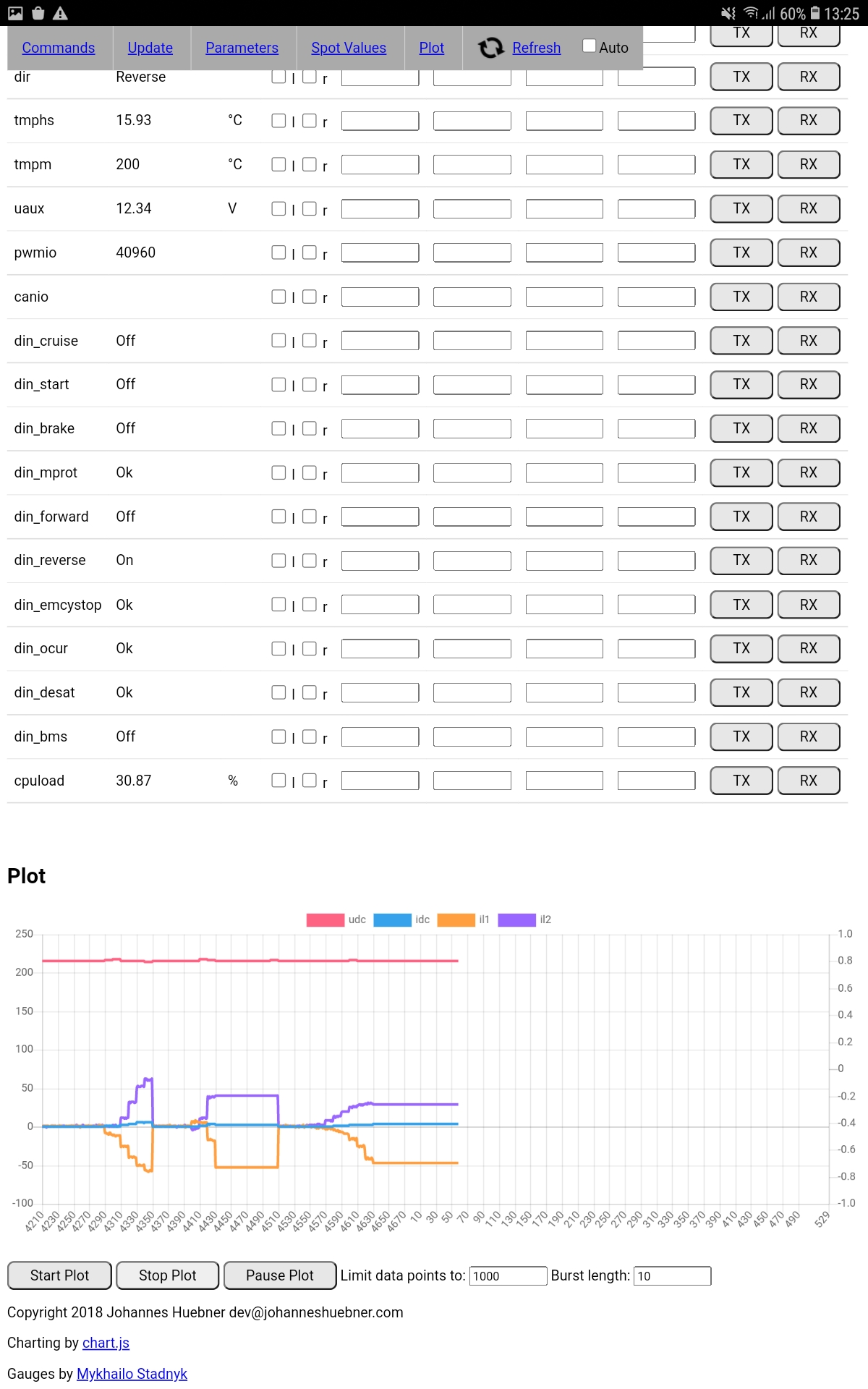

Thanks Johu!
Some head scratching and rewiring, then realised my 12volt battery had dropped to 6volts!
I swapped it out for a spare, and I got the lightbulb delta working again. All error messages gone.
I'm still doing something wrong when connecting the motor though, as I can't get it to spin in manual mode.
- I'm using 4.97RSine software
- I connected with 100v pack and a 60w bulb. As I changed the motor and manual run settings the bulb would light, but not a stir from the motor
- I found a set of parameter that Damian used when first tuning the Land Yacht with the Siemens and the Prius Gen 3, and copied the motor parameters across (attached below).
- I used a clamp meter on the phase wires, and all of them were getting ~equal ac
- I can hear the inverter whine changing pitch as I change the settings
Are there any points in particular I should be looking to measure voltage or current?
As well as the three phases, there is a ground terminal for the motor that I haven't connected to anything. Could this be something?

More boost!
The Gen2 inverter kills off phase current below a certain PWM swing. Very annoying.

Thanks Johu! Got it spinning today!
I had to cut the 60watt bulb out of the circuit after precharge for it to work.
Also managed to blow my lightbulb delta and melt my phase wires along the way (they were a bad choice), but that's a side note.
It works though! Chuffed to finally get this bit working.

Setup: Prius Gen2 Inverter+ Gen2 MG2. 5,14 FOC. 215V pack.
Was able to move like 50 meters (used 100V) and started to redo all wiring, move VCU inside etc.
Car spins the wheels in air, but on ground get Overcurrent error after getting some throttle. Checked all wiring many times. Resolver wires etc.
Tried 4,96/4,97 now 5,14
what have checked:
Pinsswap is set to 5, resolver exciter gives sinusoid, but gets little distorted when connected to resolver. Read Sin/Cos sinusoids (on oscilloscope) when turning motor by hand that are getting smaller/higher amplitudes.
1. What parameters are measured to get into Overcurrent? Idc looks like not moving too much.
2. i cant get good Syncofs that car would move forward and backwards. It goes either forward or backwards.
3. Strange feelin about VCU. it looks like if I set plotting some parameters at first try car moves better.
4. Just guessing if VCU can have other parameters left in flash that are used, but not displayed? that can get damaged during FW update/downgrade?
5. When inverter started (no HV) and reading angle data i get some free spin and soon motor starts resisting the spin.
6. I use pot1, pot2 unused- not connected. i see pot2 value rising a little bit when pressing pot1. Is that normal? pot2min-0 pot2max-0
Looking for Gen2 Inverter + Gen2 MG2 working parameter set to compare the values.
what have checked:

I assume you have checked out Damian and Johu's video. There's parameters linked in that video which are a good start from Damiens bench tests. I managed 500 meters on 180v prius battery before it stopped. Probably a mix of not charged enough and no cooling plumbed in yet. Good luck
- geduxaz
- Posts: 141
- Joined: Wed Jun 23, 2021 7:00 am
- Location: Lithuania
- Has thanked: 13 times
Checked almost every Johu youtube video and didnt find any parameters.RetroZero wrote: ↑Mon Jan 17, 2022 1:29 pm I assume you have checked out Damian and Johu's video. There's parameters linked in that video which are a good start from Damiens bench tests. I managed 500 meters on 180v prius battery before it stopped. Probably a mix of not charged enough and no cooling plumbed in yet. Good luck![]()
Will check Damian, but there is quite a number of videos. Thought it will be faster to find working parameter set here.

Thanks!
From PinSwap 4 I believe it is not Gen2 inverter.
Can someone confirm that all Gen2 MG2 have same resolver SyncOfs? I believe this offset is preset in factory and if found can be used for all MG2 resolvers?
- Been thanked: 1918 times
Correct, gen2 inverter needs pinswap 7.
I haven't found final syncofs for MG2 yet.
RetroZero
- Posts: 947
- Location: France
- Has thanked: 645 times
- Been thanked: 64 times
Going by Damiens and Johu's video @ 1.17h, SyncOfs @ 10200 is a good start. You can fine tune from there, but should get you rolling. The pinswap obviously has changed with the updates since the video. I will post my parameters on return at the week-end.
