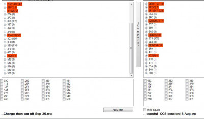

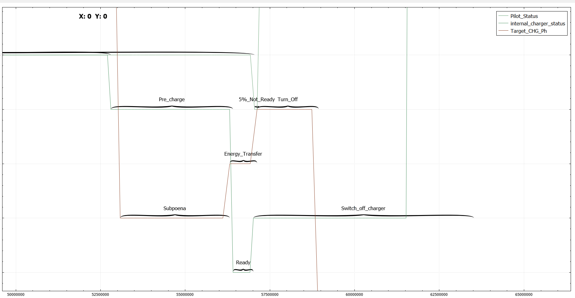

Had strange issue where the whole starting of charging commences normally and then once we are in the energy transfer section it get shutdown immediately.
Here is the log file: https://github.com/Tom-evnut/BMWI3_LIM_ ... p%2030.trc
If anyone can please cast a second pair of eyes at this log to see if I am missing something. I have not found any fault flags being thrown, wondering if it just is a dodgy ccs charger or an upset one.

Got another charger session having the same behaviour, must be that the LIM is sending something strange to the charger or that it is stopping it.

Here is a log where it allows a short charging session before it interrupts.
I have compared all failed logs to the working successful log and the only differences are the countdown timers as the successful charge is longer.
The SOC, the failing ones are all below 40% SOC where the Successful one is just above 40%.
The successful charge session log
https://github.com/Tom-evnut/BMWI3_LIM_ ... %20Aug.trc
Bit of more background, after the successful charging log the vehicle was used frequently and fast charged frequently. It however suffered from a drained 12V battery and since does not really want to take dc fast charge as these logs show.

If I have a moment this weekend I might load the logs in my toolbox and compare. Maybe something show up. What was changed to counter the 12Volt battery dead thing?
Is this charging canbus isolated from the rest?
Posts: 2420
Location: Bristol
Has thanked: 209 times
Been thanked: 577 times
EV_Builder wrote: Fri Sep 30, 2022 7:46 pm If I have a moment this weekend I might load the logs in my toolbox and compare. Maybe something show up. What was changed to counter the 12Volt battery dead thing?
I do not know why the 12V died, I am not with the car.
Yes dedicated bus between my can bridge and the Lim. It would be good if you could lend your expertise.

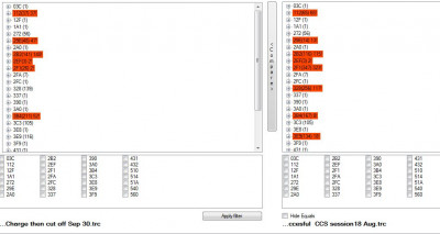

Post by EV_Builder »
tom91 wrote: Fri Sep 30, 2022 7:57 pm It would be good if you could lend your expertise.
See attachments.
Now the ! count means that in that message there where unique messages in comparison to the other side.
Now if you tell me what's important, or you check your owns logs i can expand that tree and you can figure the byte level differences.
(I realize i should add one day the DBC translation.. never short of ideas...)
At least you can cleanup on what's equal quite allot now.
