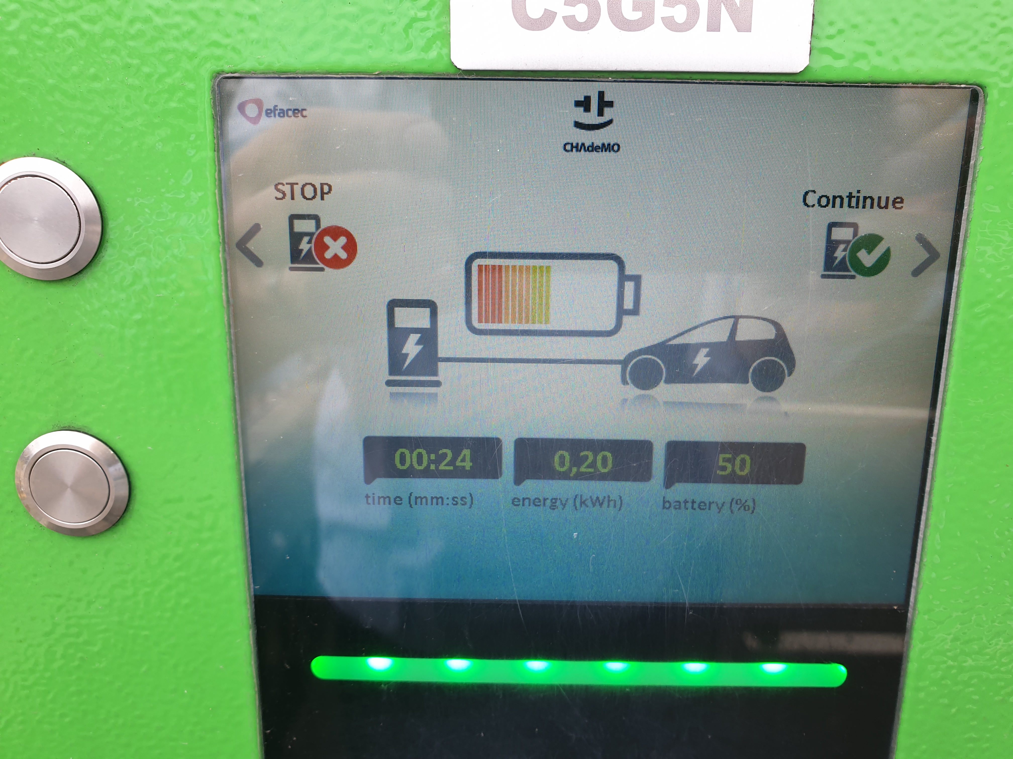

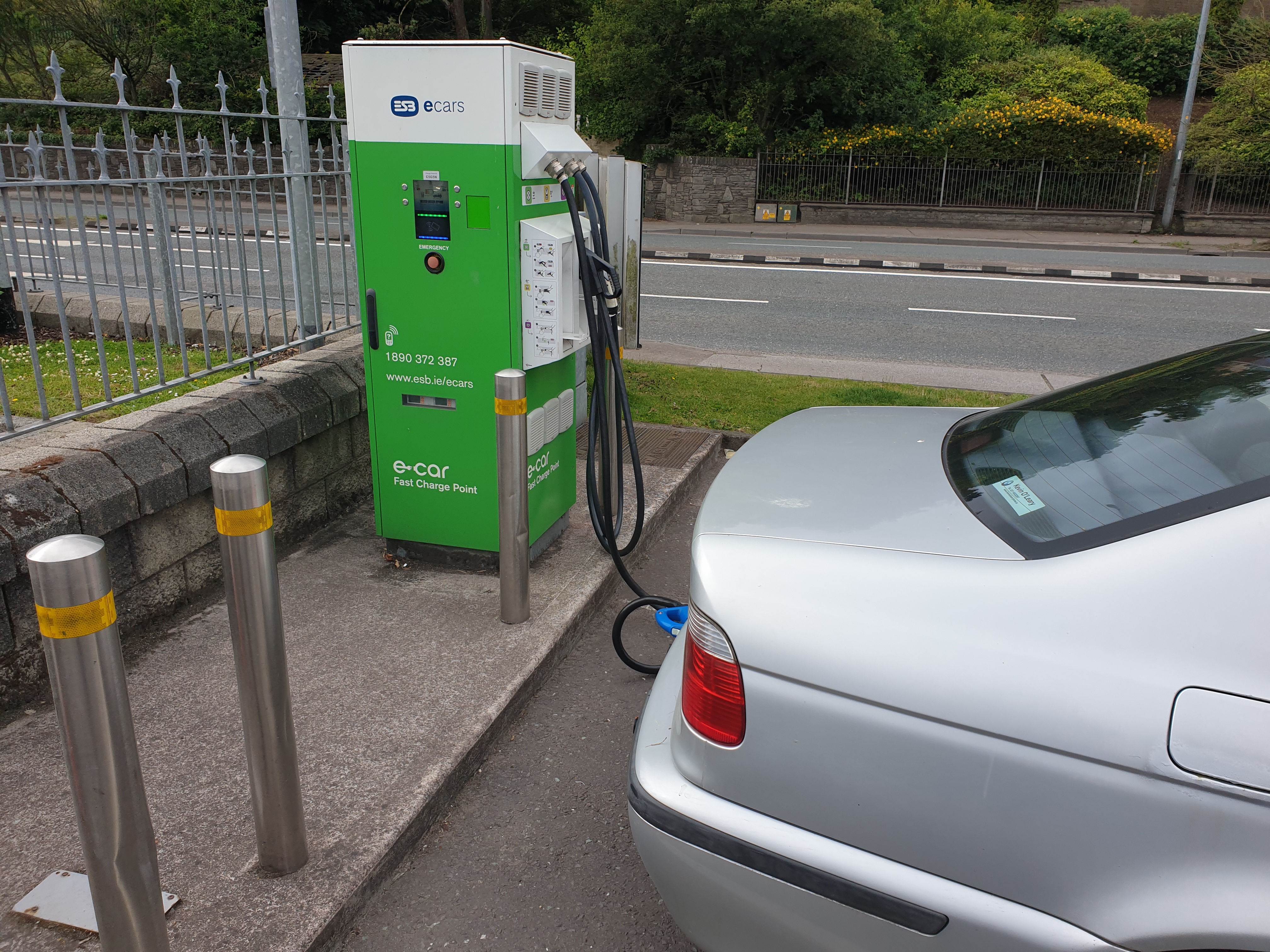

Testing of the integrated Chademo dc fast charge continues with now 3 brands of station working perfectly.

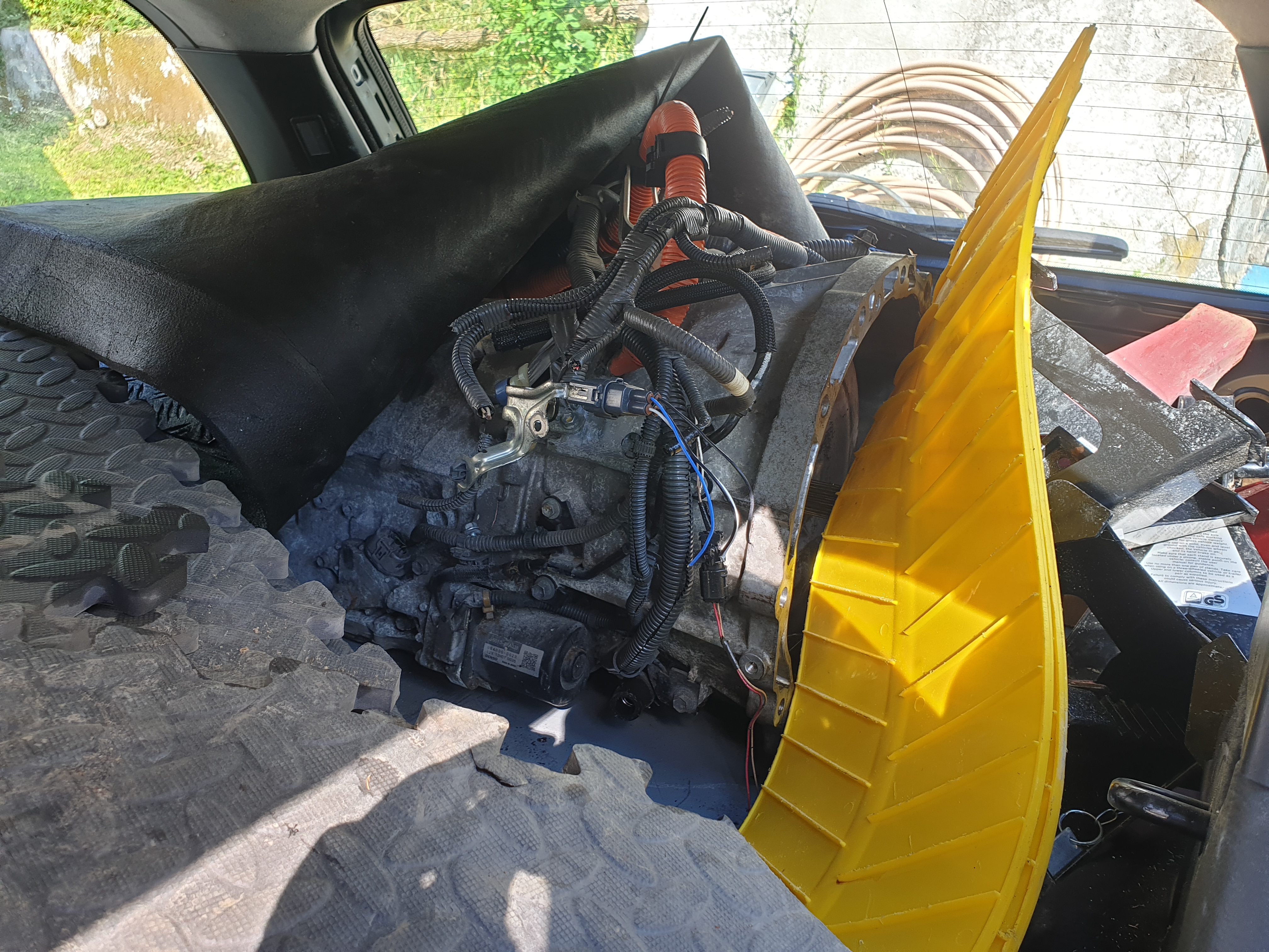

Posts: 4006
Been thanked: 1135 times
Its hiding in there:) 334 miles, 5 hours of blood sweat and some tears, 7 ccs fast charges and we have a GS450h system ready for bench testing....now if I just had a bench....

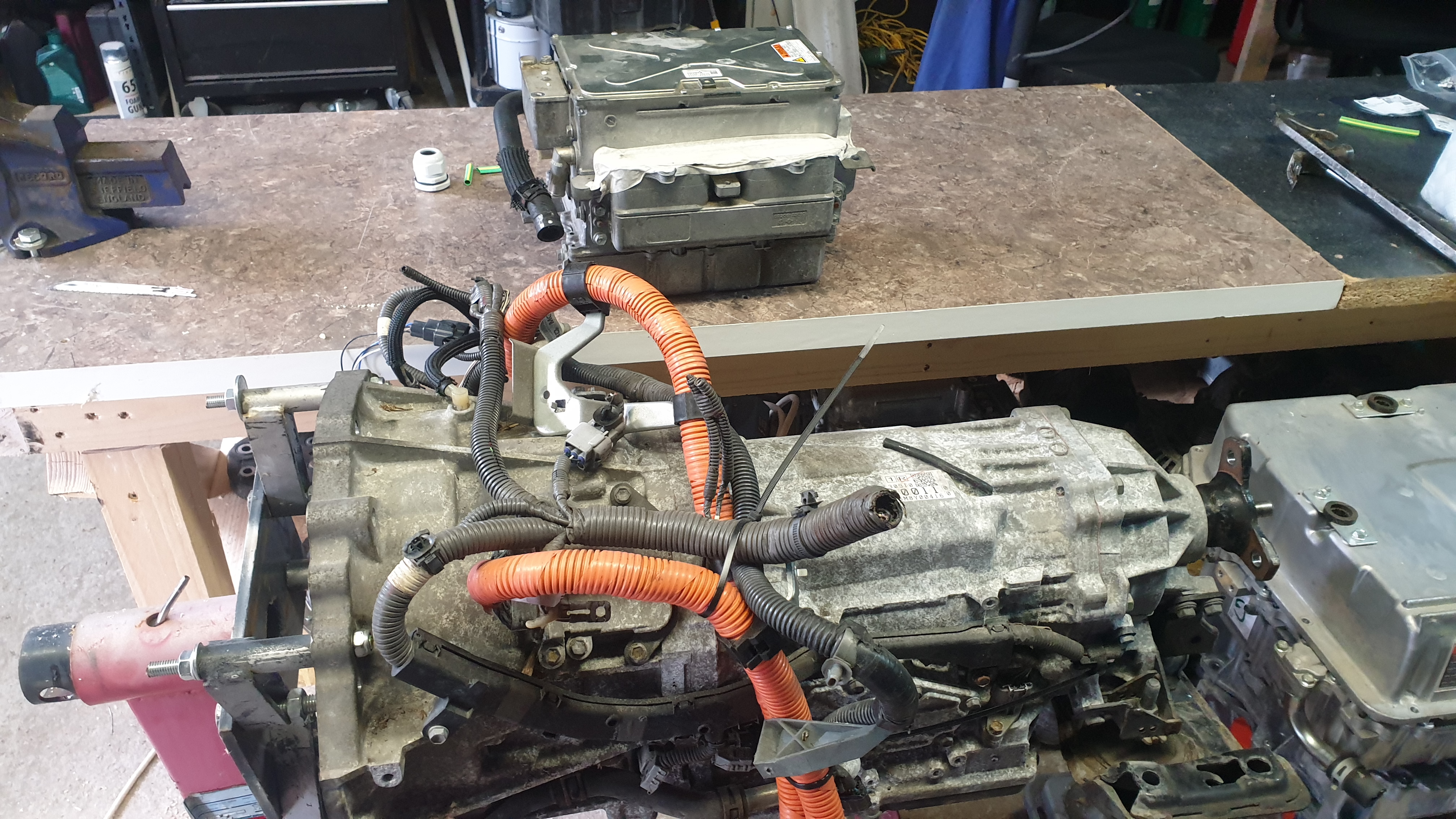

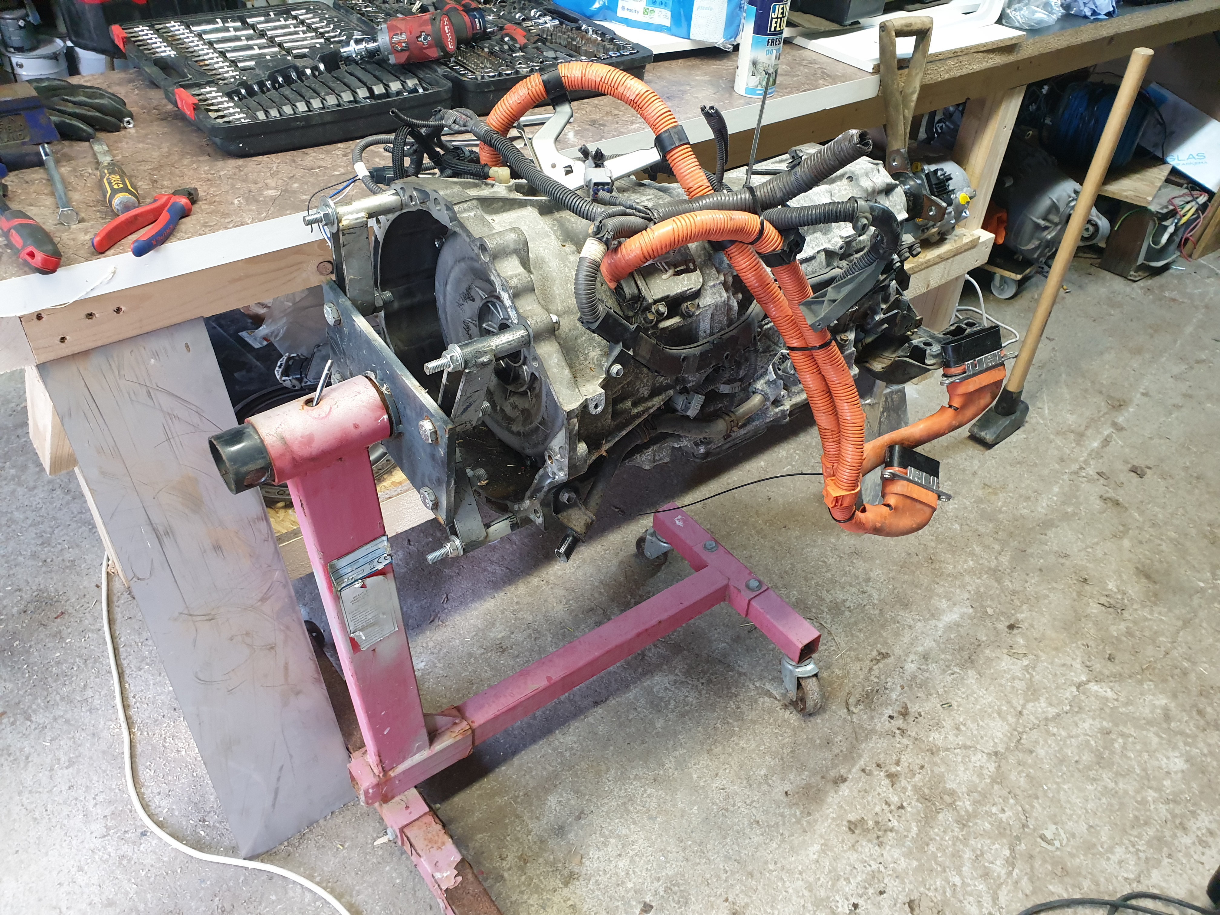

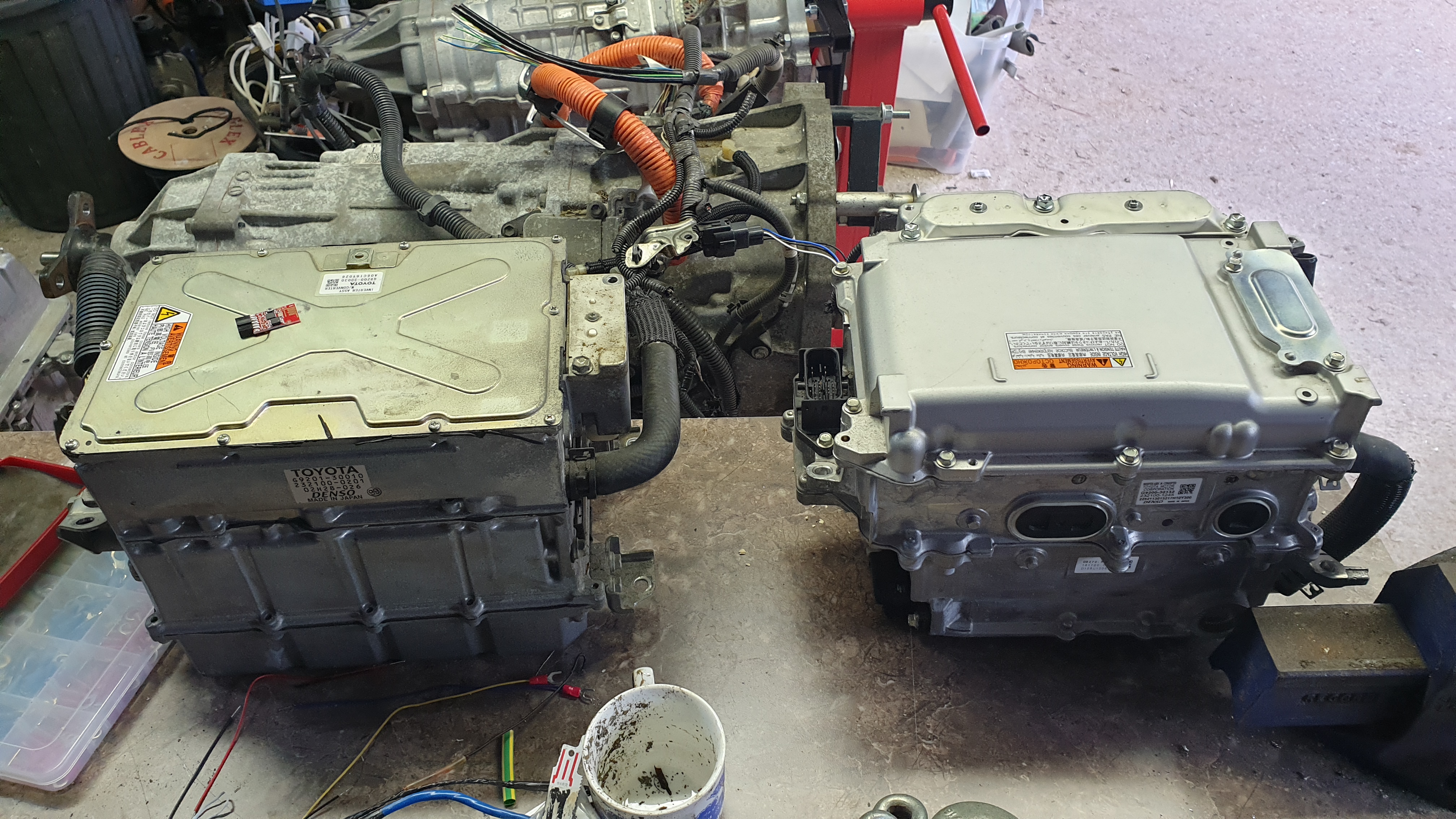

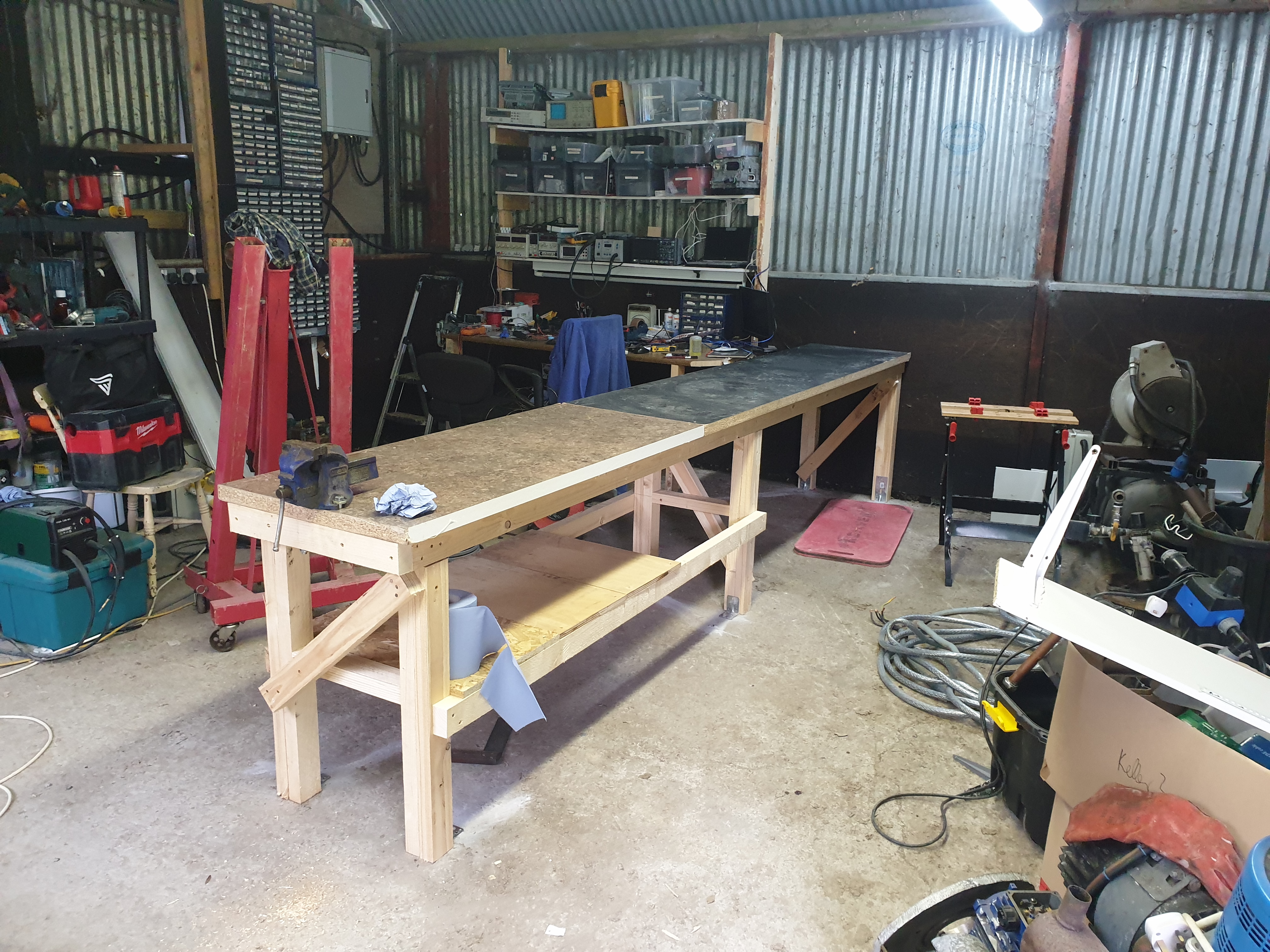

Posts: 4006
I have a bench now. And a gs450h system. Also scored a gearbox and inverter from an is300h so these will be coming to a Zombie vcu near you shortly. Next on the agenda is building a dedicated hv junction box with contactors, rig up a dash display and switch panel so all sw and hw functions can be tested on the bench before release.

Alibro
Posts: 1113
Location: Northern Ireland
Has thanked: 506 times
Been thanked: 325 times
Post by Alibro »
Coming together nicely.
You could build a land speed racer on that. :D

Picked up a GS450h inverter on yesterday's road trip for the sum of 200 euros. Now ready to start the bench setup. IS300h system due wednesday.

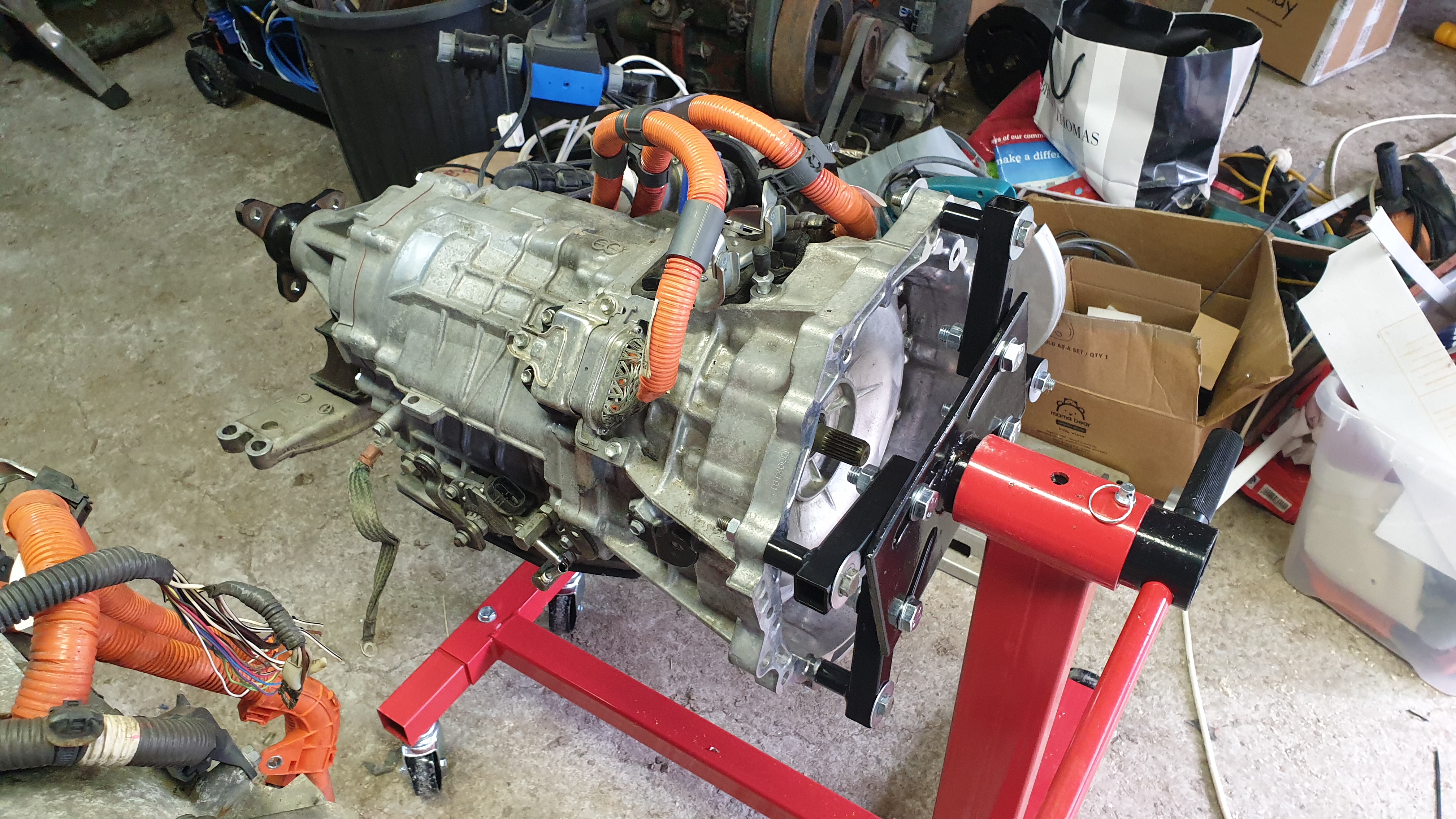

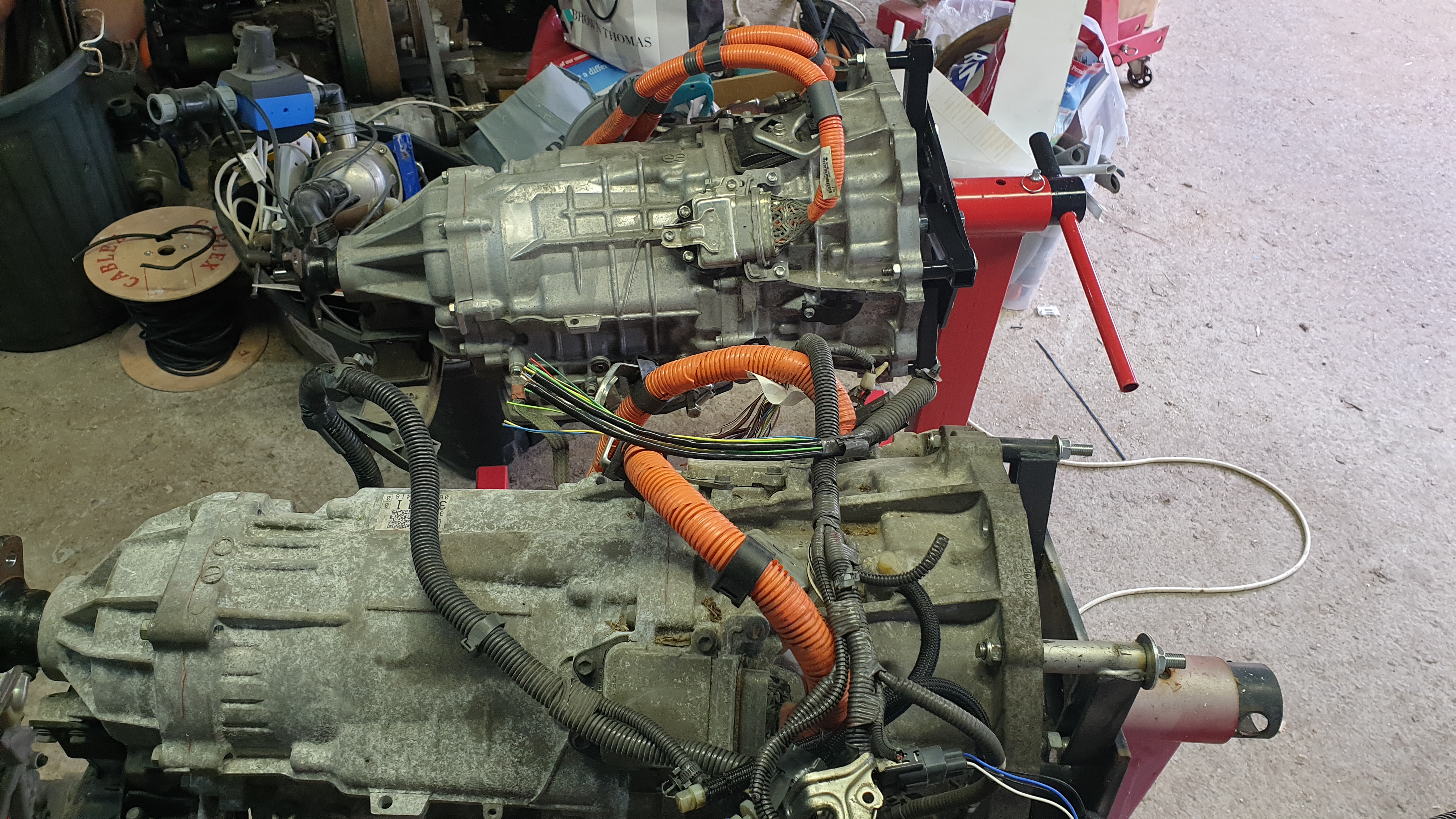

Posts: 4006
Is300h system is here.
