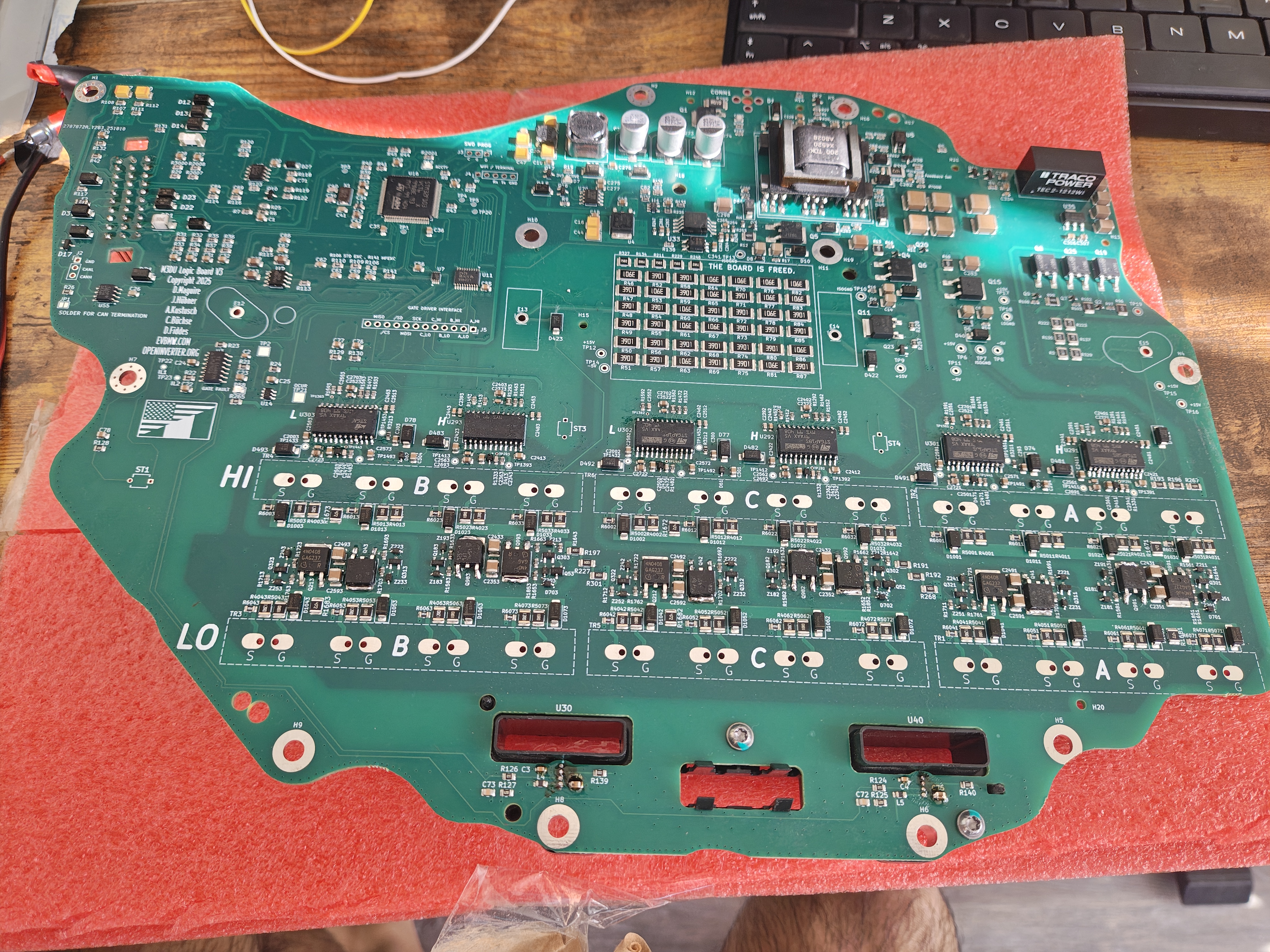

My inverter PCB arrived today! Waiting for a new 980 inverter that I'm using as the donor board. Hoping to have it mostly assembled tomorrow.
If I have time, I'll try to get the thermistor and current sense blocks 3D prints designed.

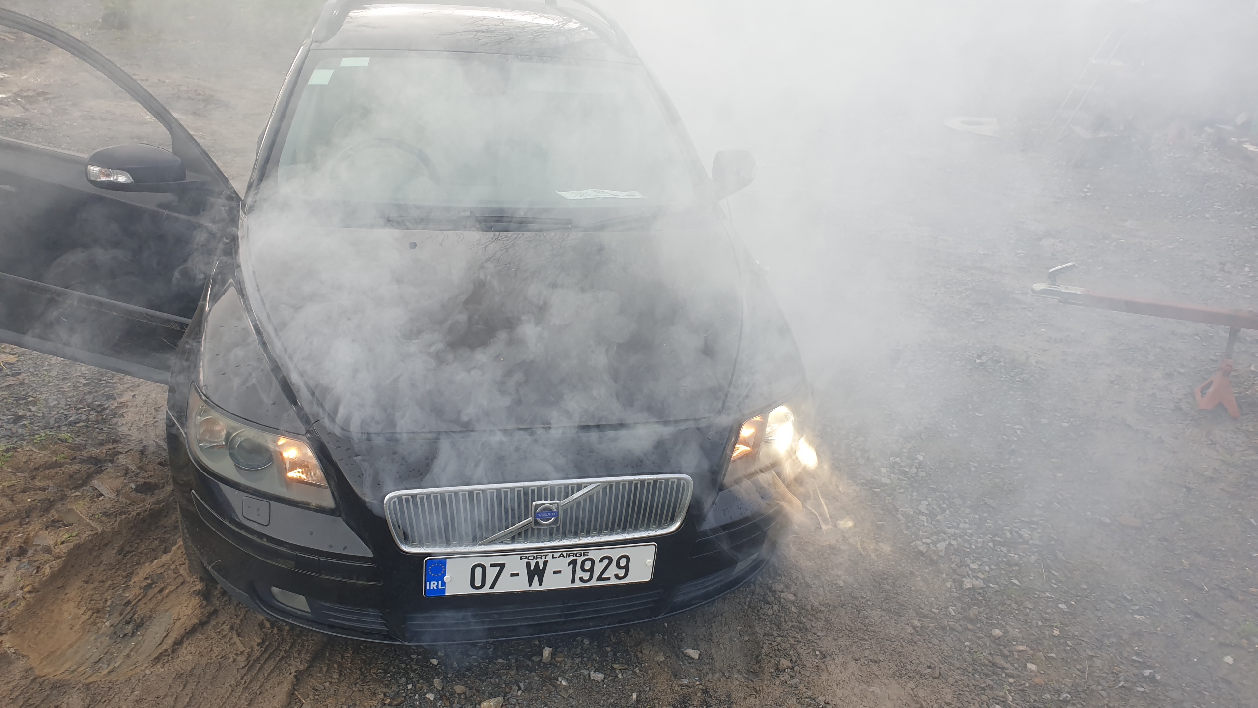

Volvo with the M3 moved for the first time today. Seized rear brakes were no match for throtcur 10. Initial impression is very smooth. Dave , I#m too dumb for my own good but could you remind me again of the oic command to save params to flash.

Sooo, I don't have any experience with driving a car with OI FOC firmware but what I can say is the V50 / M3 test vehicle that I call the T3RD is now the smoothest car I own to date. And thats just with my ham fisted attempt at tuning params that I do not understand. Sadly it's monsoon season in Ireland so not much traction just mud and burnouts in gravel.
I can make it trip desat by either A)maxing out all the kp params or B)slamming it into reverse at over 6k rpm.
Driveshafts are holding out so far.

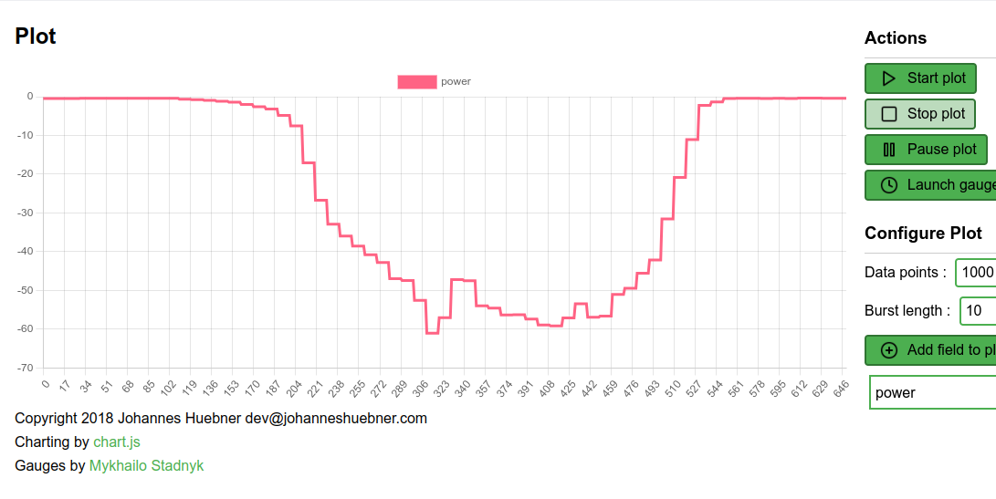

Ok, first real world data. This was captured while pulling uphill with the handbrake locking the rear wheels and foot to the floor. Front tyres were periodically breaking loose on the gravel and spinning up to roughly 3600rpm. No feild weakening used.

Scratch that. I had fmax set too low. Actual base speed around 4500rpm at 350v.

A parts order arrived. I've fitted my STGAP1BS gate drivers (not the STGAP1AS Tesla fit). They seem to be working fine so far and report no faults. I've not put HV on them yet though.
I've also got a set of hall-effect current sensors but haven't fitted them just yet either.

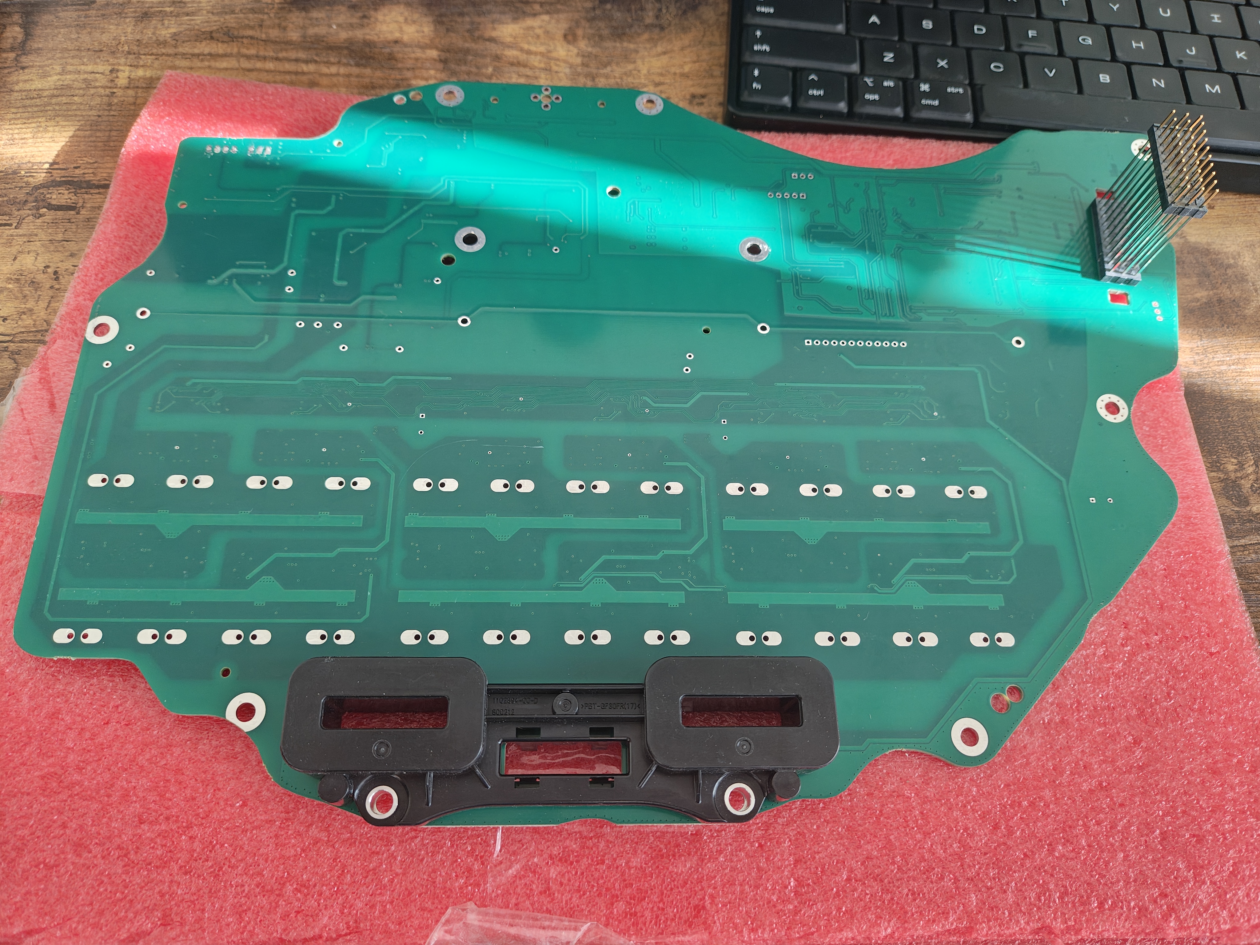

Just waiting on some temperature sensors, but it has passed all the power up tests so far!
When I pulled out the 30 pin header, I used spare aluminum bus bars to block of the rest of the PCB from damage from the blow torch. A bit overkill, but it worked. I saw another technique on YouTube where someone used a bit of copper wire as a bus bar between the pins to distribute the heat without damaging a plastic housing. Worth trying if someone wants to experiment!
I also inquired with Molex about designing a custom 30 pin header an am waiting to hear back. If anyone wants the measurements, the length of the headers are 45mm and the pitch is 2.54mm. they have a 7mm mating face (to the outer face of the black plastic), 35mm from black plastic to black plastic outer faces, and 3mm for the other mating face.
I'll get the current sensor block modeled this weekend. I pulled out one of them temp sensors from the original board and think it's pretty doable to make a 3D print. Damien, do you want a setup that matches the OEMs as close as possible or something we can adapt to the currently selected temp sensors?

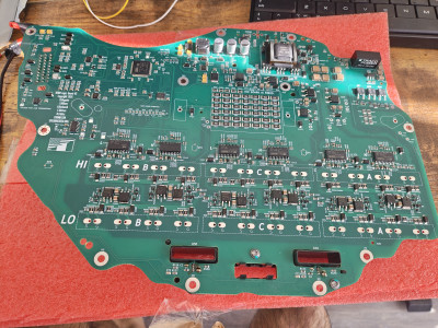

My inverter is now neatly assembled, with working temperature sensors. but I really can't find the Tesla wiring harness anywhere anymore so I had to order a new one, which is on its way so in the meantime I've been doing something else.
maybe a bit late but since the holes don't align everywhere and I have a 3D scanner I might be able to contribute to the project. So I made a scan and based on that created a step and dxf file, maybe it's useful. I will also add the 3D scan mesh (if possible with the file size) for those who are interested.

FYI, this scan is of a 3D3 front motor PCB with IGBT drivers. This PCB has the pyro for the motor phases on the side screen to be able to break. So, the current sensor is the same as the "older" model, but the middle screw is simply missing because that's where the pyro is.

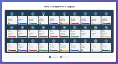

Here's the OEM to OpenInverter pin mapping if anyone needs it:
Pin 1 is the lower right from the outside of the inverter and the lower left of the housing facing towards the PCB.
Pins are ascending in each column - the bottoms pins are Pin 1 / Pin 11 / Pin 21
Got everything setup but unfortunately I'm getting two errors on my Phase C Hi Gate Driver: REGERRR | REGERRL that I'm currently investigating
- Posts: 4007
- Been thanked: 1139 times
That's a brilliant diagram. I have added it to the Github repo. The Reg errors are likely caused by a short dropping the Phase C hi isolated power rail. it wont cause any harm as each supply has its own current limiter.

As for the reg errors, I've removed the board again and desoldered the MOSFETs for Phase C entirely and then lifted the Phase C hi gate driver and and re-soldered it on. I'm still getting those errors. Any chance it might just be a faulty gate driver? Or should I be looking at other parts of the circuit for Phase C Hi?

Did you check the board was working before soldering it to the inverter chassis & mosfets? I would recommend bench testing with just 12V and CAN. The inverter should come up and report that the gate drivers are all OK. It doesn't need the big mosfets to function. You shouldn't need to dismount to debug though.
The REGERRR and REGERRL errors are the sort of thing I have seen when the gate drive PSU is turned off. It would be worth double checking the gate drive PSU for each phase in turn. You do this with TP6/TP7/TP8 for phase A, TP9/TP10/TP11 for phase C and TP12/TP13/TP14 for phase B. I measured 12.7V for the positive supply and -5.1V for the negative supply for each phase. This matches Damien's video I think.
If the phase C PSU is not working it may have current limited as Damien explained. You might have to desolder the relevant STGAP1AS to see if it is a PSU problem or a gate driver chip problem. I found access around the "hot" side of the gate drivers to be quite fiddly. I can imagine it being really easy to end up with a short or nudging one of the many passives.
