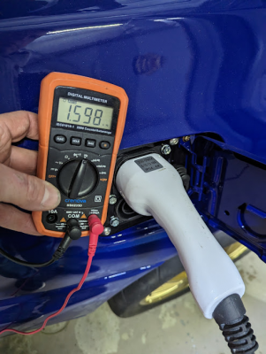

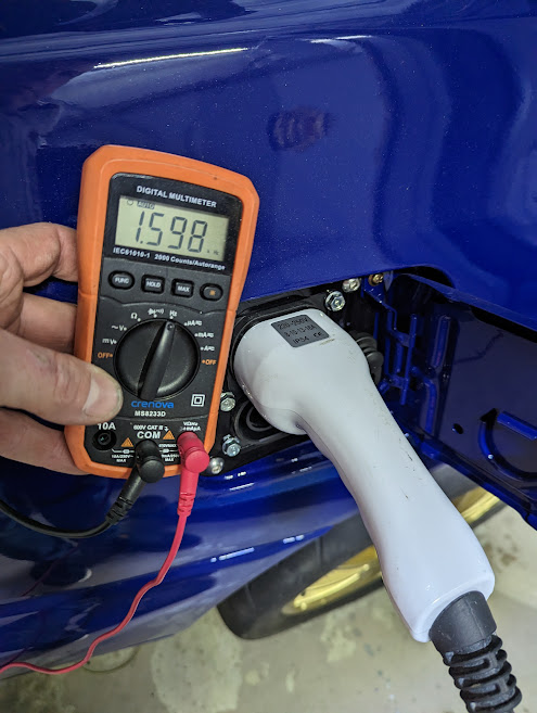

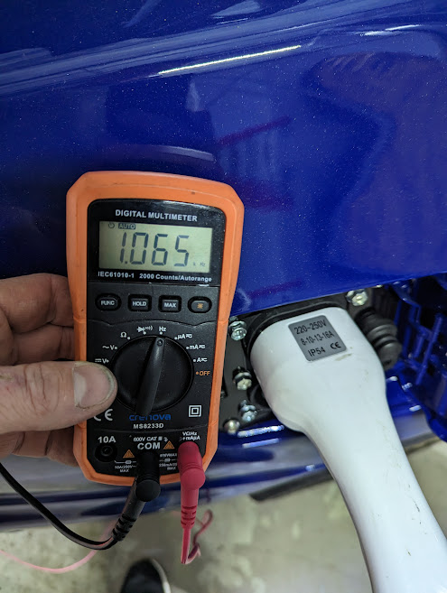

Zapatero wrote: Mon Nov 28, 2022 12:53 am I'll test what the 1B-15 does, i hope it's a pull up output that delivers 12v once plugged in. With that you could easily simulate to your OBD that the car is plugged in by attaching a pwm generator to a relay. In my case it'll be a direct charge interlock for the Orion BMS on charge power, if it's +12v

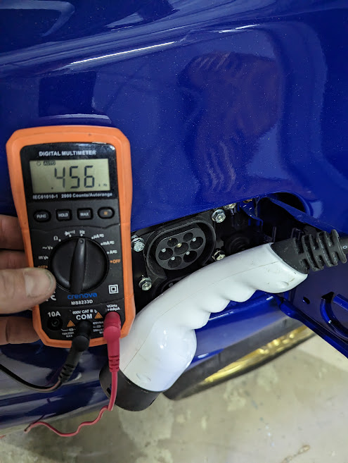

So i tested 1b-15 yesterday. It outputs a frequency. I also tested voltage (30mv constant) and resistance, but the state of a plug had no effect on the output. Just frequency changed.
No Plug Inserted
With Plug inserted
With Plug inserted and Charger plugged into 230v Wall socket

Zapatero wrote: Fri Dec 16, 2022 9:53 am So i tested 1b-15 yesterday. It outputs a frequency. I also tested voltage (30mv constant) and resistance, but the state of a plug had no effect on the output. Just frequency changed.
Uhm, okay interesting question would be does it require a pull down on the other end and what would the signal look like under the scope.
Can you test the pin 1B-8 IGN Wake up signal +12V (ignition, contact 15) with the same situations?
I am trying to come up with a way, shared on here ofcourse, of having the LIM being able to wake up or keep awake a vehicle while charging or plugged in.

If I test 1b-8 against 1b-15 then i get 12v.
No frequency or anything else...
12 volt ist constant, no matter if the plug is inserted or not

Zapatero wrote: Fri Dec 16, 2022 8:28 pm If I test 1b-8 against 1b-15 then i get 12v.
Is the car on? is it possible to turn the whole car off but the LIM connected and the 12V permanent powered.
I believe the LIM did not go to sleep.

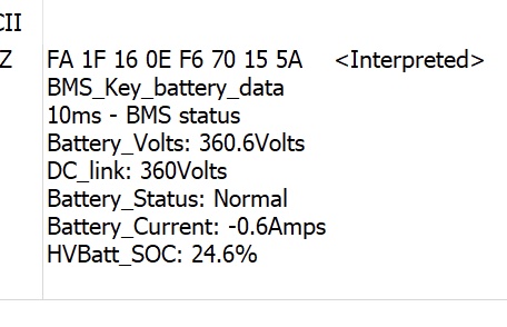

Hi to all. I'm finishing my program for Lim 2014. I studied the logs taken from the car BMW i3 2014. I can't figure out how SOC_local is defined here. I'd 0x112, byte 4.5. I get some big numbers. Can someone explain why?

Are you using the correct bit length (=12), scaling (0,1) and endianness (Intel)?

Yes, I use normal length. It's also not entirely clear to me what soc is here. For example, in the logs posted on GitHub.
112,8,FA,1F,16,0E,F6,70,15,5A,
If it is not difficult for you, you can explain with an example.
Thank you.

I'd say in that example SOC = 24,6%
Byte 4 = 0xF6 = 11110110
Byte 5 = 0x70 = 01110000
Then take all bits from Byte 4 and four most right bits from Byte 5 in front of it.
So you get binary 000011110110 = 246 scale 0,1 = 24,6%

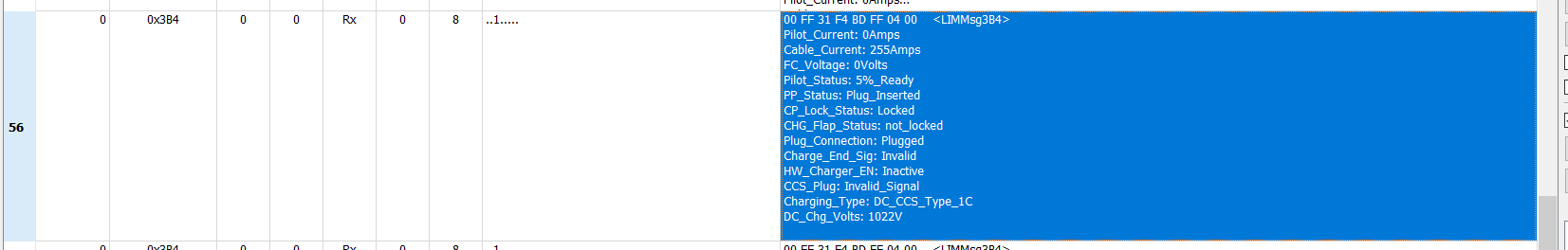

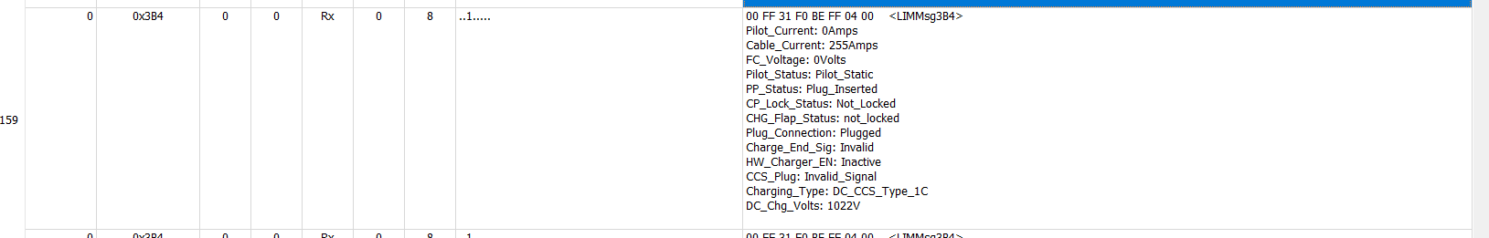

Hi all. Today I tried to run my VCU for LIM for the first time. But unsuccessfully. When transitioning to lim_state 2, the red LED begins to flash. Checked the Flap, it is in position 1. Locking the port in the LOCK position (11k). What can be wrong? Capture of the сan in the attachment. Thank you.
LIM.txt
(176.39 KiB) Downloaded 391 times
larsrengersen
Posts: 143
Has thanked: 10 times
Been thanked: 28 times
Post by larsrengersen »
You are not getting a valid Charging_Type in 0x3B4, Byte 6 and thus it hangs/remains in Initlialisation.

larsrengersen wrote: Tue Dec 27, 2022 9:00 pm You are not getting a valid Charging_Type in 0x3B4, Byte 6 and thus it hangs/remains in Initlialisation.
I get to this level 3B4 8 00 FF 31 F4 BD FF 04 00 . But, before that, at the moment LIM gets 3E9: 8,08,52,11,00,00,00,00,00, the red LED immediately starts flashing. I'm paying for the charging station, but the insulation test did not start. The problem is the blinking LED. I'm doing something wrong?

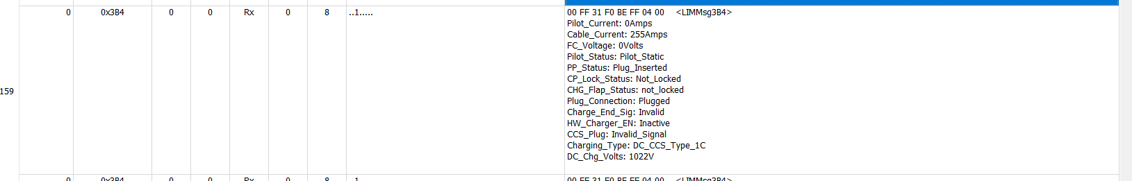

Eltis wrote: Wed Dec 28, 2022 9:09 am I get to this level 3B4 8 00 FF 31 F4 BD FF 04 00 . But, before that, at the moment LIM gets 3E9: 8,08,52,11,00,00,00,00,00, the red LED immediately starts flashing. I'm paying for the charging station, but the insulation test did not start. The problem is the blinking LED. I'm doing something wrong?

Maybe I missed one point:
1. I have lim...646 USA.
2 Port duoside. I did not put the 620 ohm resistor. Between GND and CP. Could this be the reason for my failure?
But my lim reacts normally to the connection.
3B4,8,00,FF,31,F0,BC,FF,00,00,

Fix your wiring, as it needs to duplicate the BMW I3 implementation. Easiest to get this working is using a type 1 AC charging to start.
It does determine that a CCS is present due to 5% pilot yet it has errors for plug.

CCS DC charging relies on power line communication (so data packages via the CP and PE lines). Since you are getting an invalid signal it looks like this digital communication is not working properly. Therefore Tom suggested to check your wiring.

Alot, specially since you wrote your own code. I would say compare your own logs to known working ones, this is the only way to diagnose it.
Also a chance that you are using an incompatible LIM with a CCS charger that outputs a not supported protocol (unlikely).

I already compared can protocols, everything is 100% identical. All the more so that the AC charging is normal for me. I am beginning to suspect that I have a faulty lim.

Sure who knows, yet your can messages are not identical in population to proven working logs. example, in the FC command message your time to go are 0. So it is on you to go through each variable in each message and compare it to working logs.
