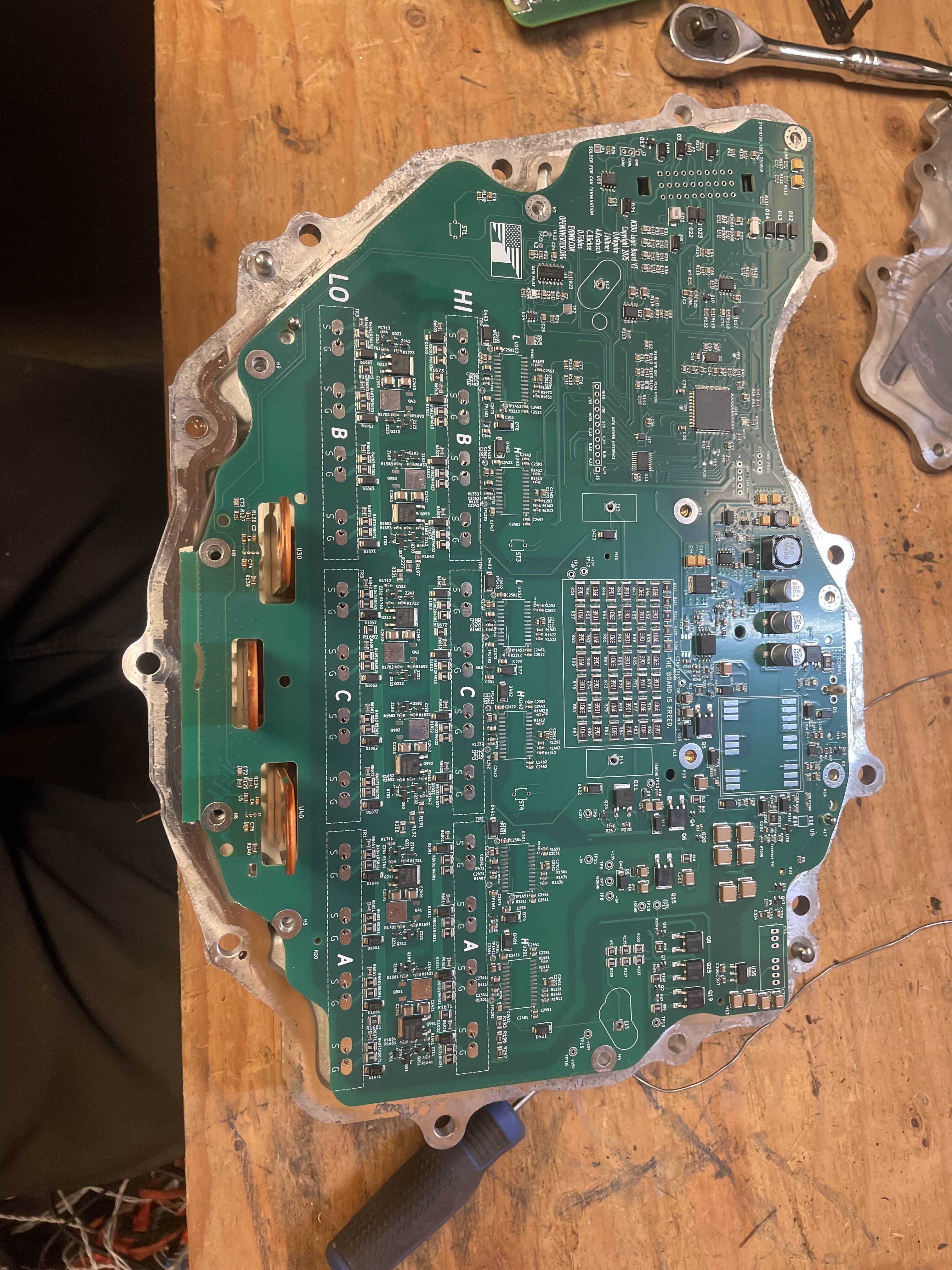

davefiddes wrote: Tue Nov 18, 2025 6:06 pm Did you check the board was working before soldering it to the inverter chassis & mosfets? I would recommend bench testing with just 12V and CAN. The inverter should come up and report that the gate drivers are all OK. It doesn't need the big mosfets to function. You shouldn't need to dismount to debug though.
The REGERRR and REGERRL errors are the sort of thing I have seen when the gate drive PSU is turned off. It would be worth double checking the gate drive PSU for each phase in turn. You do this with TP6/TP7/TP8 for phase A, TP9/TP10/TP11 for phase C and TP12/TP13/TP14 for phase B. I measured 12.7V for the positive supply and -5.1V for the negative supply for each phase. This matches Damien's video I think.
If the phase C PSU is not working it may have current limited as Damien explained. You might have to desolder the relevant STGAP1AS to see if it is a PSU problem or a gate driver chip problem. I found access around the "hot" side of the gate drivers to be quite fiddly. I can imagine it being really easy to end up with a short or nudging one of the many passives.
Jack Bauer wrote: Tue Nov 18, 2025 6:23 pm Running the latest build in the V50 now from Dave's github. All temps reporting correctly.
In general, do please follow the procedure in the video. I know it's tempting to skip parts when you want to see a result , I know that all too well but it almost never works out to be quicker.
I did check these voltages as per the video when I did it initially - the video only covers TP6/TP7/TP8. I didn't know to check the other ones. The other mistake I did make was that I didn't check with WiFi after this step to see that they were all ok.
That said, these are my voltages. Interestingly, I only see a discrepancy on Phase B (which seems inverted compared to the silkscreen labels and with drastically different voltages)
Phase A TP7: TP6 / TP8: 12.74V / -5.16V
Phase B TP13: TP12 / TP14: 3.544V / -14.02V
Phase C TP10: TP9 / TP11: 12.83V / -5.12V
I can understand Phase B giving me problems given it was the first set of gate drivers I soldered on. Is there a chance the errors on the interface are attributed to the wrong gate driver? In the mean time, I'll check the Phase B gate drivers and see what's going on

It's entirely possible the gate driver status is wrong. :-/ I'll investigate but it'll be tomorrow before I get to that.
Voltages for Phase B look wild. The zener in the PSU should stop the negative rail getting below -5.1V.
Posts: 4000
Been thanked: 1115 times
Yeah the zener "lifts" the iso ground to 5.1v thus creating the neg and pos supplies from a single output of the transformer. Its not a very strong ground so any short or damage will cause it to read weird.

That was it! It looks like at some point during installation the D8 diode lifted off of the board. Fixed that and no more gate driver issues.
It looks like the error messages for Phase C Hi and Phase B Hi are flipped

@Dave, here's a PR that addresses the error ordering. I don't have the board in front of me to test unfortunately, but let me know how it gels with your understanding of the hardware: https://github.com/davefiddes/stm32-sine/pull/1

Thanks for finding the problem there outlandnish. It's a pretty facepalmingly stupid bug on my part. No idea how I managed to get that in there. Your fix is on the right track but is actually the reverse of what's required. The way the gate drivers work is that the first data to be clocked out when reading the status comes from the last chip in the chain ( i.e. phase A high-side) and ends with phase B low-side.
Armed with the results of Damien's testing and the knowledge that I can fix anything if I let the magic smoke out I found a way of triggering faults on the high-side. I found that if I short the Source and Gate pins of the high-side drivers I can trigger a UVLOL error. With my most recent commit in place I can now force an error in each high-side and the correct error is reported over CAN. No magic smoke so far.
I've not found a way of getting the low-side gate drivers to fault individually. It doesn't matter as the ordering of data is obvious (when I pay attention :oops: ).

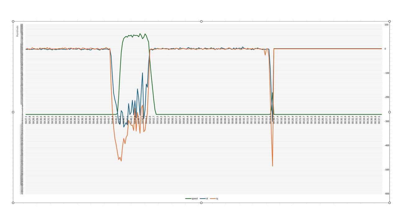

Latest firmware, cranked field weakening to 150Amps, tied the T3RD to the back of the JCB and opened up the taps. Sadly the 9kwh bmw hybrid pack aka "ScamBatt 9000" is sagging and limiting power but not much left of the tyres.

Here is a log driving around the yard along with the current parameter set from today's testing. Dave, is it possible to alter the logging time interval?

Works a treat Dave :) This log is from my wife doing a burnout and then a trip when she gets a bit too carried away...

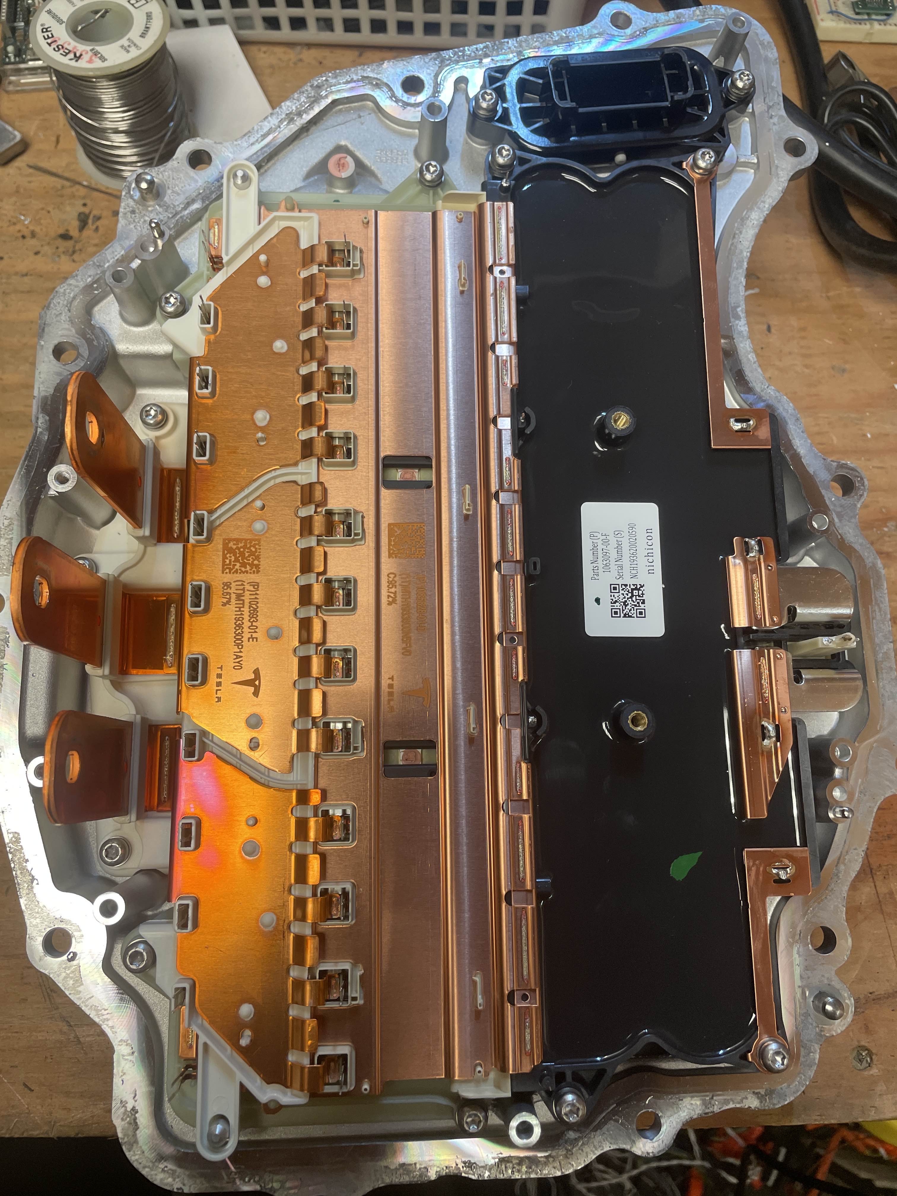

about 10 minutes with a cheap heated solder sucker, and some flux, and the board is free!
(starting to build out wiki)
its a rather simple process. place the solder sucker over the pin, let the solder flow, and suck!
After repeating across all the pins, i would then check the pin for free play, and if not, get the solder flowing again, and nudged it with a small scalpel so it doesn't rest against the board and solder its self back again. once all pins where free moving, removed all 11 screws and start to rock the board free. it should come off with ease. no force.
then clean up all the pins, removing any excess solder, then dropped replacement board in place! take your time. a few pins might need to be tweaked to get them to line up.

I was doing that yesterday too. Desoldering the PCB was pretty painless as you point out.
One gotcha that has bitten me since is to do with the current sensor housing. I hadn't appreciated the order from Damien's video and had forgotten to heat the current sensors prior to levering away at the sensor housing. I managed to snap the sensor heads off both hall effect sensors. Damn. I have replacements at least.
As part of the clean up I had reason to try the MG CHEMICALS 8310A Conformal Coating Stripper mentioned a while back. It works quite well on the Musk Goo. Softens it up nicely. Seems to need a little bit of physical scraping with something blunt (matchstick, etc) to remove. It doesn't remove the silkscreen or solder resist or cause obvious corrosion.
I am writing up the install process as I go though I've not put anything on the Wiki. I was going to start a new page specifically for that. Will get what I have up shortly.

With some luck we can have a 3d printed sensor housing if the toroid is an off the shelf part. I'll see what I can find.
