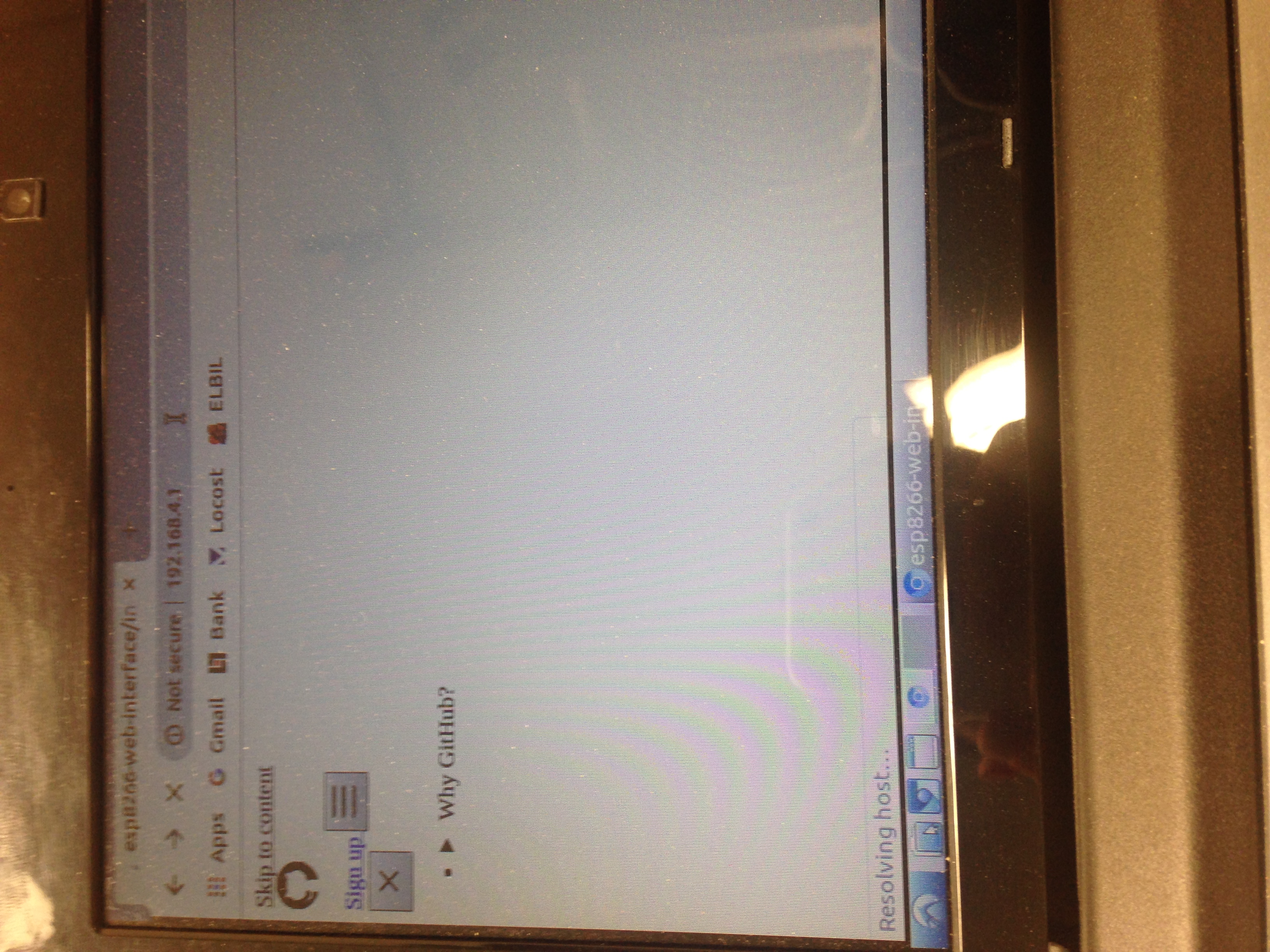

Files uploaded fine but now I can't get the web interface to load in my browser. I've tried restarting the inverter but no change. Wifi is ok so only the web interface thats not ok.
This is what comes up when trying to acces web interface:
Any way I can fix this without removing the wifi module from the inverter?
Failed to update web interface
Re: Failed to update web interface
It looks like you uploaded something not from index.html but some github page?

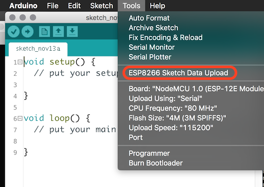

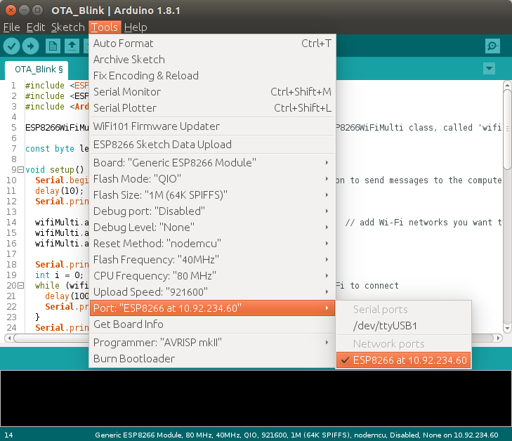

This is a tough spot to get out of without "Soldering GPIO0 to 0"
Arduino IDE with OTA (over-the-air)
1) Connect to ESP WiFi and choose Port as IP 2) Install Arduino SPIFFS Uploader plug-in
3) Move all web-interface data into a "data" folder except "FSBrowser.ino"
4) Open FSBrowser.ino
5) Do "Sketch Data Upload" Edit: Try Johannes Linux method
curl -F 'data=@index.html' http://192.168.4.1/edit- johu
- Been thanked: 1914 times
Yes that will fix it. Curl exists for windows also

Thank you dima and johu!
Fixed using curl.
My mistake was that I didn't download the files correctly from github, instead I saved the source which resulted in the html of the webpage and not the intended file. Next time I will check the html file before I upload it.
Fixed using curl.
