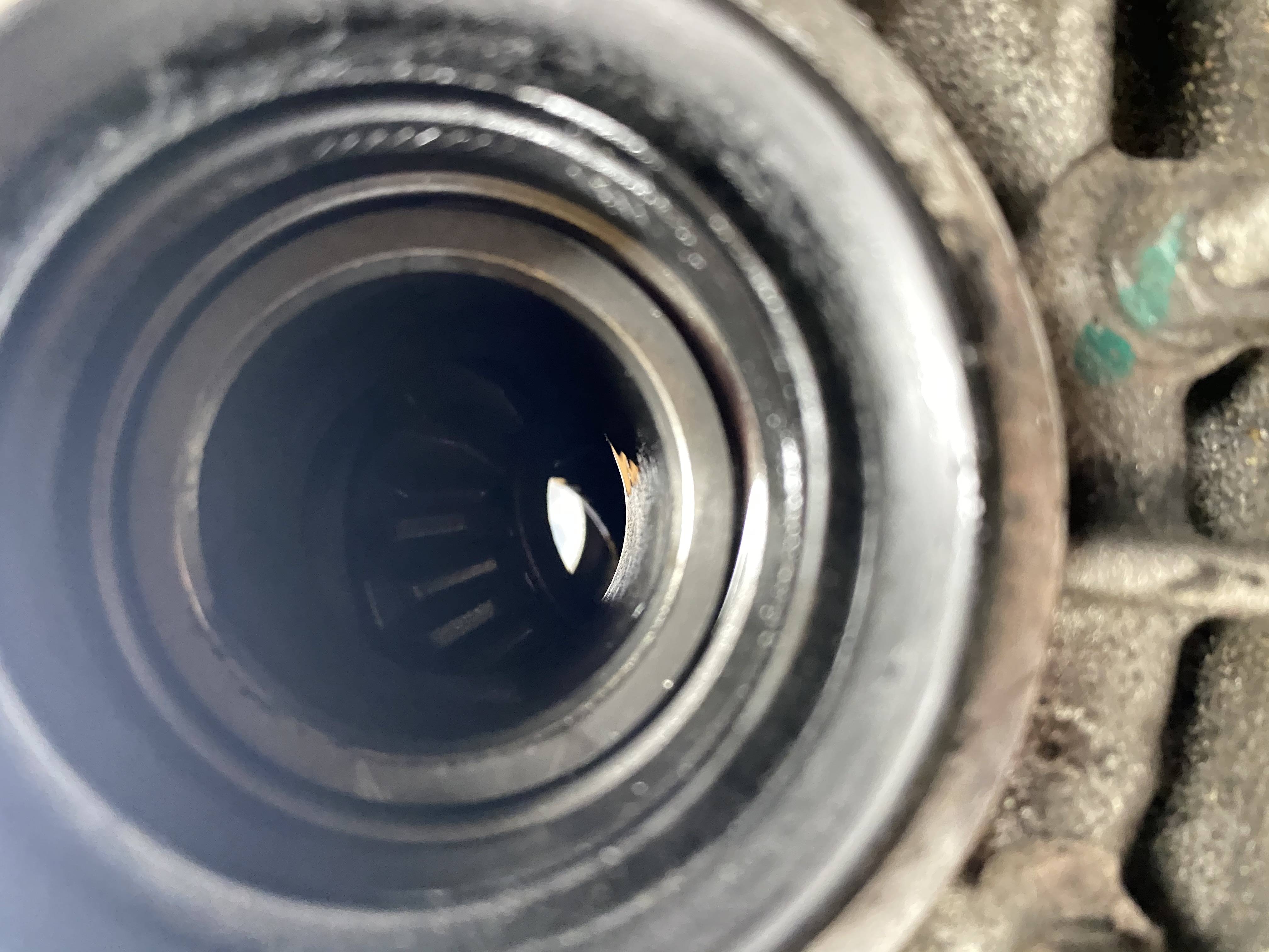

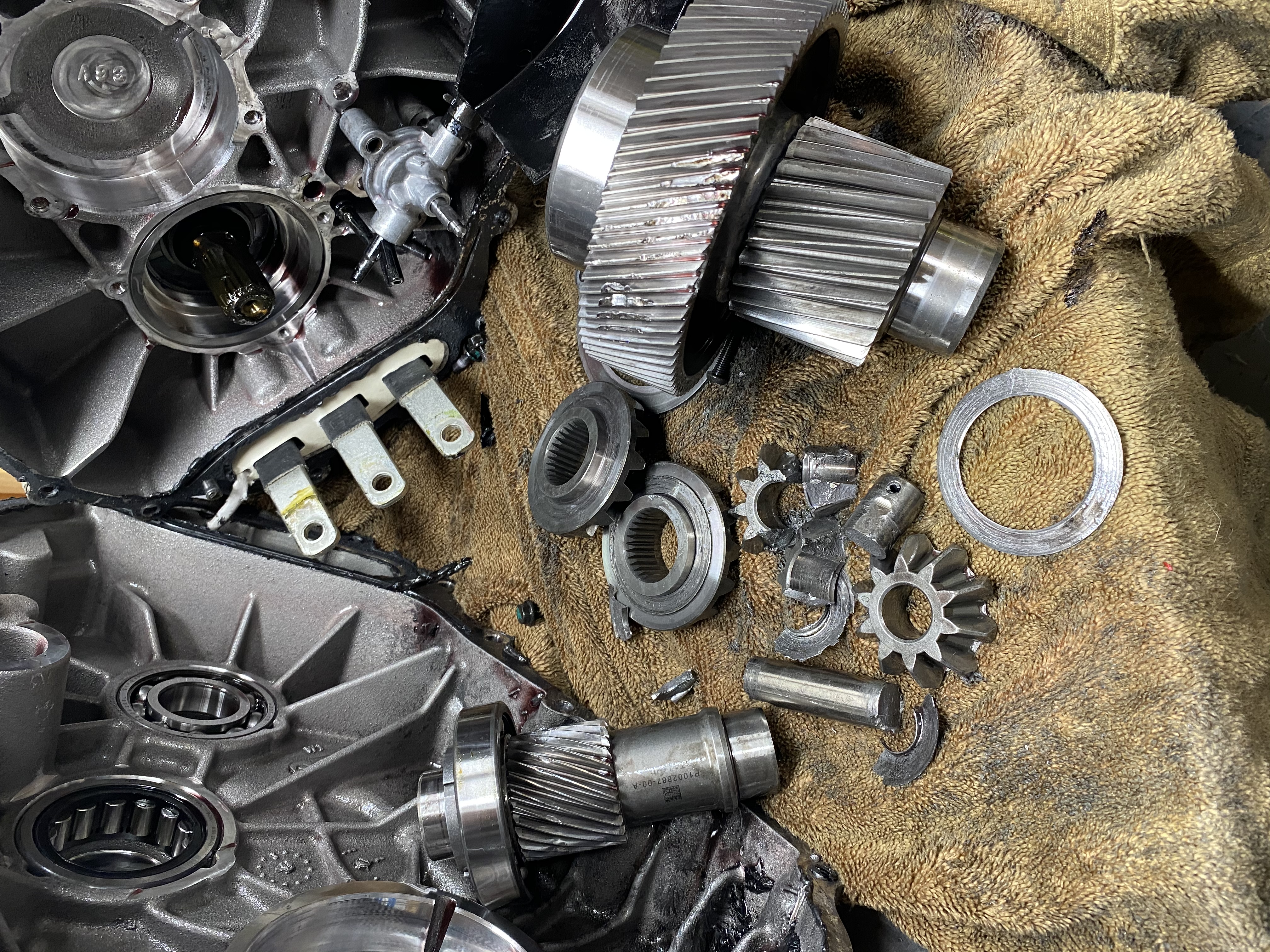

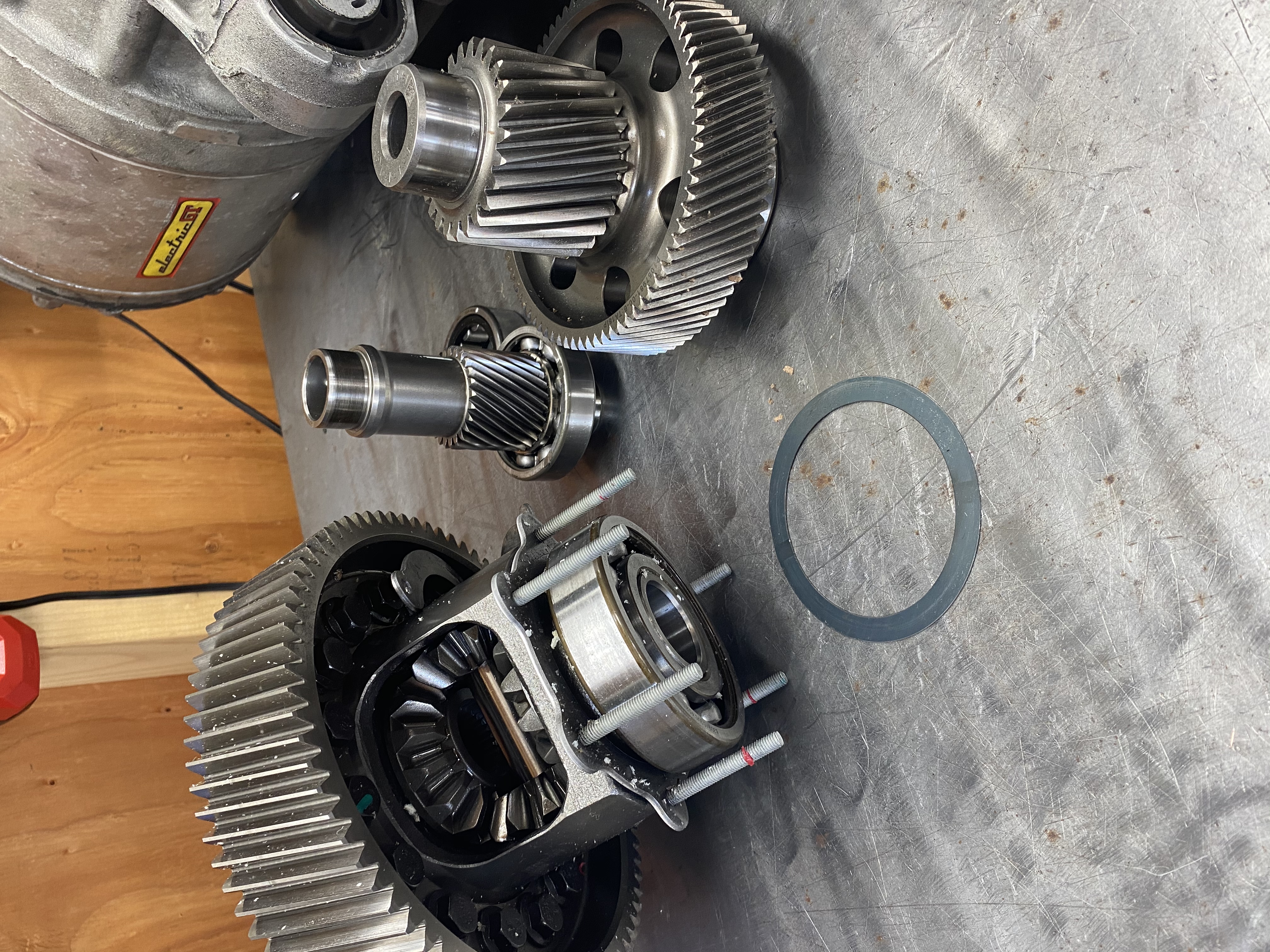

It was only a matter of time till something showed up. This unit has seen hundreds of WOT launches, many on slicks. On street tires if traction breaks, it will induce wheel hop, which is quite damaging on its own.
I was powering up a hill as the car shut off and made a whine on deceleration. I did not think much of the sound at the time as the motor was completely dead. As in no precharge, no wifi, nothing. So after some troubleshooting I found there was no power after the regulator on the logic board. This was traced to a broken solder joint on the inductor. Some solder and hot glue for added support and we're back up and running...or not. Powering up the motor resulted in a loud gear noise so I tore it apart. It seems the broken solder joint was likely caused by the shock of the diff exploding.
The bad news is I have to find another set of gears.
The good is that the inverter and motor pinion look fine and I have a Quaife LSD on the shelf that I've been neglecting to install.
There was a good amount of crap in the diff fluid so this likely could have been caught before failure with frequent fluid checks/changes. I would also think that a Quaife diff is a good investment as well.

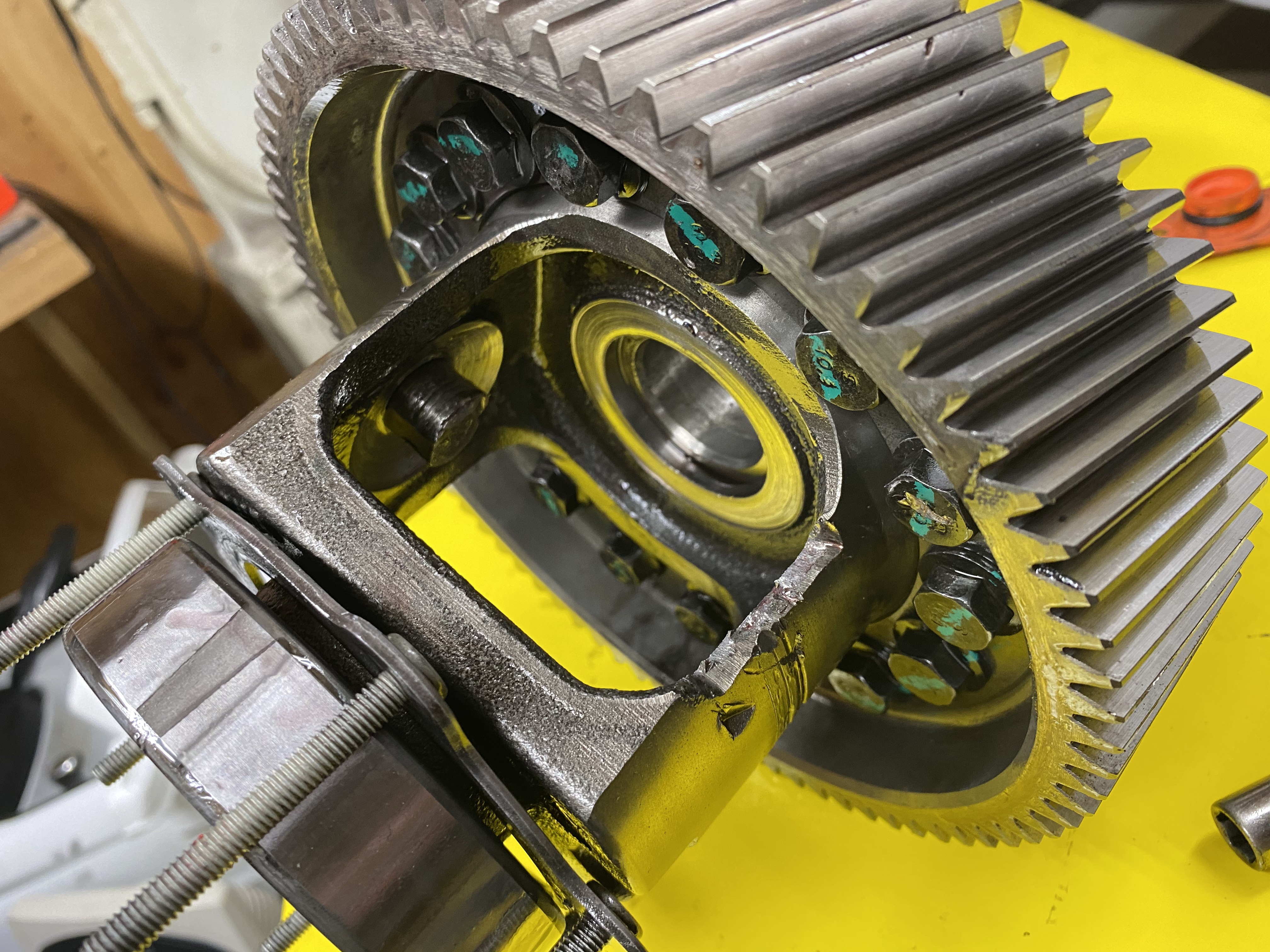

Looks like maybe the shaft holding the spider gears snapped, and then the gears ate themselves?
Or do you think the gears were wearing and their failure broke the shaft?
Re: LDU mechanical failure
Based on the wear on the outer surface of the spider gears facing the carrier, I believe they were eating themselves up prior to the pin breaking.
- Posts: 1083
- Location: Raleigh, NC, USA
- Has thanked: 238 times
- Been thanked: 279 times
I wonder if they seized on the shaft. Seems odd to me that the shaft would break after the gears.
That’s my guess is the clearances got to a point of bind. Sort of like running a bent connecting rod until the piston cocks in the bore and the wrist pin gets ripped out. Not that I’ve done that or anything.
It is certainly possible the pin went first. The end result is the same.

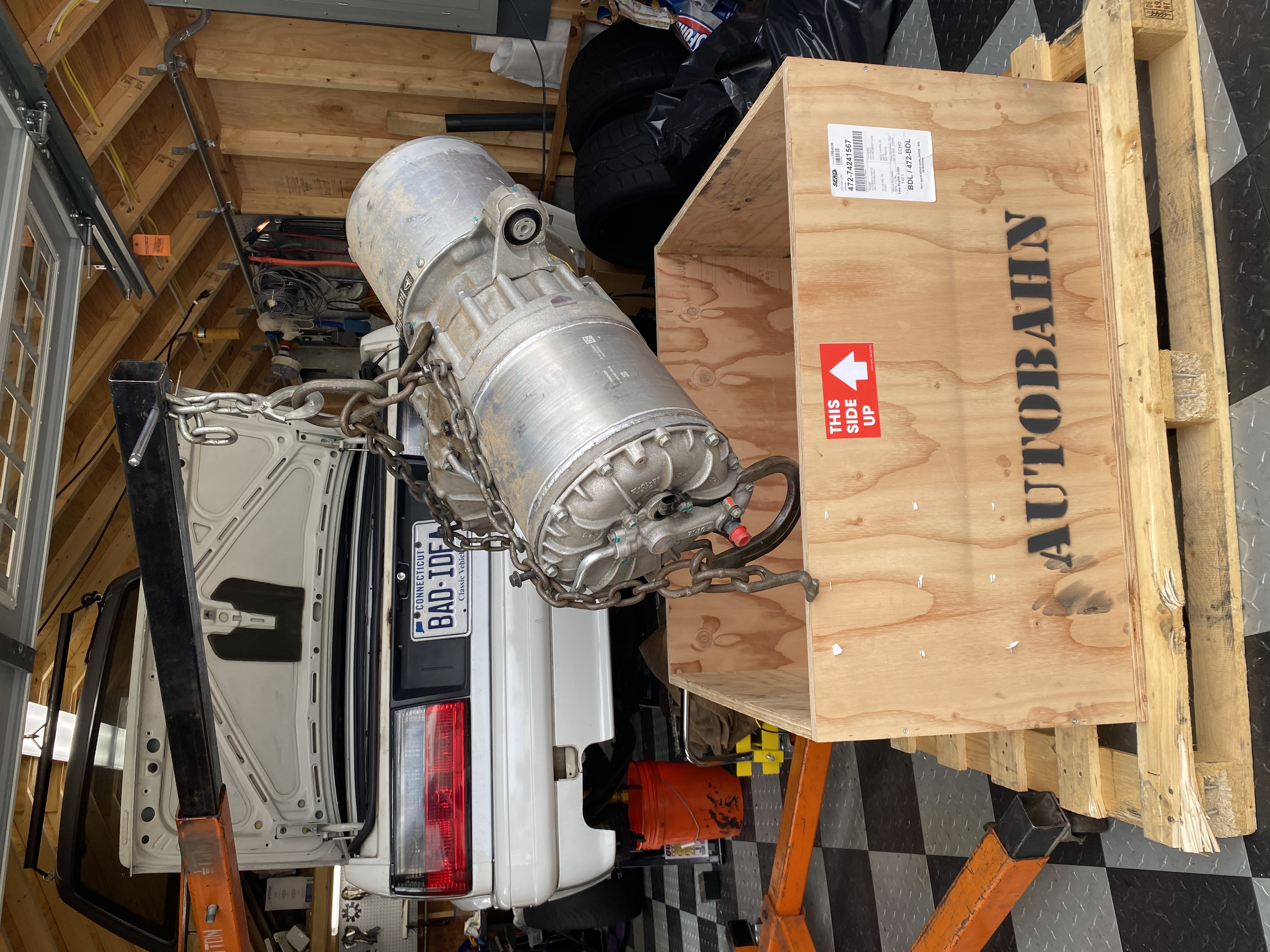

...and there were two. Replacement LDU going in the car and a fresh set of gears to repair the original as a backup.
*not sure what’s up with the orientation. They’re straight on my phone
Back in action.
Interesting observation is this motor is much quieter than the last. There was a pronounced whine, only when the inverter would start pwm generation that is notably absent from this one. It is a lower mileage, newer revision.
