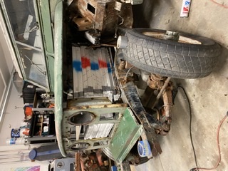

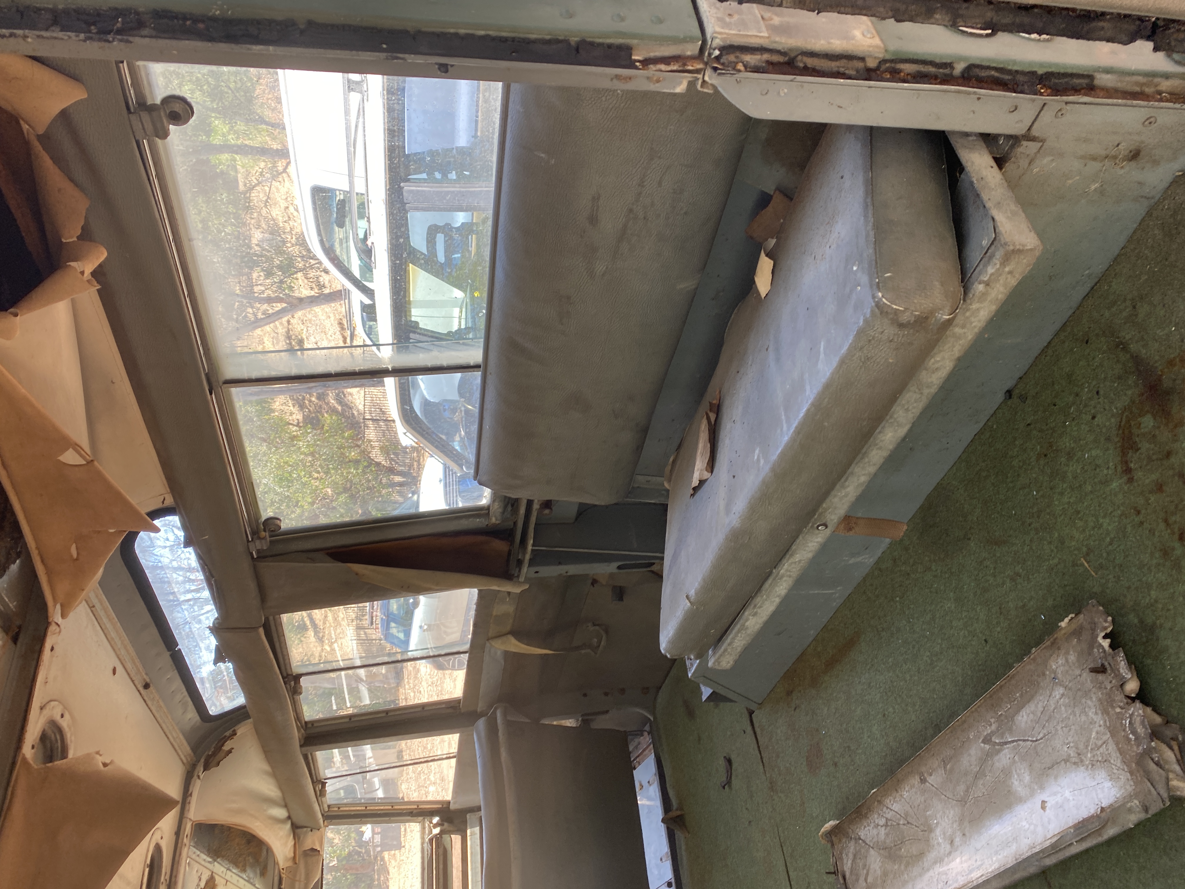

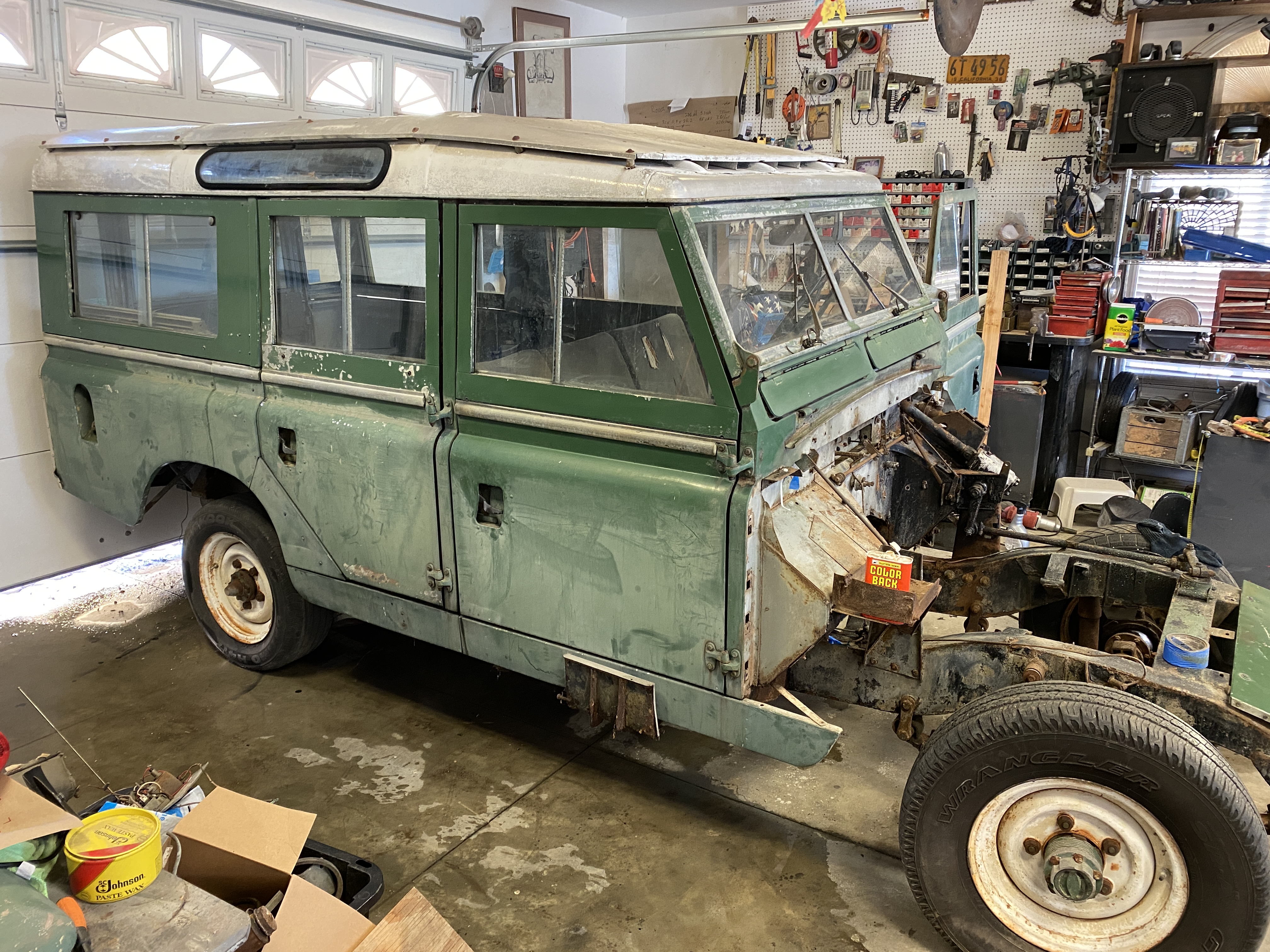

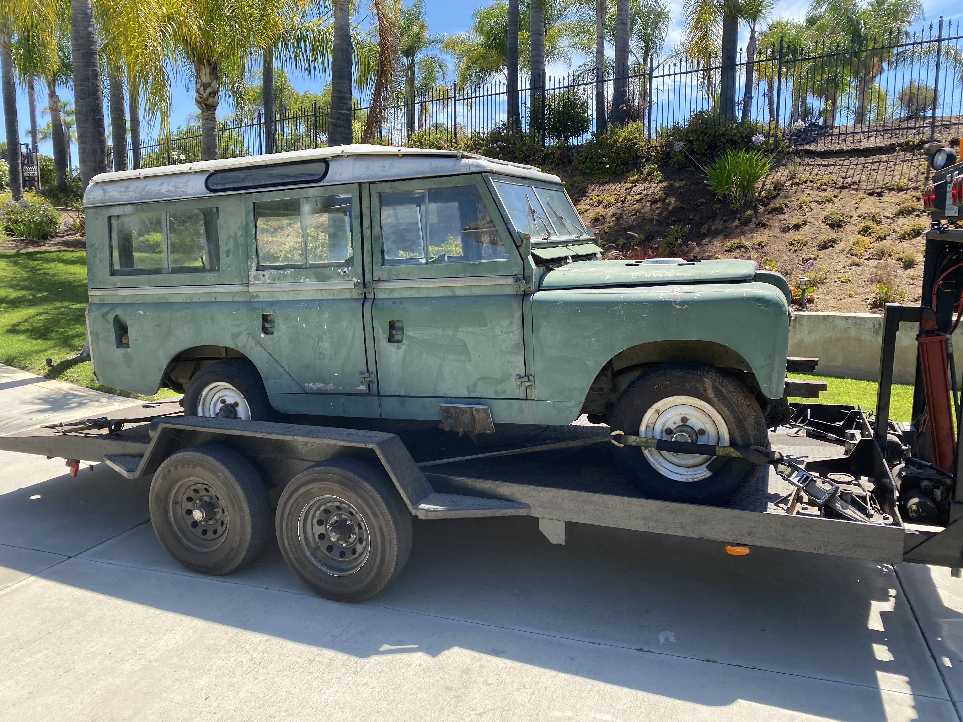

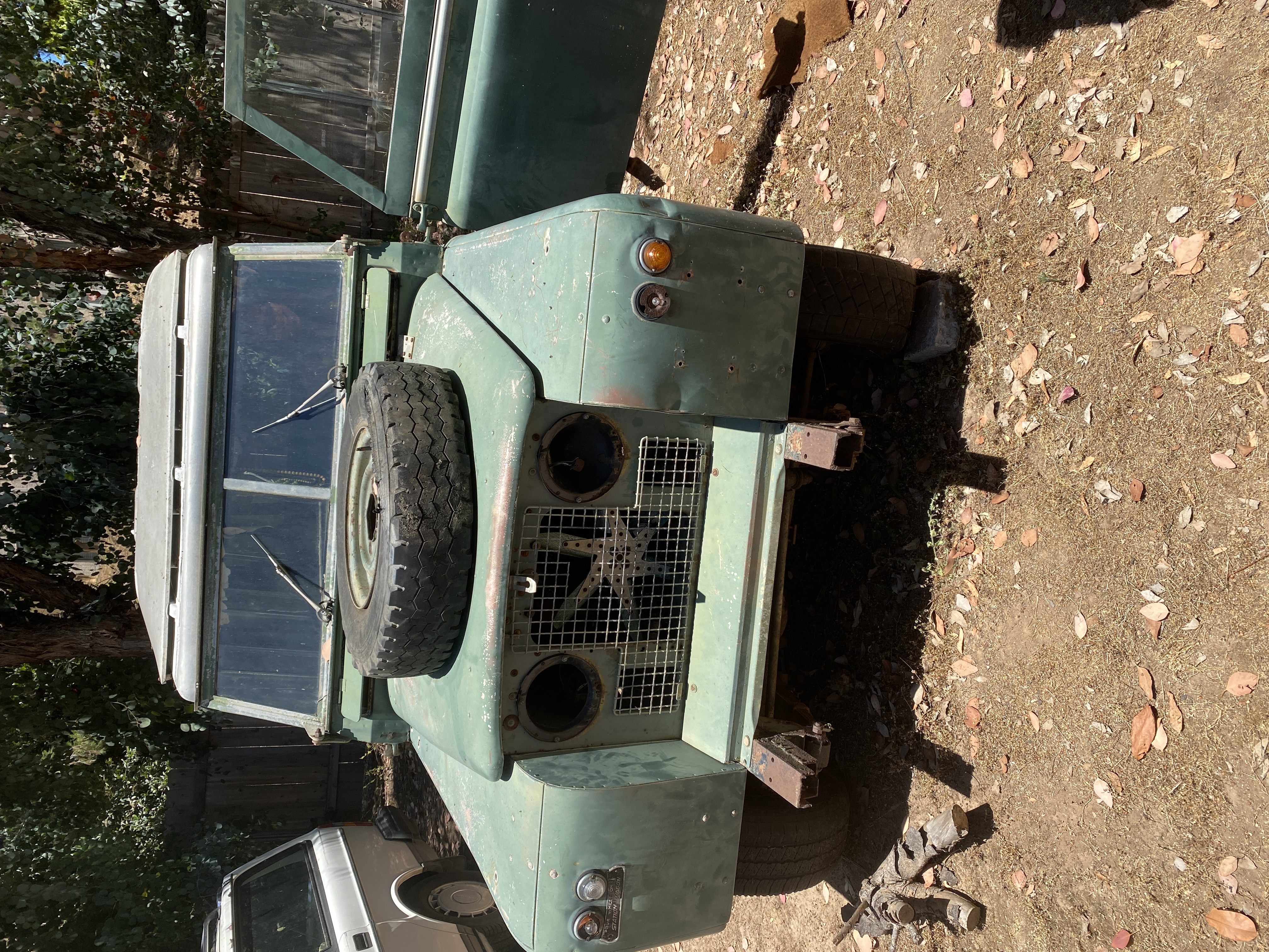

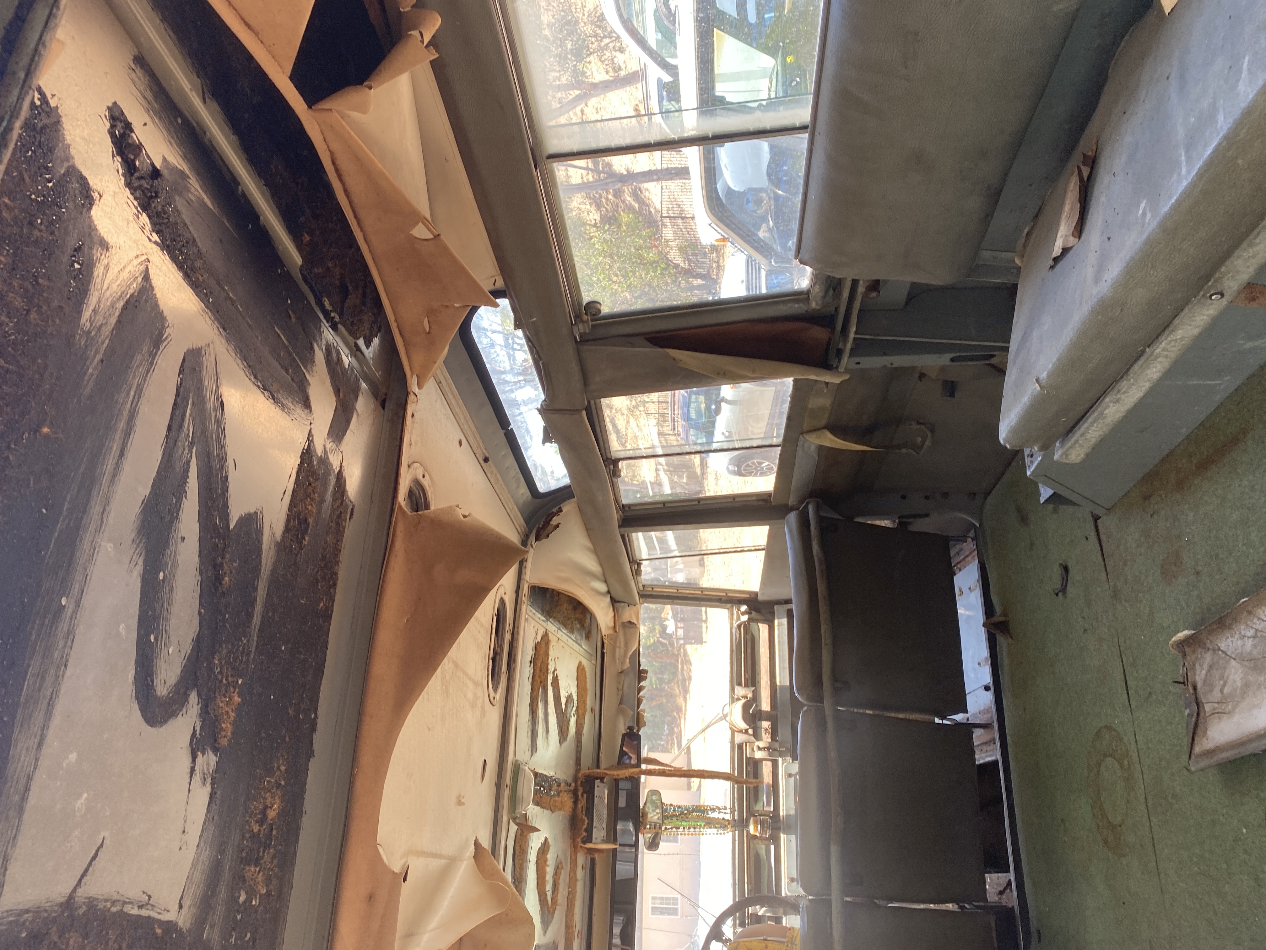

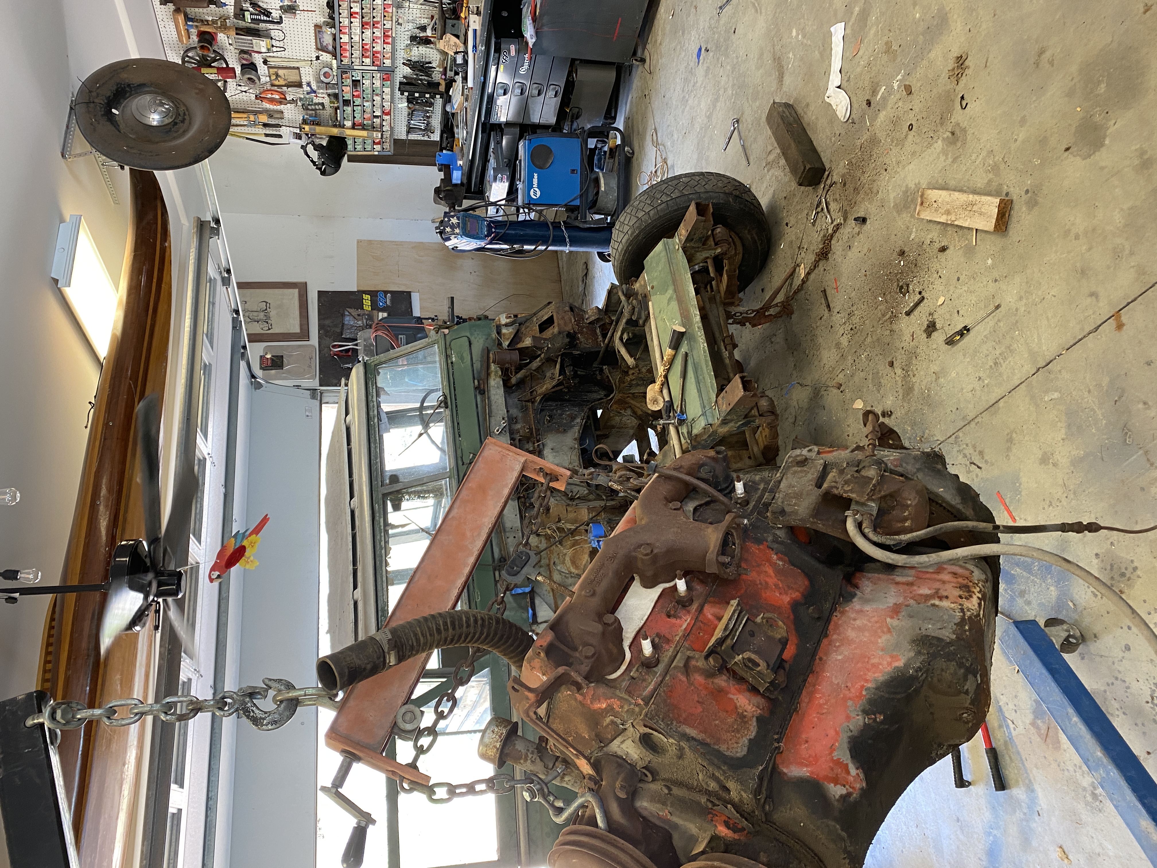

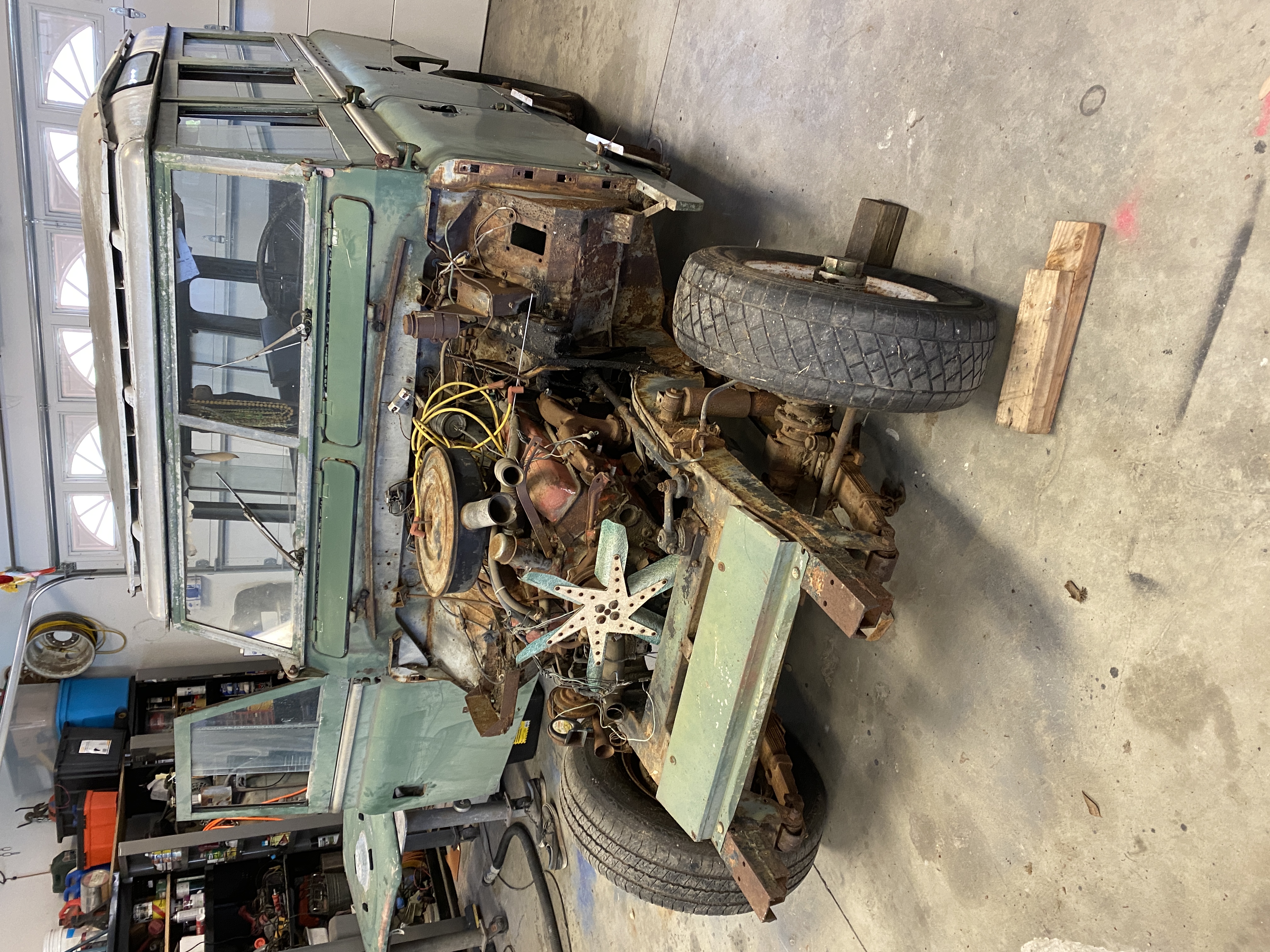

Thought I’d start a thread here to share my project. I picked up what I thought was a Land Rover “Defender”. Since then I have been “educated”. This is a bucket list vehicle for me as I have always loved the look. I’m a Tesla owner/fanboy so my project has to be Tesla based. My approach is not unique, rather it’s inspired by projects that I’ve seen on the web. The vehicle was an estate sale find, purchased and stored several years by the seller. Last registered in 1985. It had a non working V8 conversion. Anything rubber on the car was rotten and required/s replacement. I have recently finished rebuilding both axles including bearings, seals, and brake hardware.
1968 Land Rover Series 2a 109 Station Wagon
Hello All,
Thought I’d start a thread here to share my project. I picked up what I thought was a Land Rover “Defender”. Since then I have been “educated”. This is a bucket list vehicle for me as I have always loved the look. I’m a Tesla owner/fanboy so my project has to be Tesla based. My approach is not unique, rather it’s inspired by projects that I’ve seen on the web. The vehicle was an estate sale find, purchased and stored several years by the seller. Last registered in 1985. It had a non working V8 conversion. Anything rubber on the car was rotten and required/s replacement. I have recently finished rebuilding both axles including bearings, seals, and brake hardware.![Image]()
Re: 1968 Land Rover Series 2a 109 Station Wagon

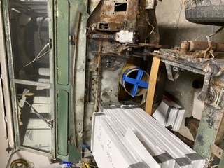

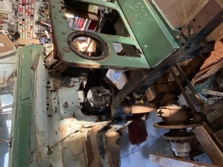

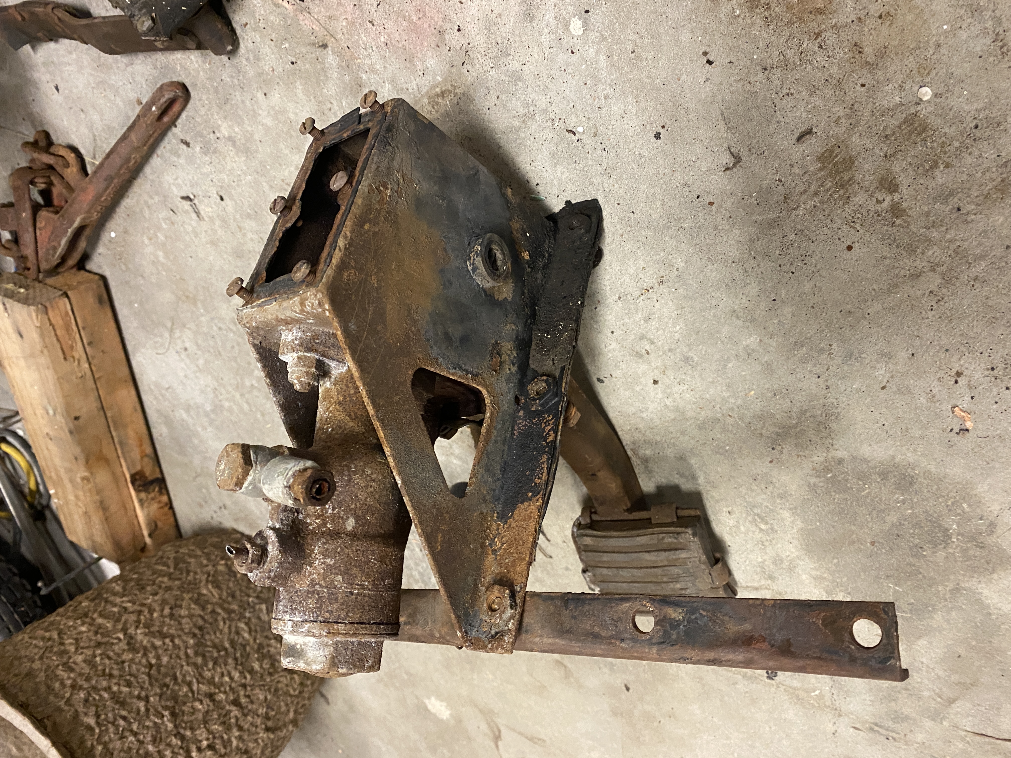

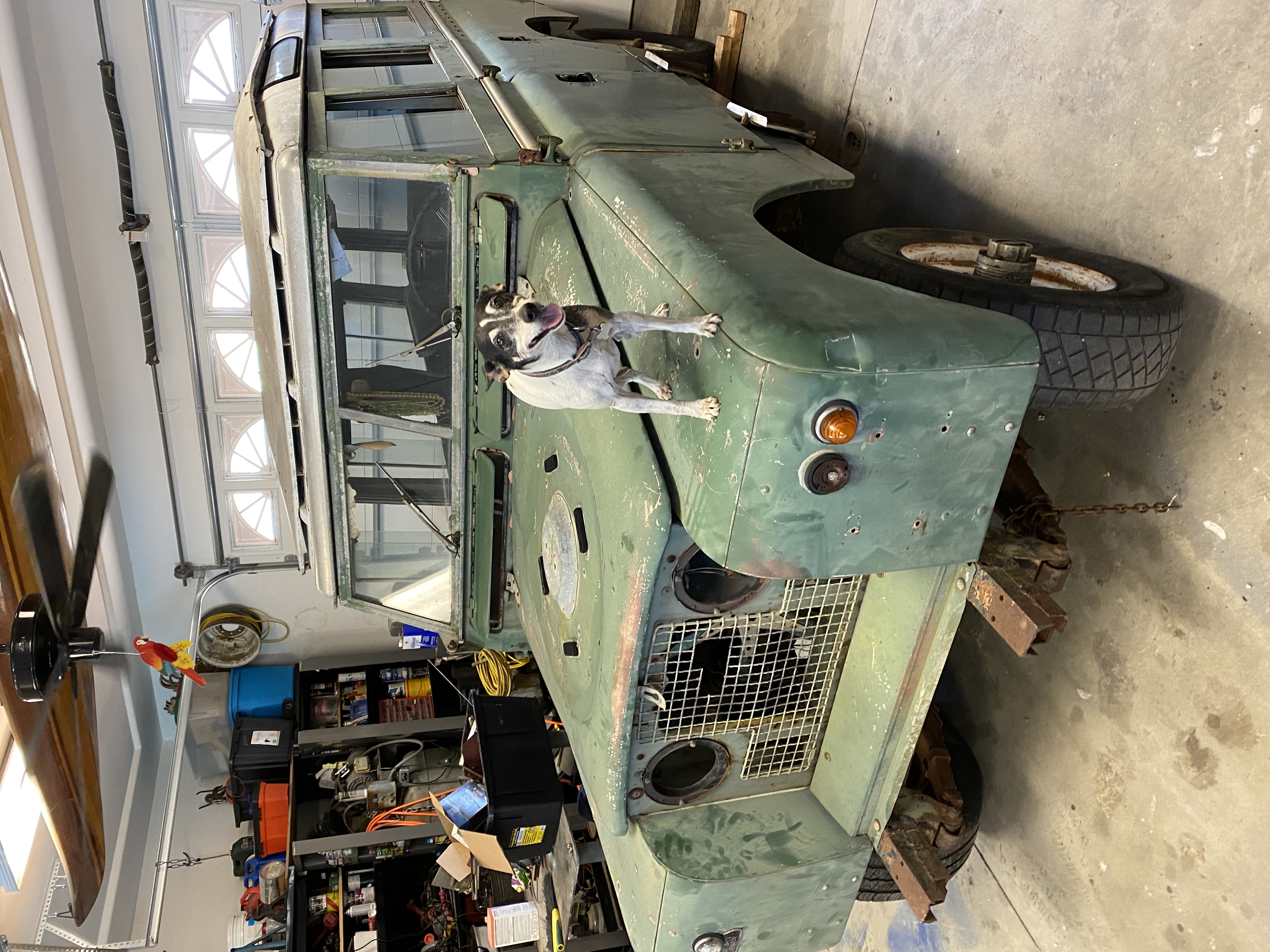

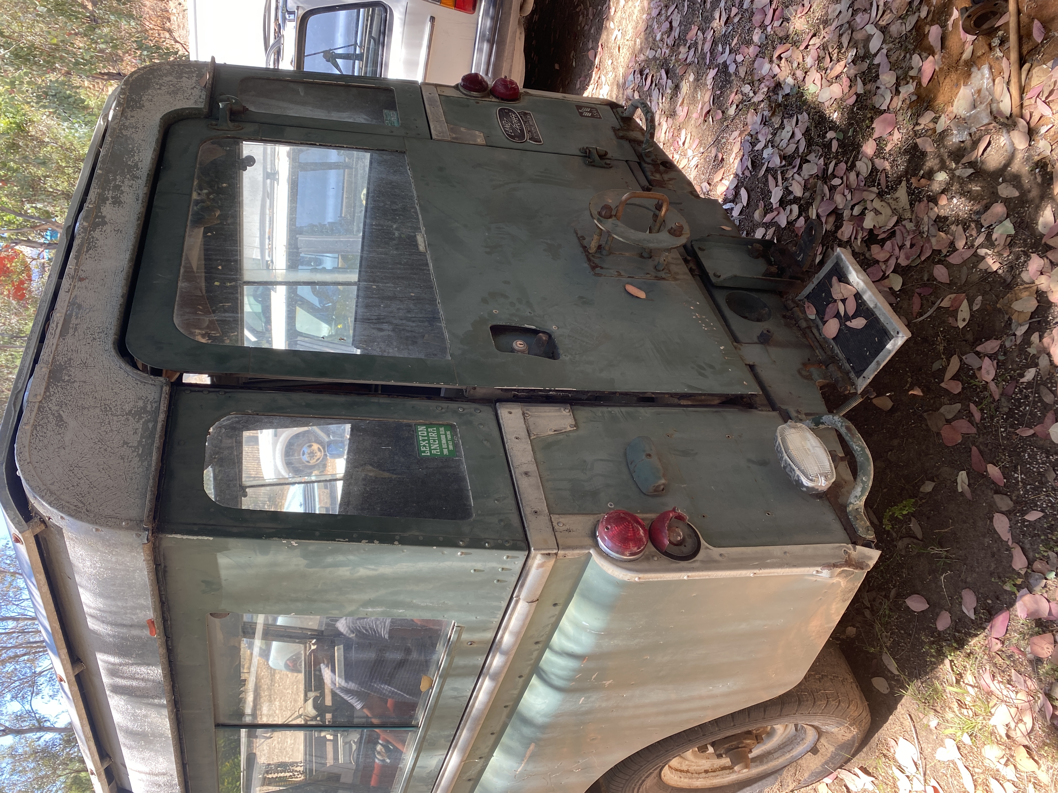

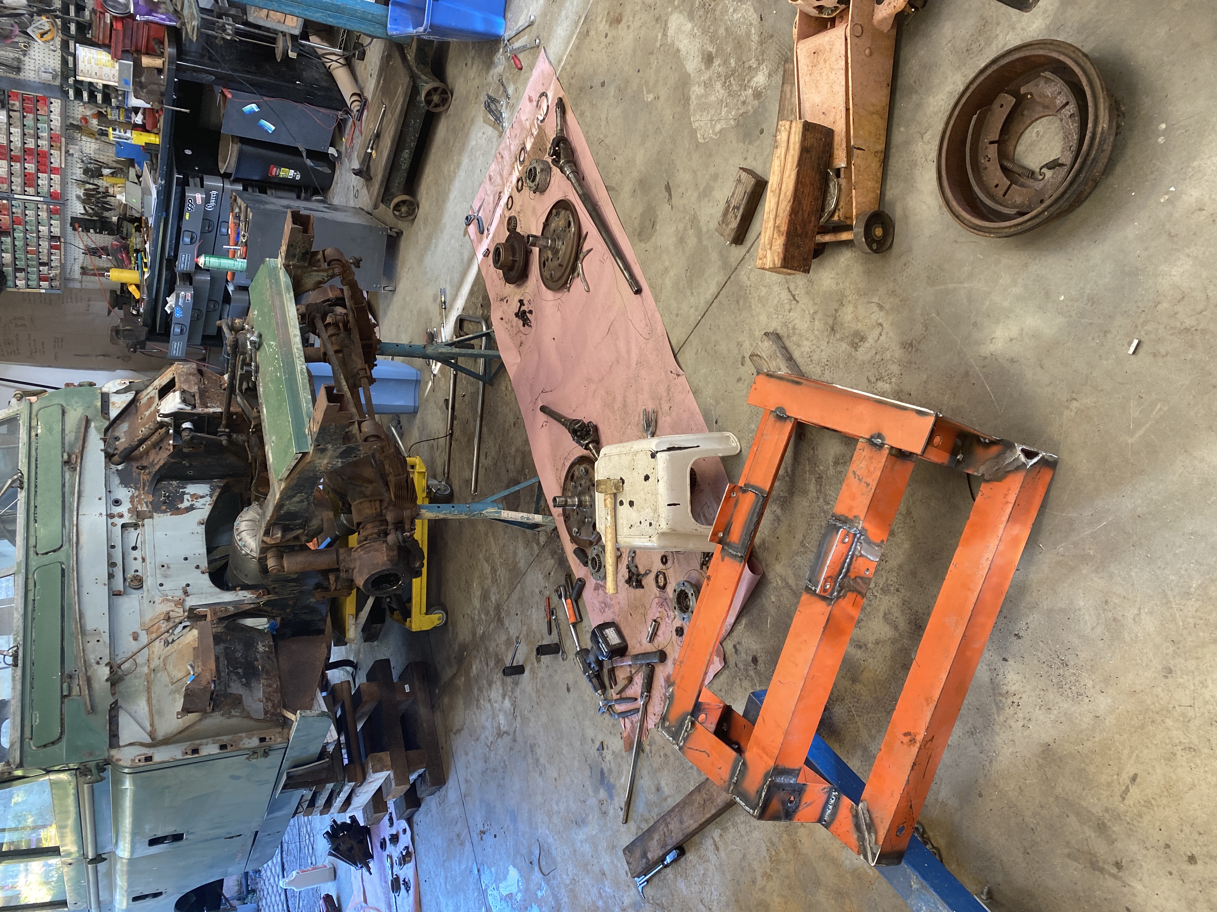

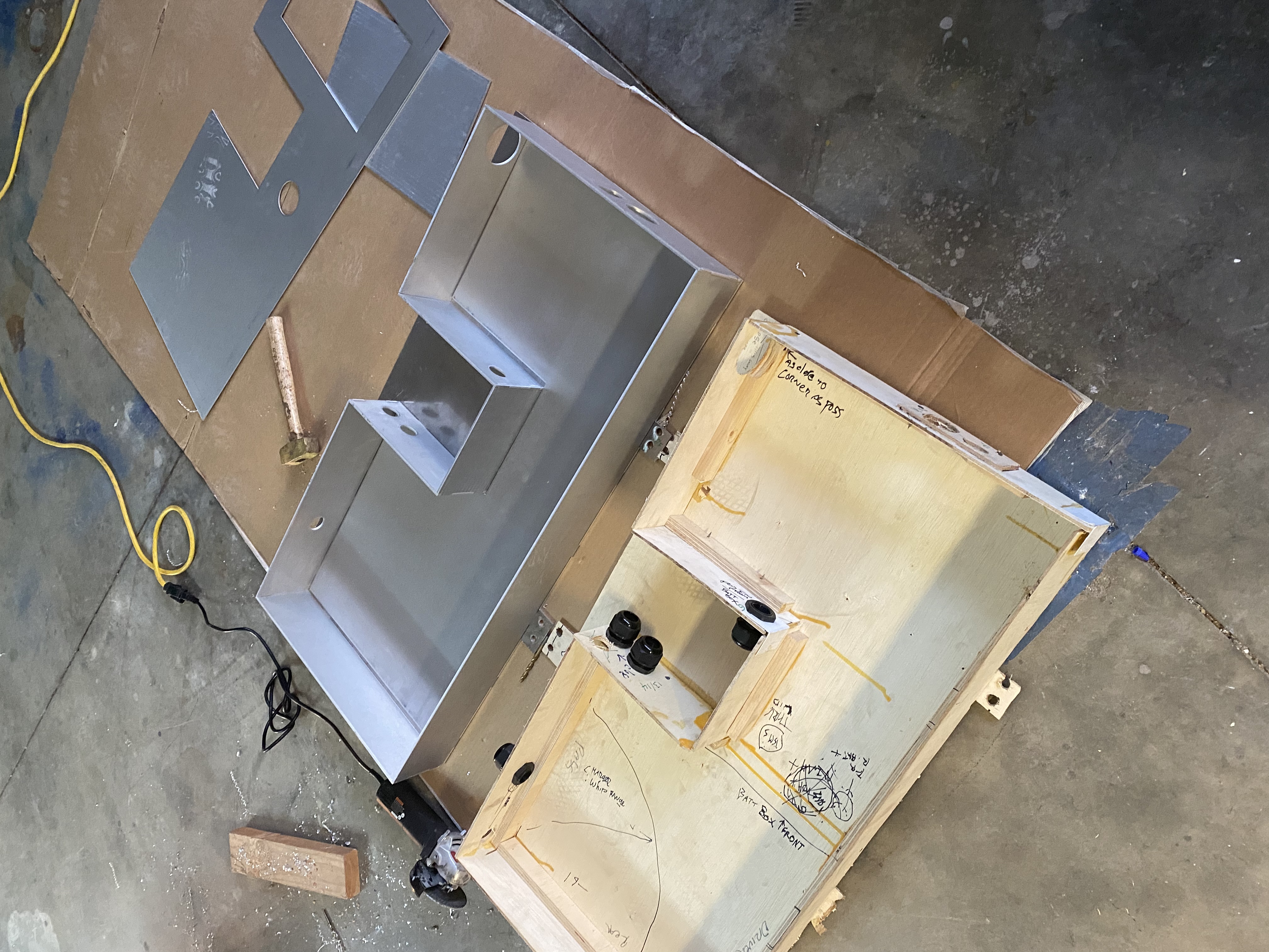

More pictures. Not sure why pictures are rotated but if you click on them they rotate properly. Here is axle tear down. Pictures of the motor mounted into position. Note the 90* rotation of the motor to supply power to both front and rear axles.

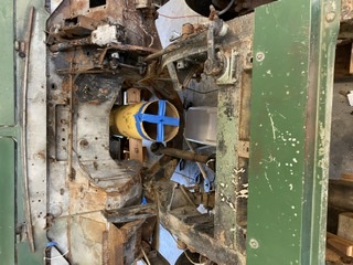

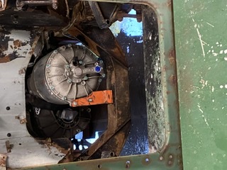

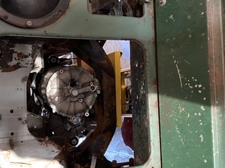

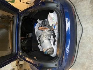

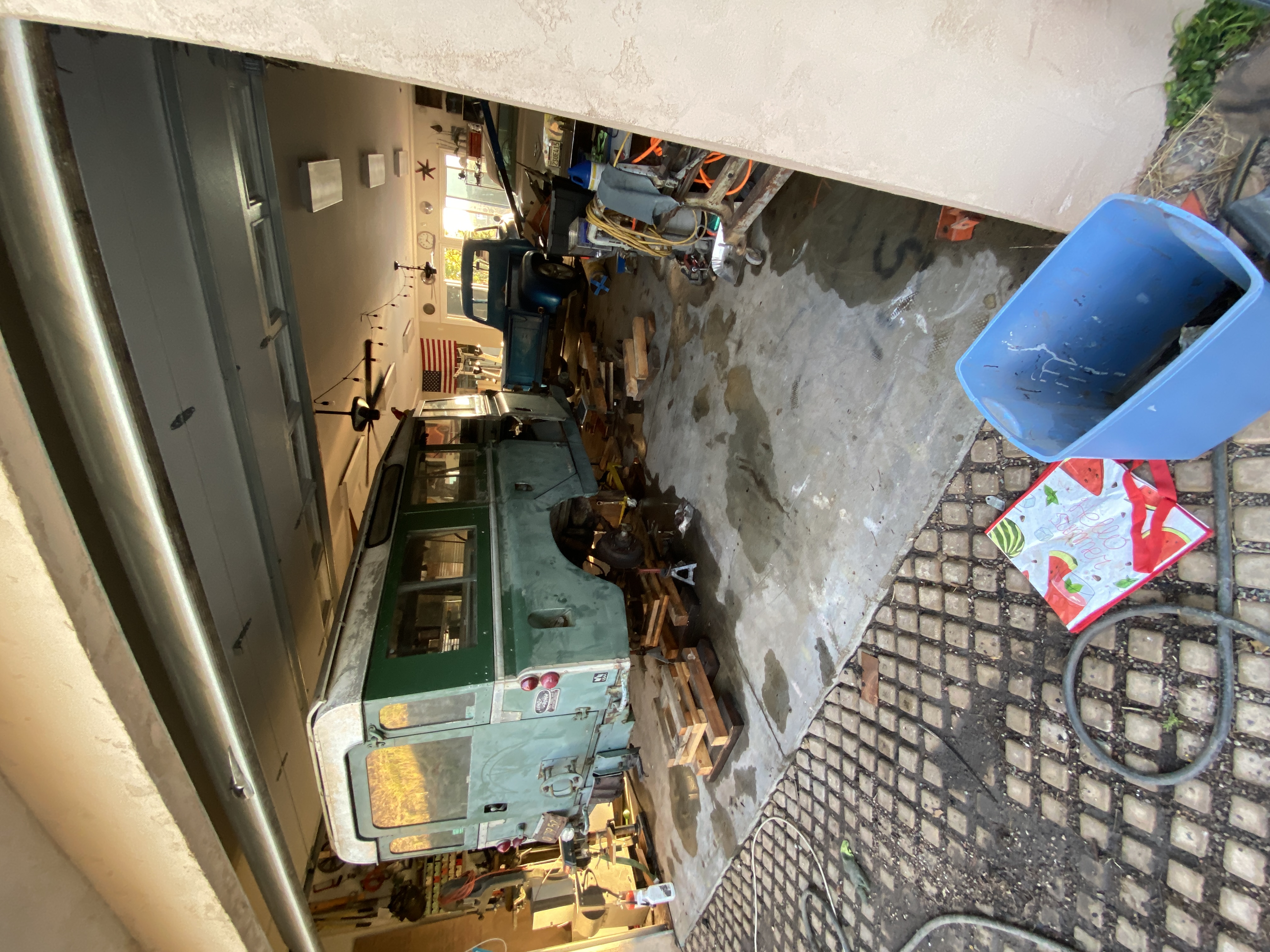

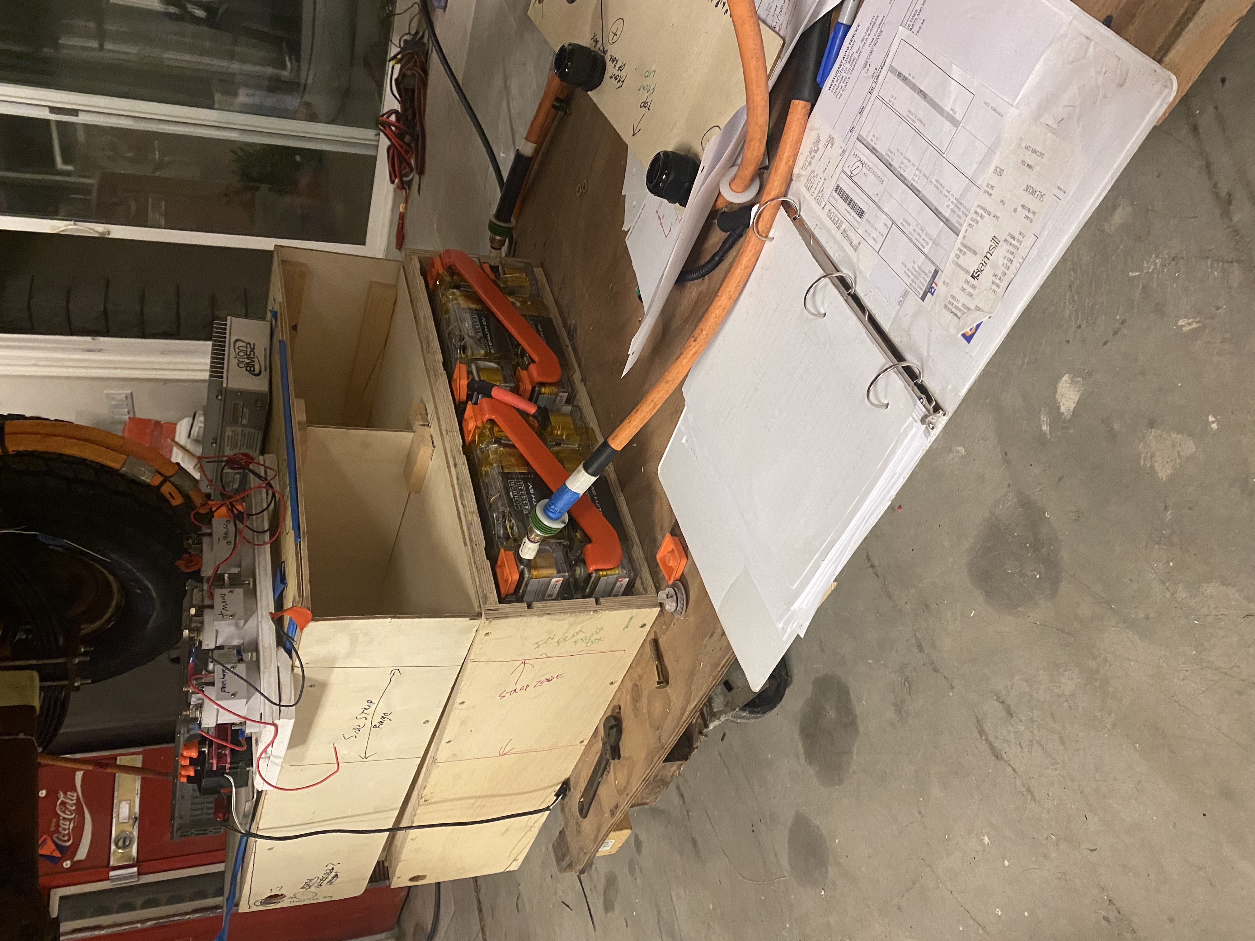

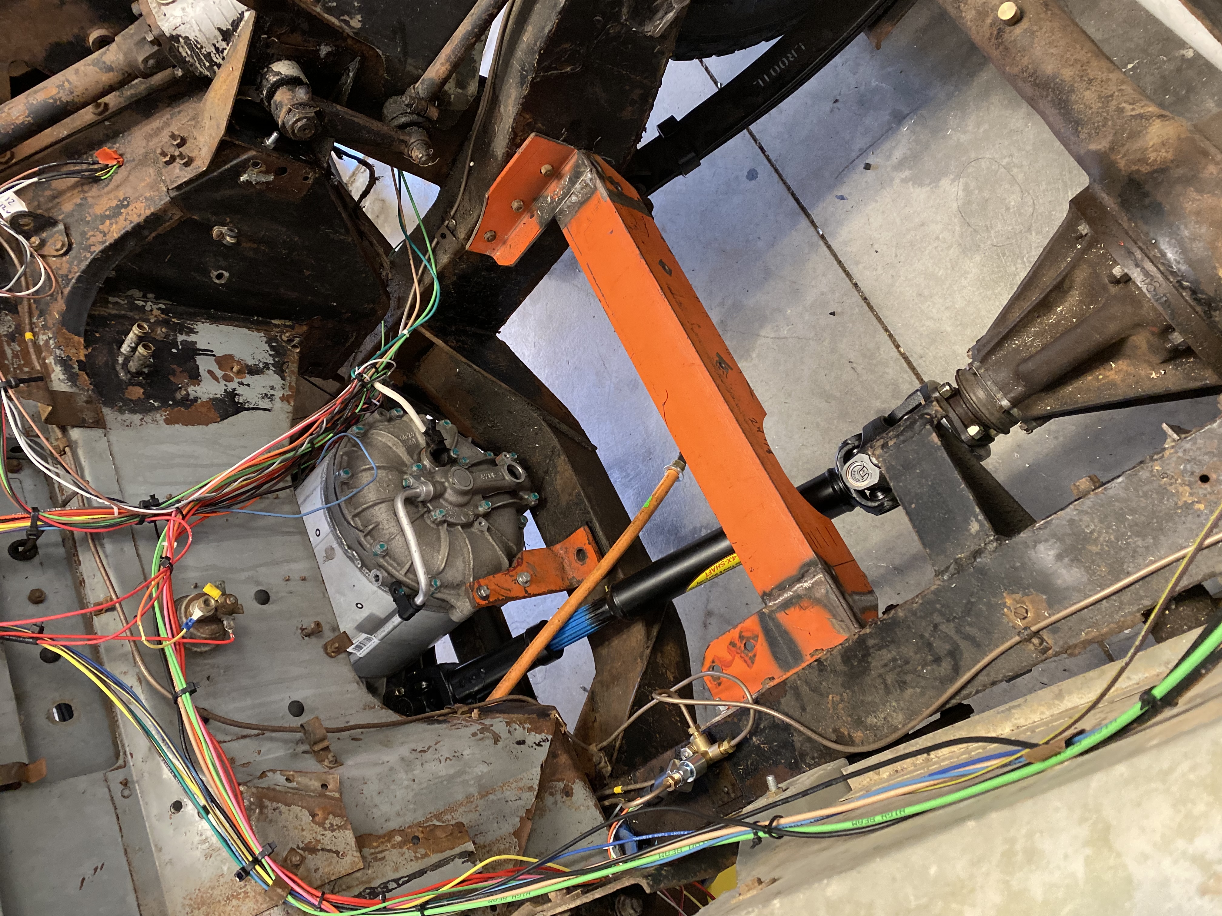

Did some trial fitting of motor and batteries using templates then brought home a LDU

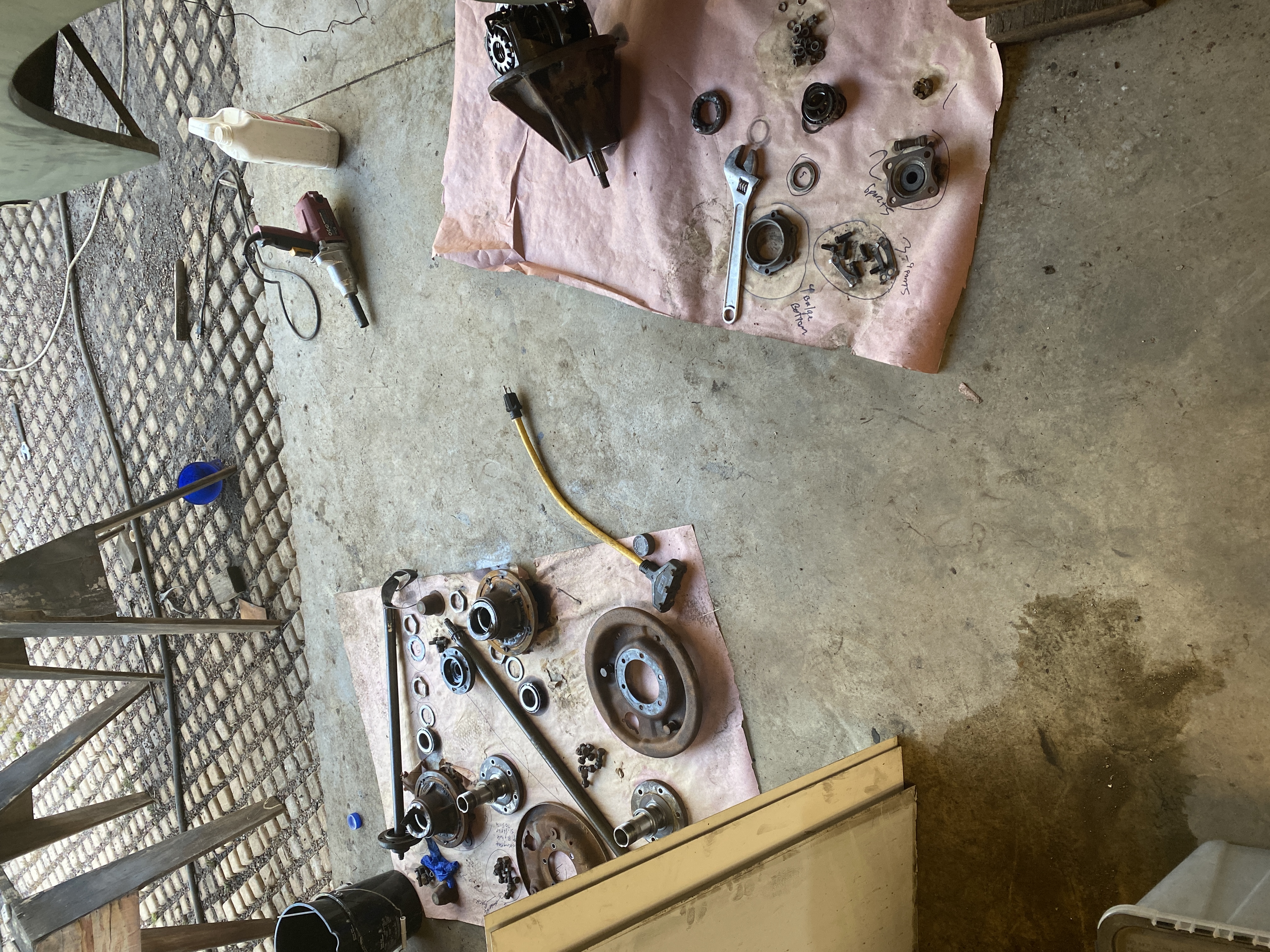

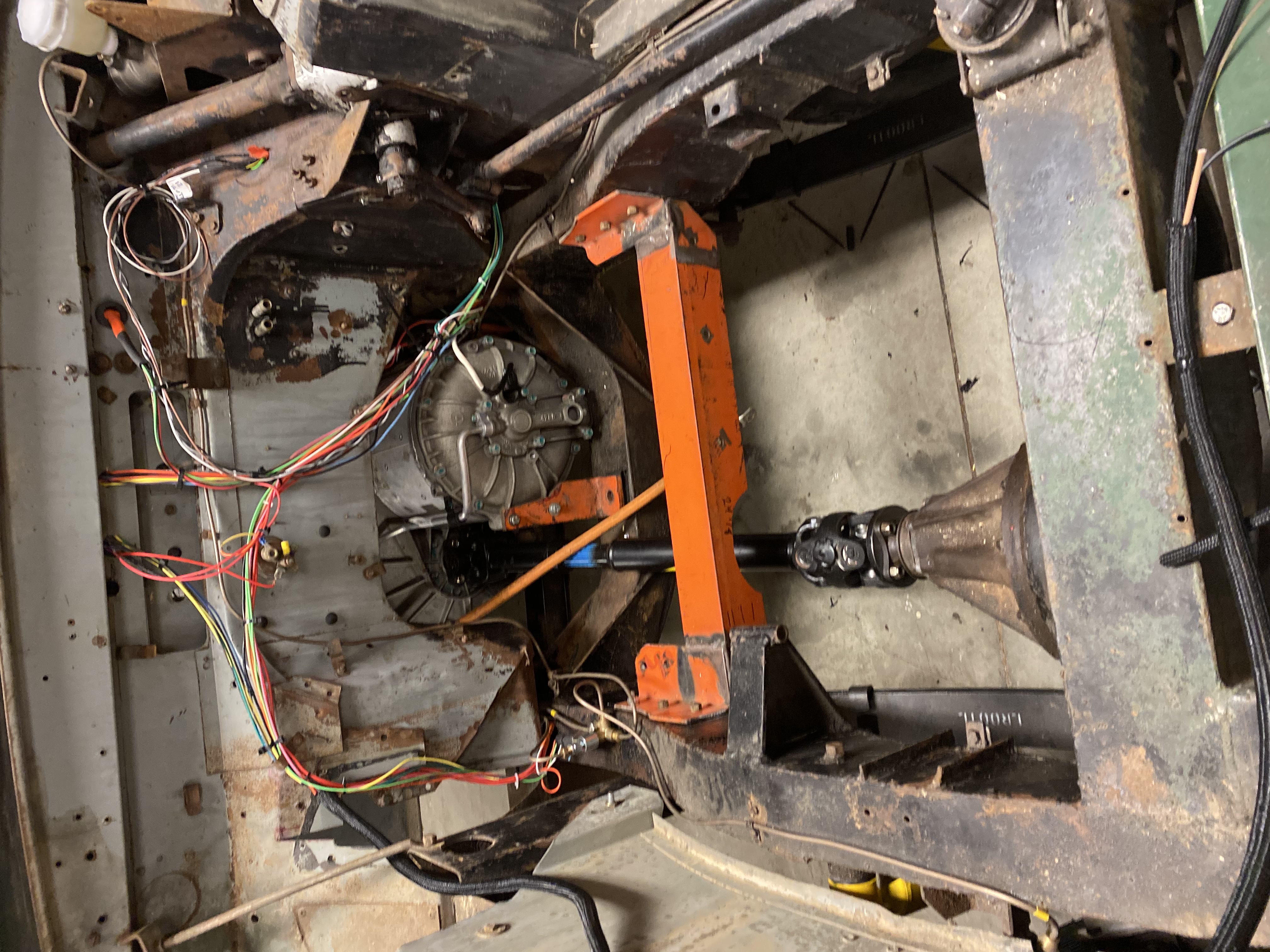

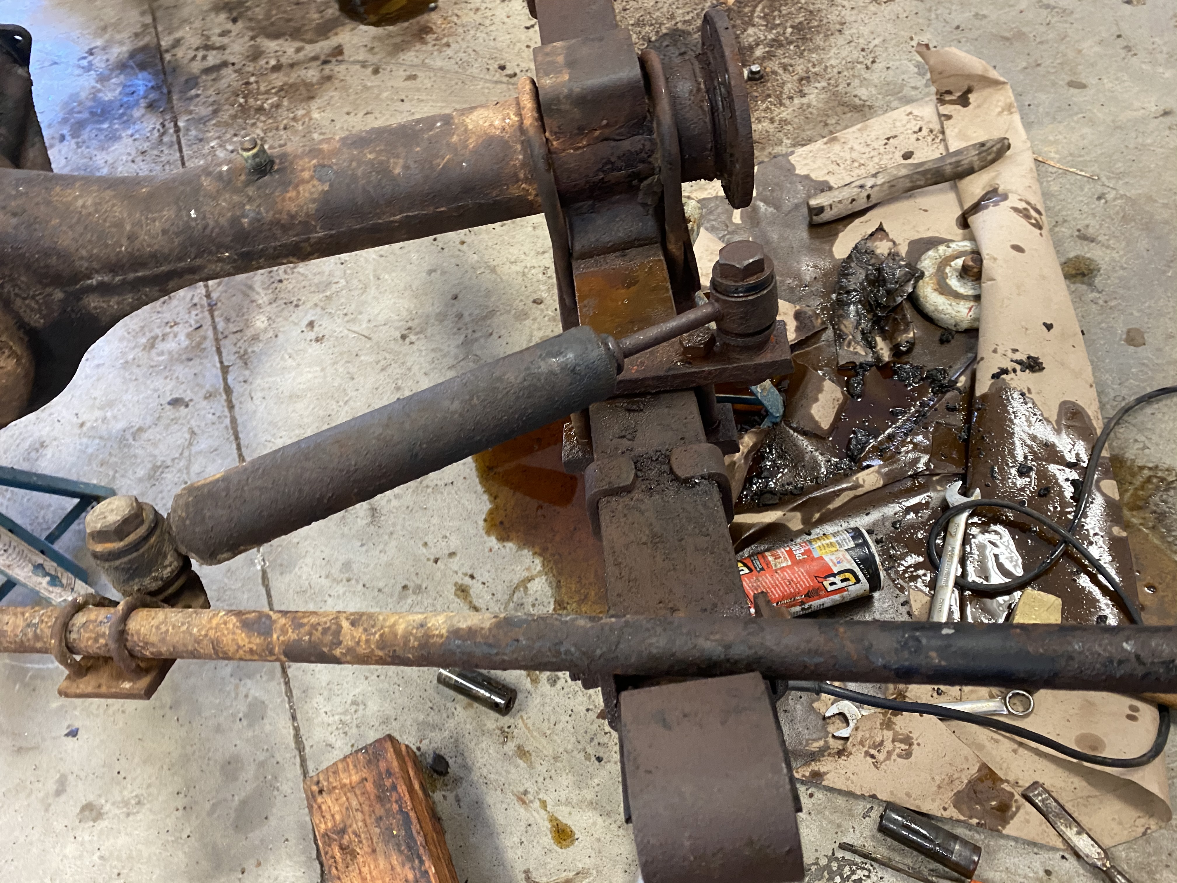

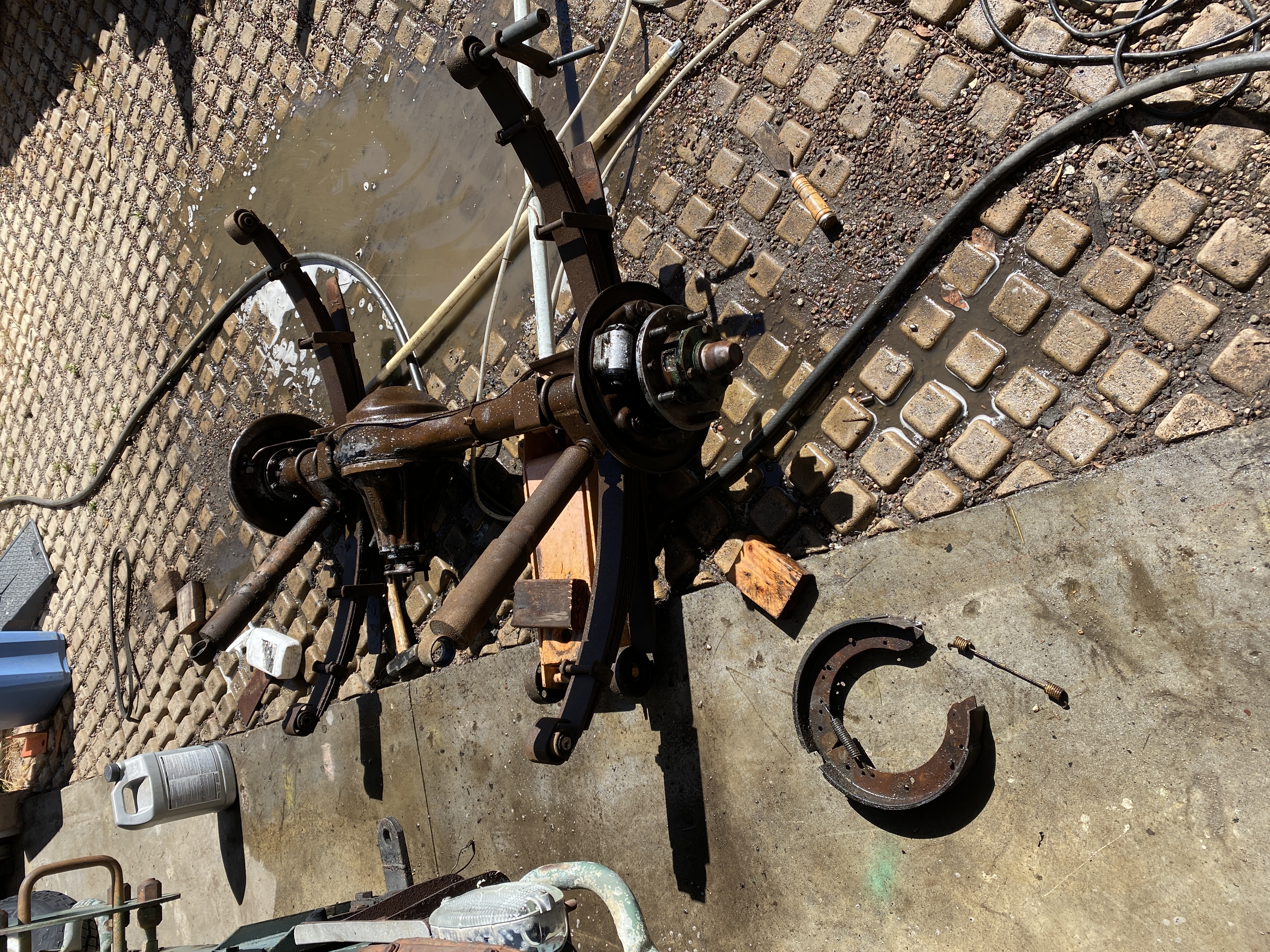

Continued working on the axles and ordered an openinverter board.

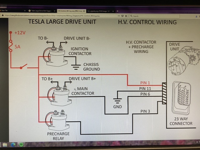

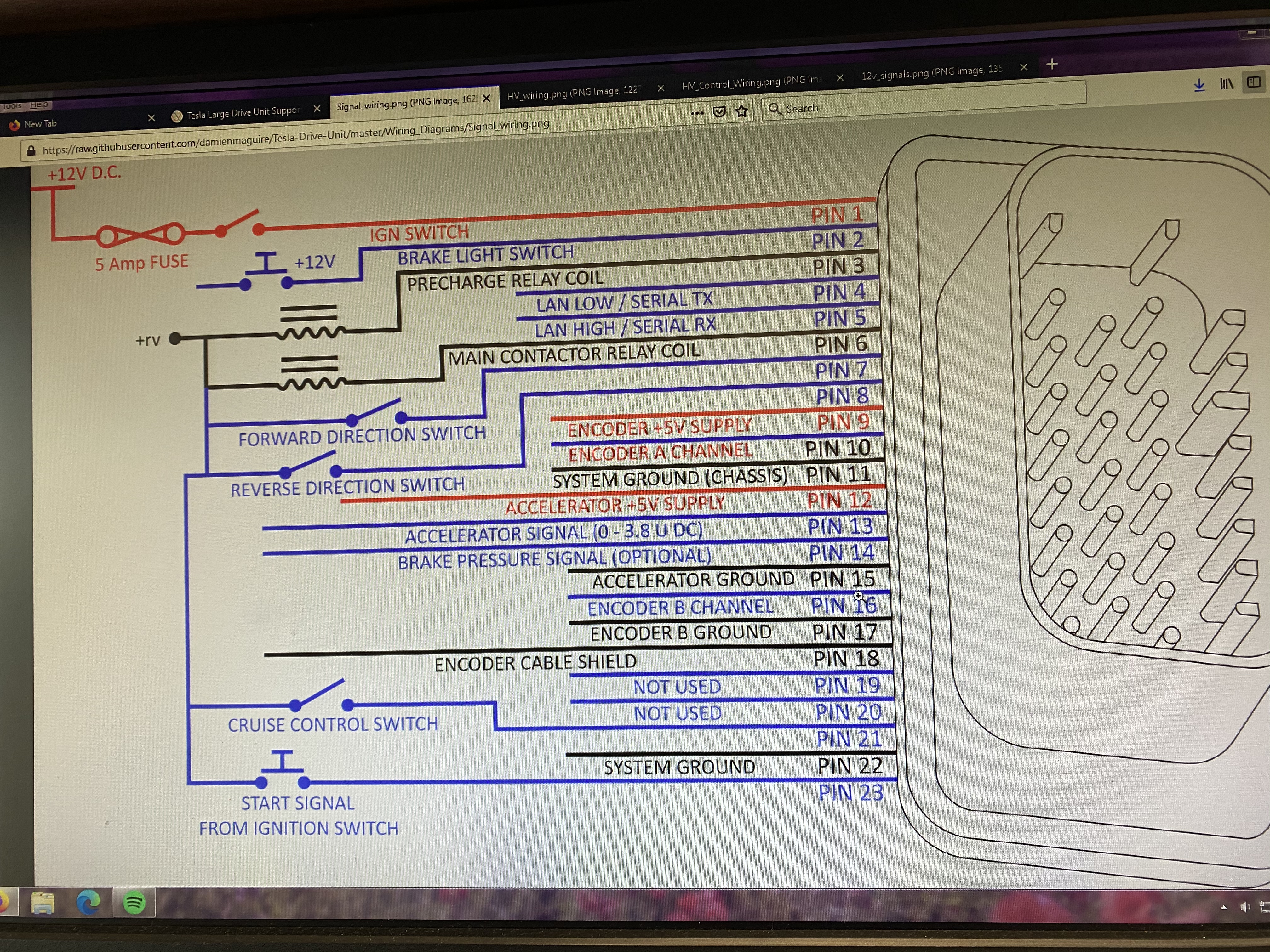

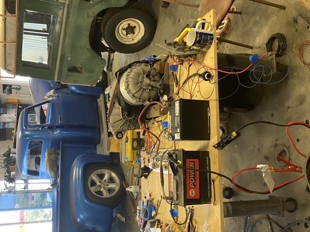

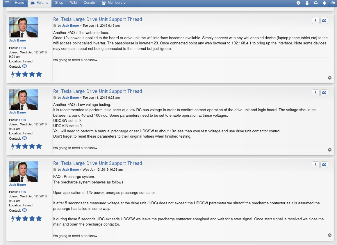

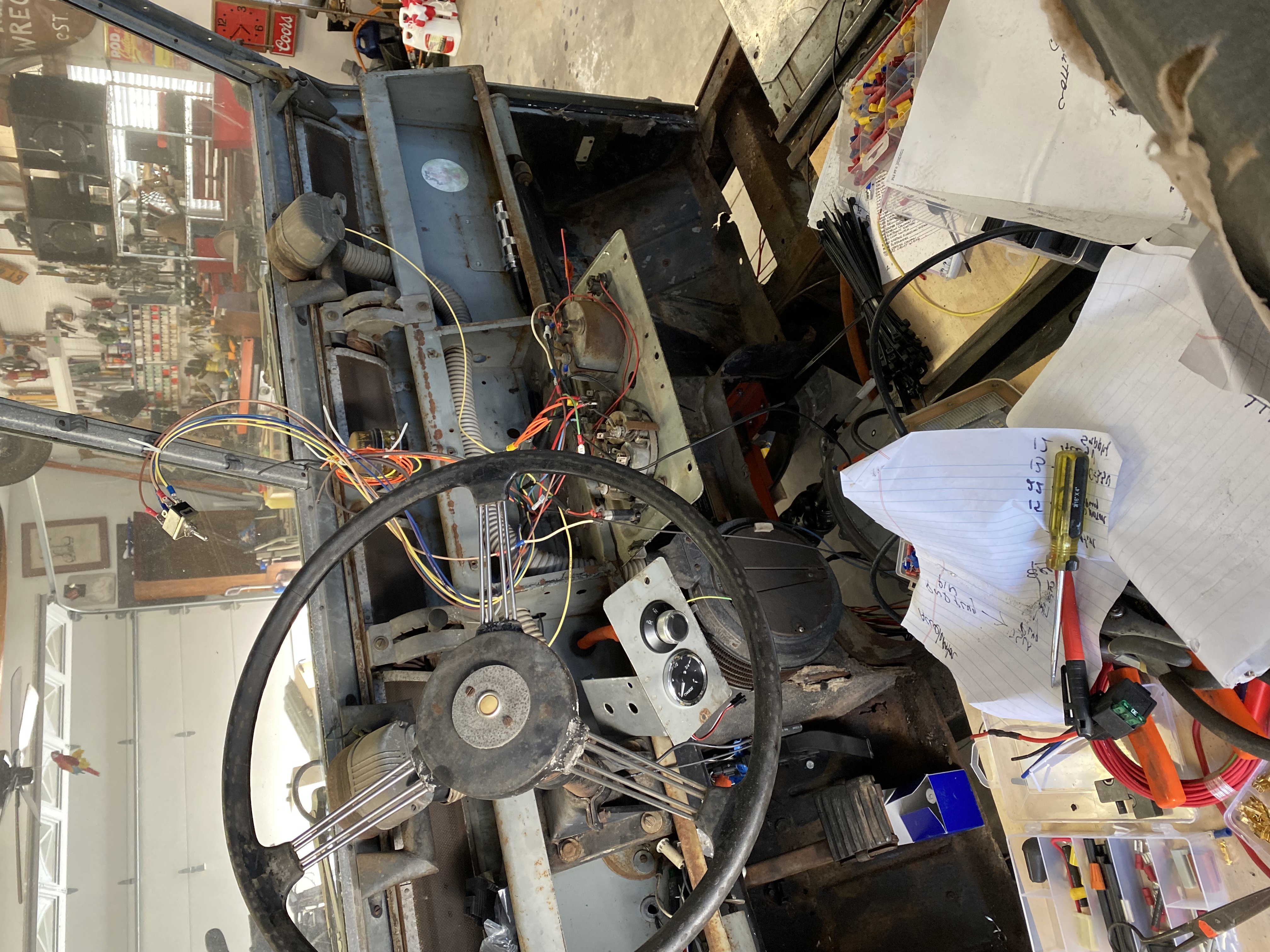

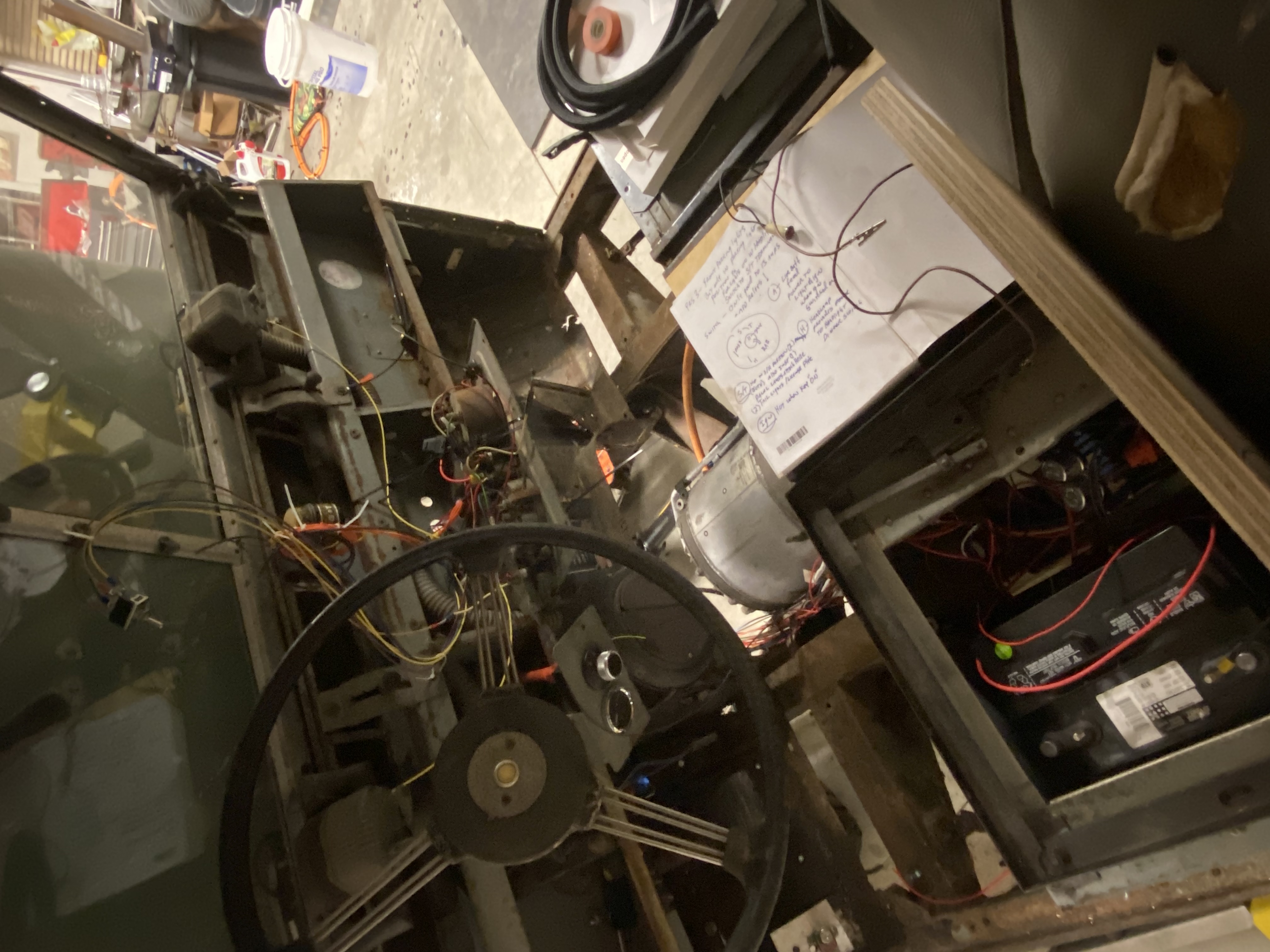

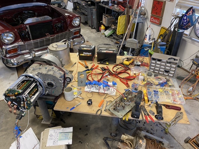

This brings me up to date. Currently I am working on bench testing the setup. Unfortunately I have not sourced the tesla battery modules yet. I have leads but nothing concrete yet.
I was able to log on to WiFi after having to ask here
Couple issues I’m working through right now is
1)What is the lowest voltage I can bench test the motor? I currently have 24 volts available
2)Which parameters should be changed to reflect reduced voltage
3)How is the main contractor actuated. Write up says momentary starter switch but wiring diagram shows all 3 contractors actuated by ignition switch and main contractor activated through pin 23??
I am by no means an electrical engineer or computer whiz. I fear I’m dangerous
Can't answer you voltage question for certain but I have heard of people testing toyota motors at 48V.
That's an insane amount of power! I hope you have a plan to upgrade the strength of the axles. Series 2 landrover axles weren't the most robust at the best of time. Just strong enough to cope with 80hp most of the time.

You'll definitely want to watch the half shafts and diffs if you are going to put all that tesla power through it. Restomodders will commonly fit 450hp LS3 V8 engines into Defenders in the US and they are known to snap half shafts. Not sure if you can fit Salisbury Axles to a Series 2, but those are a very strong Differential available for Defenders, not common though.

There are aftermarket half shafts available that appear much stronger. I probably will explore dialing down the HP in the parameter settings. For now this thing has no seat belts and no real safety features compared to modern cars so I plan on taking it easy. Anyone know are the blue lines on the wiring diagram switched negative? I think that may be one of my issues.

1. 24 volts should work fine, just ahs to be able to supply enough current to get rotor to spin
2. Don't worry about this for now, just try to get it spinning in manual mode. Once you've done that, check out the "schematics and instructions" section on the wiki for some step by step instructions on how to get things up and running.
3. Yes the contactors are low side switched (switched negative).

I guess manual mode isn't needed if you have a drop in board (read: ignore that). It's usually used for testing the bare bones functionality of an unknown motor or inverter by setting some parameters to have it spin at a fixed frequency. But, again most everything you have a question about may be answered on Damien's Github. Also, from the LDU support thread:
I advise you to go to that thread and search for whatever you may need. Enjoy!

Tried again last night with the 24 volts. No luck. On page 8 of the LDU thread see what I can find...
Page 20. May have just tripped on a you tube video to help decipher this schematic...
Specifically what does +rv mean...and where does positive come from to supply all low side( blue) lines?? I fear I’m out of my depth...
look at the first page of the Large Drive Unit Support Thread.
Lol. No reference as to what +rv means there.. I don’t have the courage to ask these questions on the main board.. Just hoping someone will take pity on me in exchange for some progress pics..
- muehlpower
- Posts: 807
- Been thanked: 188 times
look at the pictures , you can see that the contactors are connected to switched +12V, just like the signal switches for forward and backward and start.
That means +rv is actually in a normal car the ignition key (terminal 15). now clear?

Ref this thread and the attached guide :
viewtopic.php?f=18&t=565
I know Tesla stuff has this aura of complexity that some like to encourage but we don't do that here. To run any Tesla drive unit with an openinverter board just needs a throttle signal and a few 12v inputs. Thats it. No magic. So slow down and read your way smart before doing:)

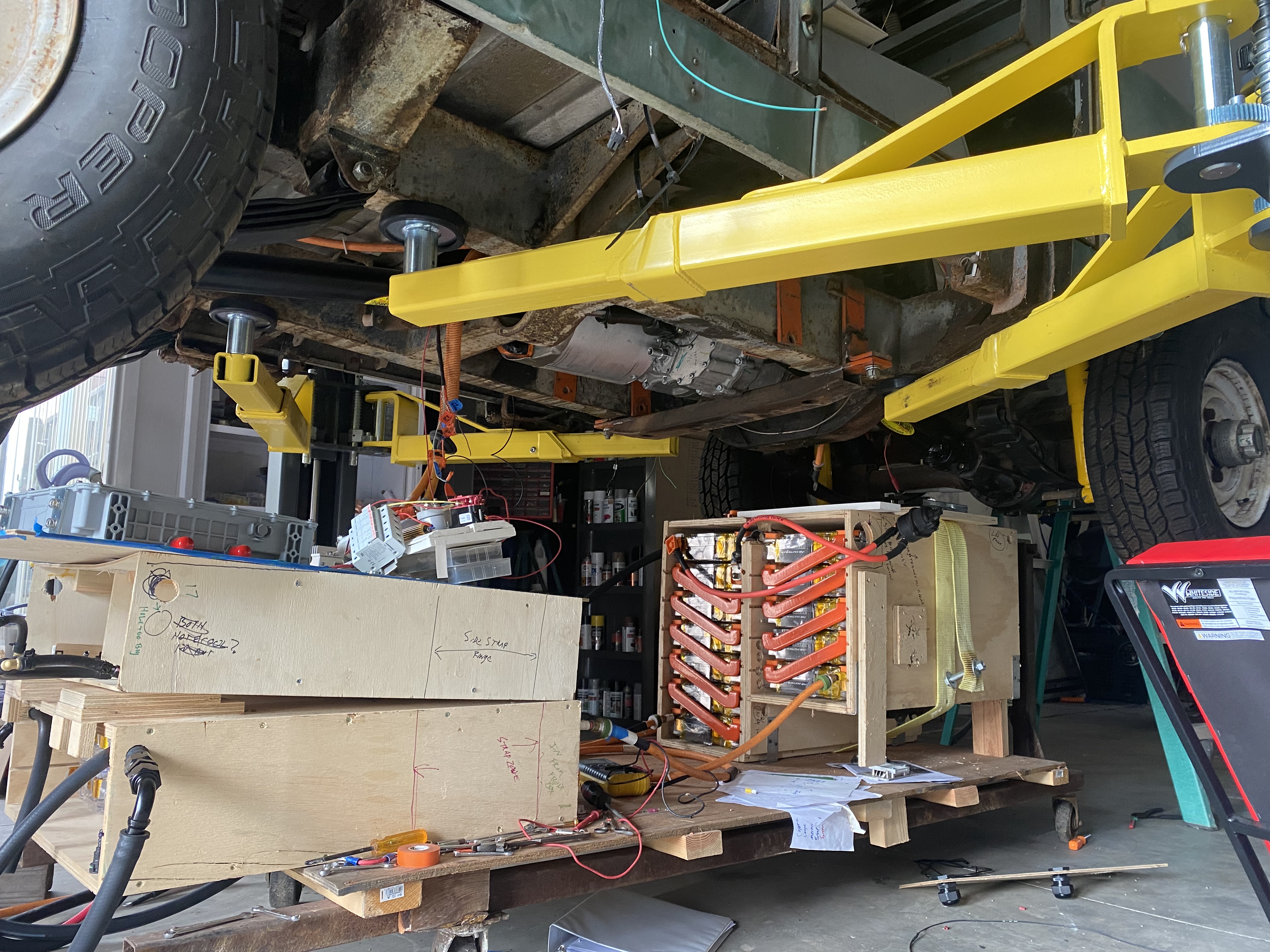

All the bits and pieces have been coming in including 85 Kw battery pack, Orion BMS, and I put the money down for the rear gearset with ampREVOLT with the promise it would be arriving to their shop before the end of the month...

Any luck getting that motor spinning? I am kinda trying to understand what +rv means as well. Watched roadster cycles videos a million times. Wish I could see where all the wires were going on his switchboard.
I understand that +rv stands for variable voltage with a quick google search. This makes me think that it has something to do with the throttle input.
Terminal 15 is labeled as accelerator ground on the chart provided. So does that mean that all the blue wires connect to +rv wich is terminal 15(accelorator ground)?
