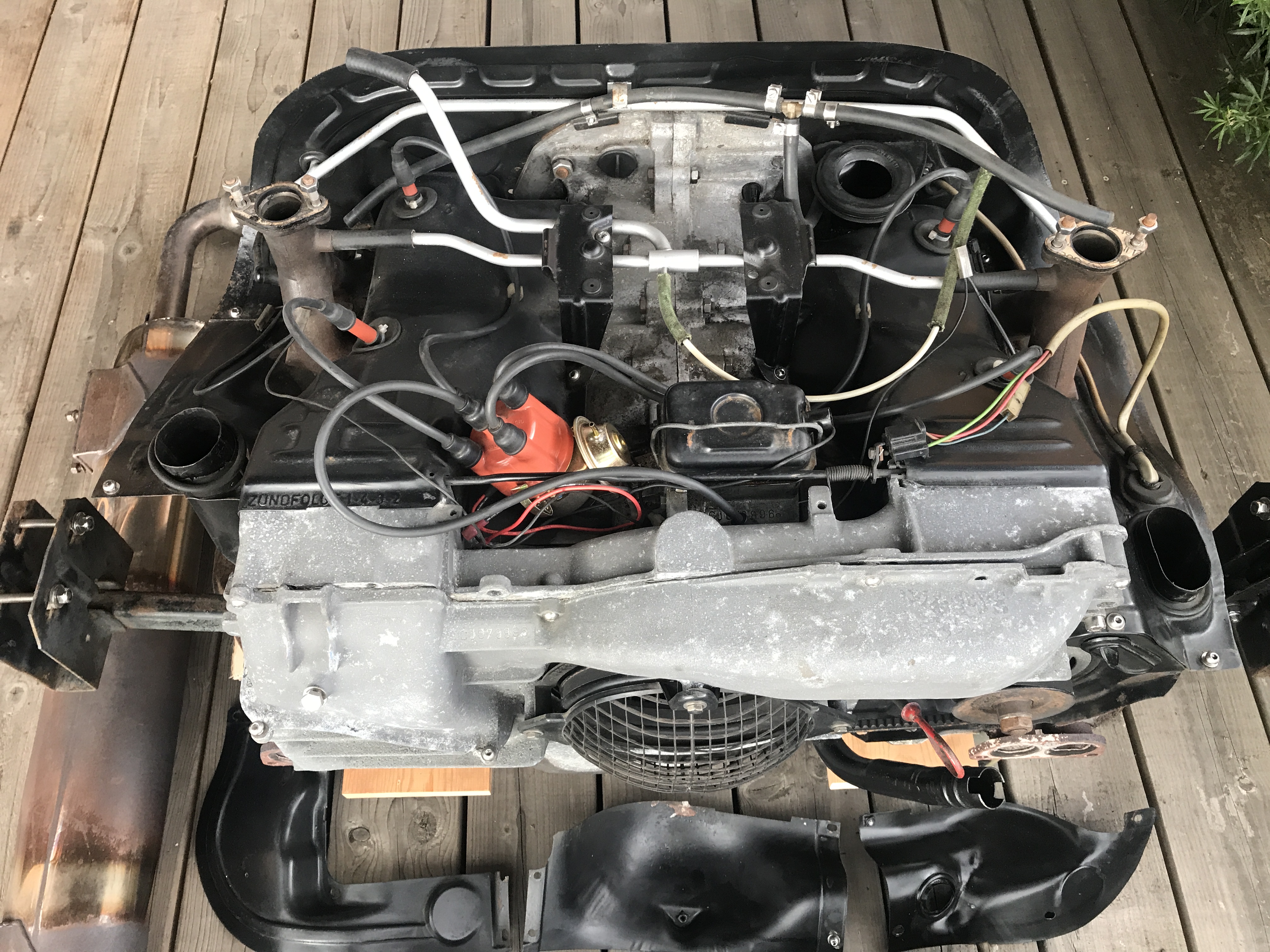

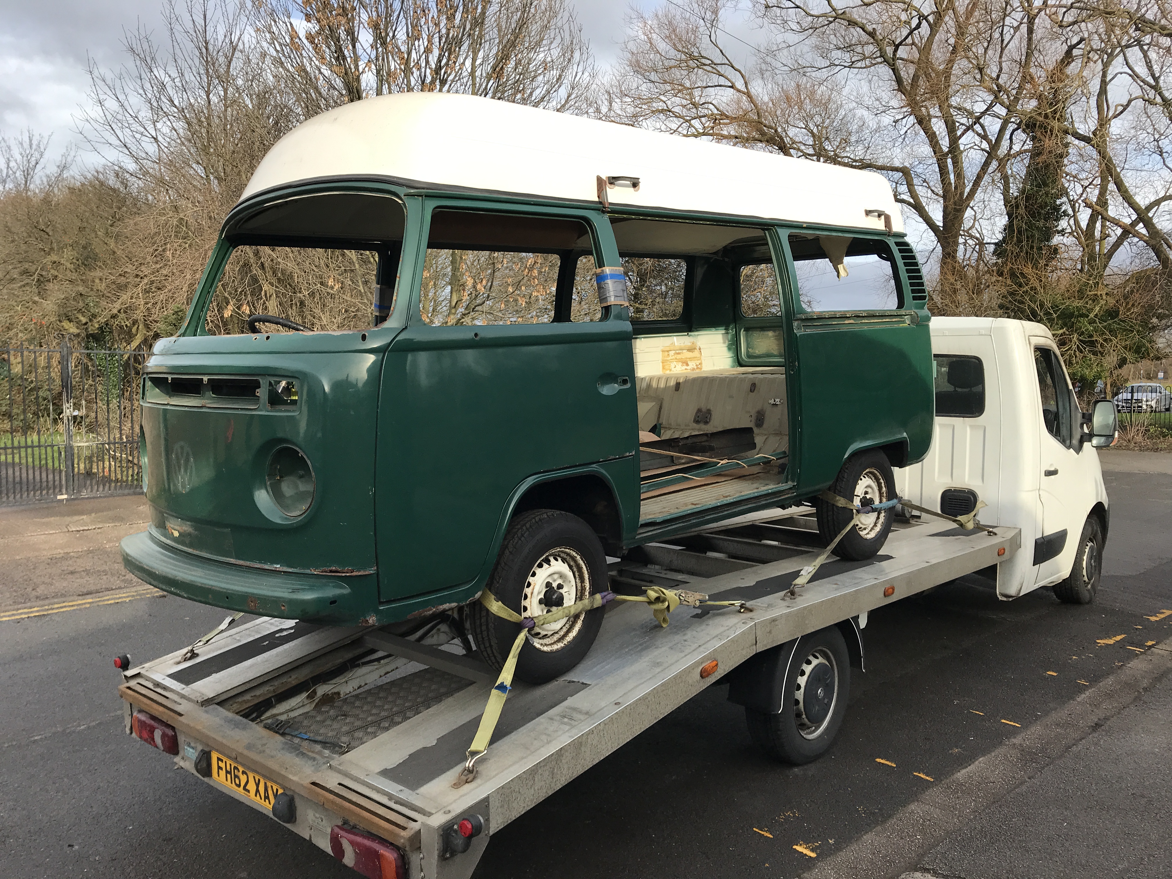

I'm starting a new thread for my project. It will be a while before I make any progress but I've just put the engine up for sale.
This marks the point of no return!

You will propably get good money from that type4 engine to get you a nice electric motor!
Good luck!

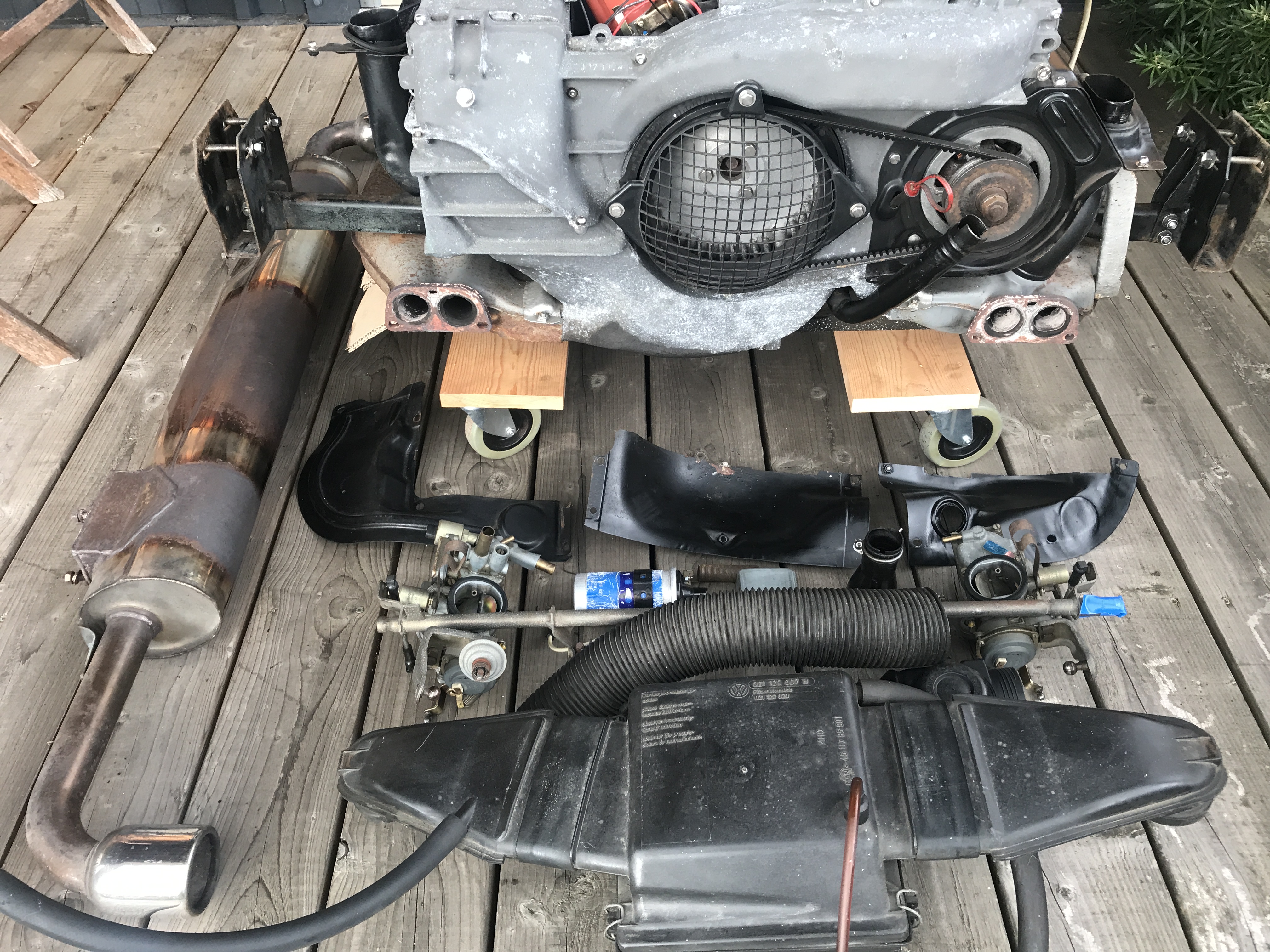

Good point, not just welding but making anything is like that. Measure, mark out, make jigs, it's a long process for a one-off part. Also, the first time you make something it's never quite right and you think of lots of improvements for the next time.
I have sold the engine now, £1300. Just waiting for the guy to collect it.

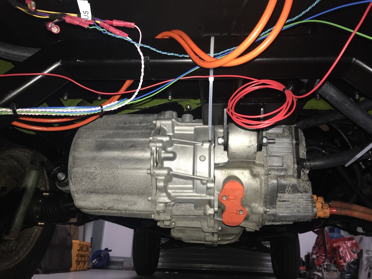

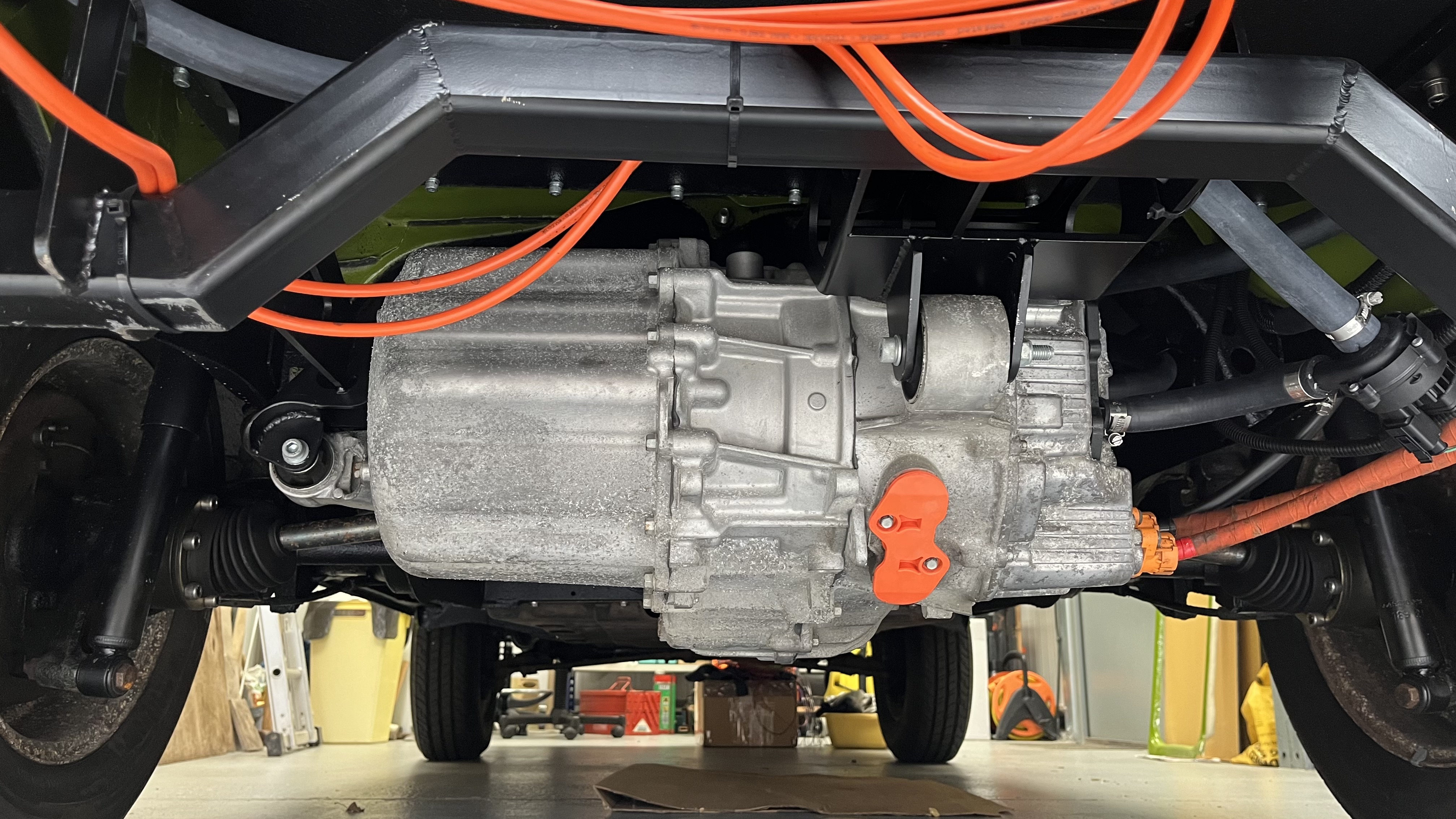

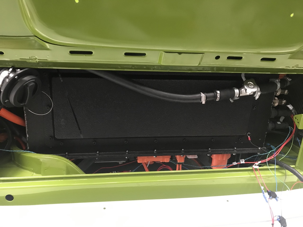

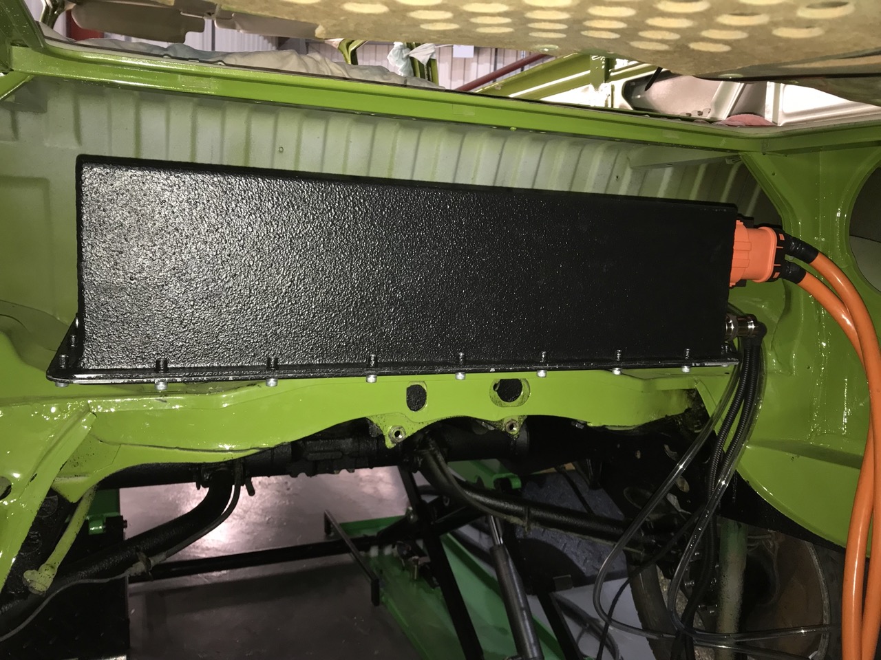

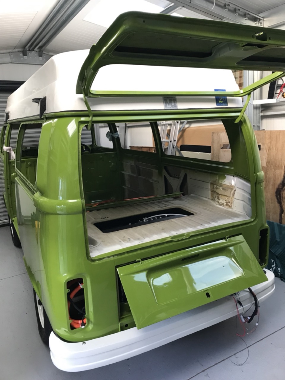

After almost a year at Edubs, including body restoration at Herbie Hospital, I have my shell back with drive unit and battery box completed. We were able to 'drive' it into my workshop under its own power.
Main battery box. This has 12 of the 16 Calb modules (35kWh total). Uses the ZeroEV cooling plates. Orion BMS. In front of where the left light cluster goes is the charger and DC/DC. On the right hand side is two radiators, one for the battery and the other for the drive unit.
This is the smaller battery box that goes where the fuel tank was. The main box sits on the same subframe that the drive unit is slung under.
Drive unit.

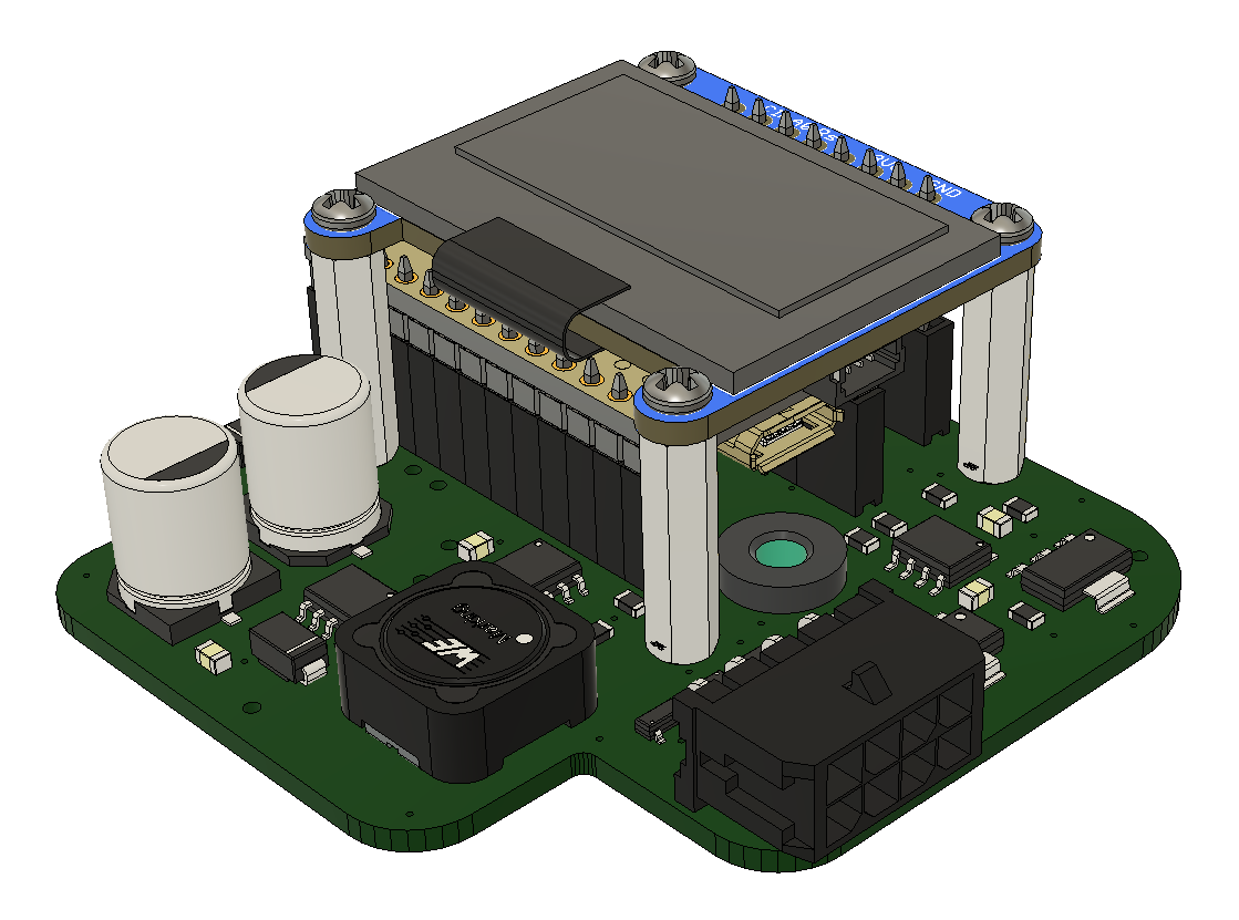

I've also started building the state of charge display that will go in place of the old fuel gauge and also drive a couple of analog gauges and the oil/gen lights. It will have an Adafruit OLED display with a Teensy 3.2 underneath.
A lot of work still to do!
Drive unit.

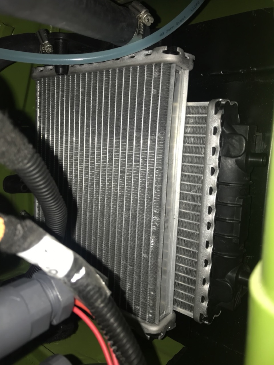

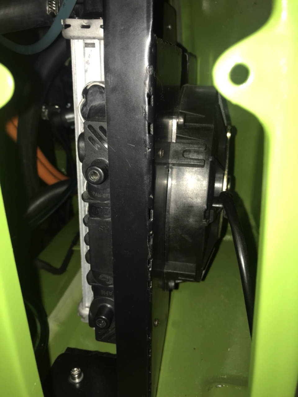

This looks awesome!
Mind sharing what kind of radiators and fans you have there?
If I understood correctly, you placed 2 radiators in the small pocket, behind the rear light stack. Seems tight, no?

I don’t know what radiators and fan they are, but they are small and mounted back to back. I need to put the 12V battery somewhere else, as it wouldn’t be possible to get it in or out with the main battery box in place.

I'm super curious to see the radiators setup. Could you please post some pictures?

Can't get any better pictures than this with the battery in place. Hope this gives you some idea.

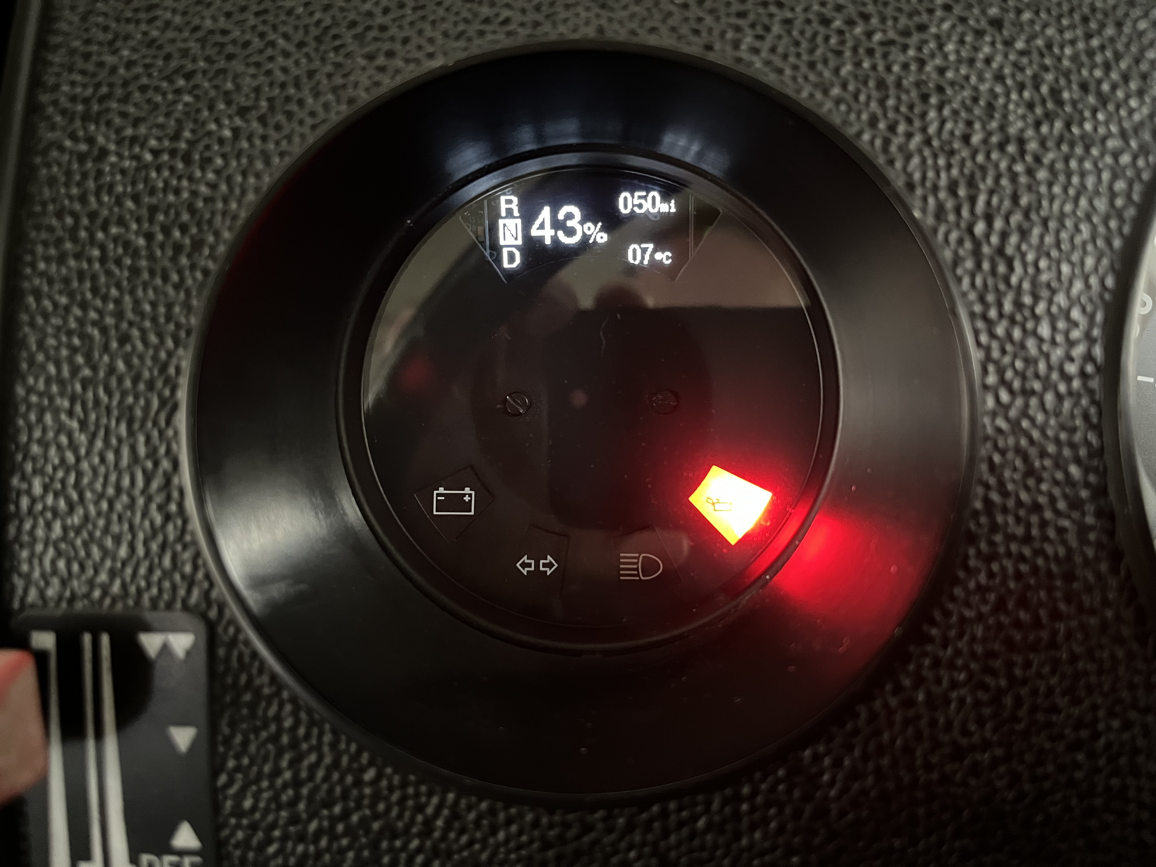

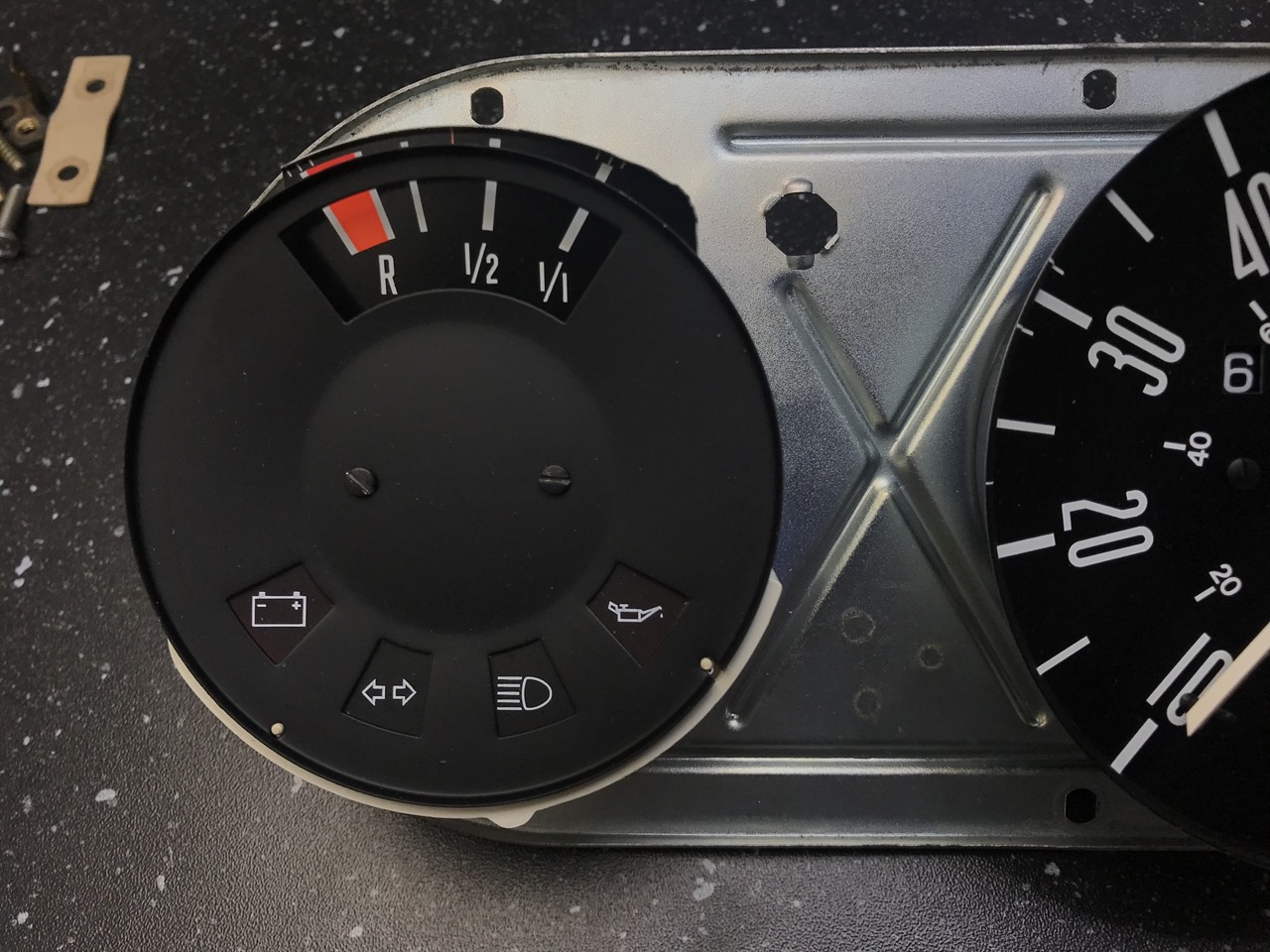

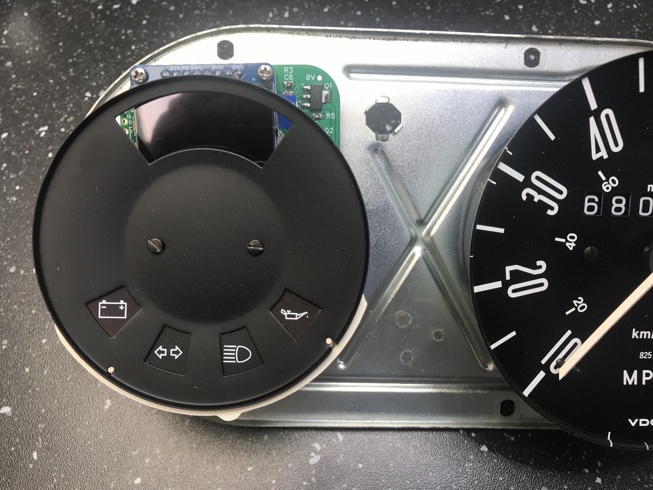

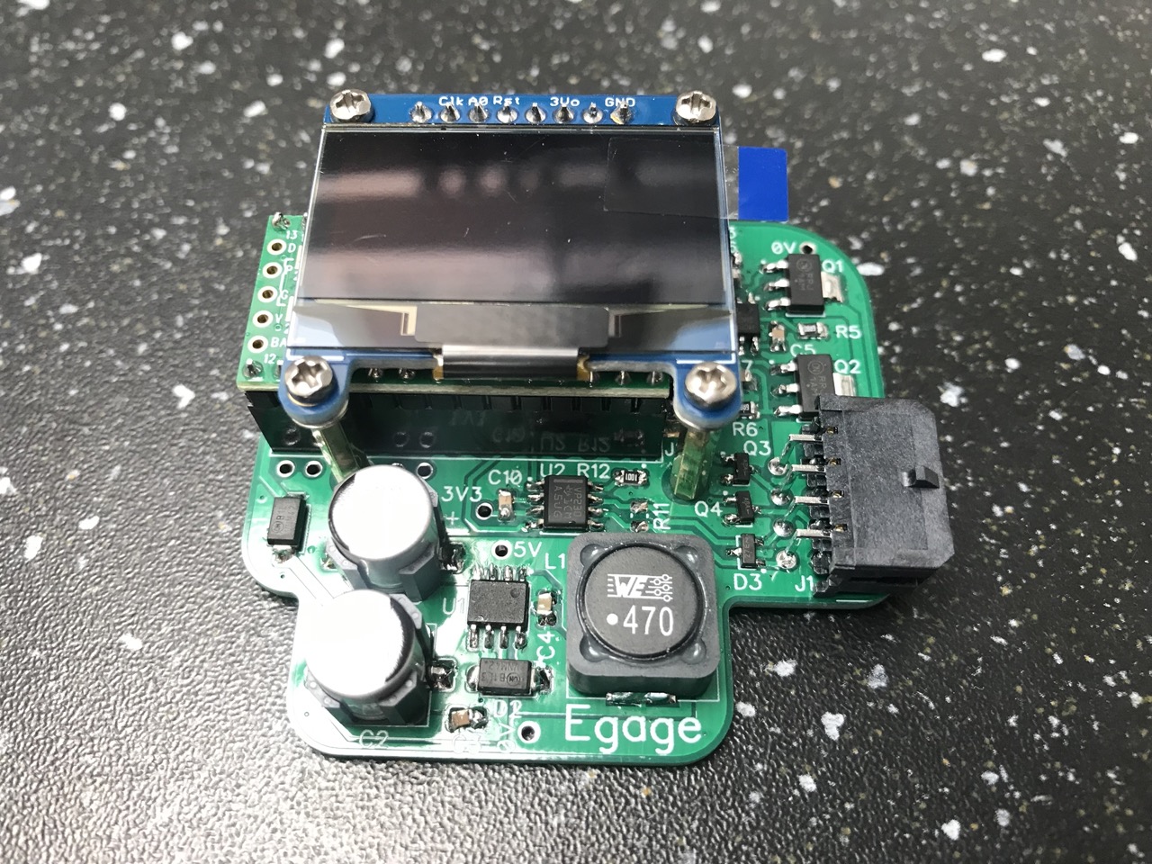

A little update.
I finished the SOC display module. The hardware tests out ok, no proper code written yet.
Here is the before and after where it replaces the fuel gauge. The display isn't as wide as the hole in the panel so it doesn't look as neat as I would have liked, but should be ok when in the dash without any light showing through.

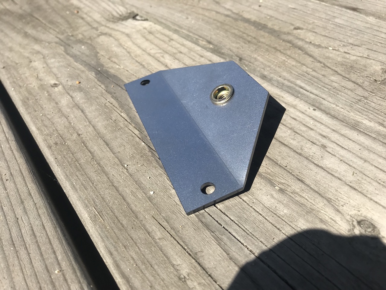

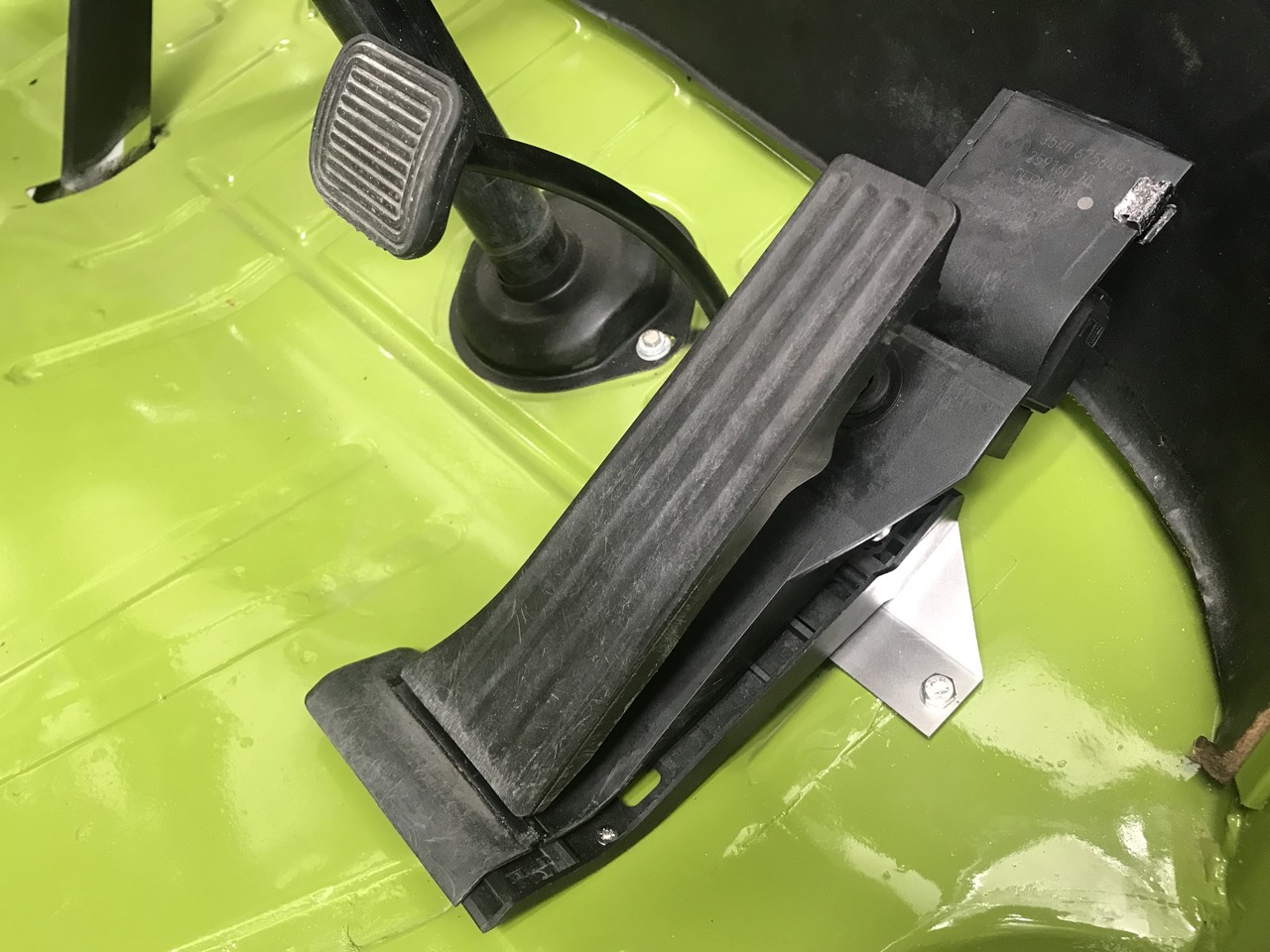

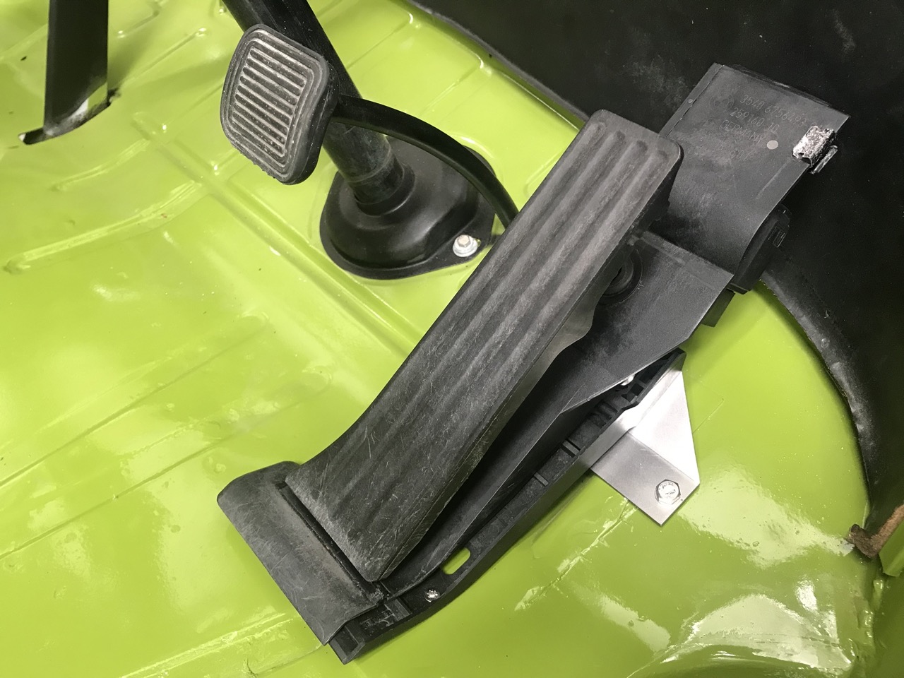

I also made/had made a bracket for the pedal (just needs painting). Test fitted with the BMW bracket and it all goes together really well, I was even able to use two of the original pedal mounting holes at the heel end. If anyone wants one of these brackets for a similar project let me know, I've got 2 spare.

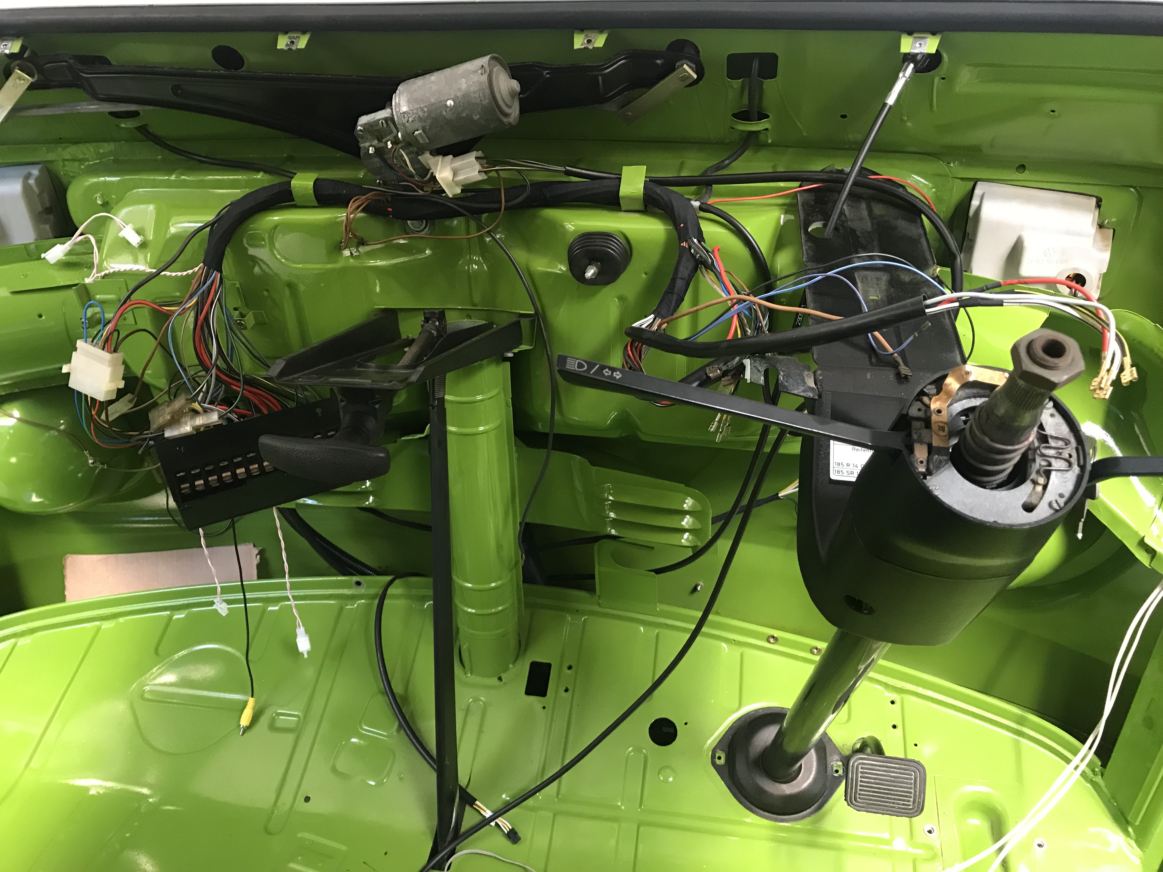

Wiring is all done now and wheels turning. This is the under-dash loom before I put the dash back in. Not long before road test time.

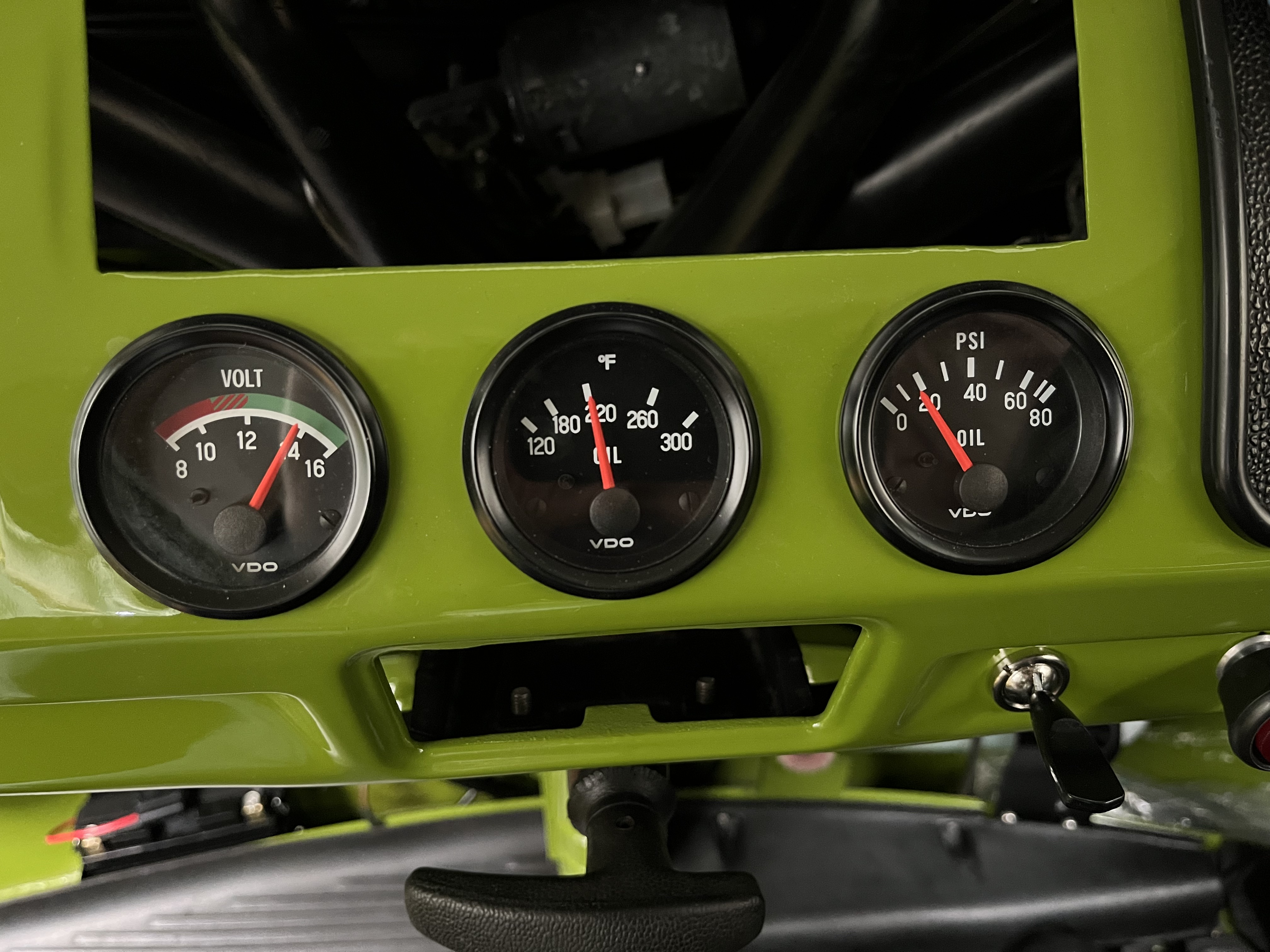

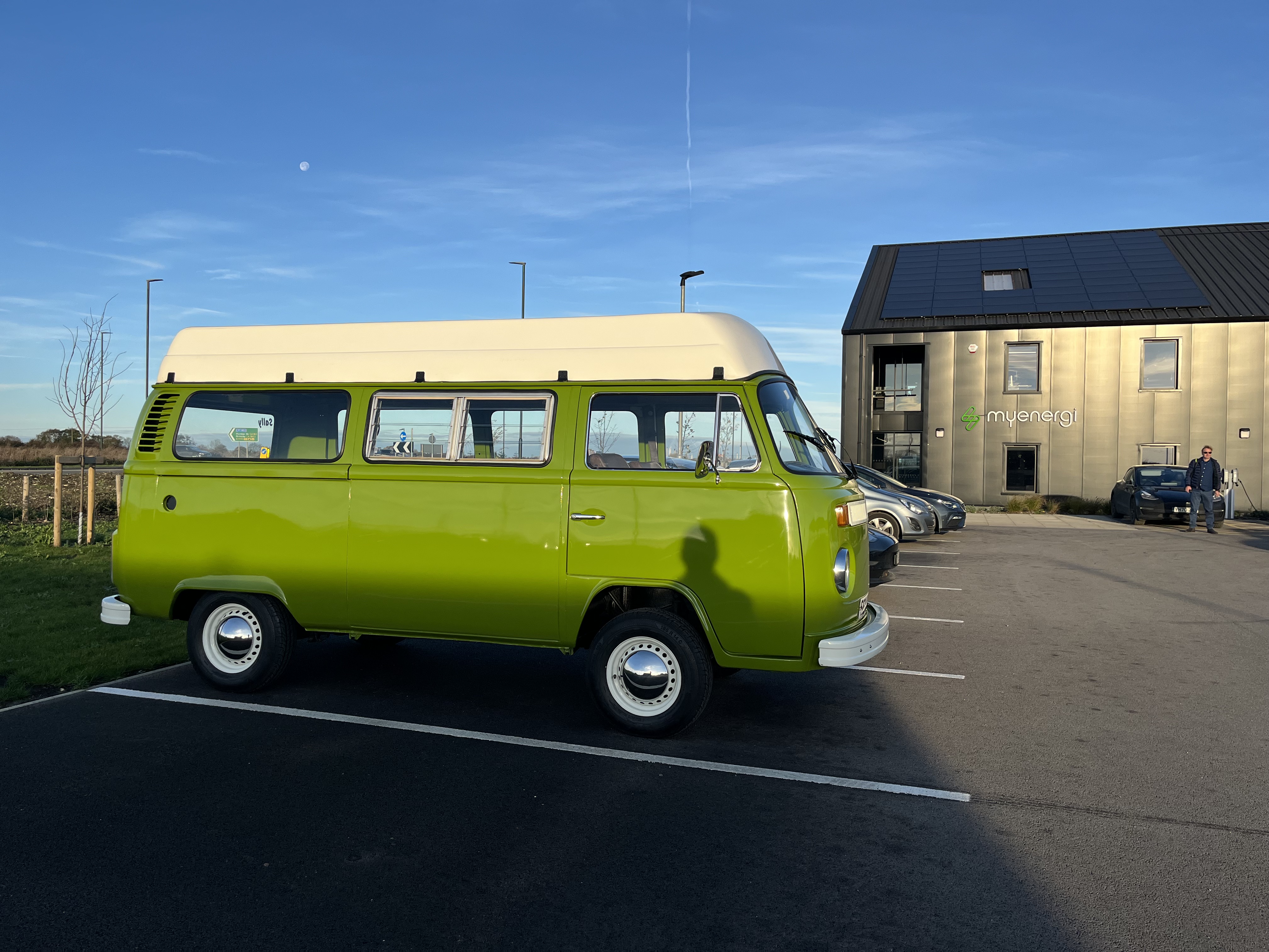

I got the bus on the road in October. Most of my spare time over the winter has been spent programming, it's still too cold to be working outside for my liking. Managed a few test drives, one was the 60 mile round trip to the office.
I had a DVLA inspection this week. The engineer was happy with what he saw, so hopefully I will get the vehicle re-registered as an EV.

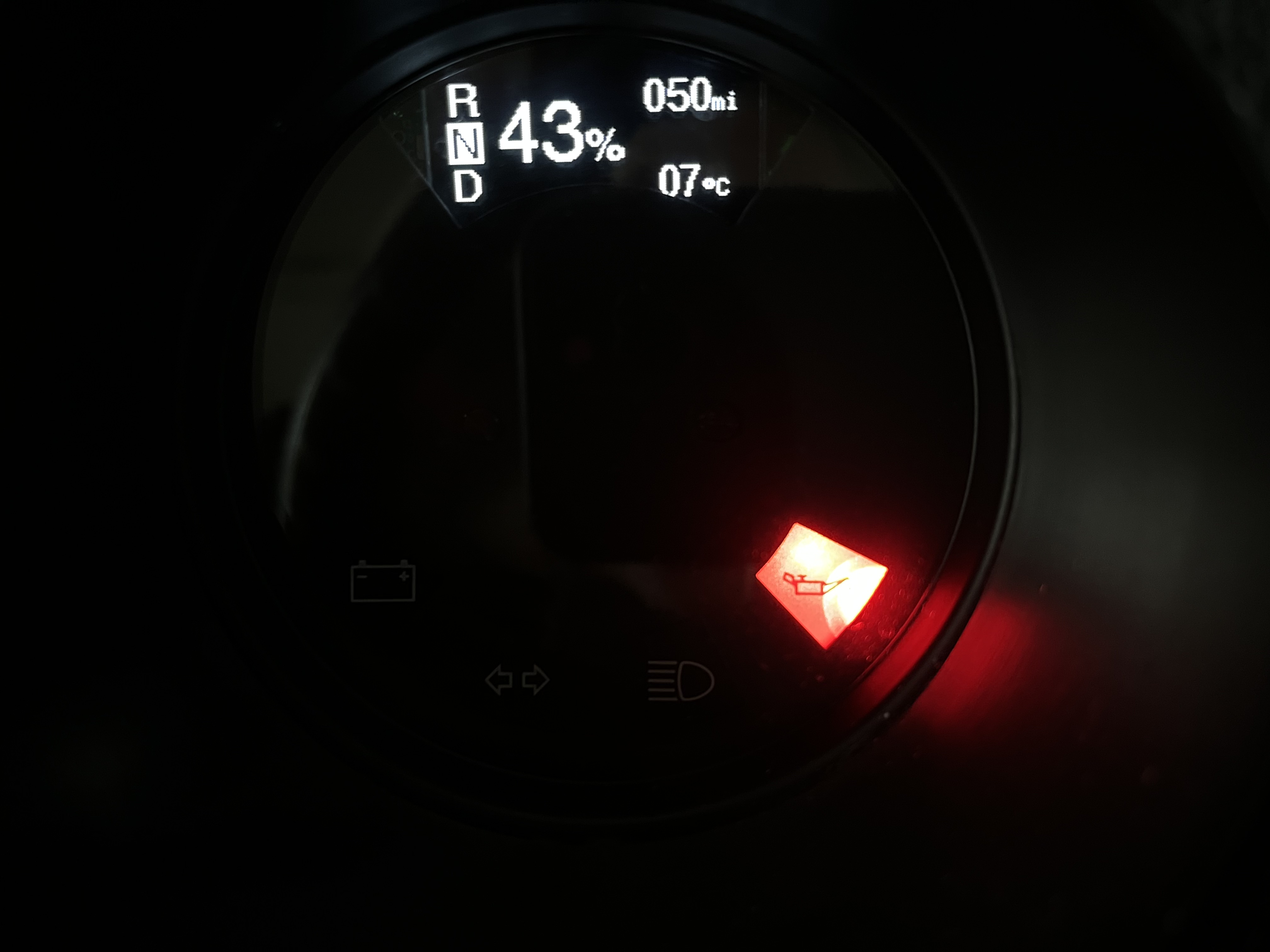

Here are some photos of the instrumentation. I've done all I want to do on it for now.
The oil light is on because it's not in drive mode. When you start the inverter up the light goes off. The temperature here is the battery temperature. I've also implemented a range estimation but not tested it for accuracy yet.
Gauges are, from left to right: 12V battery, power (+/-), inverter temperature. 12V is just a normal analog gauge. The others are driven off the instrument controller. Temperature in C scales 1:1 to PSI on the gauge. The power gauge (was oil temp) doesn't have a useful scale so it's just a guide.

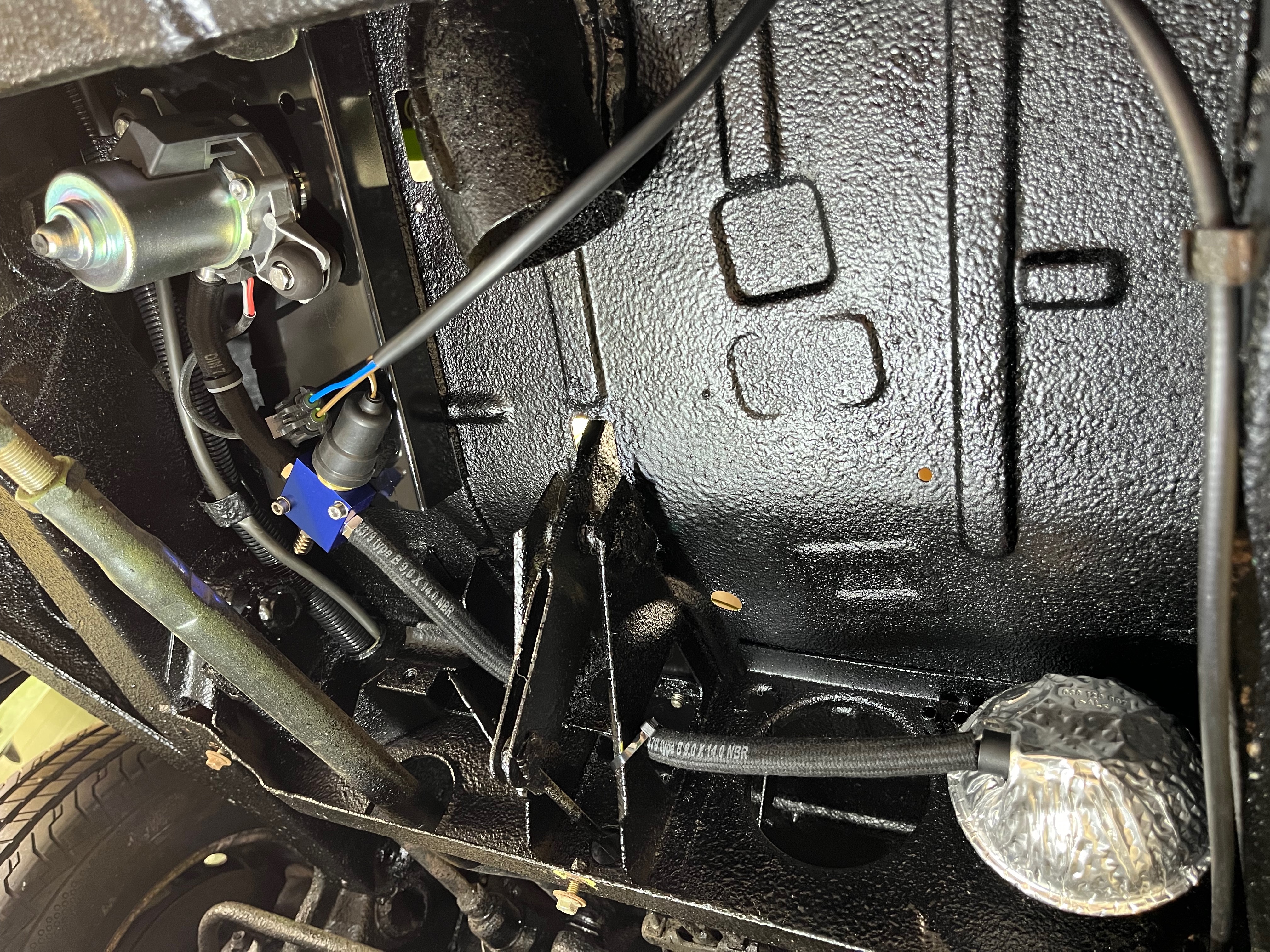

I've fitted a vacuum pump for the brakes. This photo is before connecting the hose to the servo. It works but I'm not happy about the lack of hysteresis in the switch (i.e. the pump runs for a very short time every few seconds and every time you apply the brakes). I got another make of switch but it wasn't much of an improvement. It will have to do for now.
Most of the parts were supplied by Fellten as a kit. The pump is an unbranded Hella copy.

Re: [DRIVING] 1978 VW T2 Camper
Maybe the sensor I sell would be a good replacement for the switch. https://citini.com/product/threaded-vac ... ng-module/
It has a solid state switching output and a micro controlled hysteresis of 25kPa

That would work a lot better Tom, assuming I can get 75kPa with my system. The switch I have adjusts up to 90kPa and the pump won't stop with that setting. Do you have the dimensions of the module and 1/4" adapter?
