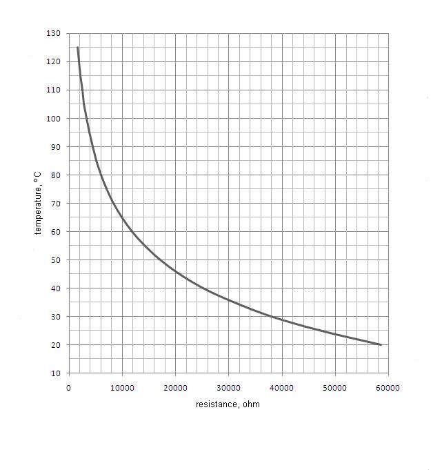

To interface to the Prius motor temperature sensor, you have to make slight changes to the board: viewtopic.php?f=14&t=1087 . Thanks bexander for this contribution!

The only odd thing thus far is tmpm = 200* :o
Posts: 6968
Has thanked: 454 times
Been thanked: 1771 times
Re: Inverter Firmware v4.94.R
When setting it to Prius motor temp sensor? If so, I forgot to link to changes in component values: viewtopic.php?f=14&t=1087

johu wrote: Mon Oct 26, 2020 9:17 pm When setting it to Prius motor temp sensor? If so, I forgot to link to changes in component values: viewtopic.php?f=14&t=1087
I completed the resistor changes (R16 = 2k2, R21 = 1k1) and tied pins 13 & 14 together and got a more rational mtemp of 101*C. Since higher resistance = lower mtemp, I also played with adding some small resistance on the mtemp (-) circuit and I did not improved the readings further.
As presumed, the mtemp readings are representative at temps near 100*C +/- and that is good :)
bexander
Posts: 883
Location: Gothenburg, Sweden
Has thanked: 75 times
Been thanked: 98 times
Post by bexander »
ZooKeeper wrote: Mon Nov 02, 2020 1:25 am
R21 should be 1k2, not 1k1.
How is your temp sensor connected? Should be connected from either pin 13 or 14 and then to GND.
You should be able to read normal room temperature when motor is at room temperature. 100 degree at room temperature means something is not correct.
