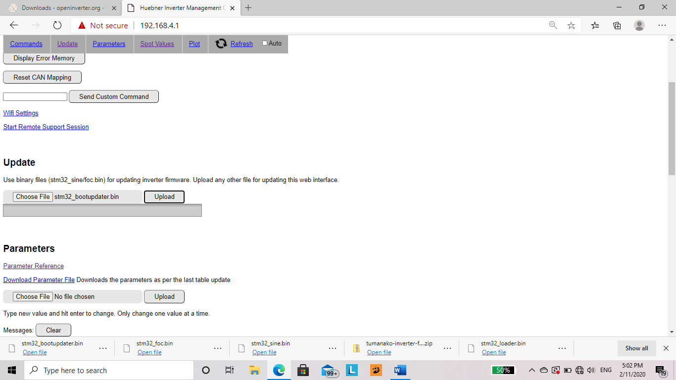

This is good news, I recently had my board delivered and DC switch is clicking on at start up. However the instructions in readme are a bit beyond my knowledge, am I just uploading the files below into the web interface then updating?
stm32_bootupdater.bin
stm32_loader.bin
stm32_sine.bin
Been thanked: 1918 times
Re: Boot loader version 4
Yes exactly like that.
Do not refresh or anything between the 3 steps.
Post by Dusty4 »
I have got to the the 3rd step, and now it doesn't let me upload stm32_sine.bin there is a spinning wheel on the interface and I have no blinking light on the board now. Any ideas?
Try uploading loader.bin again then sine.bin
Post by Dusty4 »
Thanks for the quick response Johannes, Unfortunately when I try upload loader.bin I get nothing. Same with any file for that matter. Is there a reset or something I can do?

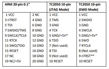

joromy
Posts: 371
Post by joromy »
Here is connections.
You can get some ready made adapters also

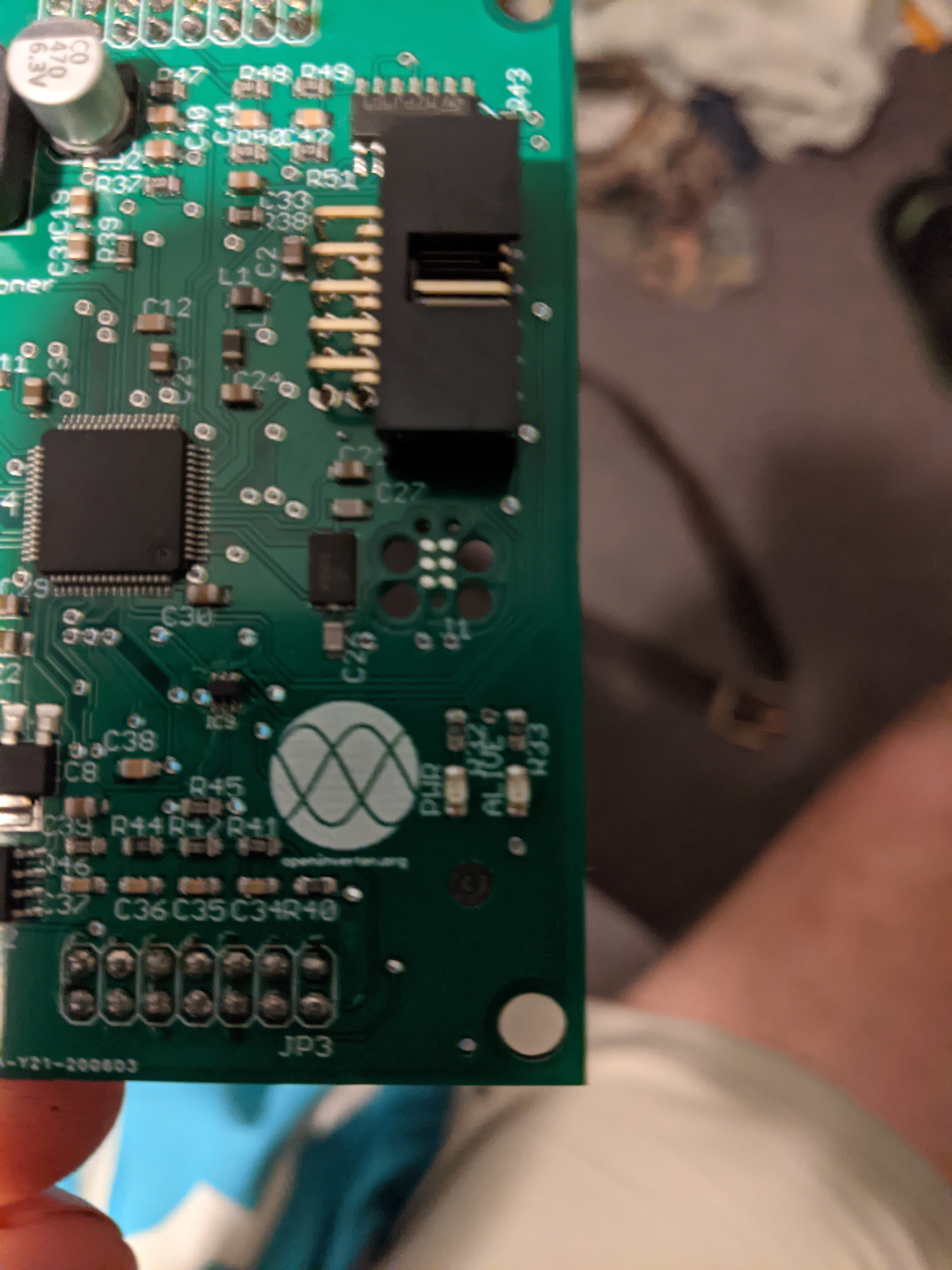

Dusty4
Posts: 85
Joined: Tue Dec 25, 2018 12:41 pm
Location: Western Australia
Has thanked: 11 times
Been thanked: 9 times
Post by Dusty4 »
Thanks, looks like tc2030 after a quick google.
You could just solder a wire to it, the tc2030 is kindof pricey. I could have just brought out SWD on a pin header, oh well.

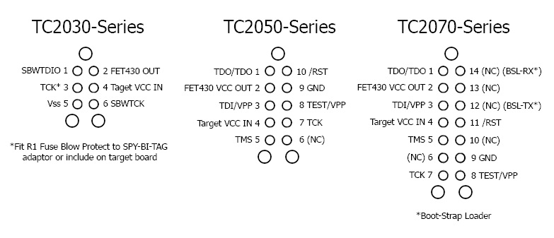

Post by Dusty4 »
Is there a pinout on the tc2030? I can't find what is what.. Also is there a thread i can read about connecting by uart?
Here's the pinout: https://www.tag-connect.com/wp-content/ ... -CTX_1.pdf
UART pin 3 and 4 are RX/TX, Pin 2 is GND. Don't ask which one is RX and which one TX, just swap until it works ;) Set your terminal program to 115200 baud.
