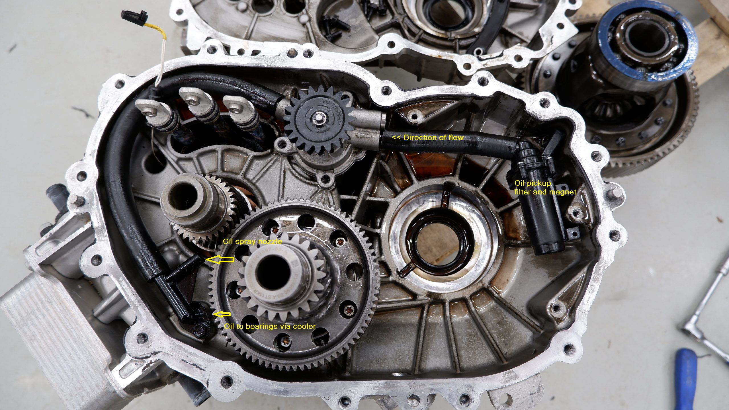

Hi! Peter, did you find a solution? I'm having the same problem to be solved right now. I have the gear housing open right now to access the oil pump and figure out how to get the cooling work in reverse operation. There would be space to relocate the piping but the pump does not work properly if run in reverse - so an external pump sounds like the way to go.

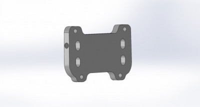

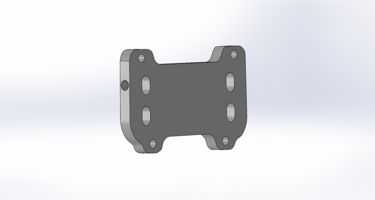

Hi Bigpie. Could be around £60. Aluminium block with 3/8" BSP ports. I will complete the drawing and post next week.

I am relying on the Tesla heat exchanger as standard for oil to coolant heat transfer. Of course I will need a conventional radiator for coolant along with a fan. The adaptor plate is in CAD at the moment so if anyone can convert to Solidworks it will look more user friendly. I will post the file later. Depending on how the pump primes will make my decision whether to pwm the oil pump with respect to when motor stopped to save battery power. As a footnote the adaptor will also enable fitting of a screw on oil filter. I decided to do this after seeing what the standard mesh filter has stuck to it !!

Hi Bigpie. Sorry for delay in replying. I sadly had to re-design the adaptor as once my SDU was fitted the oil cooler was too close to bodywork ! So, my re-design involves a new adaptor plate with different oil cooler. I have incorporated a small screw on filter too. I will post some pics later. So far cost has been just under £200, that includes second hand pump, oil filter, grommets, gasket and oil cooler. Still need BSP fittings and pipes. The simpler version which just uses filter and pump would be cheaper, around £85, thats only for the adaptor though. As soon as I have it piped up I will report back. Peter

That is front drive unit from a 2016 Model S Performance. The picture is kind of upside-down - the pickup is in top right corner where the pump (with black plastic gear) sucks and the oil travels though the hose into a cooler. There's a nozzle on that plastic piece in the end of hose where the oil goes between those gears.EV_Builder wrote: ↑Sun May 09, 2021 10:34 am Is that front drive unit? Or model X rear? Can't place the cooling mounting. And can you exain how the oil travels?
Where is the pickup and is the cooling partial and partial injected?
I can't figure out the return of the oil cooler.
I'd assume if the pump is external the oil needs to travel in other direction to that nozzle also.
Also I'm not sure where the oil return is - it's somewhere inside the motor. I haven't opened it more.

Aaahhh thank u very clear picture now. Allot of course was obvious but those last details make it great.
I was thinking if adding a Big filter between the oil cooler would make sense.
I now think it won't make allot of sense the biggest issue with this type of method is start from the line torque.
There is no oil film yet but because of huge electric torque there is torque. When having an electric pump you can make sure that while standing still the oil film is there. For electric consumption you can/could even make a oil pump mapping.
What wonders me was a thread in DIY electric which stated that the pump could be reversed and stuff like that...strange.

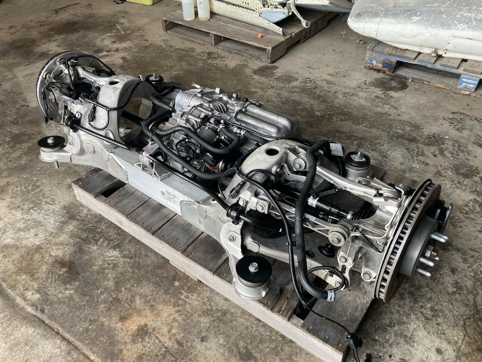

I don't know if this is still up to date, but I found a picture of a 2020 SDU that shows something like an external oil pump and an oil filter.
