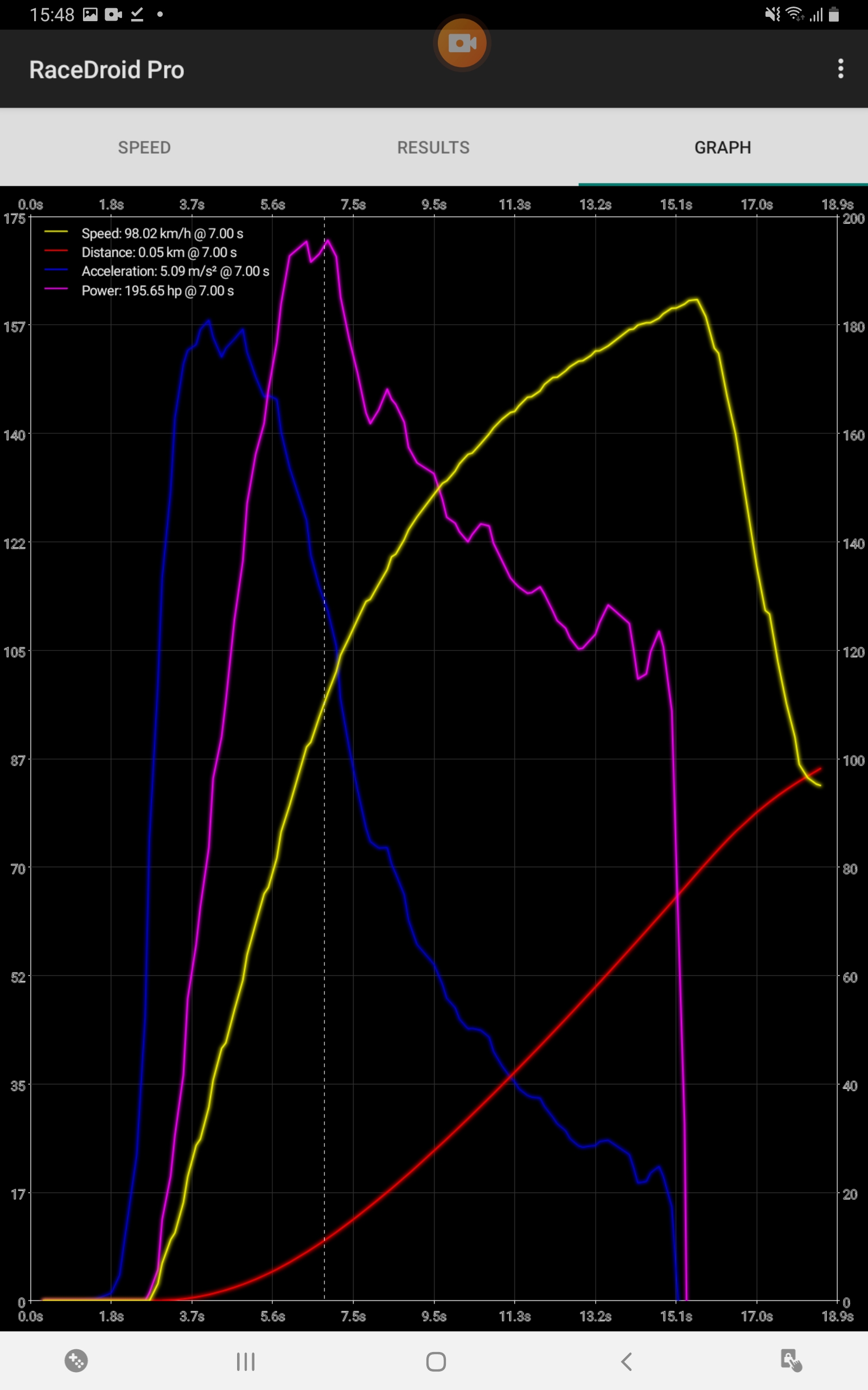

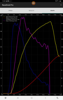

hi all, this question was bothering me for some time. What is your experience, anybody dyno'ed your car with the SDU?

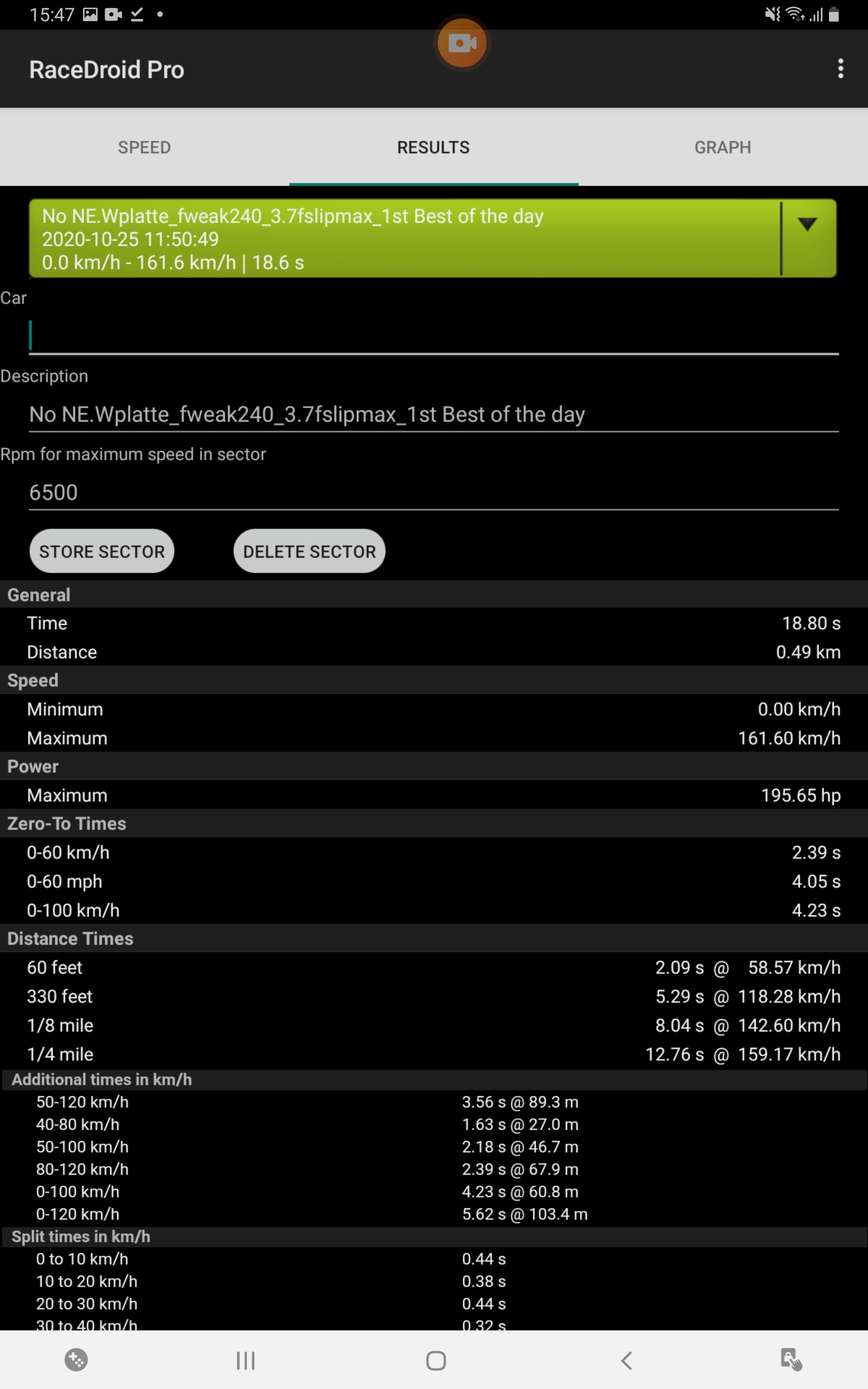

A friend of mine created this app RaceDroid Pro, coupled with 10Hz GPS (Garmin Glo) I have done some tests.
850kg car's weight (with driver), I went for 10% drivetrain loses and 0.45 Cd x 2m2 frontal area.
Result below. What I'm getting is around 190 horsepower. Close to 200 when battery with high SoC, 170 horsepower when closing 30% SoC, much less below 30%.
What I don't understand is why only 190 hp. I'm using Torque app and OBDII device that connects to the Orion BMS. It shows 500 amps current and 370 volts on the peak. That should be giving 185kW so 250 hp. I will measure current and voltage on inverter and on BMS app directly, maybe that is voltage sag...

OP, I don't know why your power levels are lower when measured by GPS. Your drag may be higher than you have calculated, or the 10Hz GPS might be too slow. Can that app use wheel speed sensors or the phone's accelerometer? Either of those might give more accurate results.

Let me draw the udc/idc at the inverter to get the accurate reading. Hard to argue with P=VI. I guess minus ~5% as inverter and motor have some losses. But not 40kW.
App works with 10Hz GPS really well for ICE cars, close to dyno numbers. Guess I need to go on a dyno to calibrate for electric powertrain.

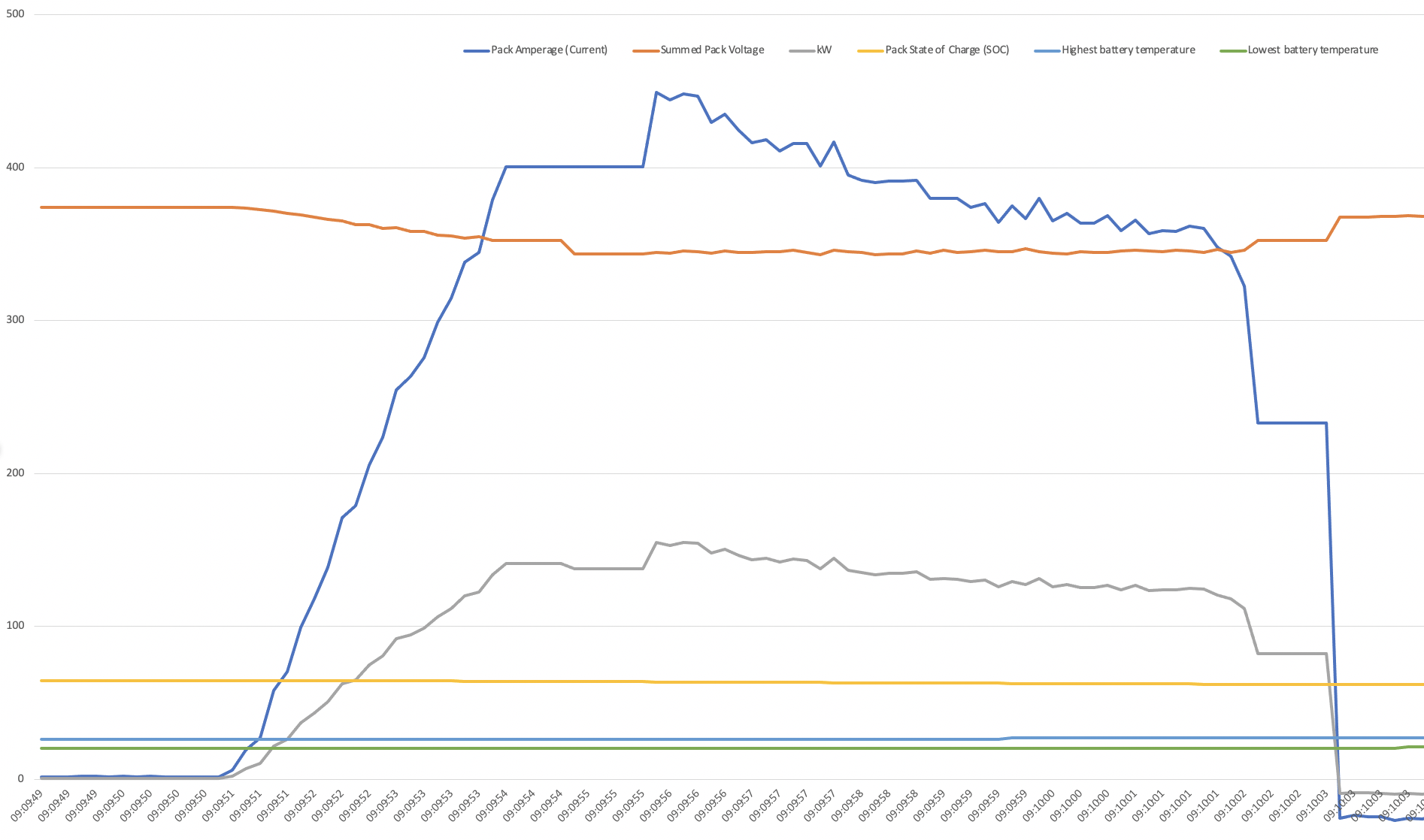

Idc at inverter is not accurate (calculated from the AC currents), udc is generally good though.
Re: How much power the SDU really makes
It probably is voltage sag. How fast does the BMS report voltage and current?

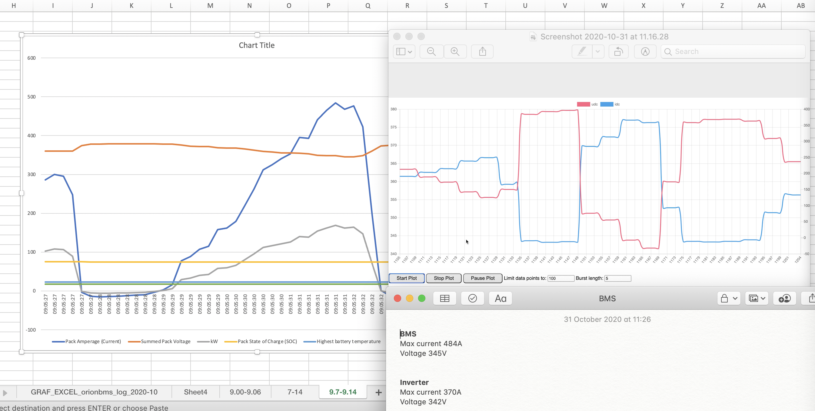

I have done some extra testing to figure it out. As Isaac96 was pointing out, the readout from the idc at the inverter was not accurate (BMS data on the left):
Udc looks to be correct.

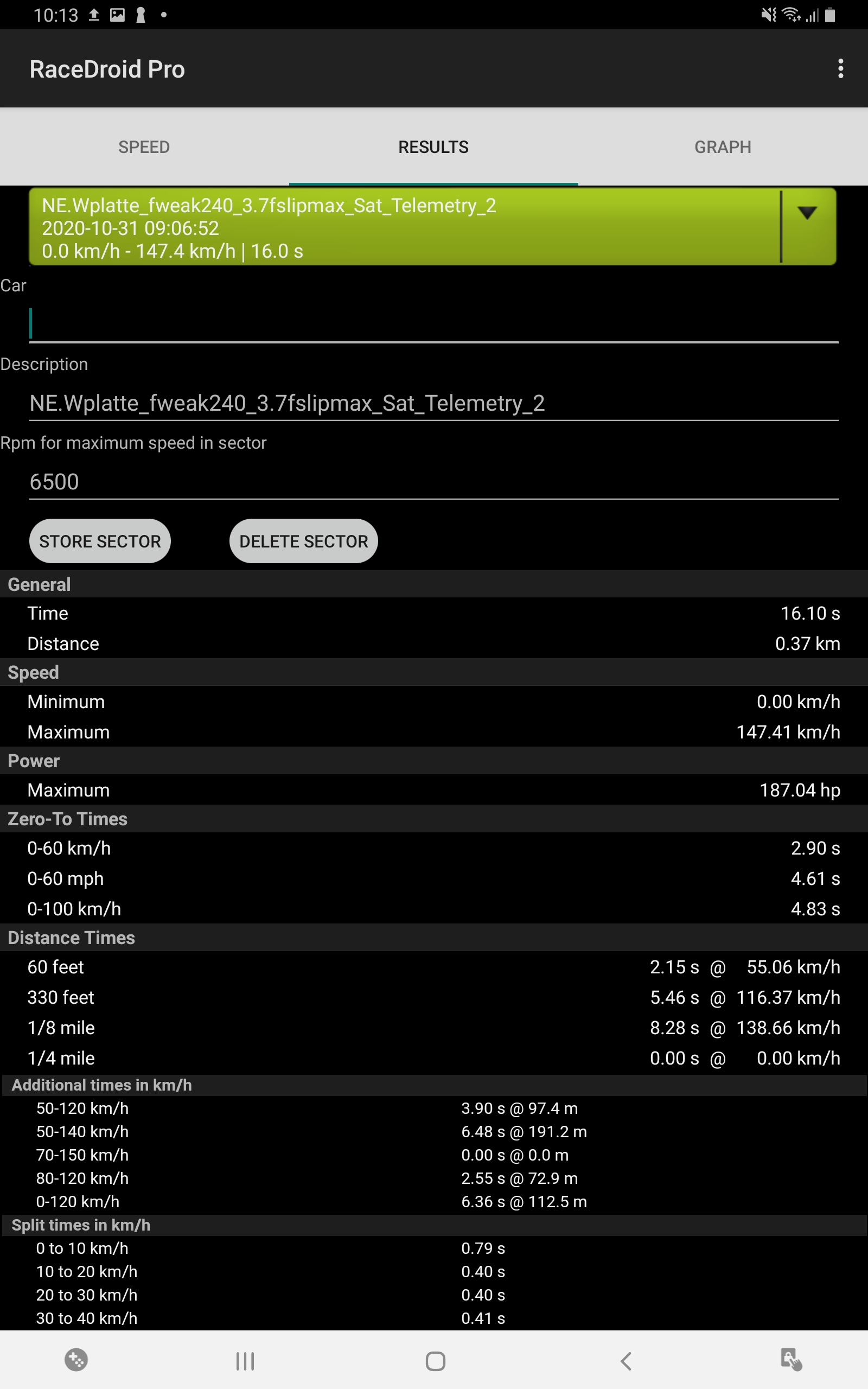

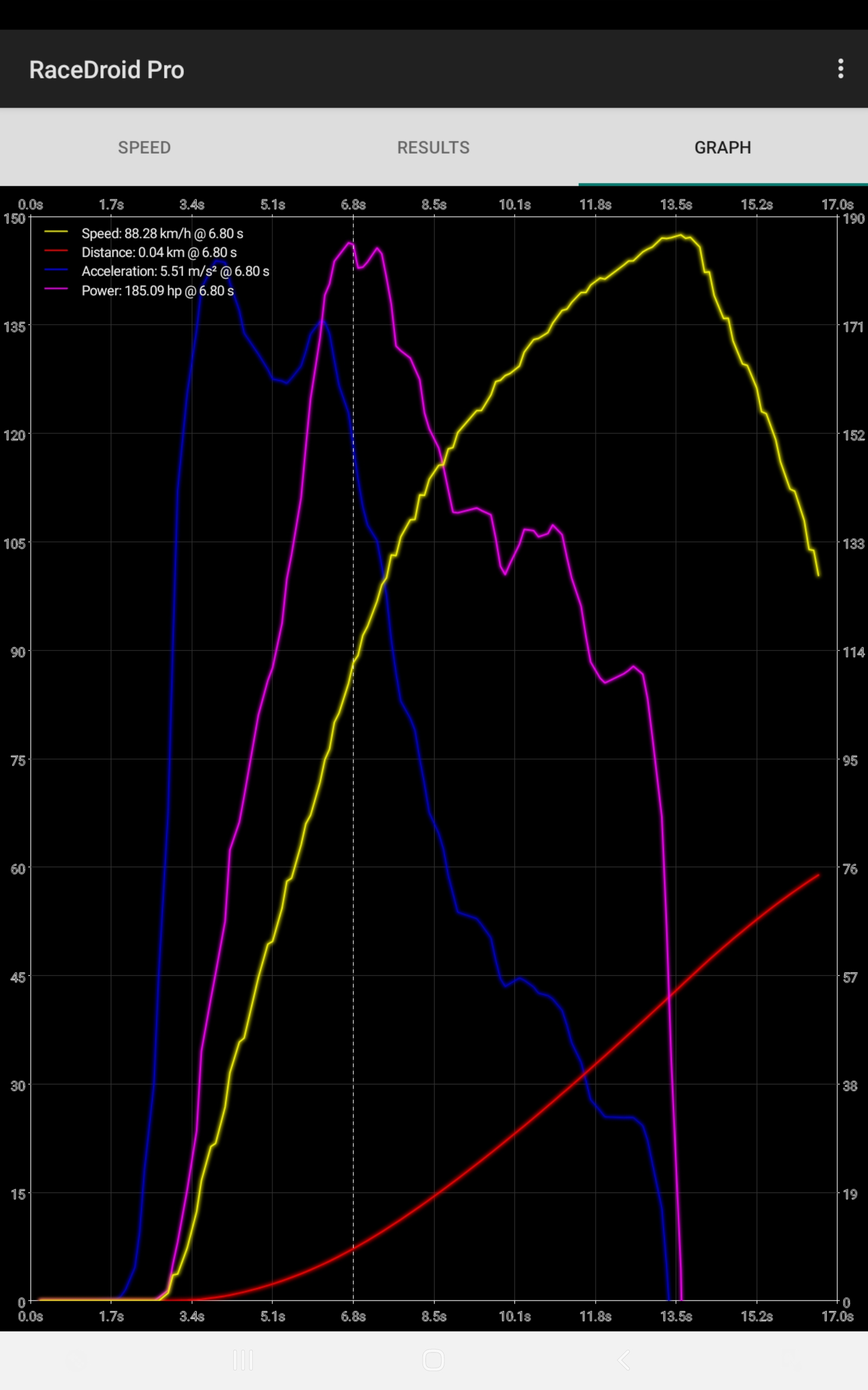

I tend to think that BMS readout is correct. For this run Race Droid Pro has shown 187 hp. Report based on the BMS log: shows the current at the peak power moment was 450 amps. Voltage sag is massive though, dropped from 374 to 345. So 155kW peak power, 208hp.
Since Race Droid showed 187 hp, BMS logged power 208hp minus 5% for inverter/motor loses gives 198 hp. Even if the error of the Race Droid and BMS measurement is only 5%, we are in the ballpark.
So clearly looks like voltage sag is the answer on why I get the power of 155kW instead of factory 210kW.
Anybody with stronger battery pack could post some logs? I wonder if with a better pack the motor can really handle 210kW.
