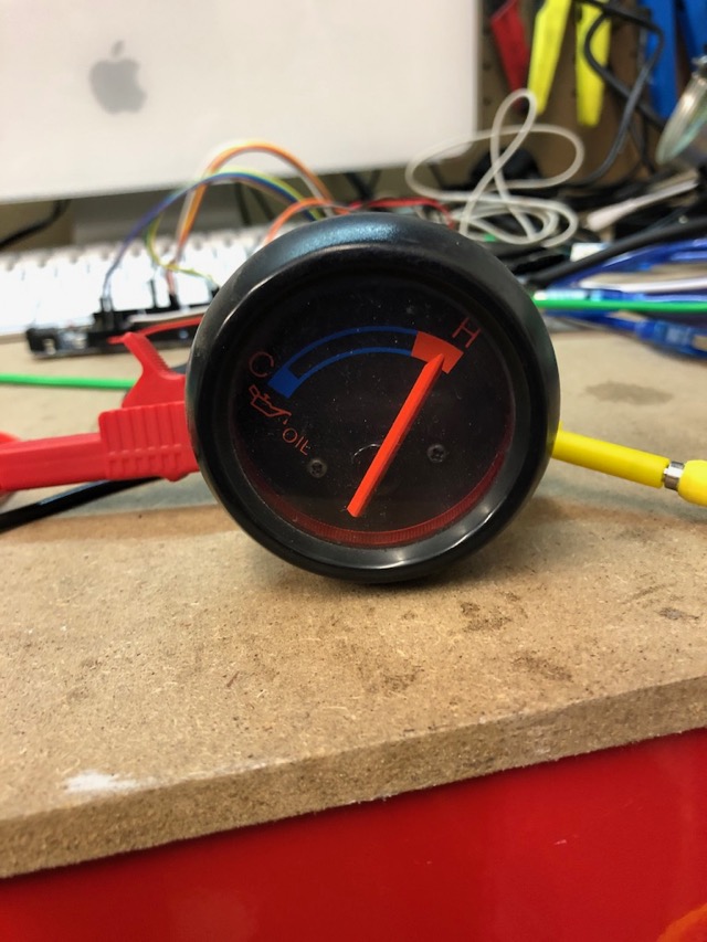

Re: Controlling an analog dash
Well, that was fun. PWM works like a charm!
Code couldn't be simpler:
int meter_pin = 6;
int meter_value;
const int min_blue = 0;
const int low_blue = 75;
const int middle_blue = 150;
const int high_blue = 175;
const int red_start = 200;
const int red_max = 255;
void setup() {
Serial.begin(115200);
pinMode(meter_pin, OUTPUT);
void temperature(int meter_value) {
analogWrite(meter_pin, meter_value);
Serial.println(meter_value);
void loop() {
temperature(min_blue);
delay(10000);
temperature(low_blue);
delay(10000);
temperature(middle_blue);
delay(10000);
temperature(high_blue);
delay(10000);
temperature(red_start);
delay(10000);
temperature(red_max);
delay(10000);

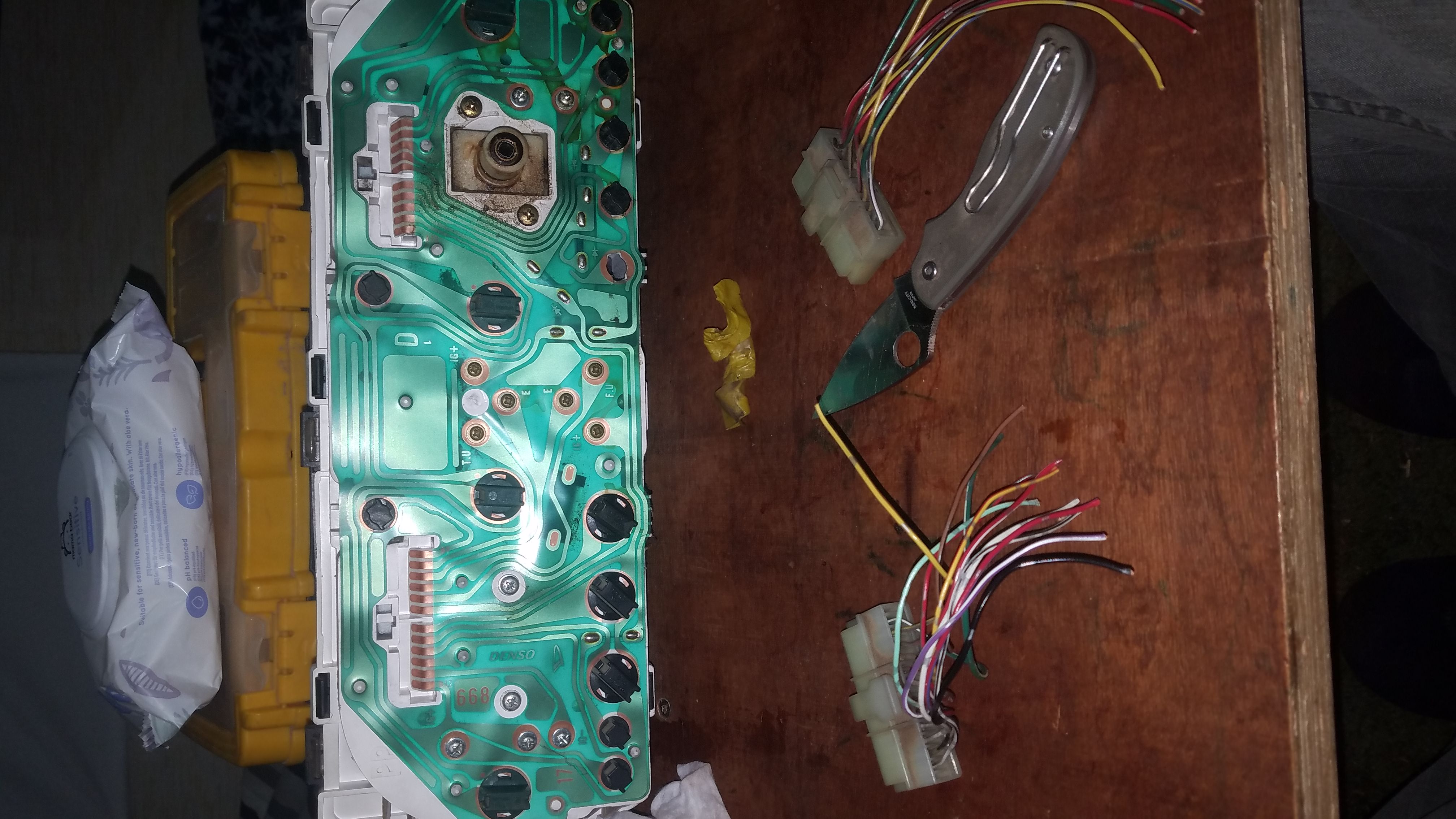

- Posts: 115
- Joined: Sat Dec 26, 2020 5:44 pm
Excellent guys, thanks
I will pull the cluster from my test mule vehicle and start playing with arduinos
A Daihatsu Fourtrak, it's delightfully basic for a car that's only 23 year old and has only done 46k miles on ICE.

I might bring the instrument cluster indoors to start working on that of an evening
clanger9 wrote: ↑Fri Jan 01, 2021 9:16 pm Well, that was fun. PWM works like a charm!
Code couldn't be simpler:Code: Select all
int meter_pin = 6; int meter_value; const int min_blue = 0; const int low_blue = 75; const int middle_blue = 150; const int high_blue = 175; const int red_start = 200; const int red_max = 255; void setup() { Serial.begin(115200); pinMode(meter_pin, OUTPUT); } void temperature(int meter_value) { analogWrite(meter_pin, meter_value); Serial.println(meter_value); } void loop() { temperature(min_blue); delay(10000); temperature(low_blue); delay(10000); temperature(middle_blue); delay(10000); temperature(high_blue); delay(10000); temperature(red_start); delay(10000); temperature(red_max); delay(10000); }
So this code just loops through those rough zones with 10s intervals

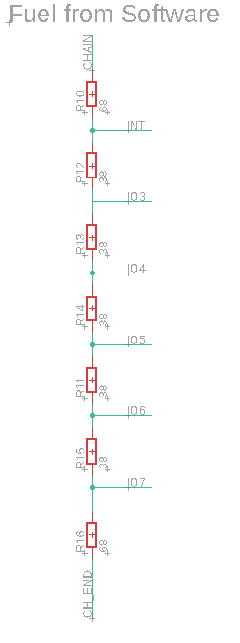

Can you show me a circuit diagram so i can test my dial here.
I don't need speedo as that's controlled with a gear in the gearbox, but i do need temp, fuel and tacho

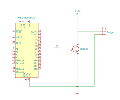

- clanger9
- Posts: 203
- Location: Chester, UK
Sure, it's just a 2N2222 transistor as a low-side switch. 1k resistor from Arduino pin 6 to B. E to GND and C to the temperature gauge input.
The gauge itself is powered from 12V power supply. I can do a quick sketch tomorrow...
Probably wise to characterise the gauge with a multimeter & some resistors first. I found that the maximum current draw (with the sensor gauge input shorted to earth) was 75mA - so well within the transistor rating.

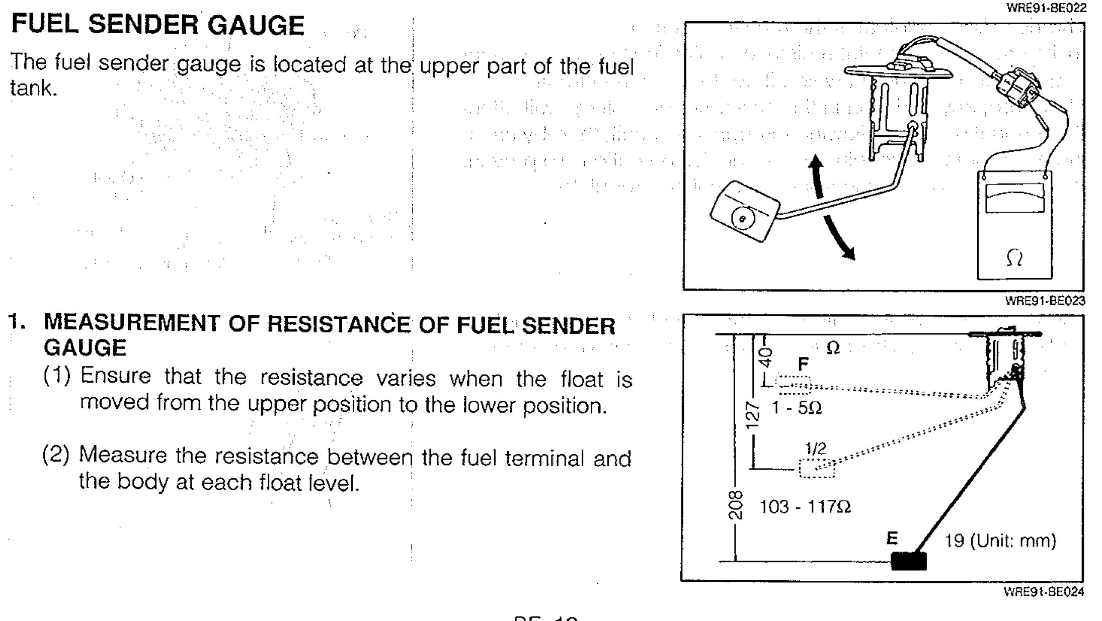

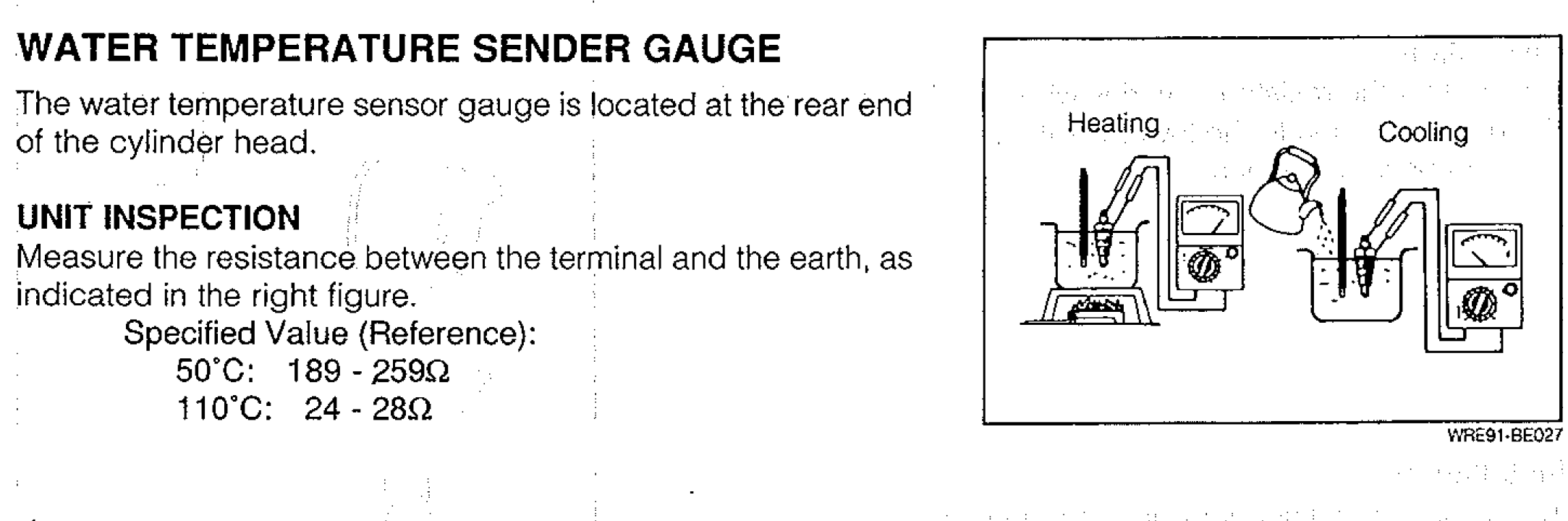

- Posts: 115
I was lucky enough to find a full service manual recently, the dash circuit diagram doesn't line up completely accurately with my dash and myb tracing of the pins (assume it's for an earlier version of the vehicle), but i'm kinda guessing the temp/fuel senders and gauges didn't change
Temp Gauge Fuel Gauge

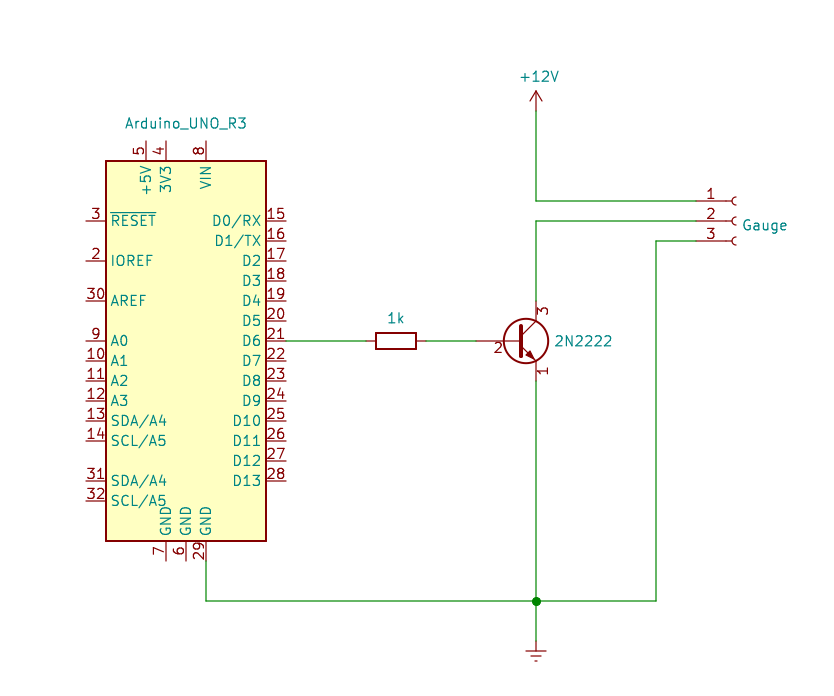

- clanger9
- Posts: 203

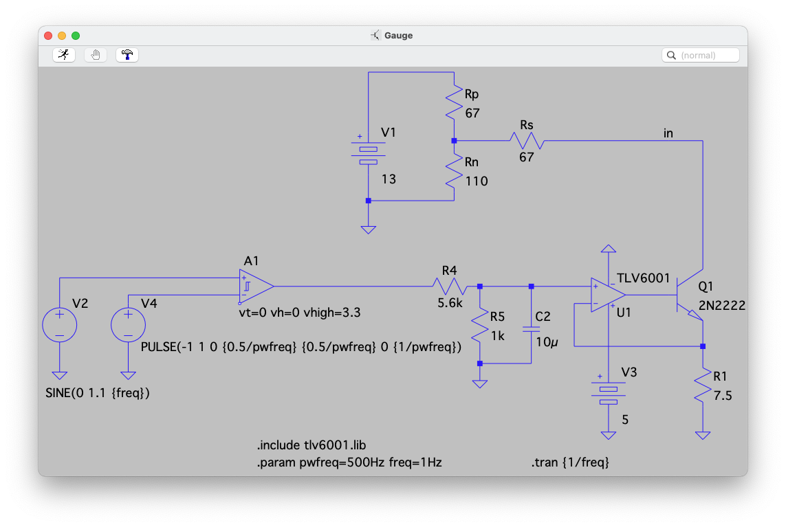

Looks good - that should work fine with PWM.
Behold, my first KiCAD schematic!
Every day's a school day...

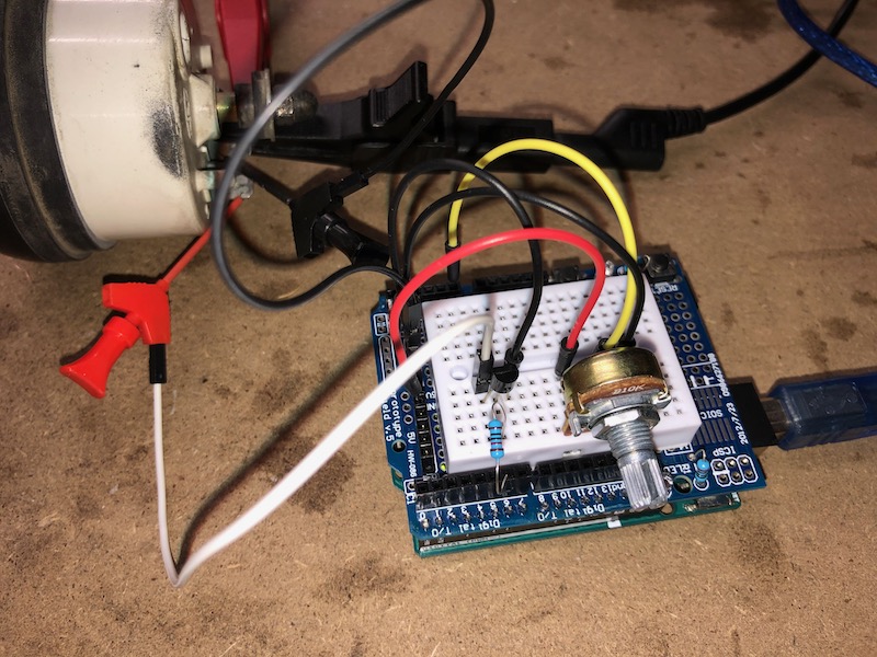

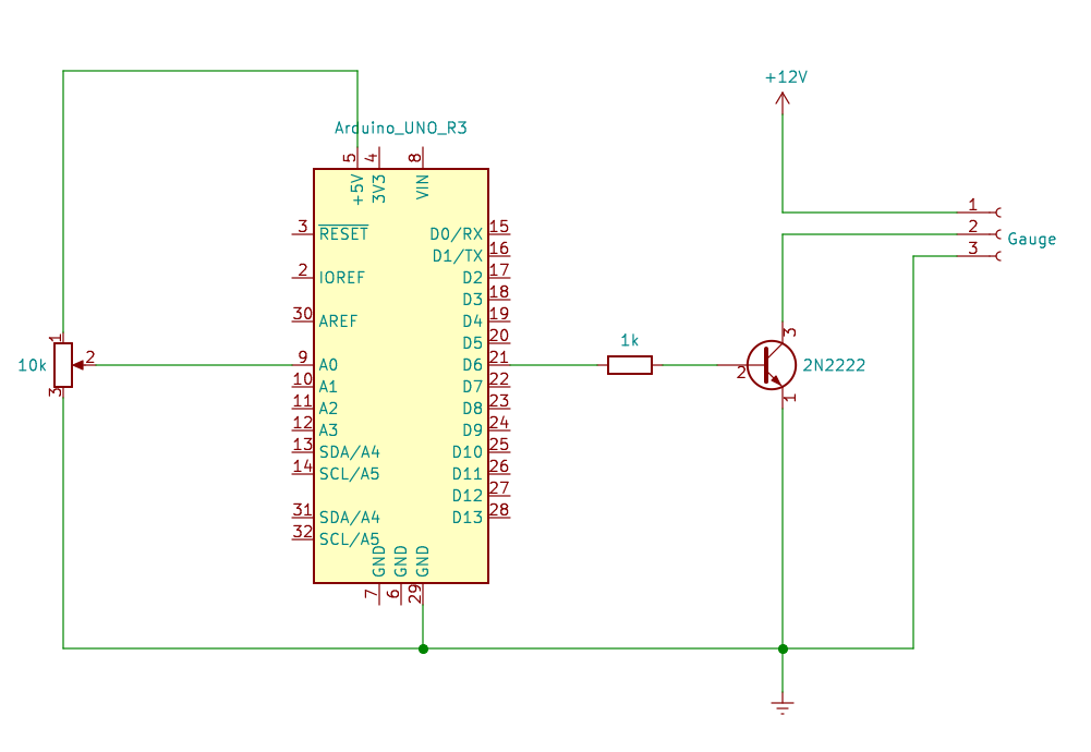

- clanger9
- Posts: 203
This might be a more useful test setup (on a roll now...)
This is what I used to characterise the gauge. It adds a potentiometer so you can set the gauge to any value. The value is shown on the serial monitor.
NOTE: if you're using a 3.3V Arduino (e.g. Due or Teensy) DO NOT connect the high end of the pot to 5V as shown in the diagram. It needs to be connected to 3.3V, otherwise you will damage your board...
