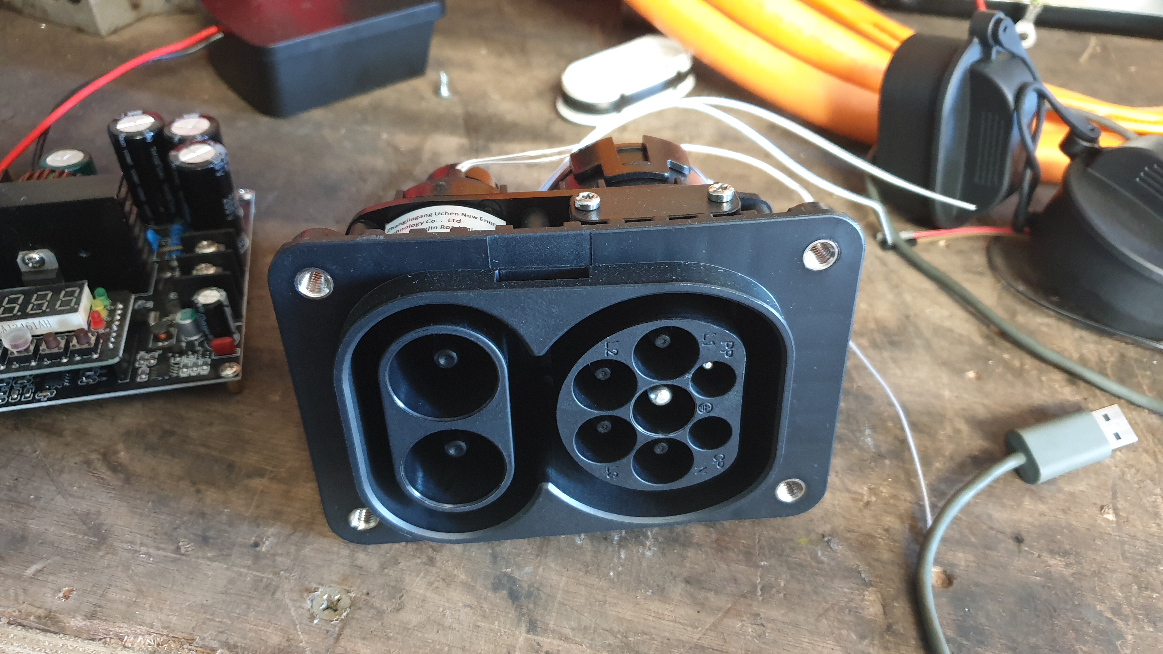

Got you covered on the socket. One thing I've learned over the years working with Johannes is the more complex and hardware intense the system seems to be , the more likely he is to solve it with an stm32f1 , a few resistors and caps and some lines of code

I recognise that socket... happy another New Electric donation is proving useful
