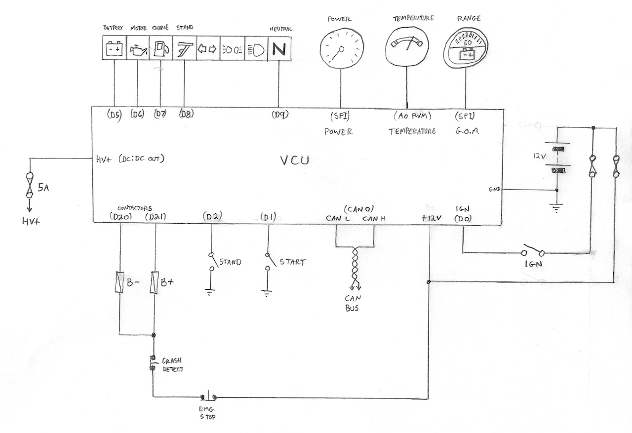

Here's a high level VCU diagram for starters (that's all I have so far).
I'll post code/updates as I work through this...

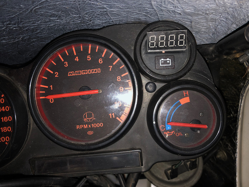

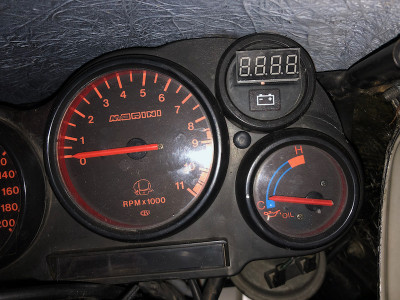

The main change to my design is that the "power" and "range" displays will now be CANbus instruments. The VCU will send motor power messages over CANbus to a (modified) analogue rev counter containing a stepper motor and the battery management system will send the state of charge to a 4-digit 7-segment red LED display inside the original ammeter shell. It will show a simple 100 -> 0.0 number. Temp gauge will be original, driven via PWM signal from the VCU. That way, I can keep all of the dashboard exactly as I imagine it might have looked in the late '80s... 8-)

Nice, I'm a big fan of keeping the aesthetics as original as possible. I'm planning not to add anything to mine and just use temporary displays for anything more than what the original dash can display.

My plan is to build the CANbus instruments using Teensy 3.2 boards. Not the cheapest solution, but they are tiny, easy to use and have on-board CAN. Space is going to be tight in that little ammeter ;-)
