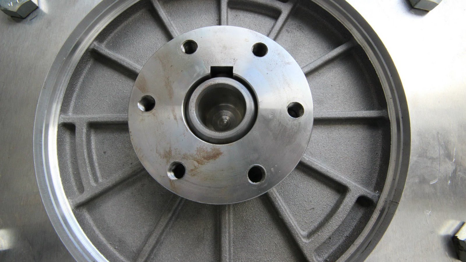

Some questions have been asked about the Leaf coupler used by Johannes (here). I've discussed this with my colleagues in Amsterdam and can confirm they are selling a new version of the coupler ("puck") to end users
The puck costs €250 and uses the exact DIN norm of the Leaf spline. Included in this price is the drilling of a bespoke bolt pattern to match the flywheel you are using. Some bolt patterns are already on file but if you have something exotic they just need a dimensioned drawing of the bolt pattern or you can send them a flywheel and they will do it for you.
Blank pucks are also available for €225 if you want to drill your own flywheel holes

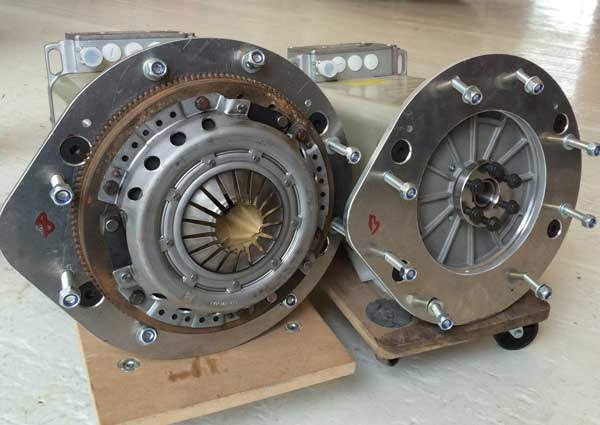

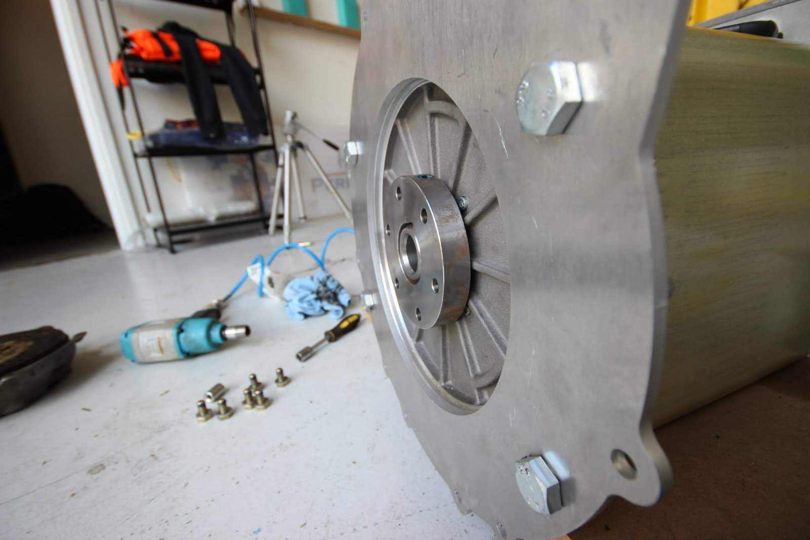

I can also confirm that New Electric can supply adaptor plates for mounting motors to gearboxes. They have many motors and gearboxes on file but if not they just need a dimensioned drawing.
Attached are some photos of the puck and adaptor plate for the Siemens motor.
