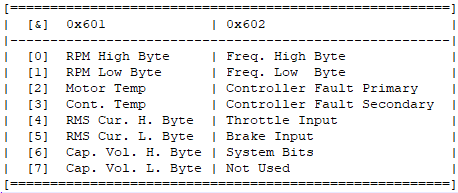

Greetings, I'd like to suggest getting information together for gauging the LDU. I know there are two CAN buses available, one that will output serial data if you move the jumpers on the board. For most of my EV gauging I have used Torque from the Orion BMS which also has two CAN networks. It doesn't supply the juicy stuff like RPM, phase amps, or motor temp from the LDU. I have coolant temp plumbed to the bms, so at least I have that, and I can read battery current from the bms, however:
How to we gauge motor RPM? I was thinking of porting the motor CAN to the BMS to see if it would see the CANopen would play nicely with the BMS and then I could read RPM on Torque as well.
Any CAN networking experts that CAN chime in?

Orion BMS supports the HPEVS AC-51 + Curtis 1239E system, so a quick workaround would be emulating the Curtis CAN data. I have done that before. Not for the Torque, but for a custom gauge I designed.
So attached is the CAN structure of the controller data between Orion BMS and Curtis controller. If you map the CAN data your Tesla inverter to send the rpm value to the first two bytes of CAN ID 0x601, also by enabling the Curtis 1239E (CAN) support on the Orion BMS interface, you might achieve what you want. But as I told I didn't use this method with the "Torque" software so additional work might be needed.

Thank you so much, this is an excellent way forward. I have used the AC series motors with Orion, i never networked them however.nailgg wrote: ↑Thu May 09, 2019 2:02 pm Orion BMS supports the HPEVS AC-51 + Curtis 1239E system, so a quick workaround would be emulating the Curtis CAN data. I have done that before. Not for the Torque, but for a custom gauge I designed.
