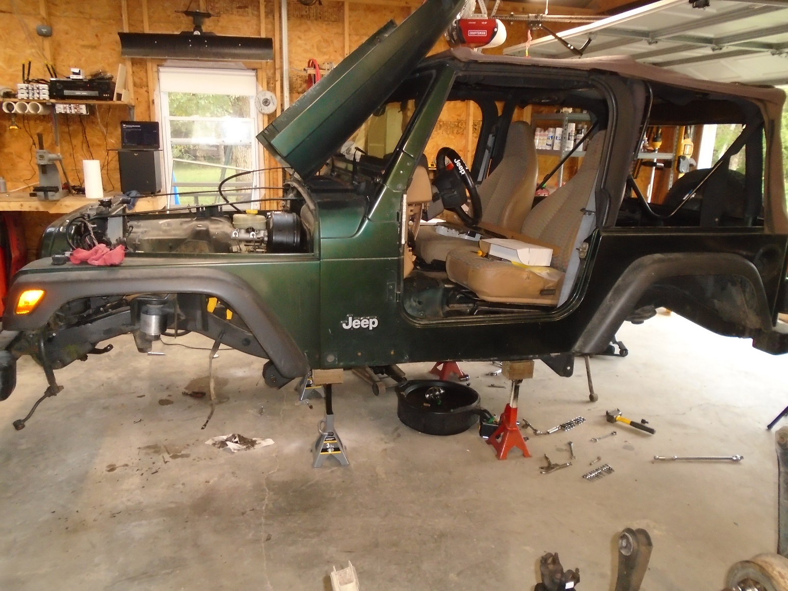

Back in July 2020 (a few days after my birthday) I bought a 1997 Jeep Wrangler with over 250,000 miles on the clock. The 4 cylinder was very tired but it ran pretty well and I was able to drive it home. The overall condition of the Jeep was as you'd expect for a vehicle with so many miles. I live in Tennessee but I suspect the Jeep lived most of its life somewhere very dry and free of road salt as there was only light road grime on the chassis with the factory paint still intact. There was only a small spot of rust in the passenger footwell.

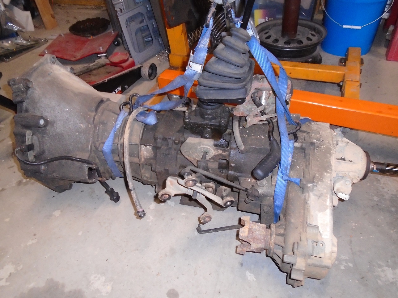

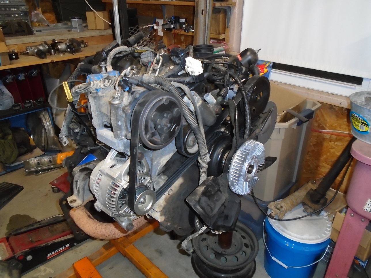

Of course first thing to do was to get that nasty dirty engine, transmission and transfer case out.
Image Image
I weighed these parts and came up with 660 pounds.
I also removed the standard ICE parts: fuel tank, fuel lines, exhaust, various emissions components, etc...
I didn't weigh all that stuff but I'd guess another 150-200 pounds.

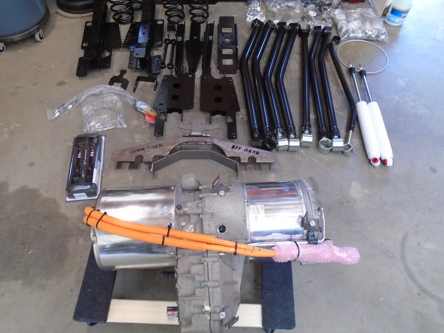

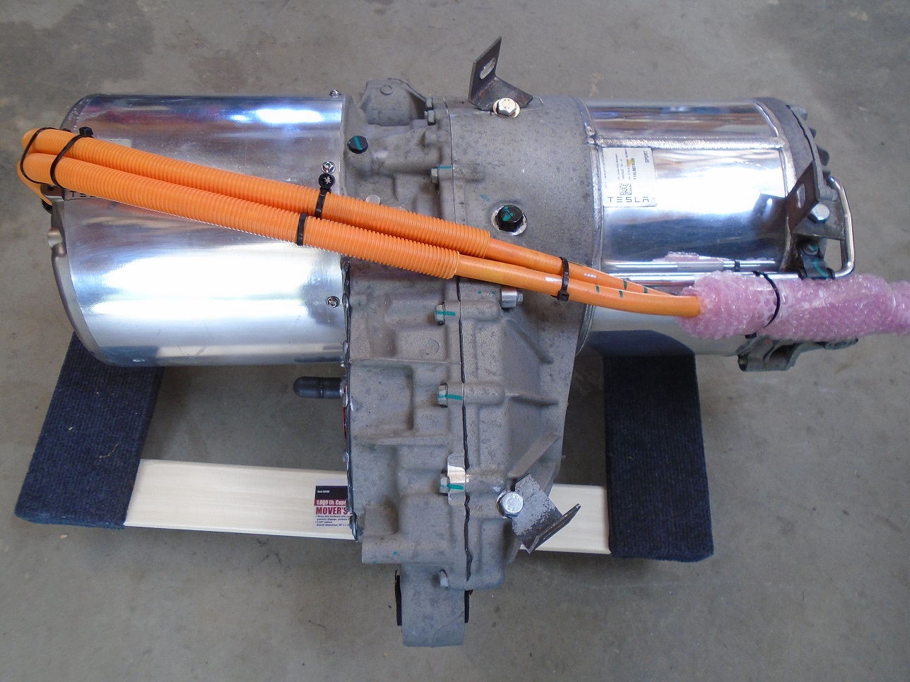

Now the job was to figure out who to buy a Tesla drive unit from. My research indicated that the main choices were EVWest, 057 Tech and StealthEV. Ultimately, I went with StealthEV because Matt Hauber and I are former employees of Jack Rickard at EVTV. Matt worked with Jack in the early days of Lithium-based EV conversions and I worked there about the time Tesla drive units were being reverse engineered. If you ever watched EVTV during that time, you may remember they stuffed a LDU into a VW Doka. If you've never seen EVTV, check this out: That's me! :)
I gave Matt a phone call and sent him a big, fat check. A few weeks later this showed up in my mailbox:
I think that's where I'll leave it for tonight.

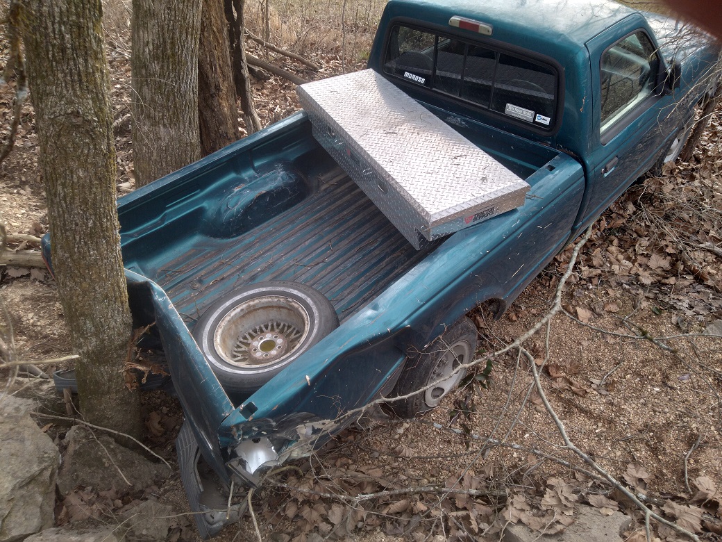

So one of the things that was always in the back of my mind was what's the plan for the Ranger when the Jeep is finished? I can't imagine I'll drive much so it's just going to sit around. It has a lot of good parts that could be used for something else but why take apart a perfectly good conversion??

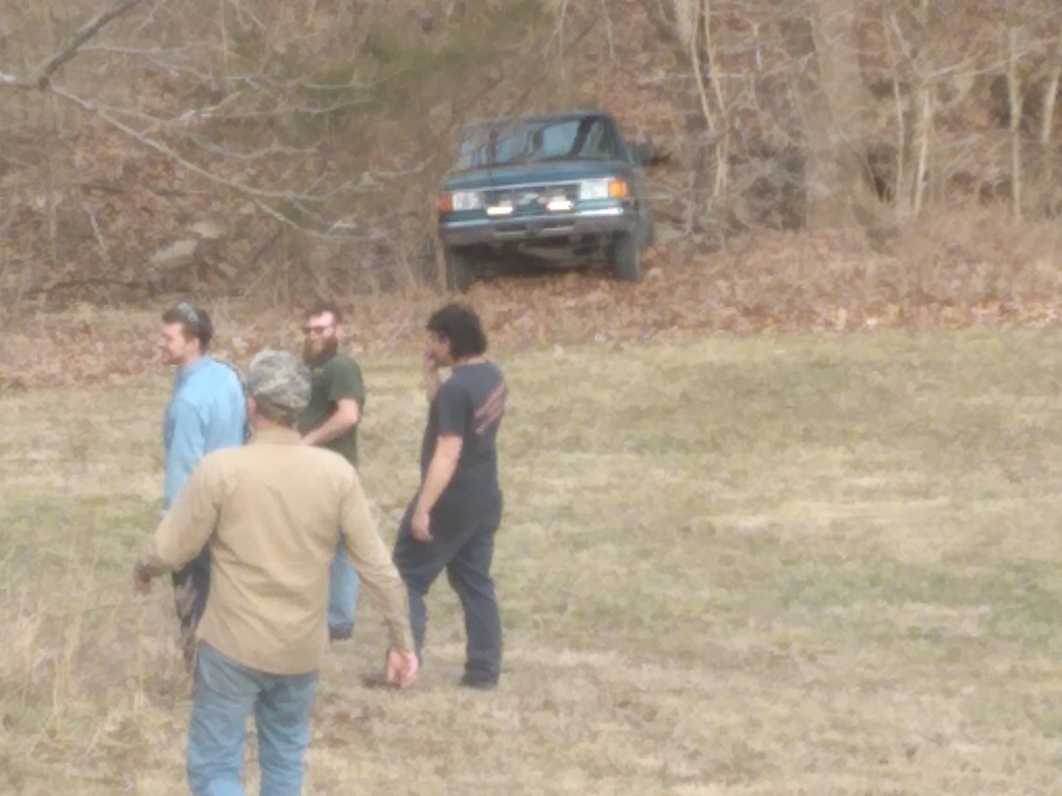

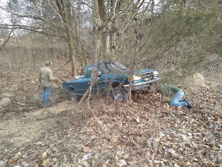

Well, life has a way of solving difficult problems.
The parking brake has always been essentially non-functional so most of the time I just park on level ground and left it be.
That' worked 99.99999% of the time. Thursday was the 0.00001%.
It's very sad. The frame was visibly bent on the right side along with that spring hangar getting shoved forward about 1/4".
I don't know how fast it got going but the forces involved to wreak this much havoc must have been enormous.
Needless to say eRanger is no more. This weekend I'll push the Jeep aside (literally and figuratively) and start stripping parts.
Two of the battery boxes were damaged so it's likely that a couple cells were damaged, also. We'll see.

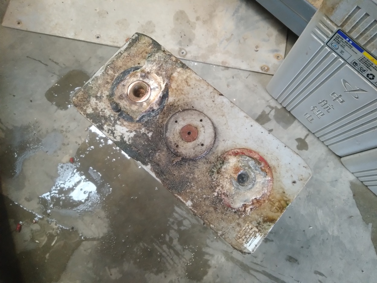

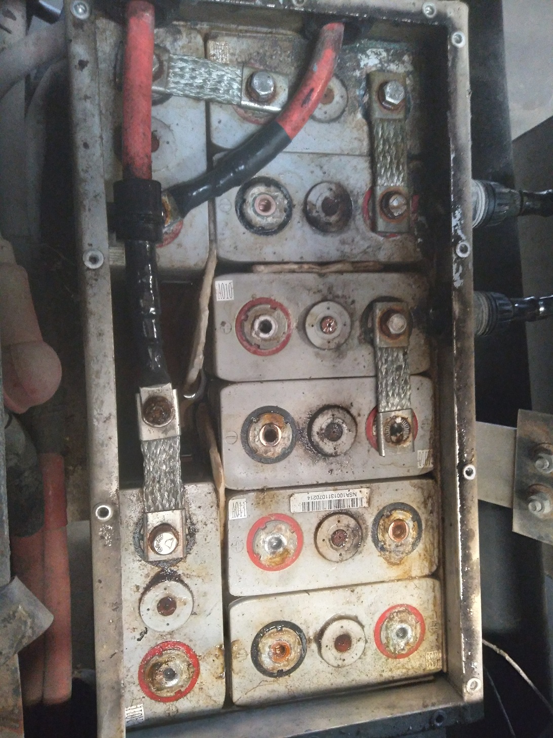

So the tree blasted the rear bumper into the rear battery box. The collision was strong enough to rip a hole in the .060 aluminum. One cell was in the direct line of fire. Apart from a superficial dent in the plastic housing, there was no damage at all. I didn't even take a picture because there'd be nothing to see.
A second battery box that was struck from below by a rock or something caused no visible damage to any cell at all.
One of the other boxes (there are 5 in all) clearly had a water leak. It was full of water within about an inch of the top of the cells. Every battery strap and cell terminal was corroded. Every NordLock was rusted. There was mold and nasty stank everywhere! I have no idea how long it had been full of water but certainly before last week when it was well below freezing every day.
Despite all of this, not a single cell was swollen and all of the voltages were within .002-.003 volts! Granted, the pack is about 66% SOC so the voltage doesn't really tell much but still I'm a LiFePO4 believer forever!!

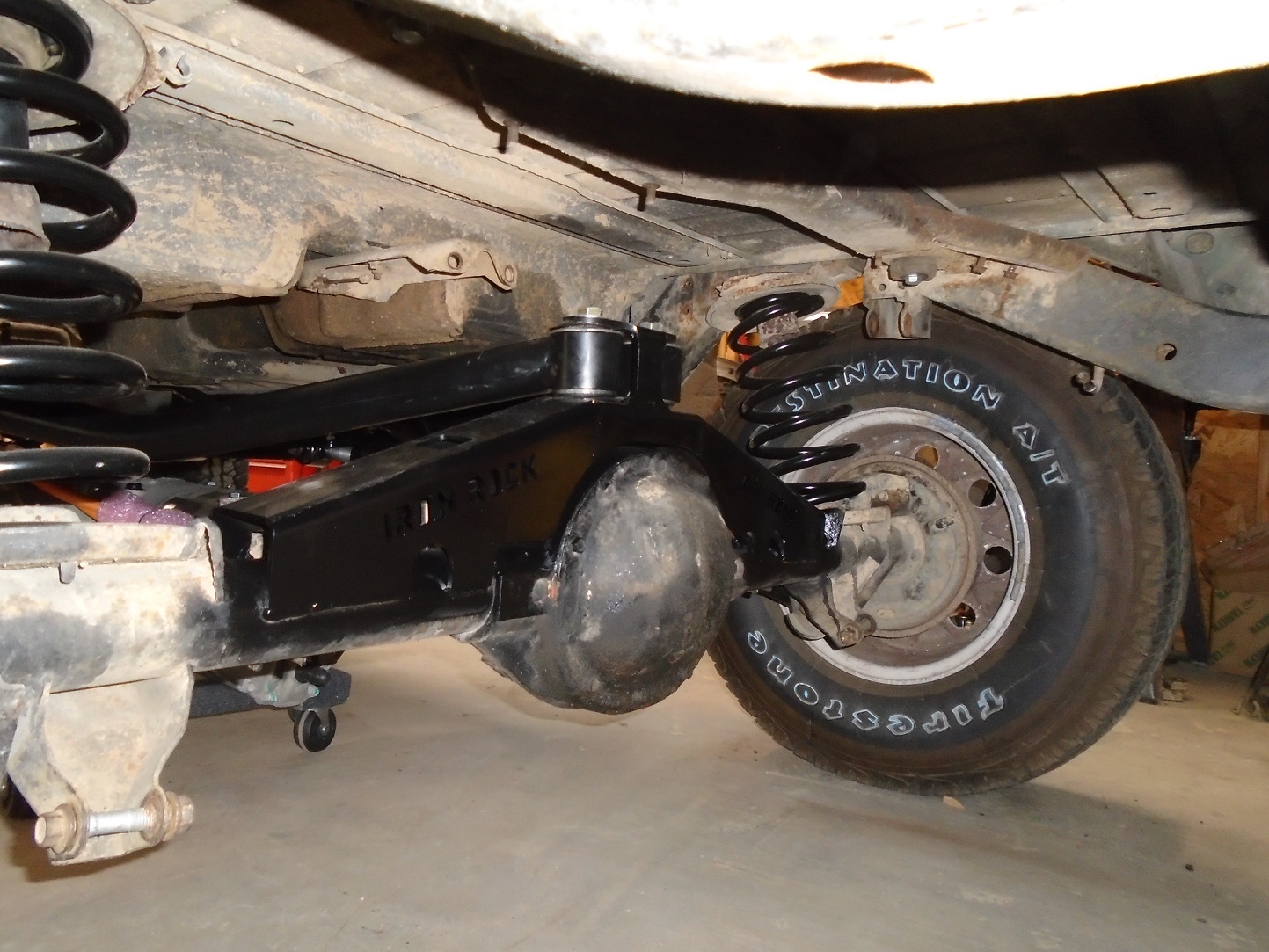

First thing to do then was tackle the suspension. If you didn't know, Jeeps are rather "upgradeable." I dare say they have one of the largest aftermarket parts inventories of any vehicle! I watched a few videos that convinced me a long arm kit was for me. After looking at several kits, I threw a bunch of names at the wall and the one that stuck was Iron Rock Offroad. https://www.ironrockoffroad.com/
This kit is not for the faint of heart. You have to cut/grind all of the factory suspension mounts off of the frame and axles and weld on a truss to the rear axle. You were able to read that WAY faster than I was able to do it. Without the shocks on, it's a VERY smooth and bouncy system. I think I may run into a problem with the spring rates though once the batteries are installed. The front will probably be OK but the rear weren't designed to support 400lb of batteries. We'll cross that bridge later...
Next on the list was brakes. I got a large disc/caliper kit for the front and a disc brake conversion for the rear. Of course I painted the calipers red...duh! I did the rear conversion for a couple reasons. First, it looks cool. Second, Jeeps use Dana 35 rear differentials and they use C-clip axles. Basically, there's literally a clip shaped like a "C" that holds the axle in. If you happen to break an axle, the broken half and your wheel can dissociate themselves from your Jeep. With a disc conversion, the axle is still held in with the C-clip but the broken half is held in by the disc and caliper.

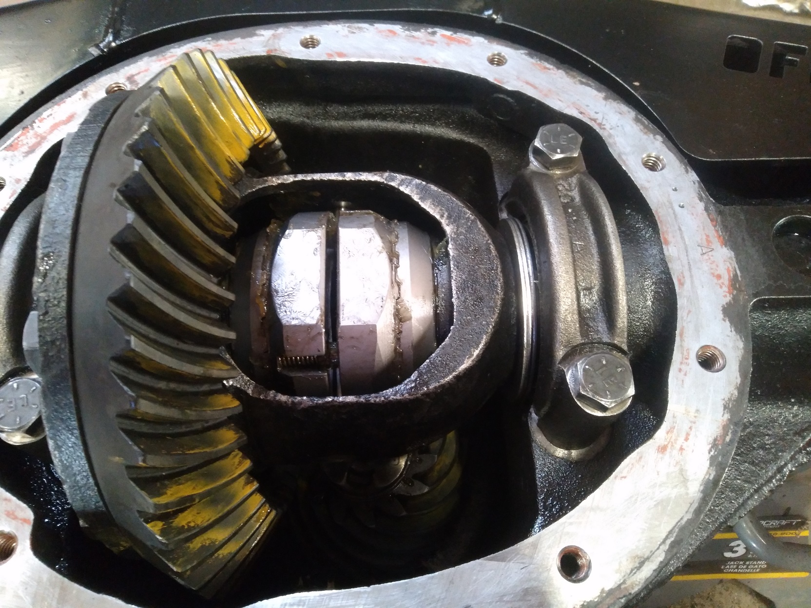

While I was in there I also upgraded the axles to chromoly and changed the differential gearing. The Tesla DU comes from the factory with 9ish:1 gears and my Jeep came with 4.11:1 gears. Since I'll be running the DU longitudinally with the right output shaft going to the front and the left going to the rear, multiply those gear ratios together and you end up with an obscene 36ish:1. With 31" tires, even an astronomical 16,000rpm would only give me a top speed around 40mph. Fortunately StealthEV offers the Quaiffe 4.5:1 gear set for the Tesla DU and Spicer offers a 3.07:1 gear set for Jeep diffs. Those will give me a much-more better 106mph top speed. Swapping the Jeep gears out was not as easy as I'd have hoped. I had to have one side of the front carrier machined .015" and the rear .030" and add a whole bunch of shims to the other side to get the backlash, preload and wear patterns correct. The backlash is still a little tight but hopefully it'll loosen up over time. OR it'll tighten up and cause major problems. We'll cross that bridge later...

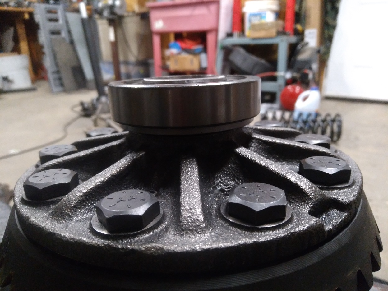

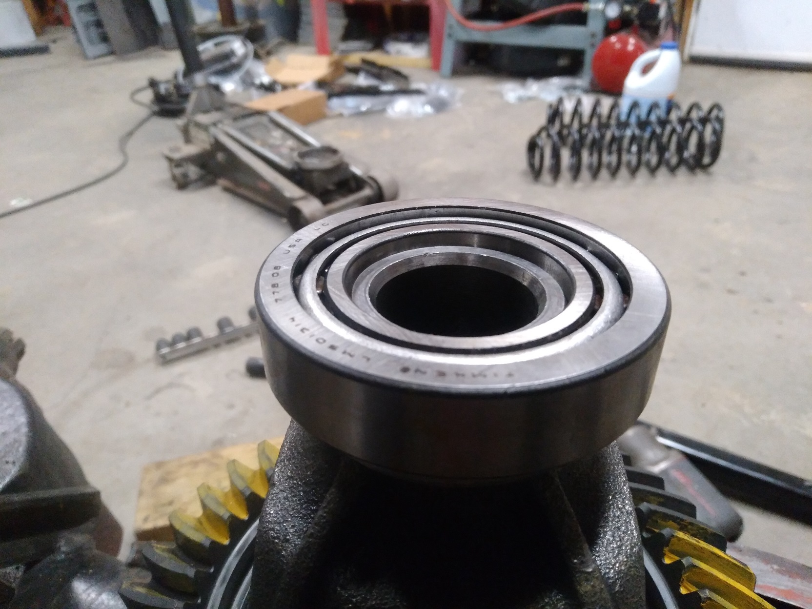

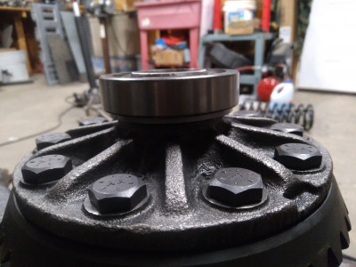

The last thing to do was fit a locking differential to the back. Again, there are a number of flavors. You can get them with disc packs, cones, air actuation, electronic actuation, worm-like gears, sprag-like gears and spools. The Land Rover used a torque biasing style from Auburn. These are IMO the best kind for vehicles that spend the majority of their lives on the road. There's nothing to wear out and they don't require special additives. I guess they don't make them for 3.07:1 gears though. All the ones I found were for 3.5:1 and lower (numerically higher) gears. I'm not surprised, 99.99% of Jeepers would never put taller gears in their Jeep...why would anyone do that?? I'm the .01%. I ended up getting what's known as a "luhchbox locker." They are of the sprag-like gear type. Called lunchbox because one manufacture of them ships them little metal lunchboxes. They don't require special additives either. They're very simple and will take about 100 years to wear out. They also, quite literally, drop in to the factory differential carrier. Problem is they're a little noisy when you go around turns. You call it noisy, I call it cool!
In the picture you can see the wear pattern on the ring gear, all the shims I had to add and the sprag-like gears in the locker.
