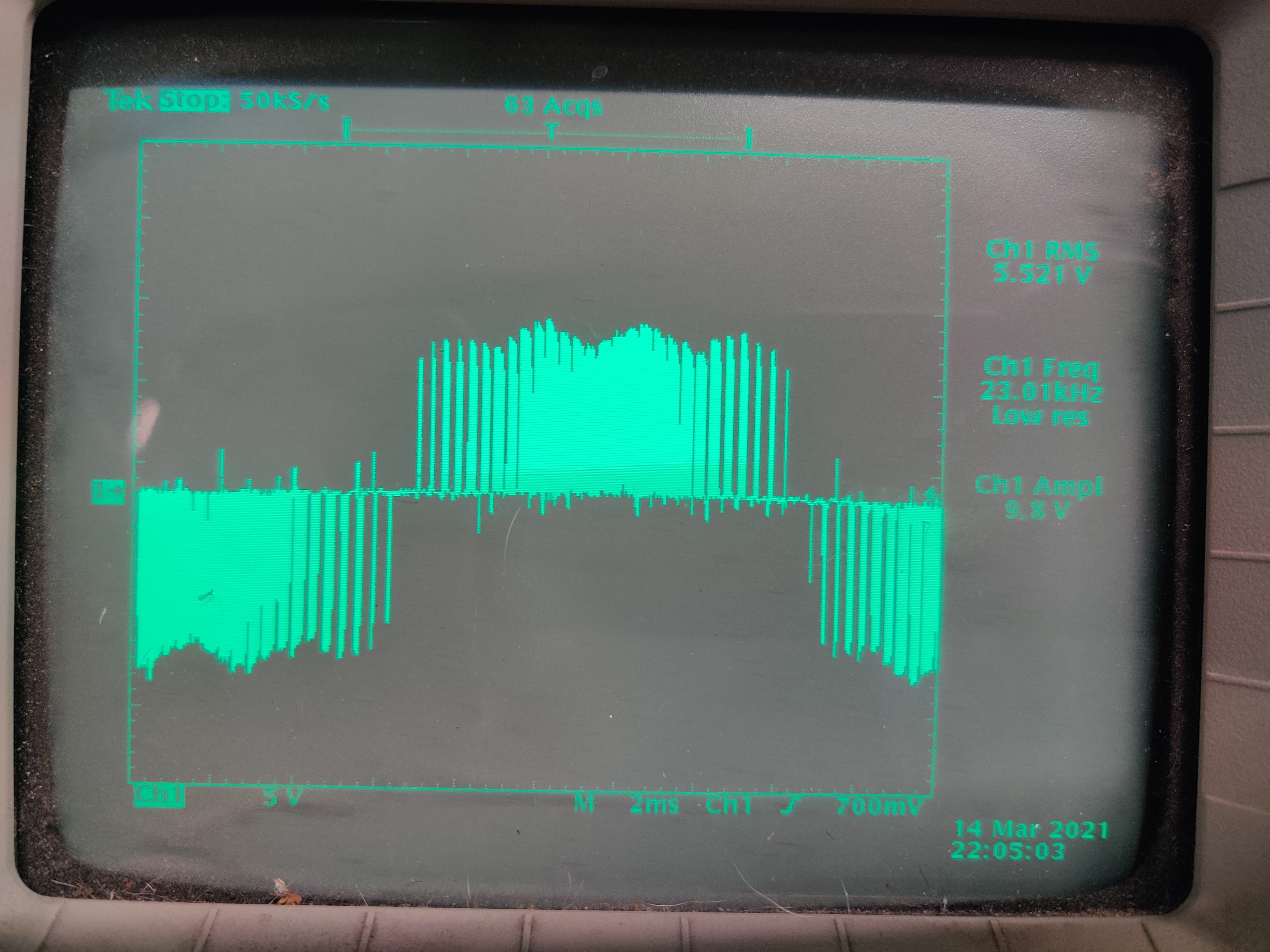

I connected them raw to the egs002 module just messing around (12v 1.5A current limited of course).
To be honest I have never used an oscilloscope before and it doesn't help this one is ancient as well haha. So I don't really know what I'm looking at, but here's the AC output of the H-Bridge. It seems quite rough but from what I understand it needs a capacitor and inductor as an LC filter. And it probably doesn't help that the EGS board was running blind with no feedback.
Anyways, I was looking at an interesting IGBT driver. Its called the "EXB841" and seems to be one of those weird All-in-one deals, with its own DC-DC converter for negative gate switching and everything. They cost very little, around $4 a piece. Says it can handle 4A. Wonder how those would do?
