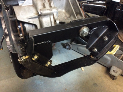

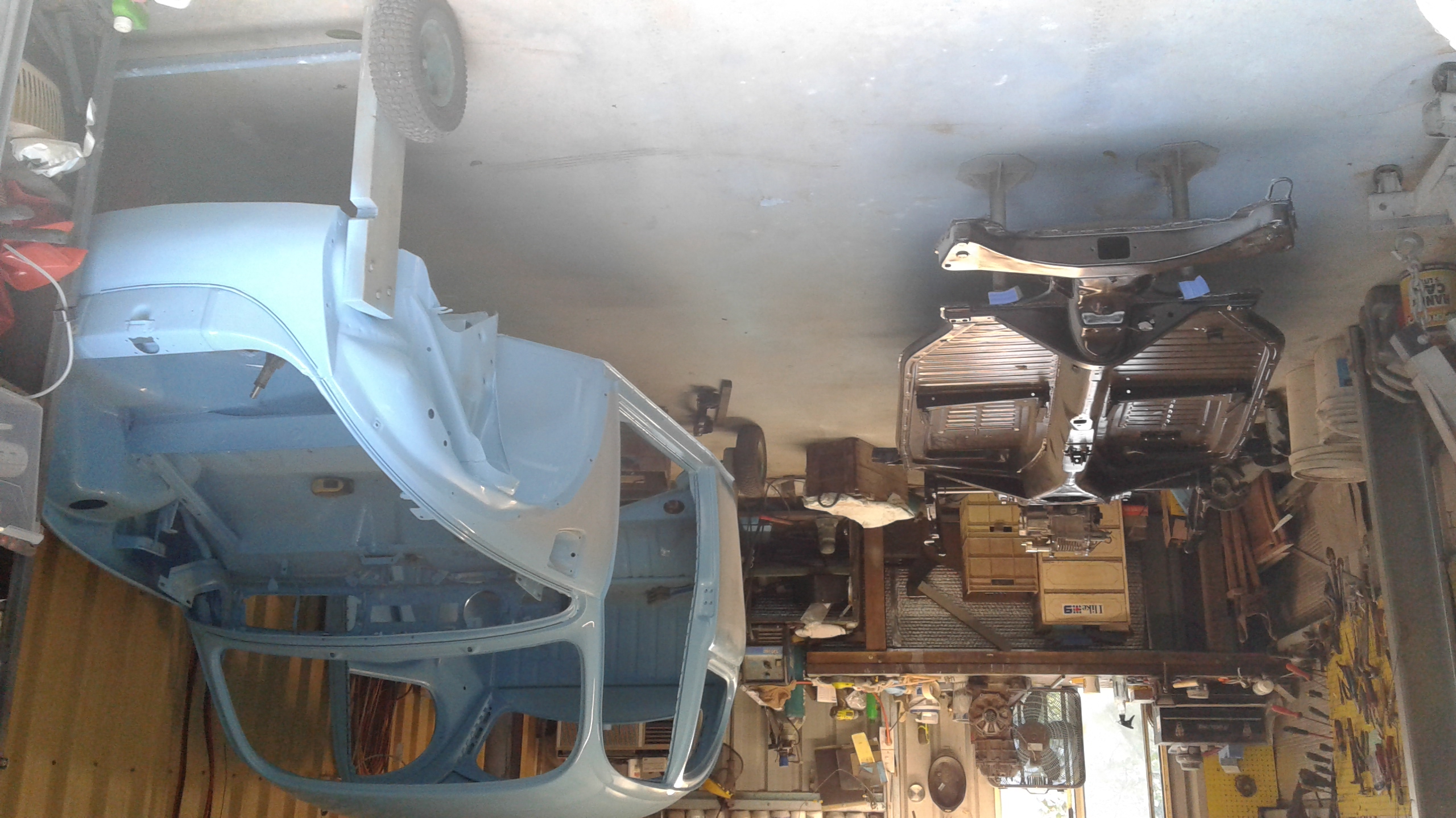

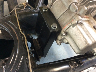

Where do the weeks go? As this is also a complete bare metal, nut and bolt restoration it was never going to be quick. The advantage being that I have more time research the EV side of the project.
MECHANICALS
The floor pan is now sitting on its own wheels again with the MGR installed on its new mounts. There were no structural modifications to the Beetle ‘horns’ and the motor has just a slightly raised front and about a 10mm offset to the left. I was expecting to have to source some shorter ‘racing’ half shafts but with the rear suspension now rebuilt it has been possible to do some accurate measurements and the current plan is to shorten the right hand MGR stub axle by some 10mm (they can be prised out with little effort) weld on a 10mm plate which will then have a recess machined into it and 6 @ M6 holes tapped to match the original VW CV joints. The left hand will need to lose 20mm with a similar 10mm plate. i Original engine mounts have been used so, as with the original Beetle motor, replacement couldn’t be simpler. Remove the electrical connections, disconnect the CV joints and there are just 4 bolts securing the motor to the body!

Now that the body is almost ready to be returned to the floor pan it is high time I put some effort into planning the two electrical layouts. Replacing a 50 year old wiring loom without the alternator, distributor etc isn’t the biggest of challenges. However designing a high voltage system is completely new to me and a challenge that I can see is fraught with lots of potential hazards so, first problem -what battery?
