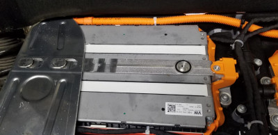

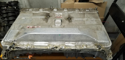

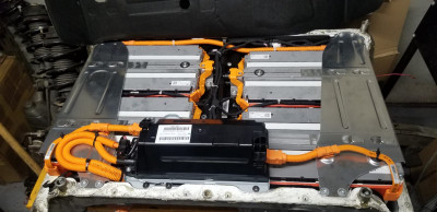

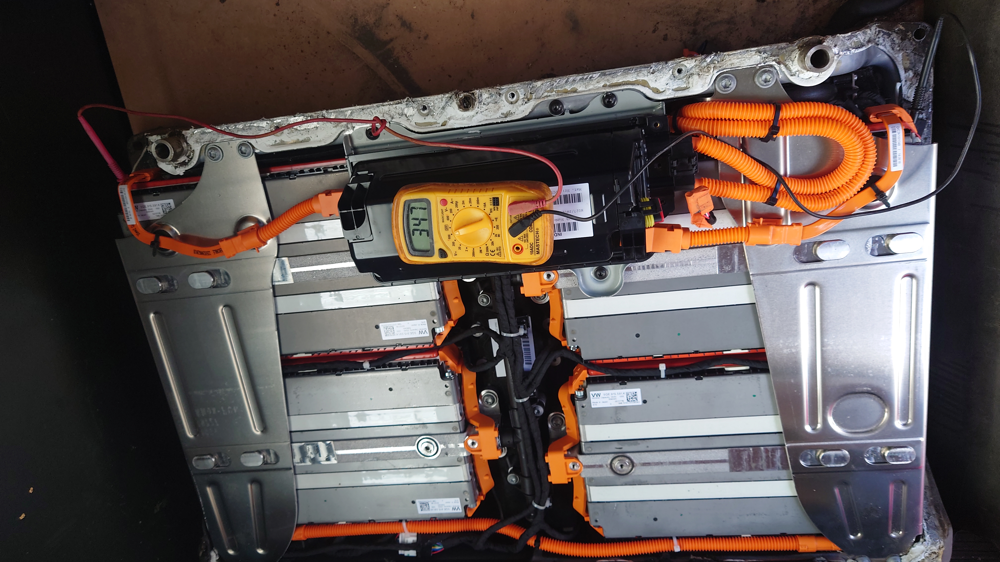

Hi All,
Heres some pics of the Golf MK7 GTE hybrid battery its 8.7kw watercooled. the bms communates to the battery modules thru canbus.
if any one has a golf GTE or Audi etron near London who wouldn't mind letting me plug my diagnostic into to get the canbus control messages would be mega helpful. i would like to control the linbus controlled ac compressor.

I have the same pack. Documented on the wiki. There's a dbc file there for the internal battery can bus.
What's missing the the balance command, it would be great if you did manage to get a car to plug your pack in to and charge, see if we can get a log during balancing

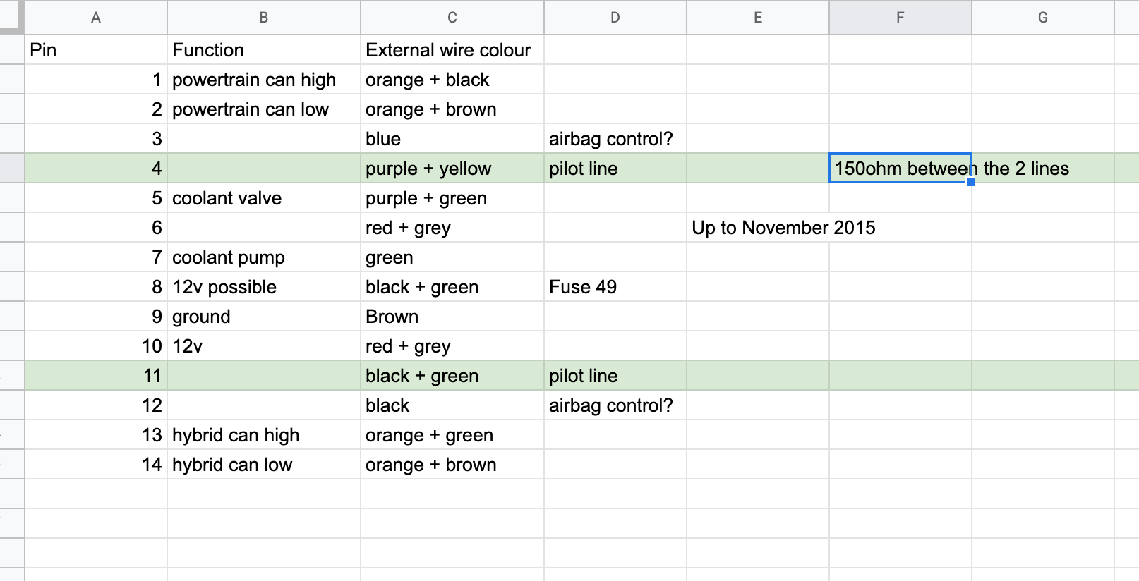

Hi this is the pinout for the battery external connecter as near as i can figure.
External Pins GTE Battery and E-up
1 Can H Power
2 Can L Power
3 Airbag Crash
4 Pilot (In)
5
6 12v (30a)
7
8 IGN (15a)
9 GND
10 12v Safety (30a)
11 Pilot (out)
12 Airbag Crash
13 Can H Hybrid
14 Can L Hybrid
you need two 75ohm resistors on the pilot line to remove the safety errror

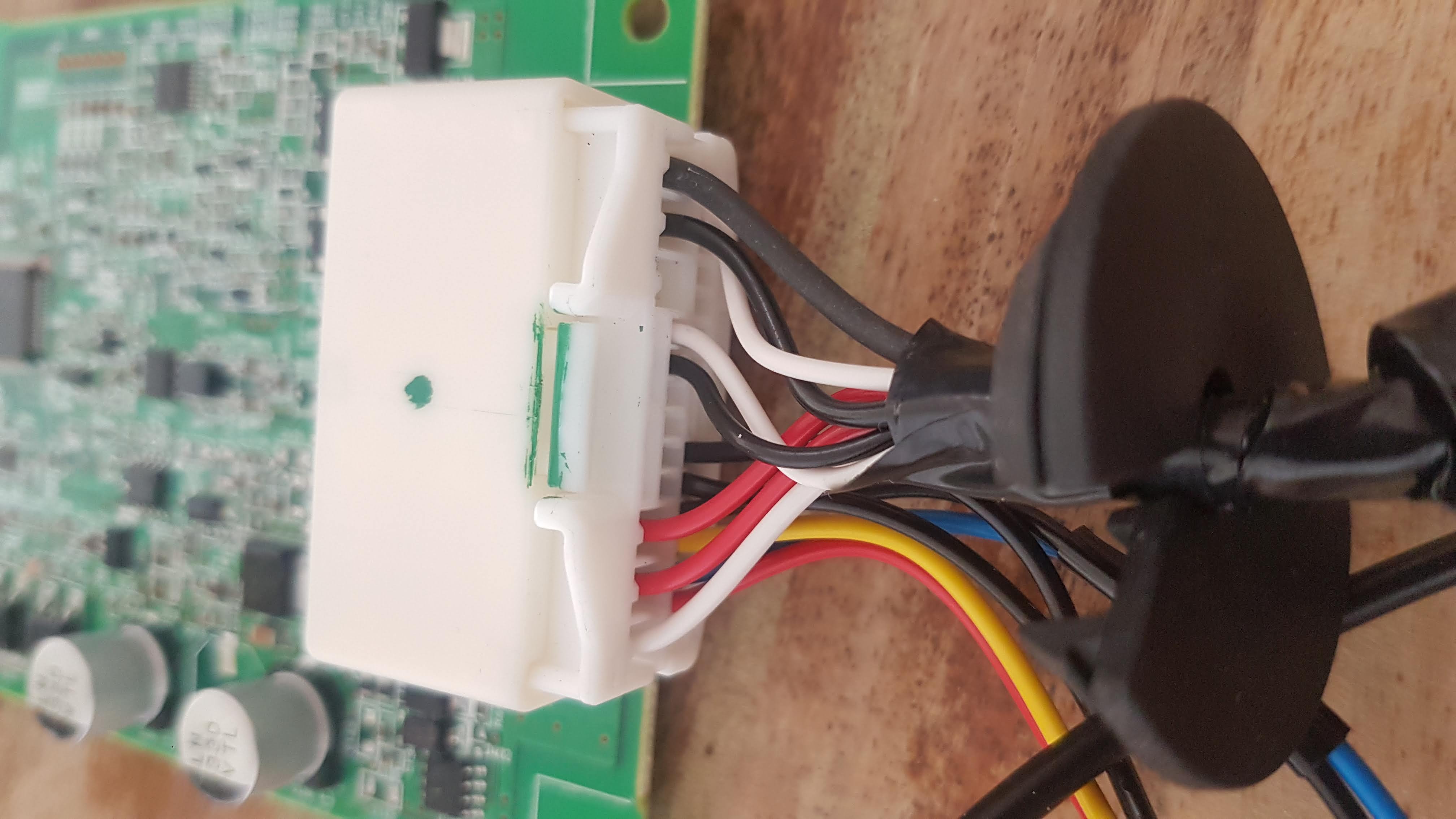

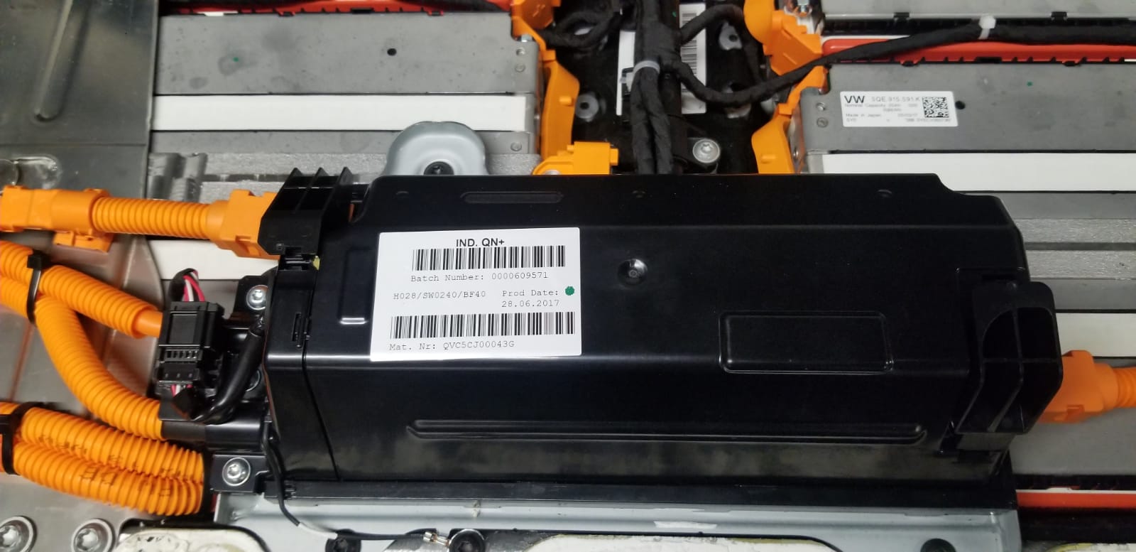

On the contactor control board, the left most white wire, and right moat white wire, do you have any clues as to what they are for? Maybe the safety interconnect? I butchered the cabling before checking where they go.
The 2 reds next to it are 12v in, the black can low, white can high(battery can) the next black is GND, the black with a ring terminal had 5v on it, assuming it's used for some isolation tests?

The first white appears to be 12v ignition, give it 5v and the other 2 voltage regulators start spitting out 5v. Just one wire left to identify now.

Re: VW Golf GTE battery
I've got a second pack to play with. I've been able to get the contactors to close from the hybrid can thanks to some logs from DomT177
This is the pinout of the external connector. To close the contactors 0x09C & 0x3A6 are needed on the hybrid can.
0x3A6 58 02 11 00 00 01 00 00 byte 1 (0 indexed) increaments to 0F and restarts, not yet sure if it cares about that. Byte 0 is always the same, so for 0x02 byte 0 will be 0x58.
https://github.com/DomT177/GolfGTE
