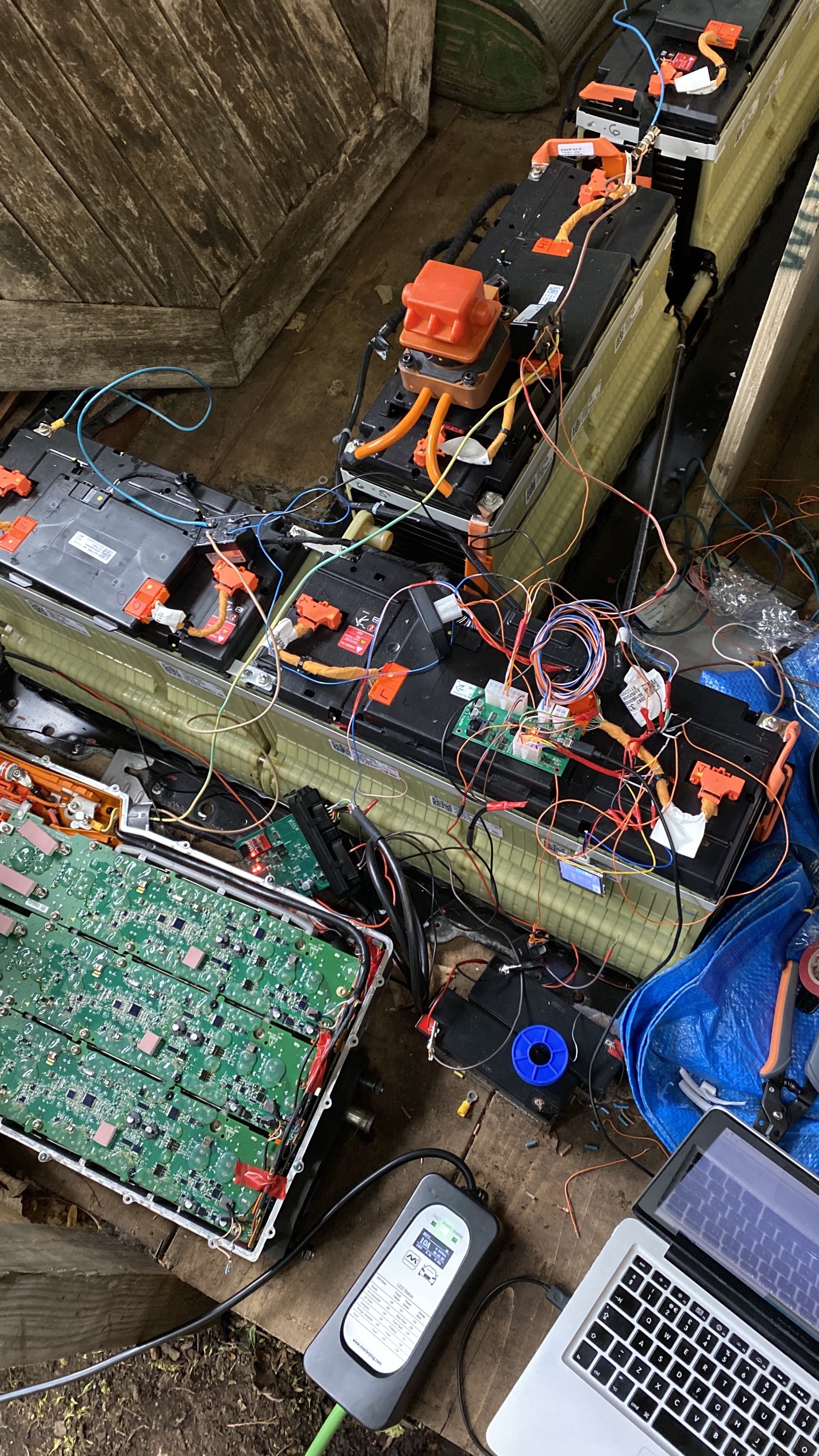

Hi!
I was able to charge successfully from a wall socket at baby test ampage. (5amp)
I used a variable resistor to get the resistance correct for it to detect the plug.
I haven’t put my brain to work on the charging side of things in a while so I might misremember this but I think SIMP BMS controlled the charge relay, and damiens gen 3 board did the handshake. https://www.evbmw.com/index.php/evbmw-w ... controller
I’m happy to talk through my progress. If that’s useful to you!

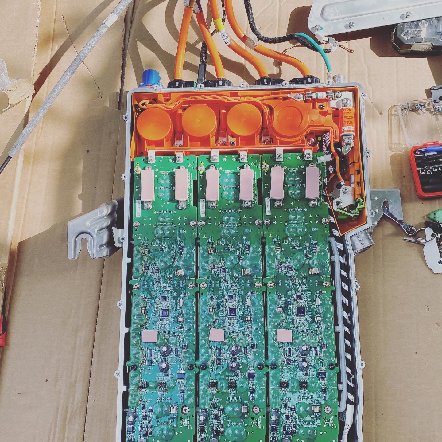

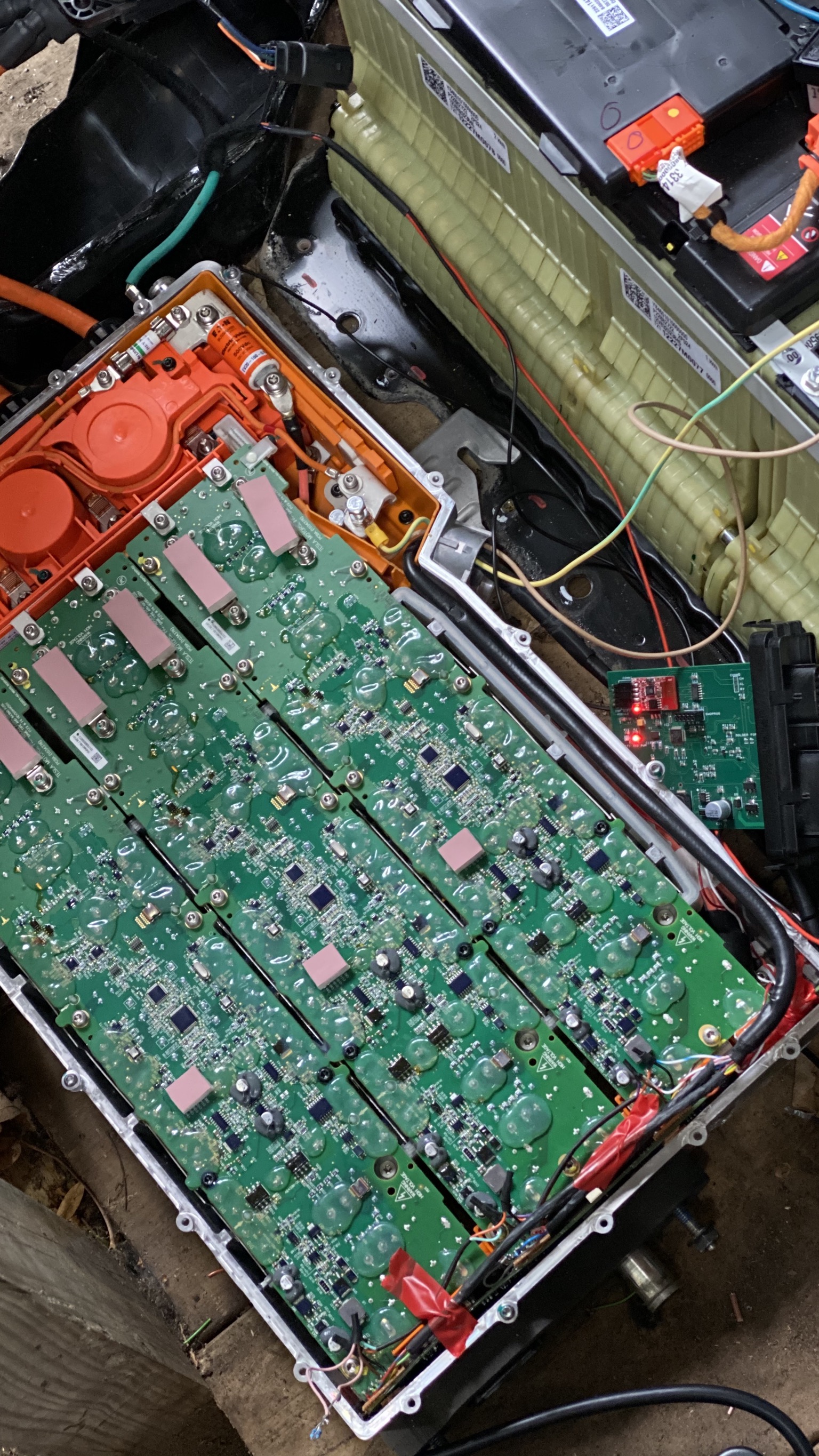

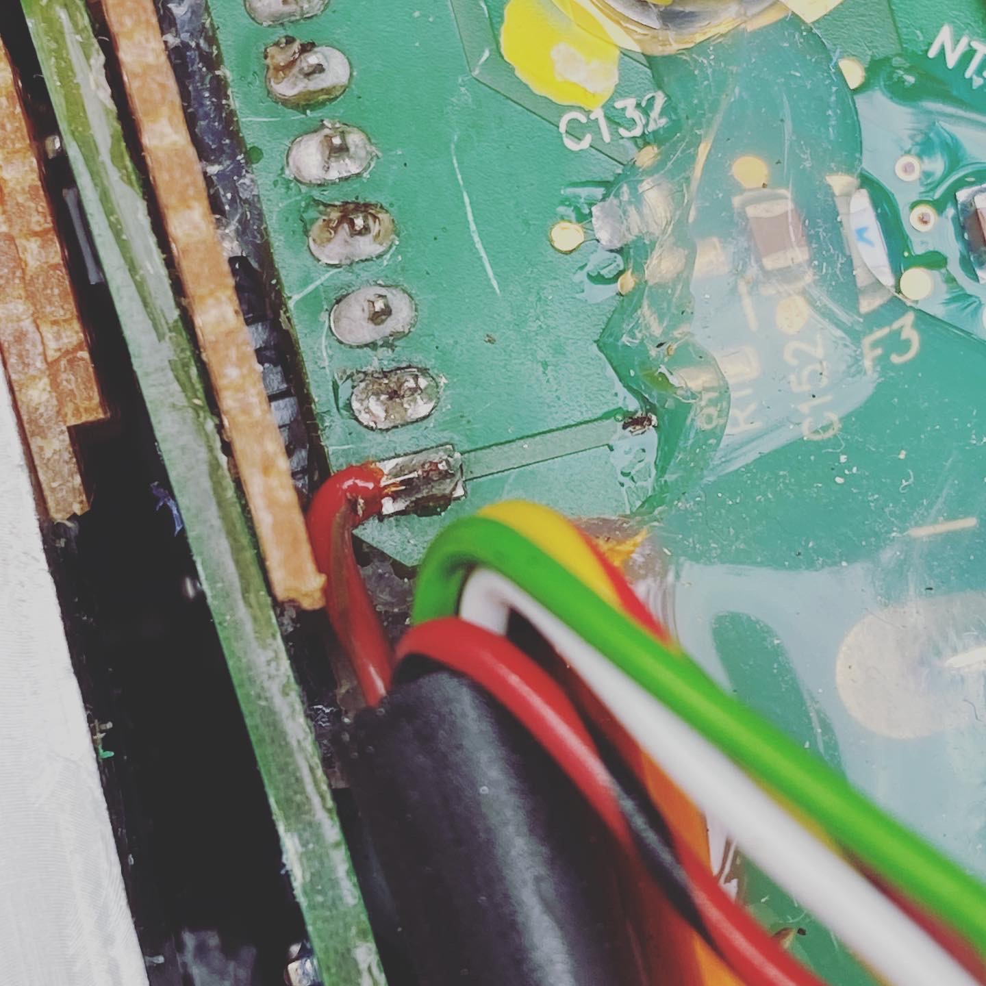

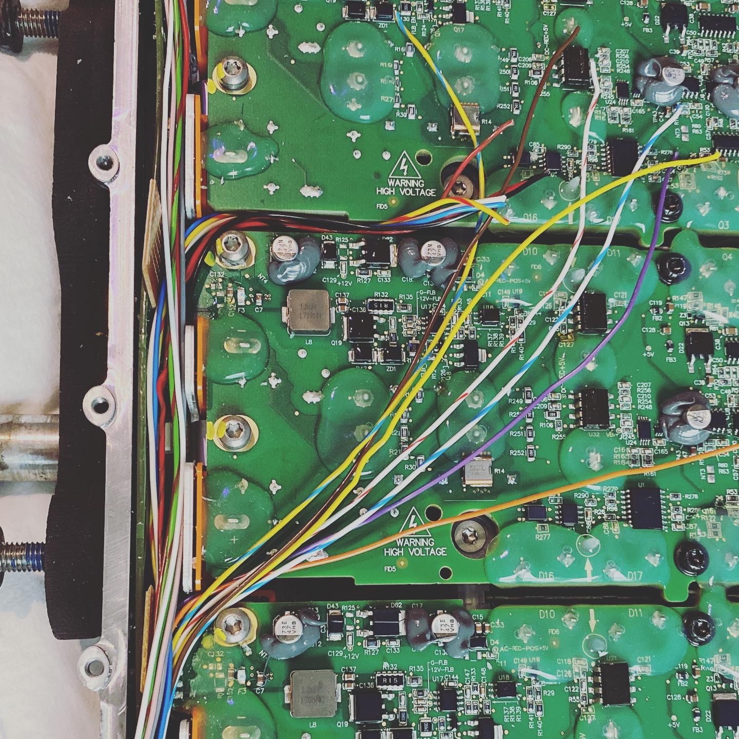

Cool I’m away for a while so can’t show you specifics but I have an eu version, so no modification required.
Evbmw covers the steps to convert to 3 phase eu.
I have spammed some photos, cutting the board isn’t that bad it’s nerve wracking!
The hardest is routing the cable to not compromise the weather sealing.
I also left a spare cable in mine to avoid having to desolder the whole lot Just for one broken line. I think it’s 18 lines (I used 3 ground and 3 positive because they’re thinner gauge than ideal.)
I had to merge these into two pins defeating the purpose 🤣
I think mine is 18 but I cannot remember off the top of my head.

ev340 wrote: Fri Nov 12, 2021 9:39 pm Cool I’m away for a while so can’t show you specifics but I have an eu version, so no modification required.
Yes I've seen it is a bit more difficult to wire gen3 vs gen2 😊. Do you know if your charger is 10 kw or 18.5kw? Trying to decide between gen2 and gen3. If they were the same price which one would you choose? Gen3 is harder to wire up but have a bonus of integrated junction box that you don't need to buy separately.
Yeah gen3 is much more fiddly, I have a gen2 too which was nothing to wire up just push connectors.
I’m not sure off the top of my head if it’s 18 or 10, I chose gen 3 because I got mugged off with one of those super charger gen 2 chargers so I just wanted to avoid that ever being a risk.
Also, the gen 3 has a HV output whilst charging. Which i find interesting, I’m not sure if I’ll use it yet but it could be handy to run a heater whilst charging without needing to wire up a relay for it. Is that what you meant by junction box?

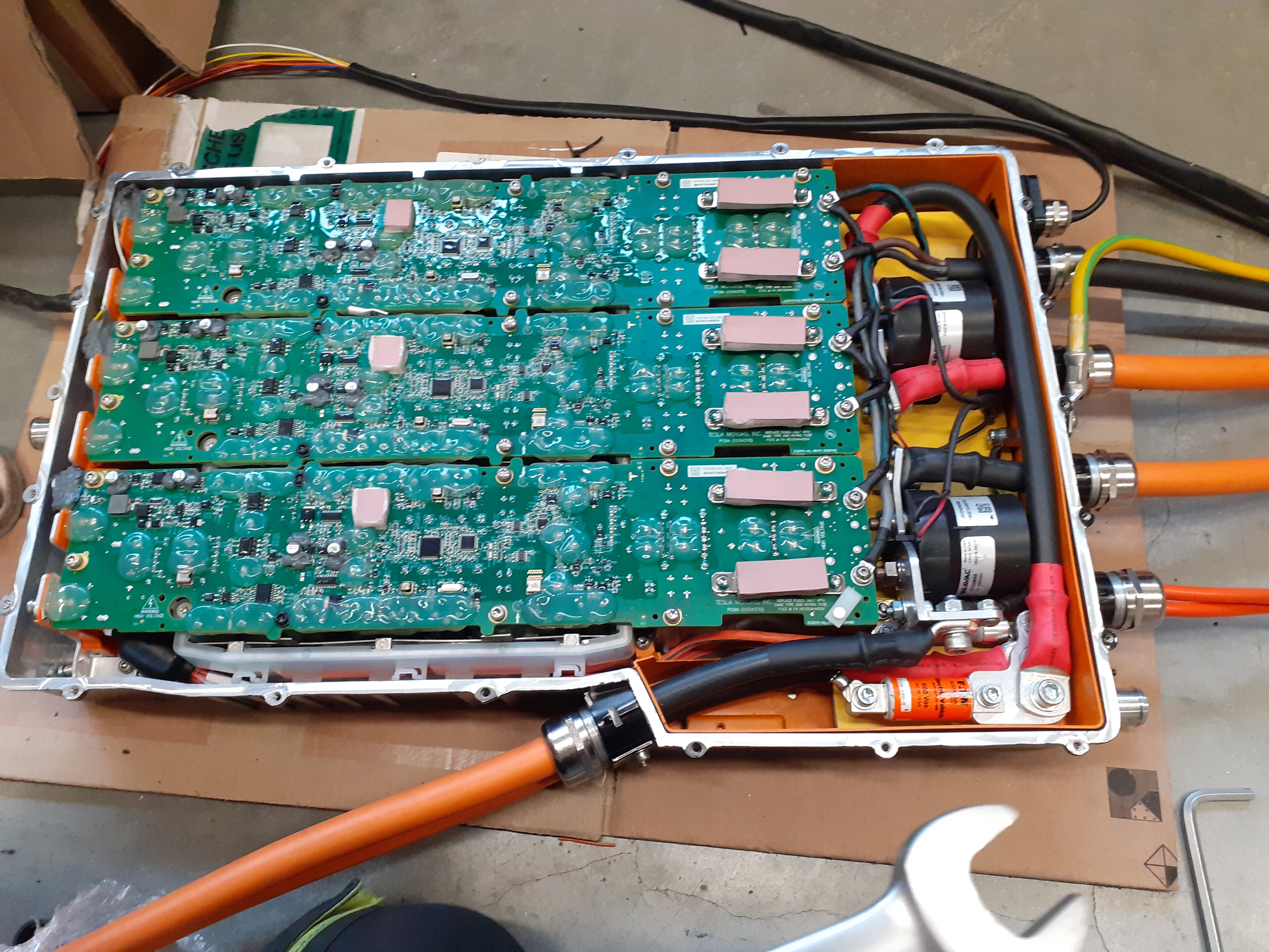

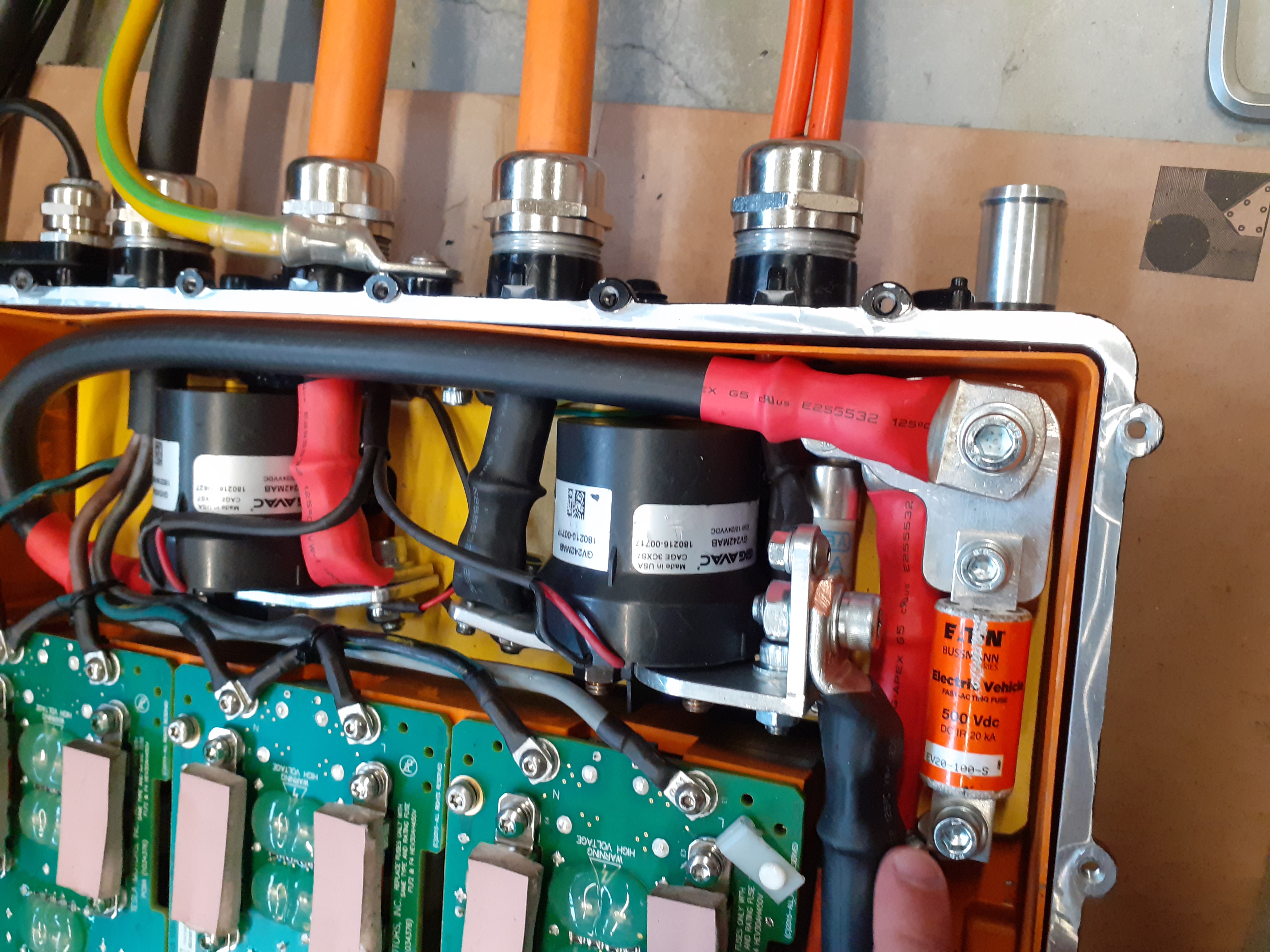

muehlpower
Posts: 807
Has thanked: 18 times
Been thanked: 186 times
Re: Tesla Gen 3 charger compatibility
Post by muehlpower »
The difference between 48A and 72A is easy to see, as the 48A only has 2 instead of 3 modules. I think there are also some with only one module. US models differ in the hardware only in the contactor part, which is normally not used by us. I used the space on mine to accommodate the DC contactors for fast charging and a couple of fuses, as well as the voltage measurement for the LIM.

muehlpower wrote: Sat Nov 13, 2021 12:56 pm I used the space on mine to accommodate the DC contactors for fast charging and a couple of fuses, as well as the voltage measurement for the LIM.
Thanks, that is very helpful and nicely done. Would you explain the wiring a little bit? Do you have AC coming in via 2 separate ports (black thick wire and 2 smaller orange wires) and is it wired for 3 phase? How is the control done when you connect to single phase and then 3 phase is it automatic or you have to change a setting? Also looks like you're not using AC contactors how are you timing the AC application to the charger is it done via EVSE? Which control board are you using? Also looks like you totally removed Tesla mainboard are you connecting to the modules via it's connector?
muehlpower
Posts: 807
The AC input is the black cable (4x6mm²). The two thick oranges on the right are the DC input and, like the AC input, are connected to the CCS2 inlet. The two thin orange cables supply the DC-DC converter, battery heater, cabin heater and A/C compressor with power. I completely removed the original board and led the cables through the old connector hole to the controler. The two thick, lower orange cables go to the battery box, in which the main contactors and the main fuse are. In single phase mode only one of the three modules works, which gives me up to 6kW if the socket is adequately fused. I do not bridge 2 modules on the AC side because there are no single phase outlets larger than 32A! 16A is normal

muehlpower wrote: Sat Nov 13, 2021 12:56 pm The difference between 48A and 72A is easy to see, as the 48A only has 2 instead of 3 modules. I think there are also some with only one module. US models differ in the hardware only in the contactor part, which is normally not used by us. I used the space on mine to accommodate the DC contactors for fast charging and a couple of fuses, as well as the voltage measurement for the LIM.
Really neat setup!!!! You should be really proud of that!!
Posts: 3795
Been thanked: 411 times
Hi
Can anyone confirms to me if it is OK to use all straight wires on Gen3 charger modules the way Damien shows in his video? If you actually used them like that for CAN lines how is it working then?
I can see on some of my equipment if i use straight lines for a bit of distance on CAN it actually works, but after some 30cm signal is lost if wires are not twisted.
tnx

arber333 wrote: Mon Sep 19, 2022 6:42 pm Hi
tnx
I think some shielding would be wise especially this close to heavy currents.
