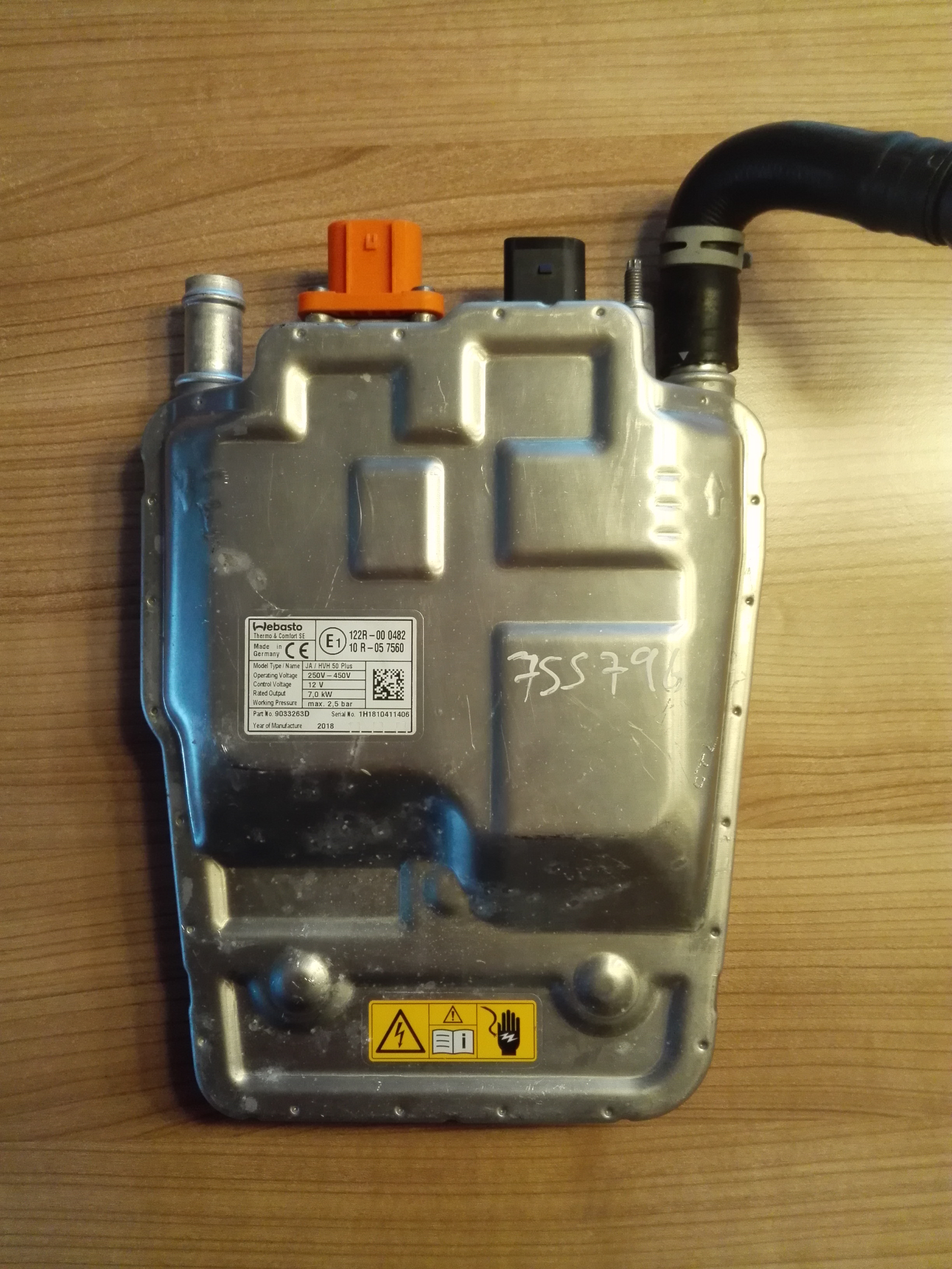

Webasto HVH50
Do we have any info on these?
HVH_Datasheet_2020.pdf- (202.15 KiB) Downloaded 827 times

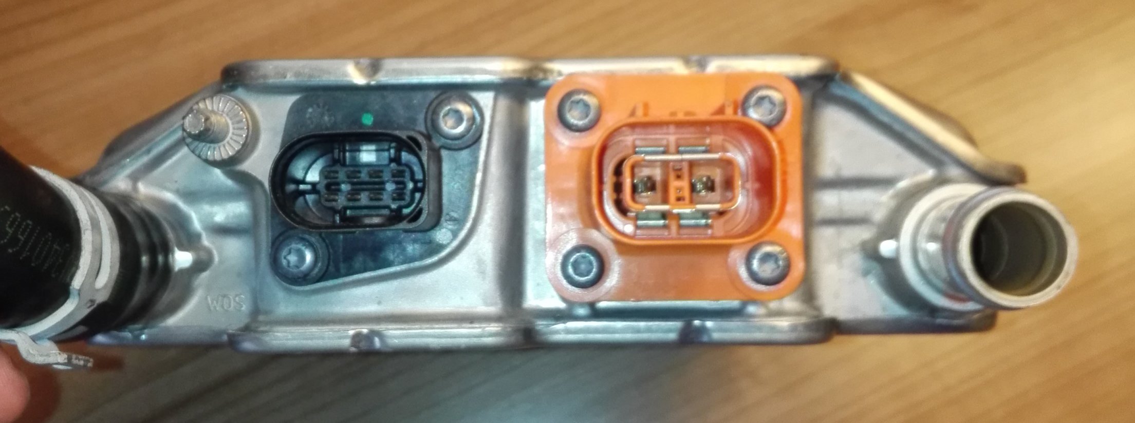

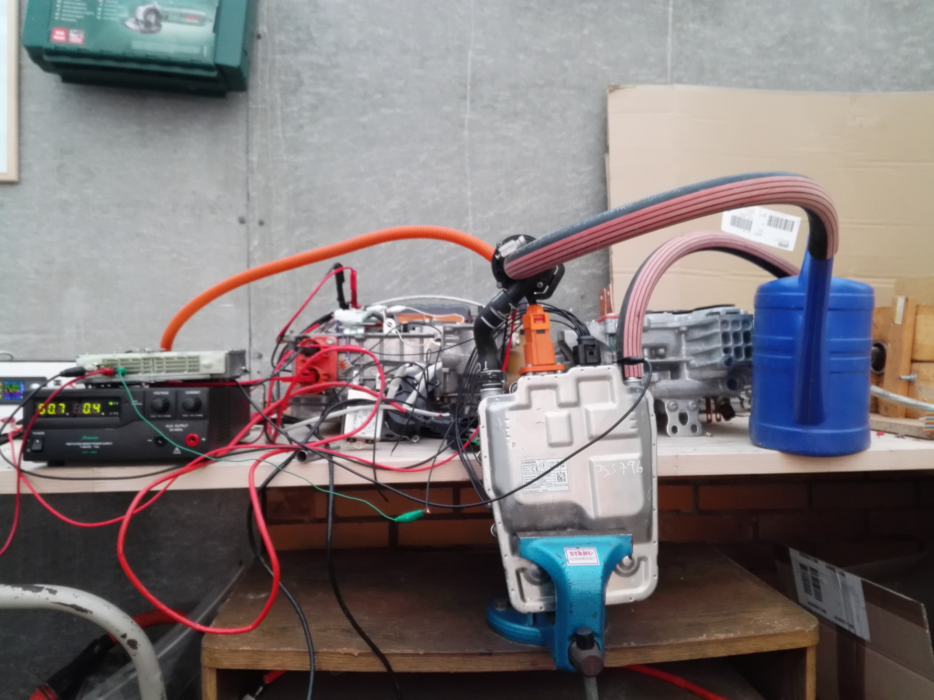

Re: Webasto HVH50

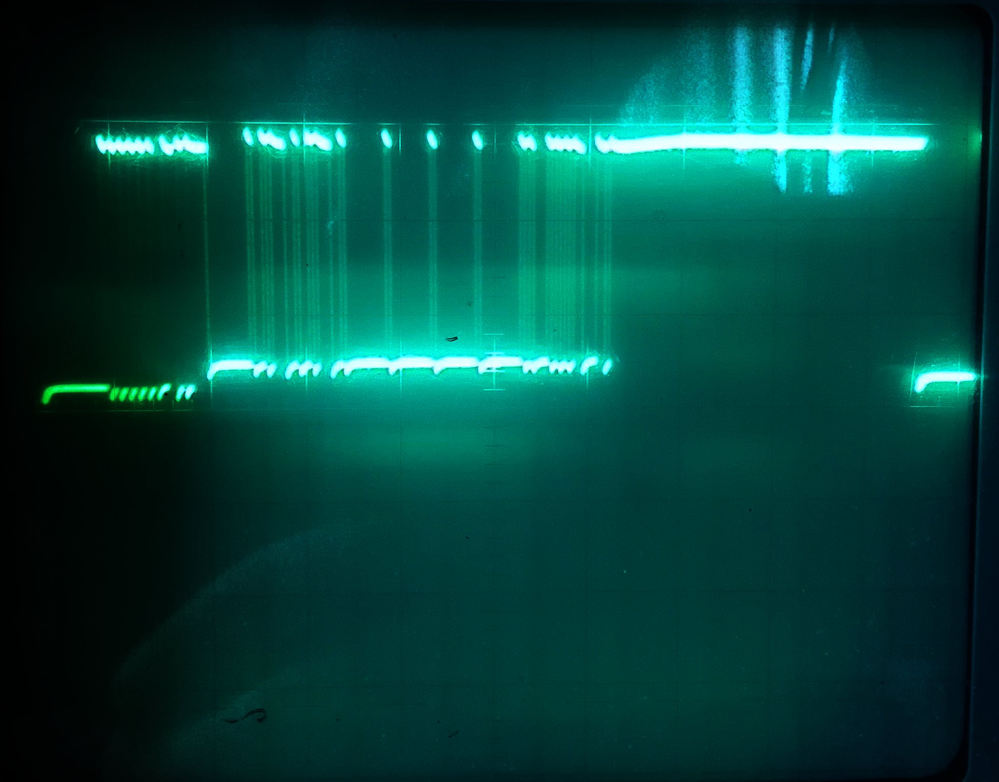

I have sourced all necessary connectors and connected HV to Prius-generated 290V.
I have tested the "analog" input, i.e. just supplying 12V to pin 3 - didn't work, no power draw from the heater
Then tested PWM on pin 3 - didn't work
Now I'm trying my luck at LIN. Since I have no transceiver handy, I just use an inverter gate plus N-MOS transistor.
Now in the manual it says that there is diagnostic info on ID 24. With parity that is 0xD8.
So I'm sending BREAK - SYNC (0x55) - PID (0xD8) - thats what you see on the scope (200us/div). At 19200 baud each bit lasts about 50us.
Now I would expect some kind of response from the heater but there is none. Only reaction is that it does actually wake up and draws about 100mA from the 12V line.
EDIT: maybe there is no heat output because I just filled the heater with liquid but didn't actually circulate it. That still wouldn't explain lacking comms though.

On this since there are pictures of how it should look on the oscilloscope, maybe that will help.johu wrote: ↑Fri Apr 16, 2021 11:20 am I have sourced all necessary connectors and connected HV to Prius-generated 290V.

i have written a program that simply sends all 64 valid headers without data bits and outputs the messages on rs232. Normally a 0 is then displayed for all data bits. Everything else stands out clearly. Then I only display the address to which I received an answer and send all data bits with 255 to the other addresses and watch whether something changes in the received message. After that I send fewer and fewer addresses and watch when the received message changes until I have the address to which the answer is responding. then i shorten the message and watch the output until one data length behaves differently from the others. That’s the right length then.johu wrote: ↑Fri Apr 16, 2021 11:20 am I have sourced all necessary connectors and connected HV to Prius-generated 290V.

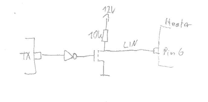

Re: Webasto HVH50

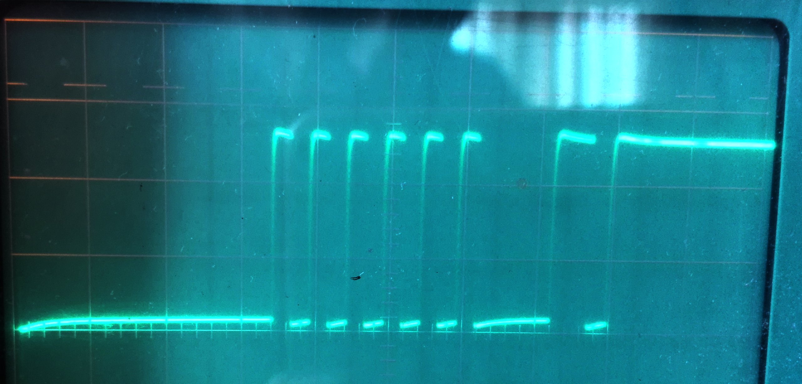

I went through all 256 PIDs (so the invalid ones also) and I never got a reply. Scope is on 2 ms time base so I should see replies up to 20ms later. I must be doing something fundamentally wrong. Does it maybe just reply with HV connected?
Attached is my transmitter circuit.
EDIT: I was expecting 30k from LIN towards 12V (pull-up) but resistance is infinite. LIN pin does rise to 12V when powering up though. Maybe some active pull-up...

i don't know what the webasto unit is doing. With my VW compressor and my VW heater I got an answer without any HV connection. Maybe something is wrong with the timing or the polarity. The master usually has a 1K resistor in series with a diode at 12V and a 1uF capacitor to ground.

Re: Webasto HVH50

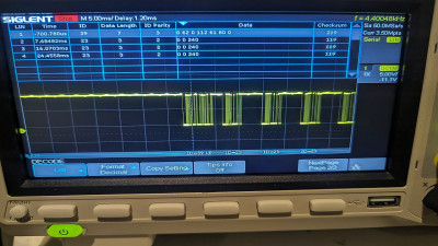

Finally got a reply!
So it seems that units firmware has been altered for the OEM. It runs on 9600 (as opposed to 19200 in the manual) and replies to IDs 22 and 23 (PID 0xD6 and 0x97) as opposed to IDs 24 and 40.
Now remains the question which one is the control ID (35 in the manual) and is the same data format still used.

- Been thanked: 1918 times
Re: Webasto HVH50
Well I am pretty confident in sending and receiving valid frames with the STM32, so don't think a bus analyzer will help right now.
Today I'm actually circulating water and connected 290V. Then I sent the frame as specified in the manual:
0x1 (turn on), 0x64 (heat up to 60°C=100-40), 0xa (power limit to 400W)
I sent this on all valid and invalid IDs. Also added an extra 0 byte or an upcounter in the 4th byte. No change, never drawing power. Then I got desperate and brute forced all values from 0-0xFF with incrementing PID and frame length. As soon as the heater reports a status != 0 I stop. When I hit ID22 it stopped with a "Temporary lock" probably because of collision as 22 is a read command.
I checked the parity calculation of the PID and the checksum calculation against muehlpowers manual and all is fine. I guess I will brute force more and exclude IDs 22 and 23.
The bus voltage and temperature readings are all perfectly valid, so no fundamental communication issue anymore.
Any ideas?
Any ideas?

I don't know exactly how you work about it. A status byte was recognizable on my devices because it did not move slightly like measured values but made jumps when something changed. There was always a difference between pure reading (only sending the feedback ID) and also sending all IDs. After that I sent fewer and fewer IDs until I noticed it in the status byte again. That was the right ID to control. After that I only sent this ID, but with different lengths. One length then had a different status byte than the others. That was the right length!

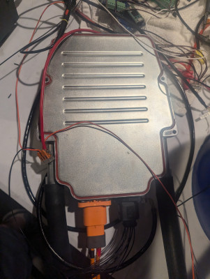

Re: Webasto HVH50
I have some trouble setting up the LIN communication software and hardware.

I have a HVH_50, already fitted, connected and filled. Only thing missing is the LIN bus input
I am working on a small controller to manipulate the dashboard gauges on my Saab 93, for this I use CircuitPython. I like to add the LIN bus with a MCP2021 but I have no idea to setup/build the correct LIn message string that goes to the transceiver. I see above all kinds of snippets but I only know half what it does.
So, if anyone could please help me out or point me in the right direction I would be very grateful.

Look here: https://github.com/jsphuebner/stm32-car ... ar.cpp#L95
It uses the LinBus class from libopeninv https://github.com/jsphuebner/libopenin ... linbus.cpp

hi, I have no clue. Nothing comes out and nothing what I sent in works.
I guess I bin the heater and find something else.
