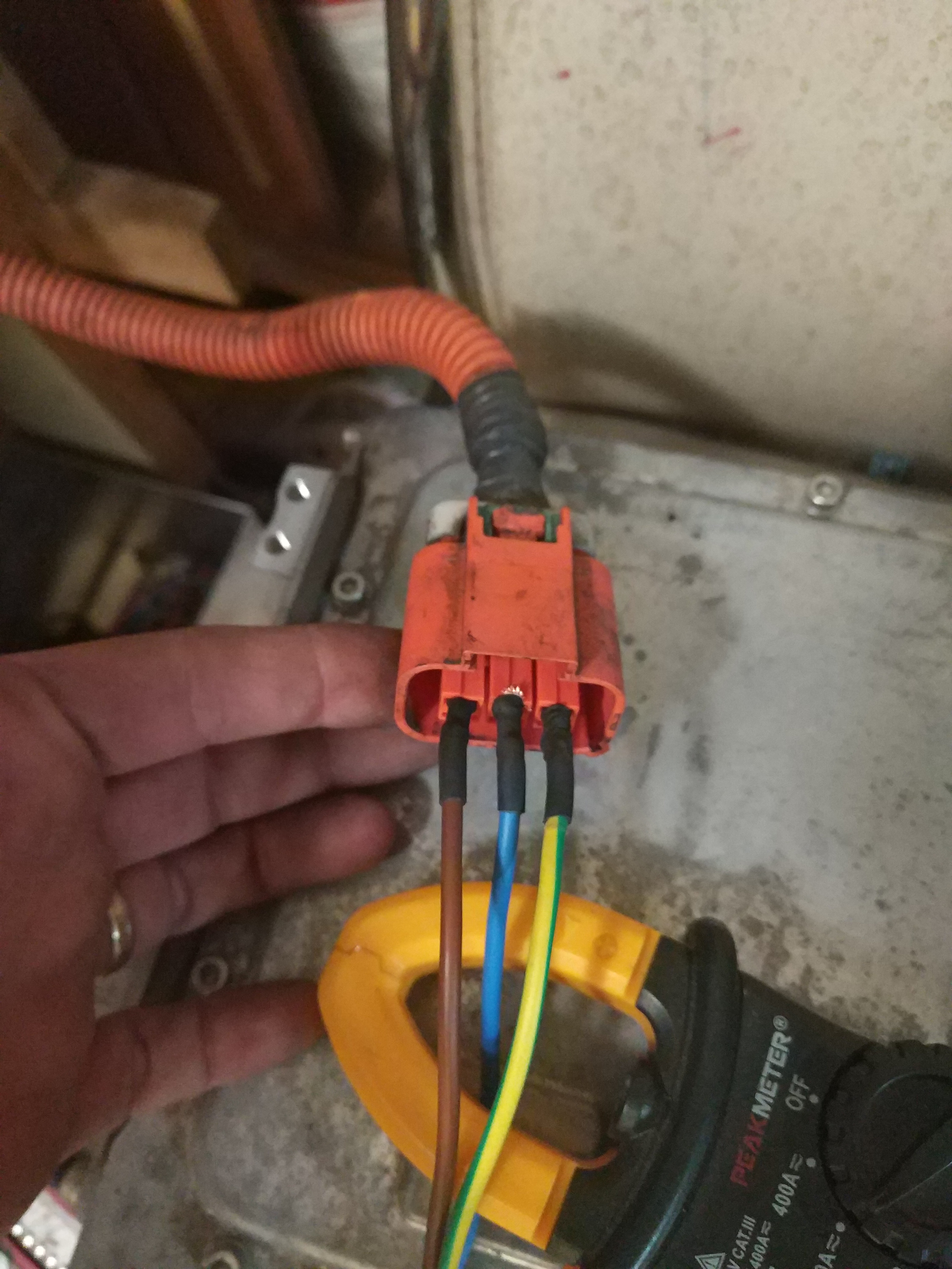

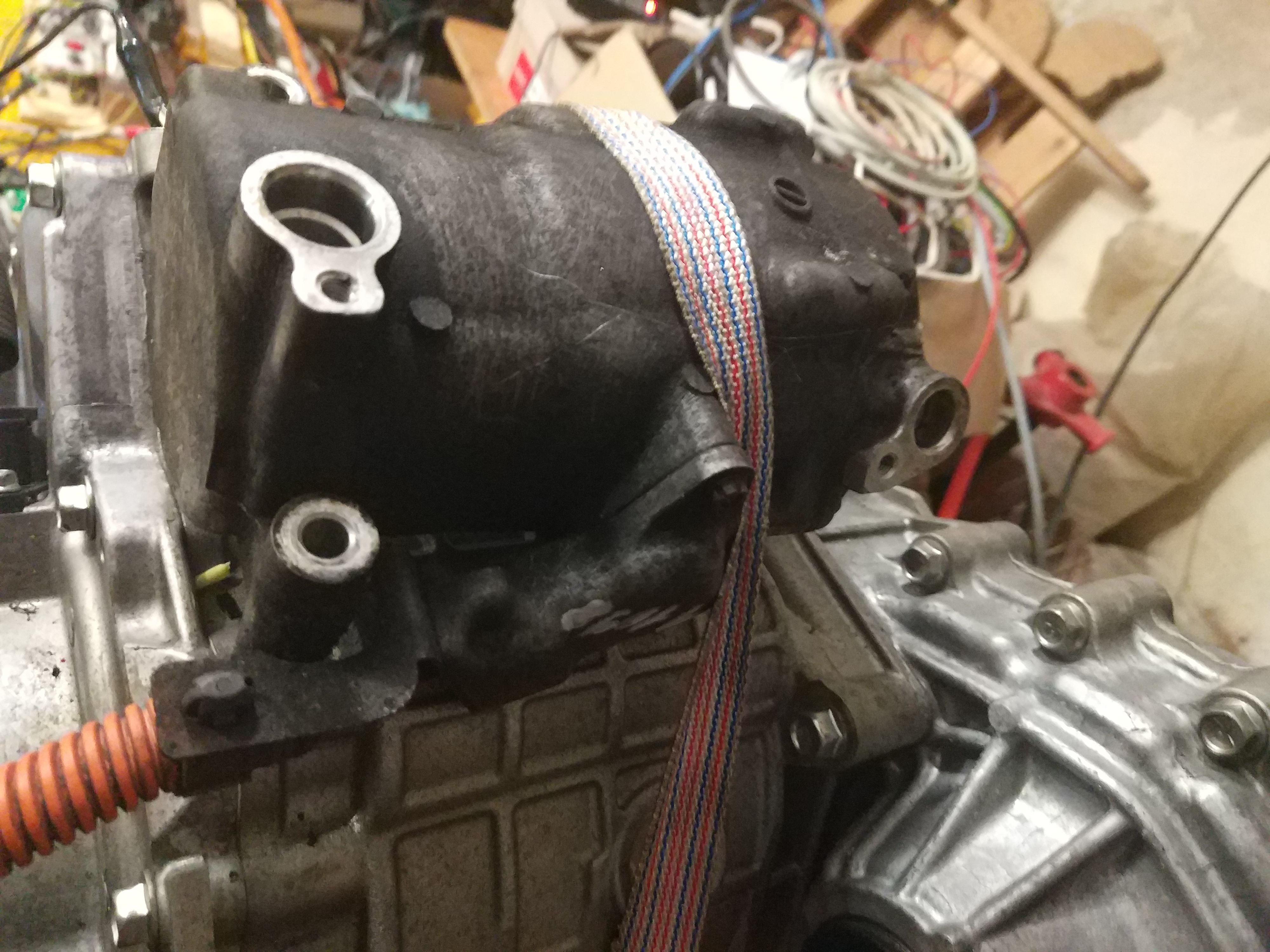

I am waiting for gen2 Prius compressor and then i will try to get it to run. I will recount how it goes here..

Re: Prius gen2 hardware worth grabbing?
Well i just confirm you definitely must grab gen2 AC compressor since it doesnt have internal inverter. One can use virtually any other inverter to drive it...
