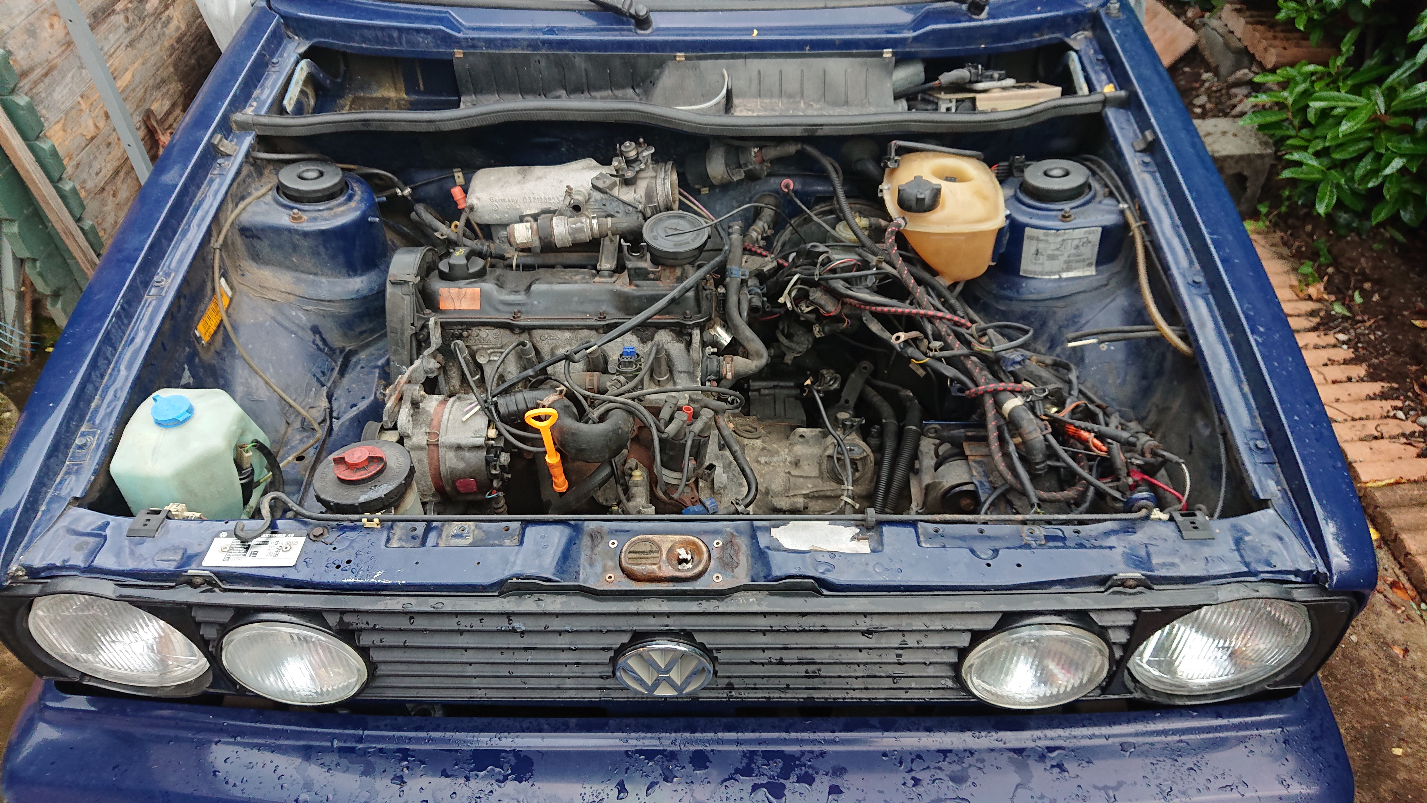

Today was prepare for engine and gearbox removal - Fun in the rain

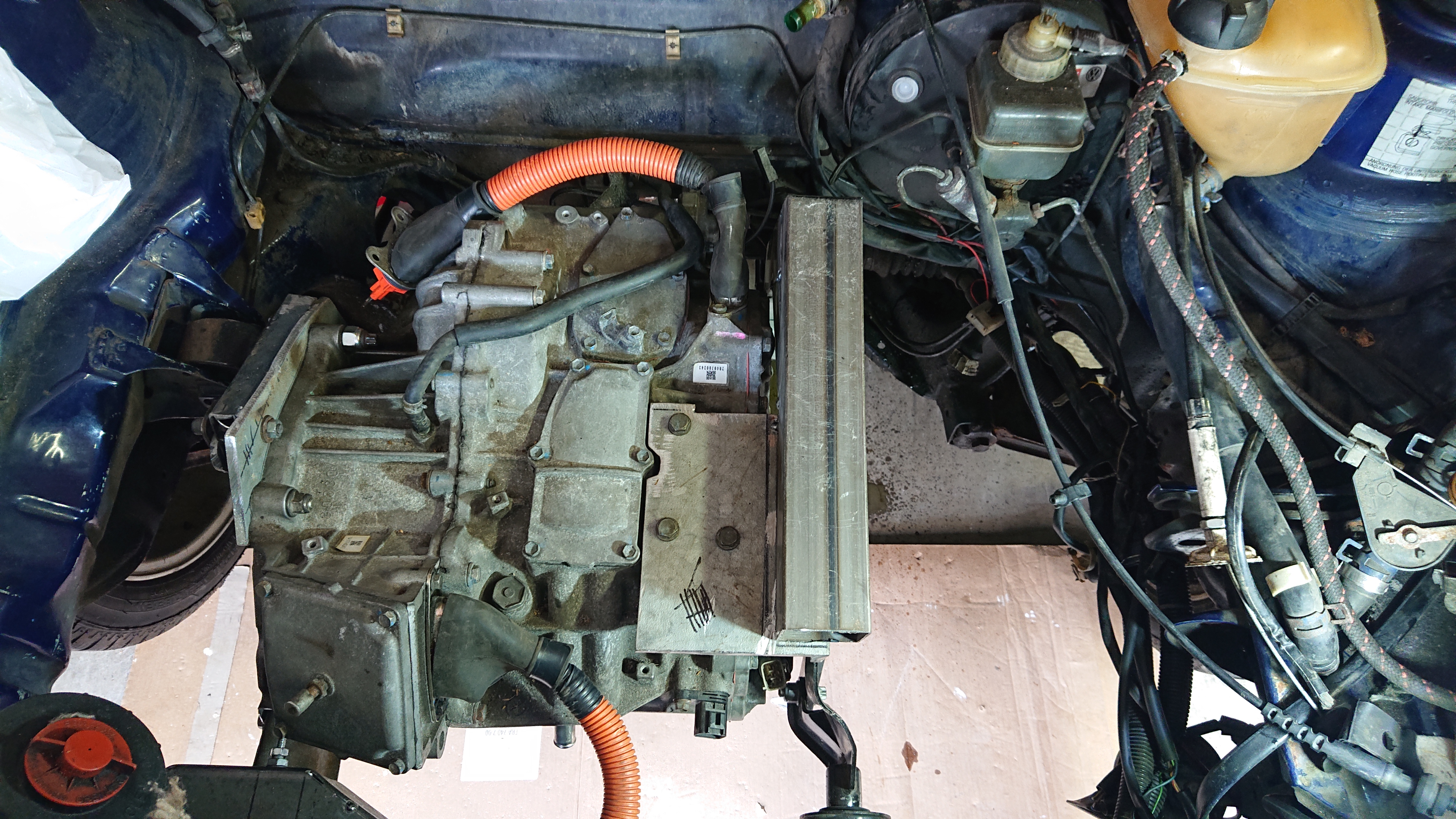

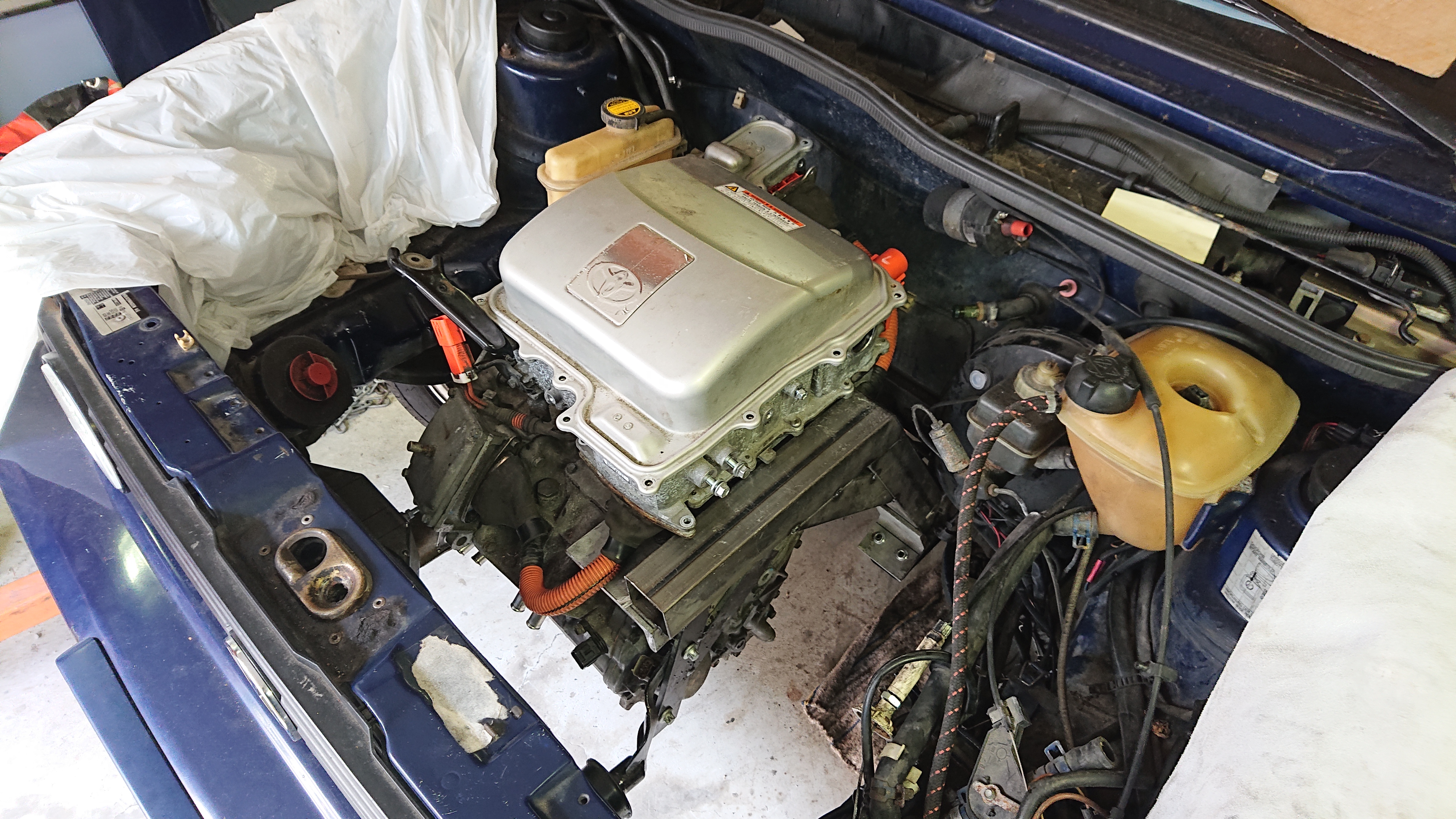

At the moment I am looking at the different placings. Not so easy to decide when Brake booster and original mountings are to take into account. Then there is the height, don't want to have to cut a hole in the bonnet. The driveshafts will come later. Putting the motor and inverter to one side gives me place for some battery modules up front.....well that's the idea.

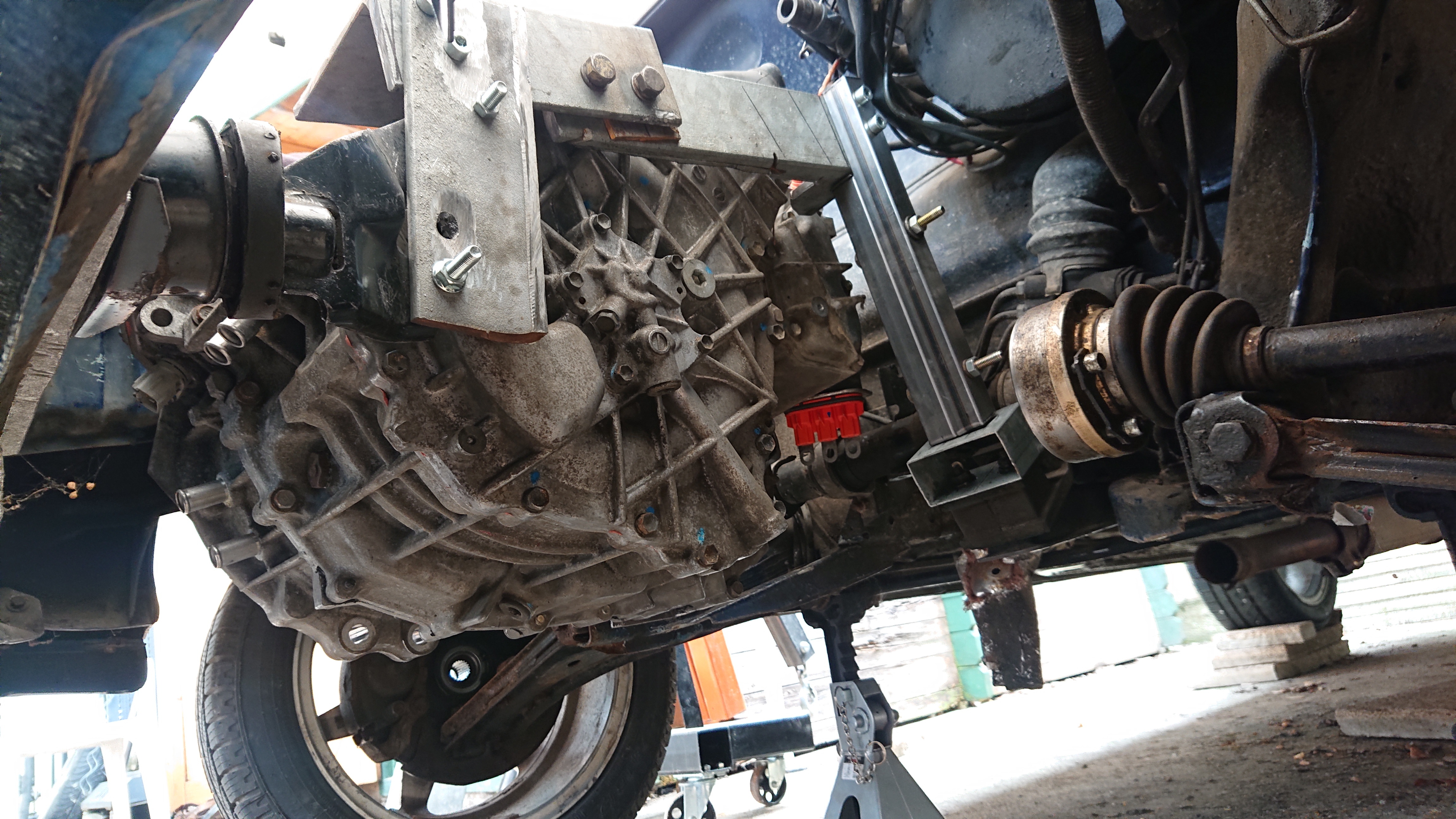

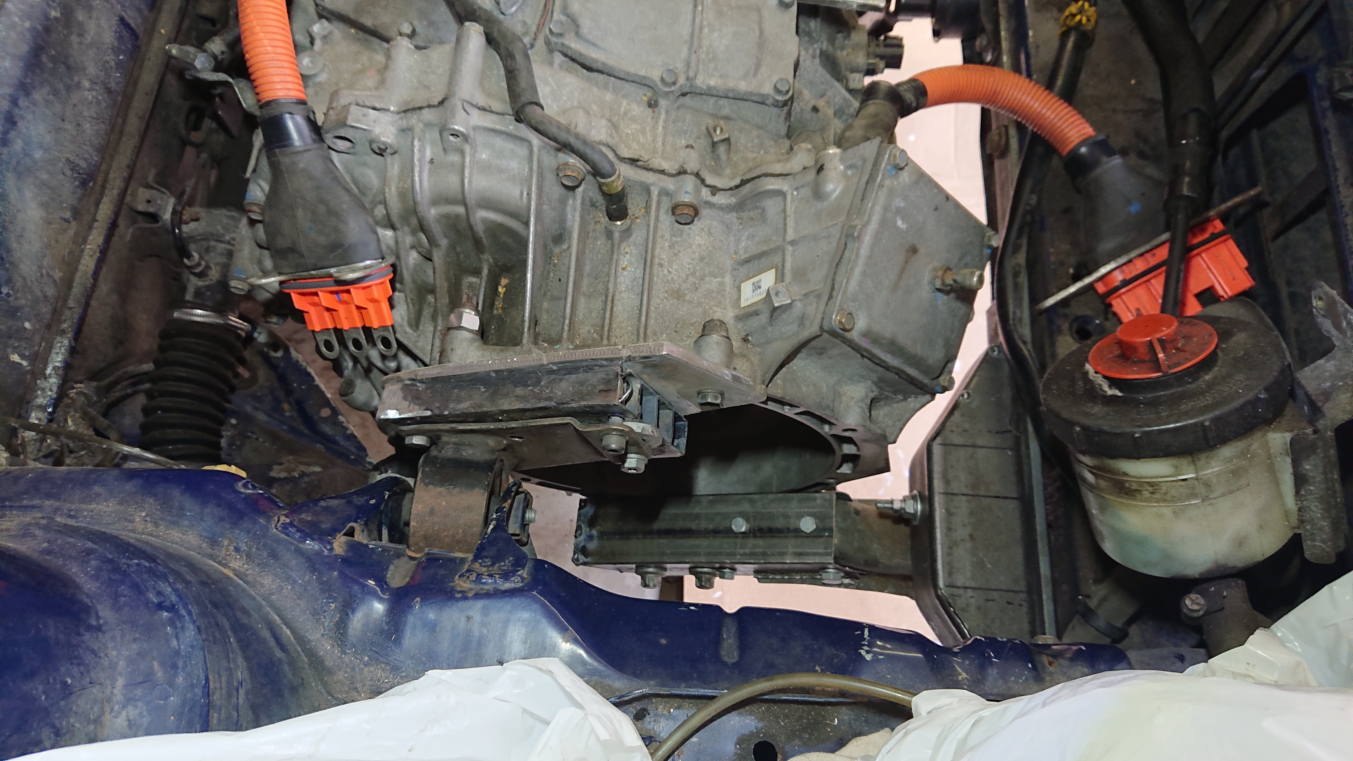

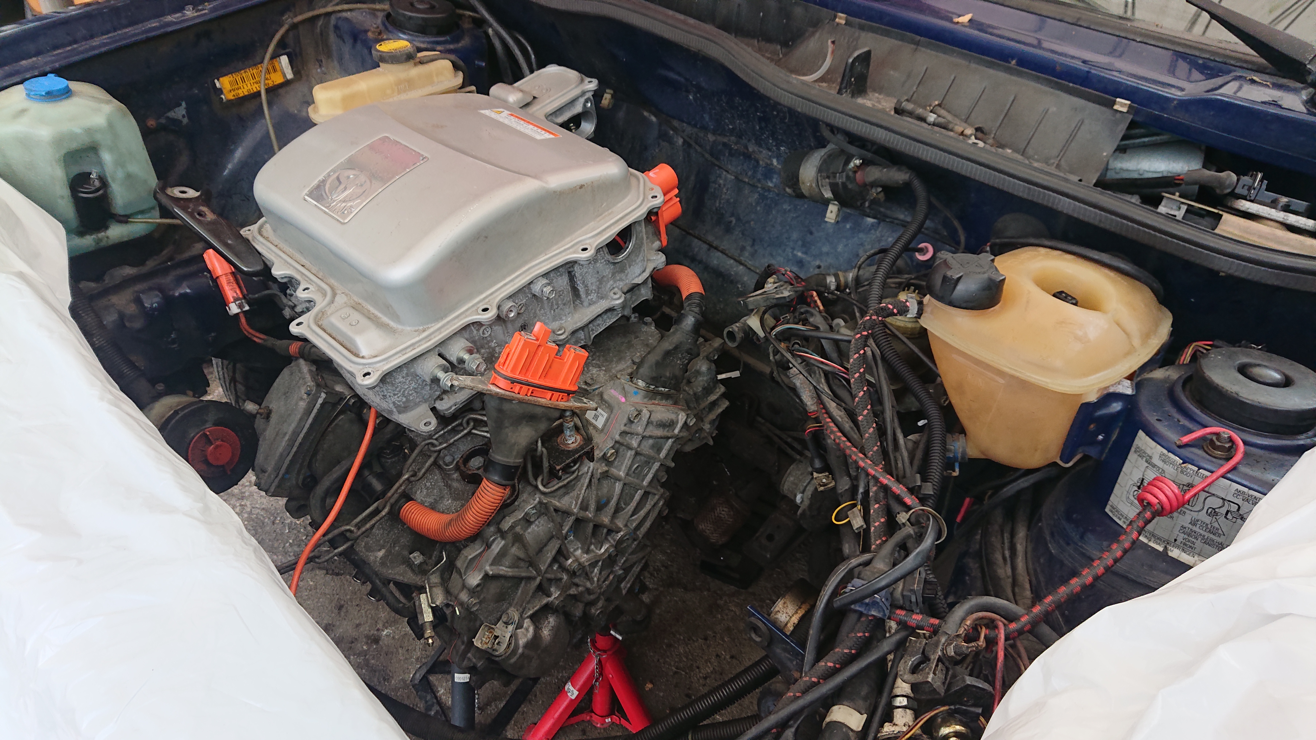

"Jenny" is now hanging by various brackets to measure up driveshafts and start propper mounting builds.

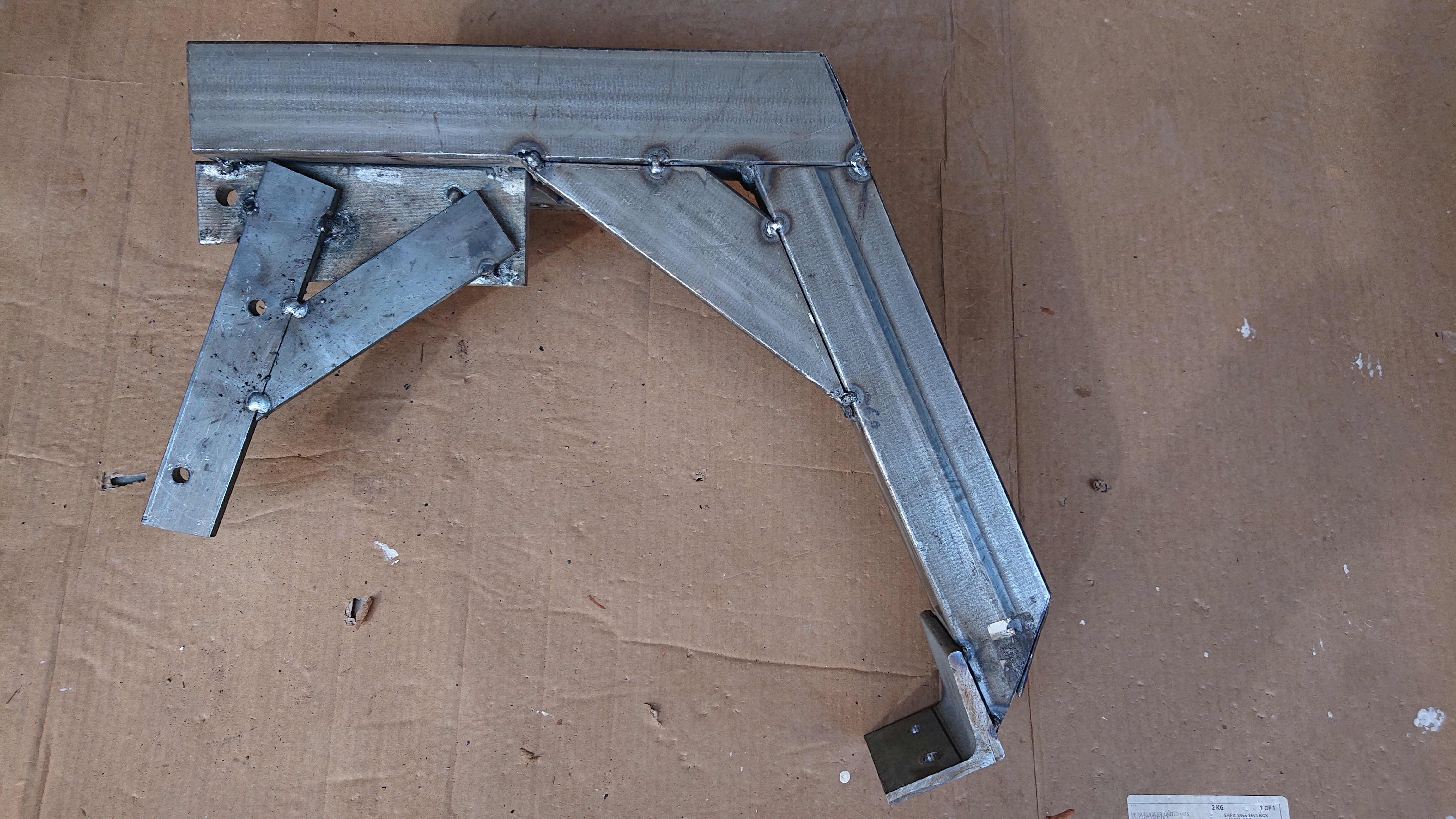

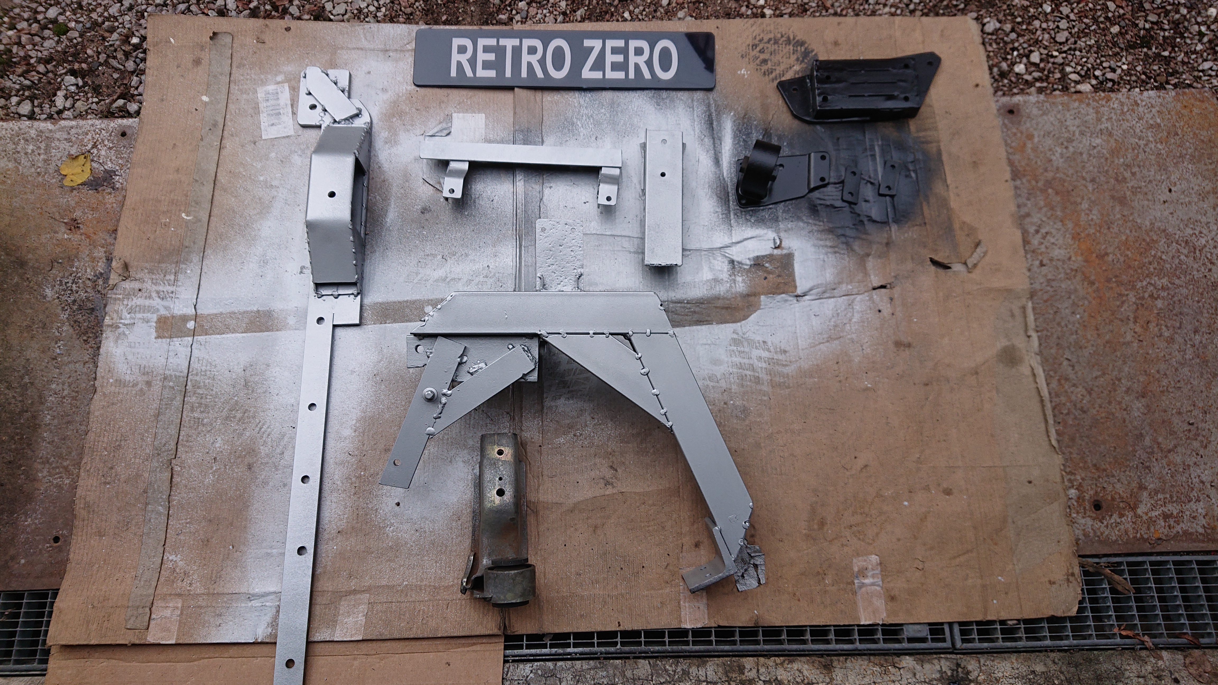

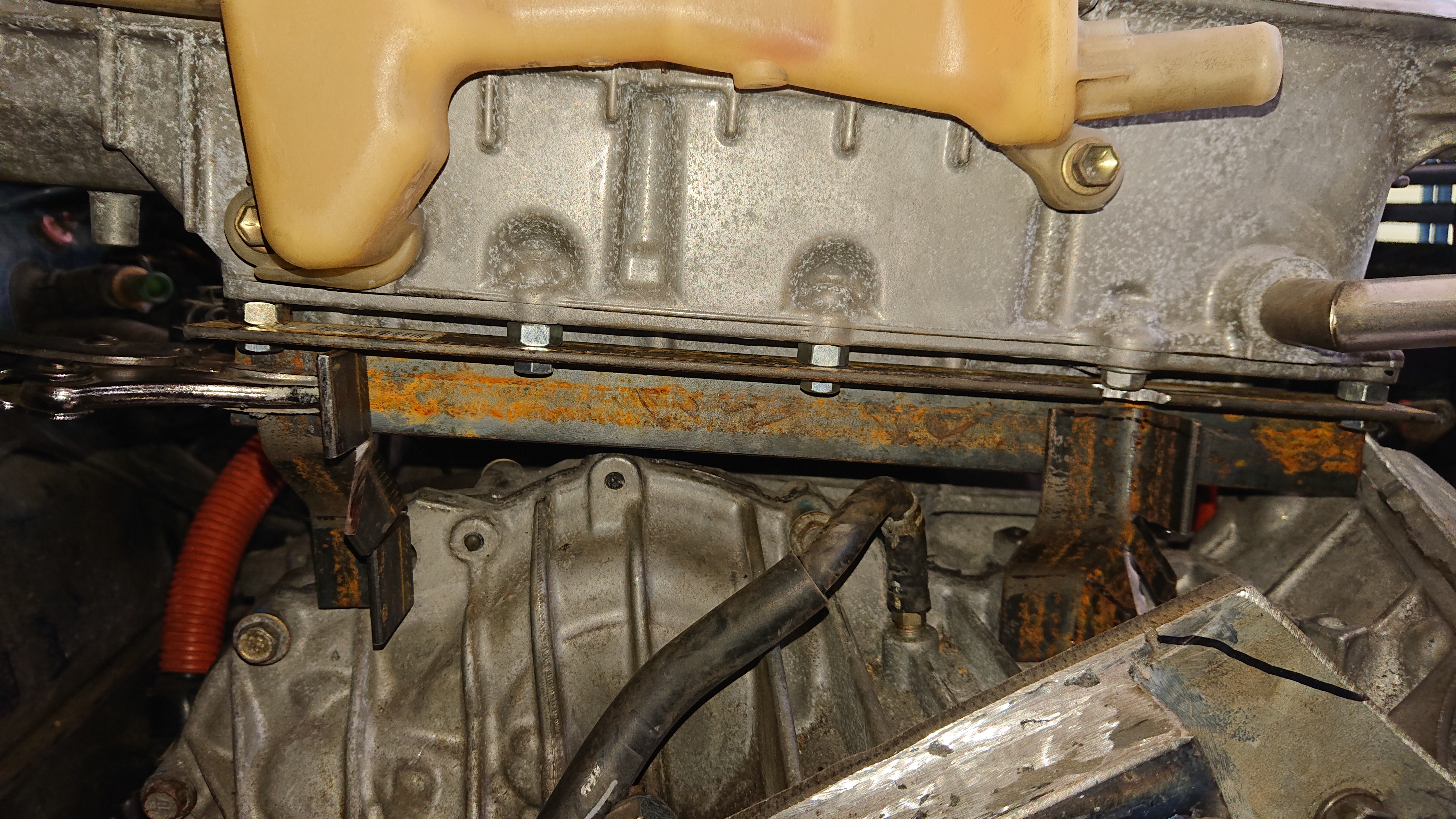

Thanks to the various projects surrounding prius and vw 'marriages' I think I got the transaxle supports sorted. Unlike 'Maker of Things', à lot of pigeon poo welding later, I got the various supports tack welded. Driveshafts next up

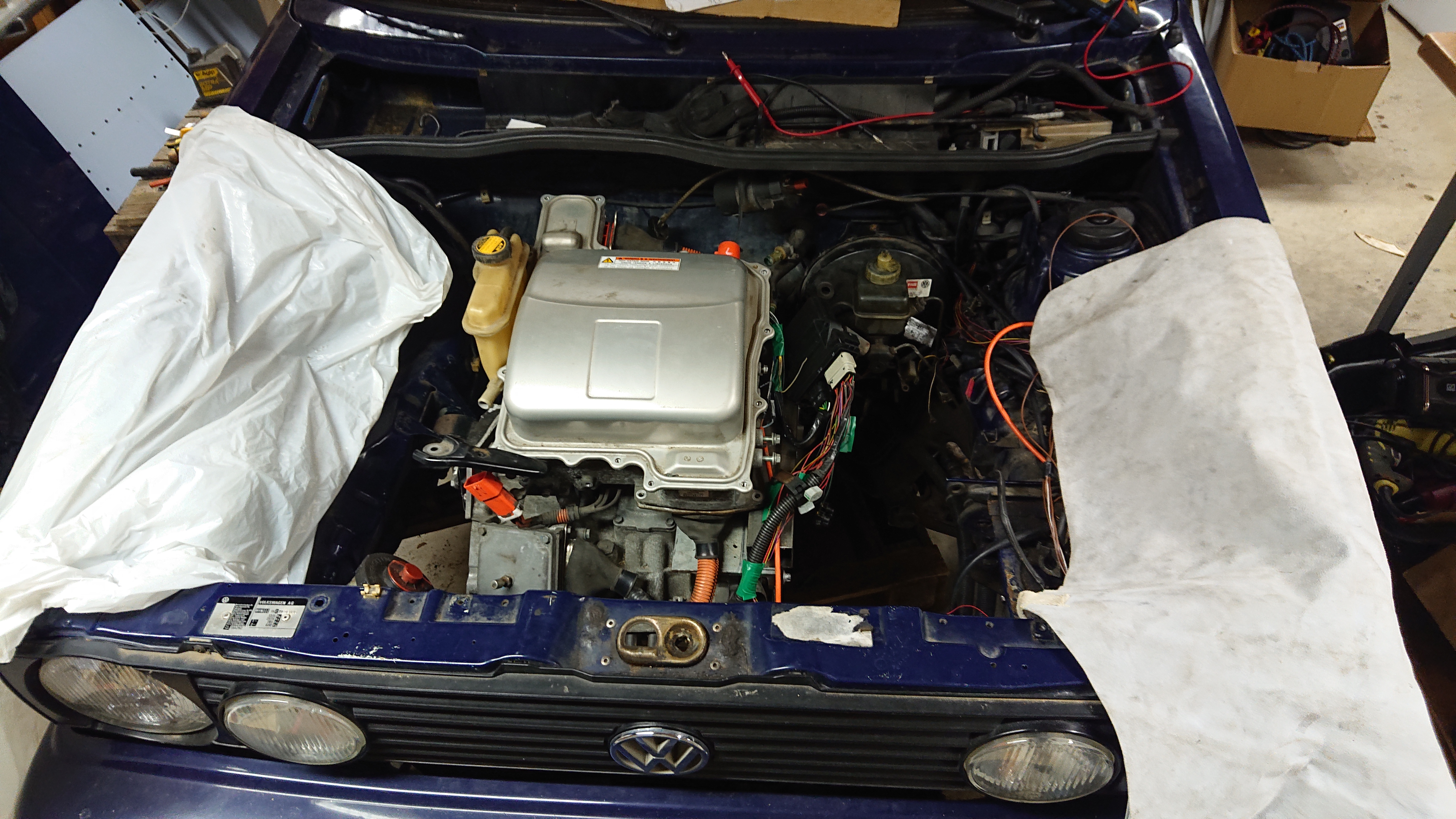

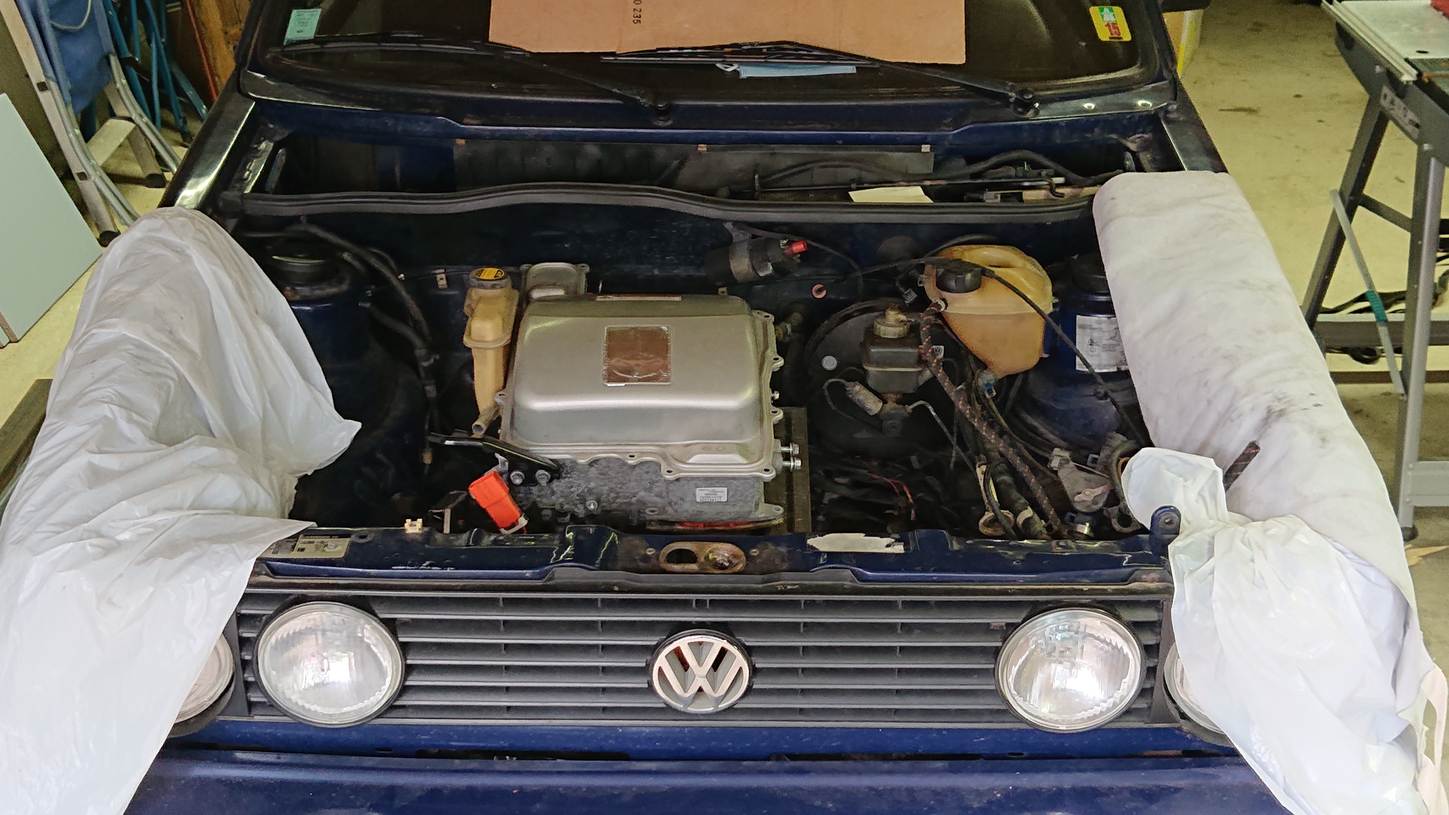

Inverter will just fit under the hood.

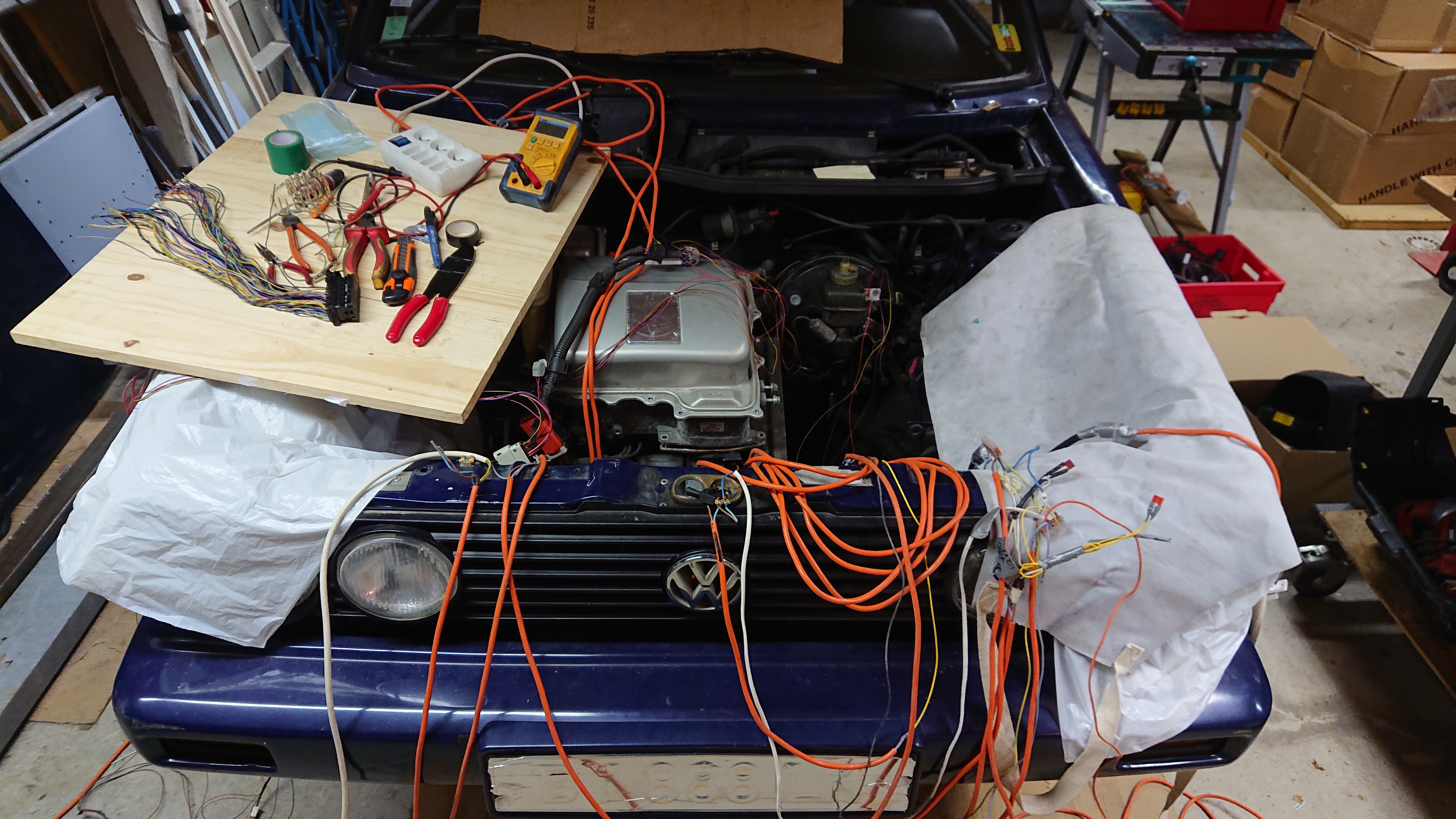

Started to rewire the inverter and transaxle this week end. Hope to have it looking presentable for a local 'recycling forum' in a few weeks.

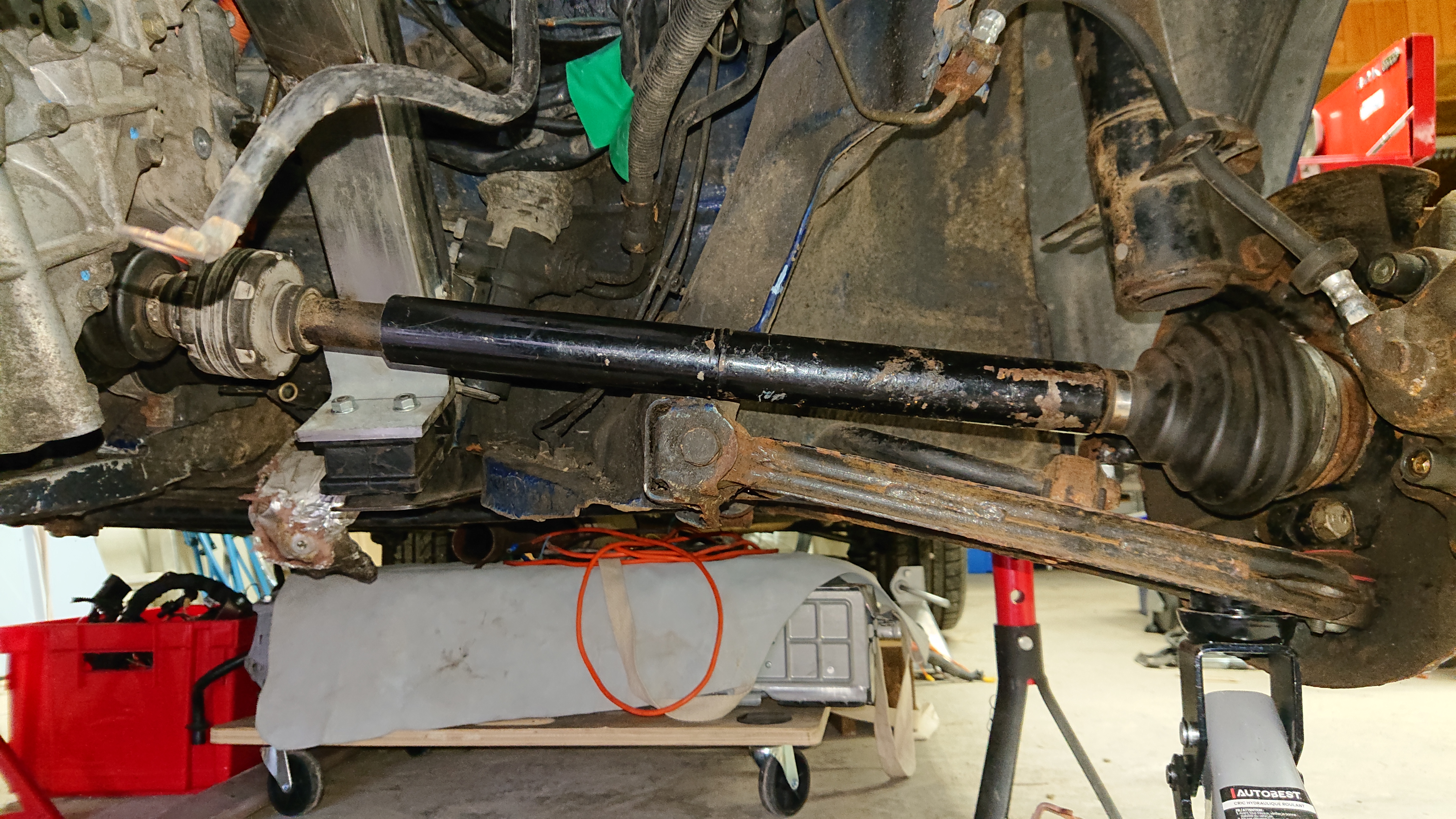

Post by RetroZero »

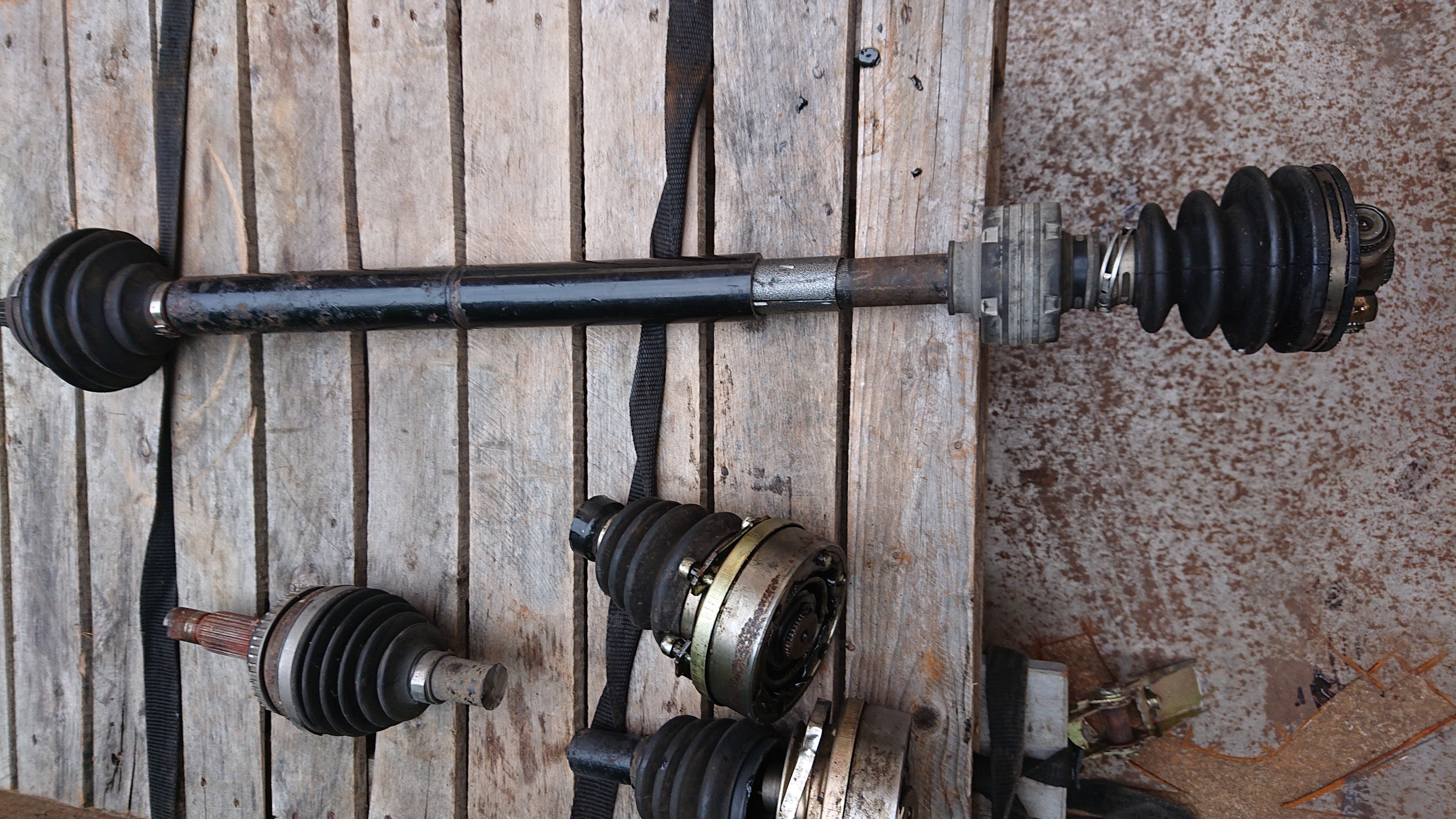

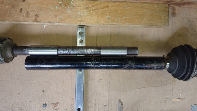

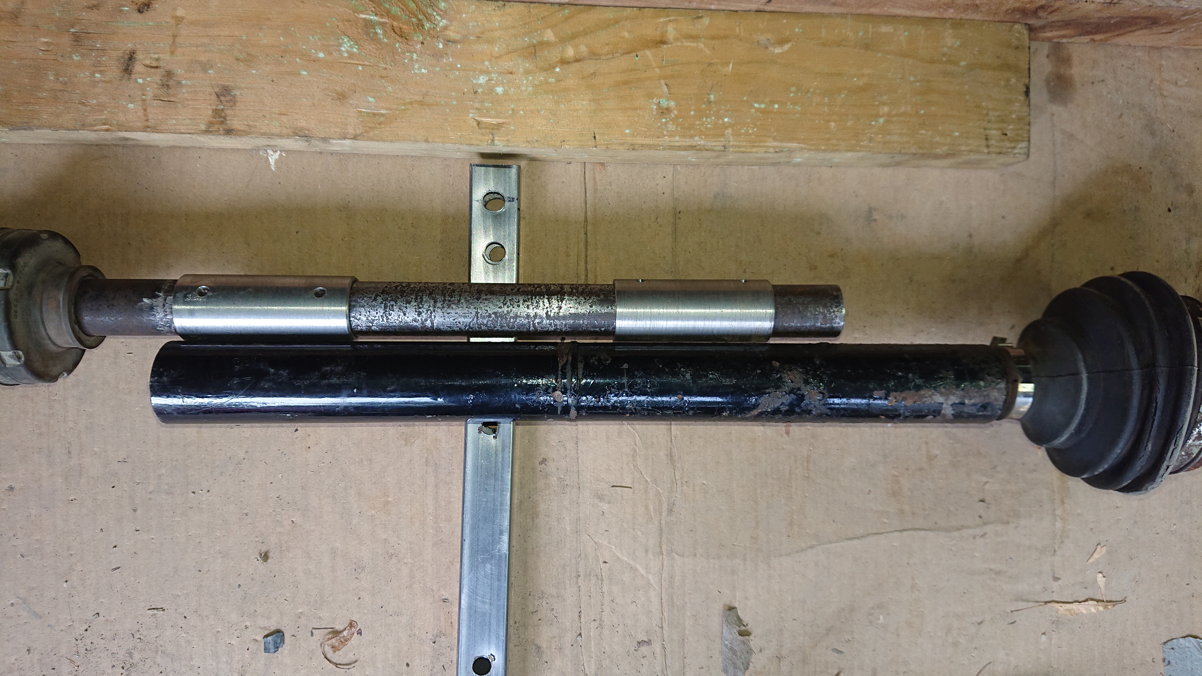

Another quick update - got shims made up and will get the lengths of the driveshafts calculated next. Then off to get them MIG/TIG welded.

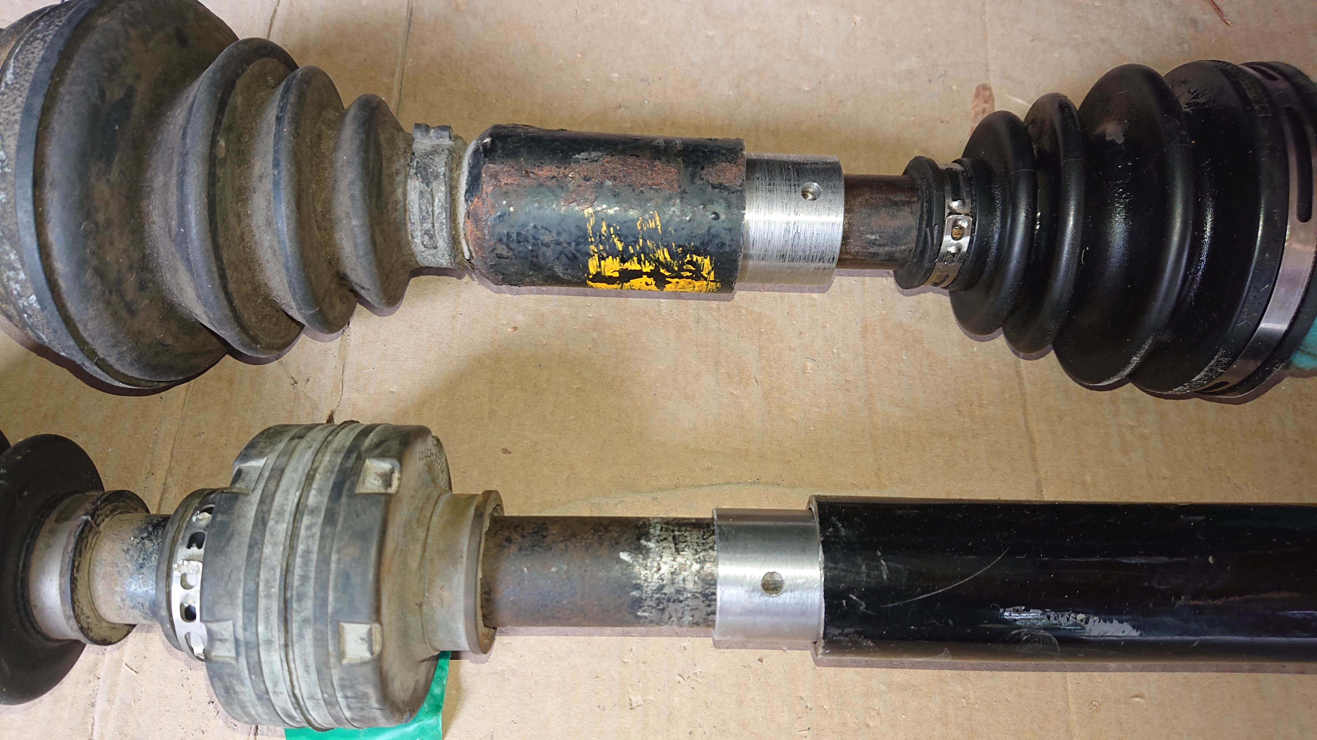

RetroZero wrote: Sat Sep 18, 2021 4:34 pm Another quick update - got shims made up and will get the lengths of the driveshafts calculated next. Then off to get them MIG/TIG welded.
Curious, what made you decide to splice the axle shafts instead of milling/welding a type 2 flange with the Prius inner cv doj?
RetroZero
Posts: 893
Location: France
Has thanked: 566 times
Been thanked: 54 times
Re: Golf 1 / Prius Gen 2
Post by RetroZero »
Not having a lathe or precise welding capabilities, I think this was the simpler way forward. The longer the shafts and shim in between, the less run-out is likely when everything is welded up. It Also allowed me to calculate the min and max lengths of the shafts when mounted on the Vehicule. I can slide them in and out of each other and then find the mid point for joining. Oh, and because one shaft is hollow, and the other solid. 😉

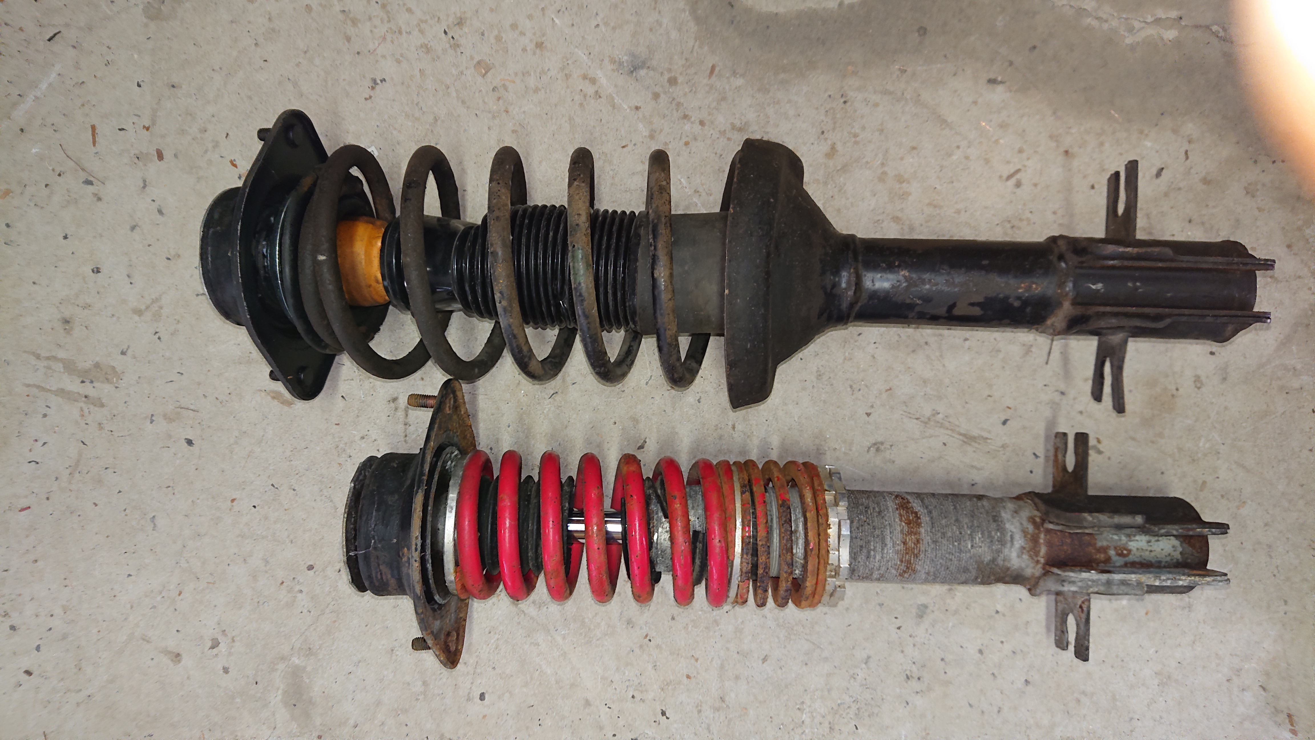

Ligned up driveshafts today, along with making brackets to secure the Inverter.
So lesson learned - due to height limit between Gen2 Transaxle, Inverter and the bonnet, the driveshaft outputs are sitting too low and causes the left side to touch the sub frame. :x Shorter springs will have to be the solution...How low can we go? Will find out soon.

Will need a good clean up, but shorter springs fix the problem. Will see once it's on the ground in terms of clearance. Trying to get it as close to original ride height as possible.

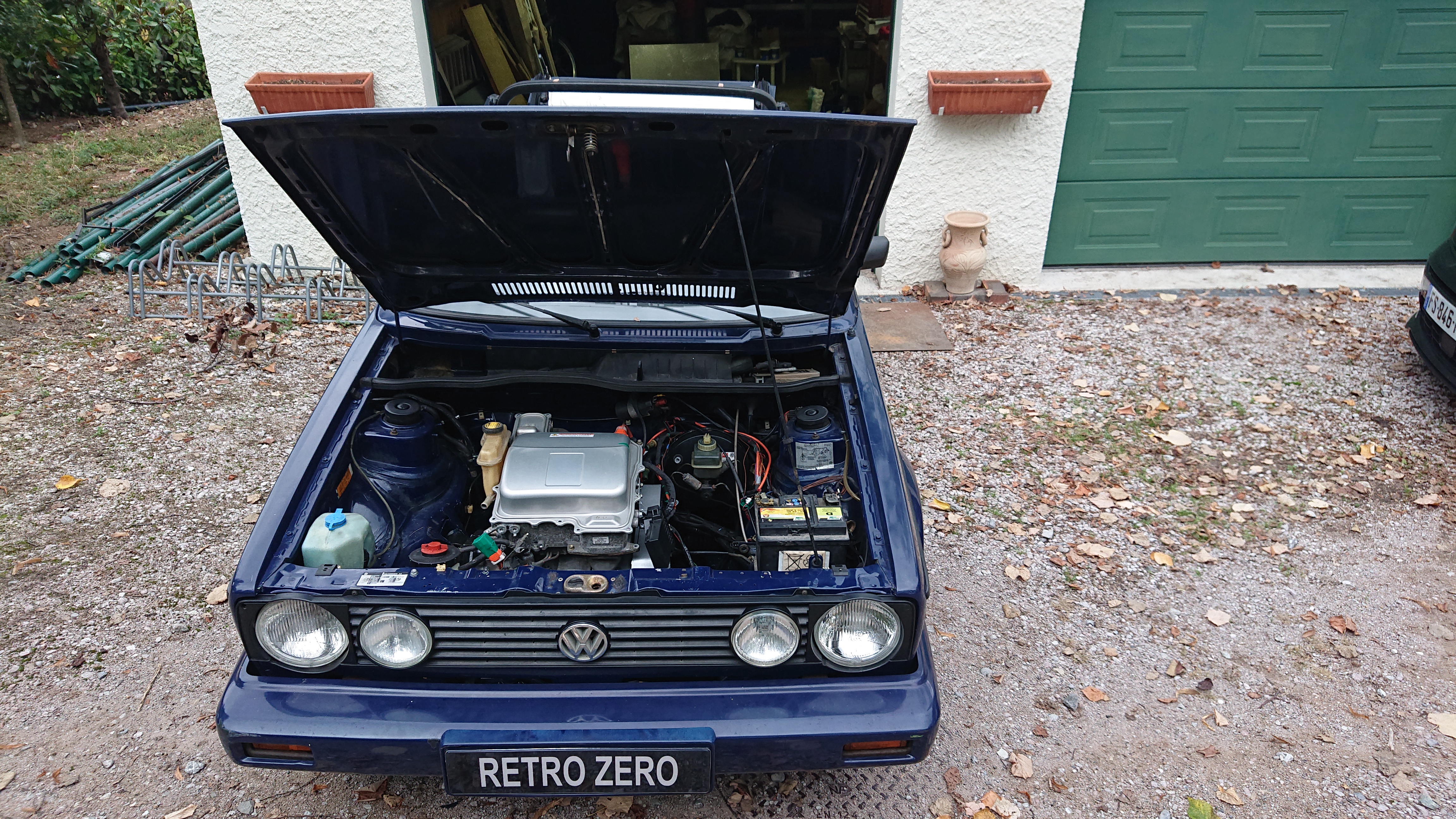

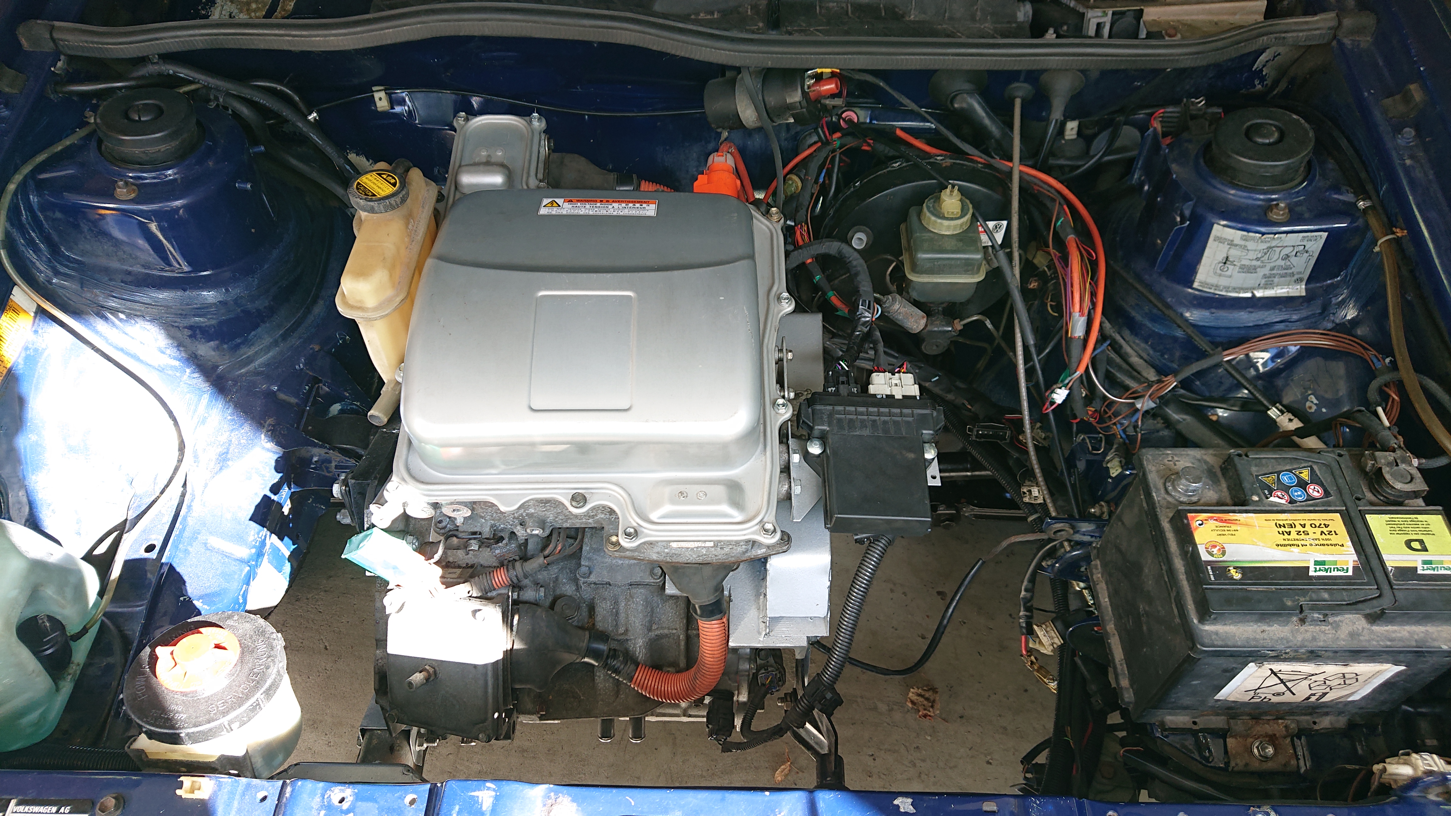

Just wanted to say a huge thanks to Damien and Johannes for getting me into this passionate subject. Off to prepare for tomorrow's meeting where 'Ze Golf' will be on expo - IN RUNNING MODE!! 😁 🥂.
Will post afterwards, but some pics for an idea of where I'm at. THANK YOU OPENINVERTER COMMUNITY!
Posts: 6771
Has thanked: 384 times
Been thanked: 1590 times
Well, thank YOU, so good to see this running! Very shiny too :) I assume you're running MG2 only?

Post by RetroZero »
For now it's only MG2 and Inverter. Testing with Prius pack for the moment, and next step is basic charging for it. My dilemma is that I will run MG1 (with a 2nd board) , so inverter cannot be used as charger as well (unless I unbolt everything each time I need to recharge). Will do some research whilst changing powersteering, brake booster pump and cooling system. Just happy it moves.

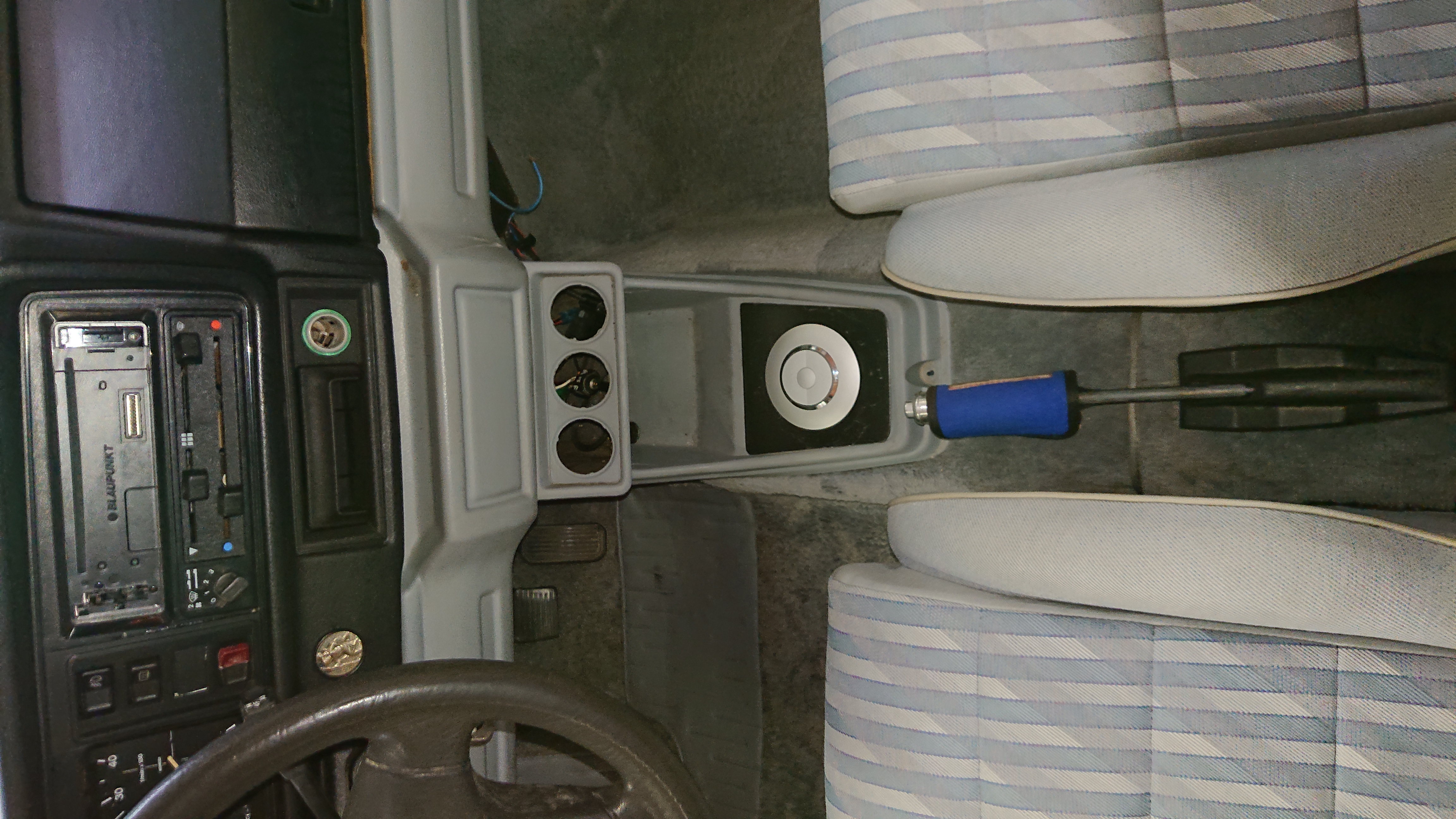

Not much happening whilst doing the workshop.. But put in a new gear lever 😁
Post by RetroZero »
I haven't tried it out 'properly'. No cooling plumbed in and prius battery has low voltage. Lots of torque though and very smooth in forward. I plan on running MG1 as well, so on-board charger to configure with plumbing and brakes next on the list.
