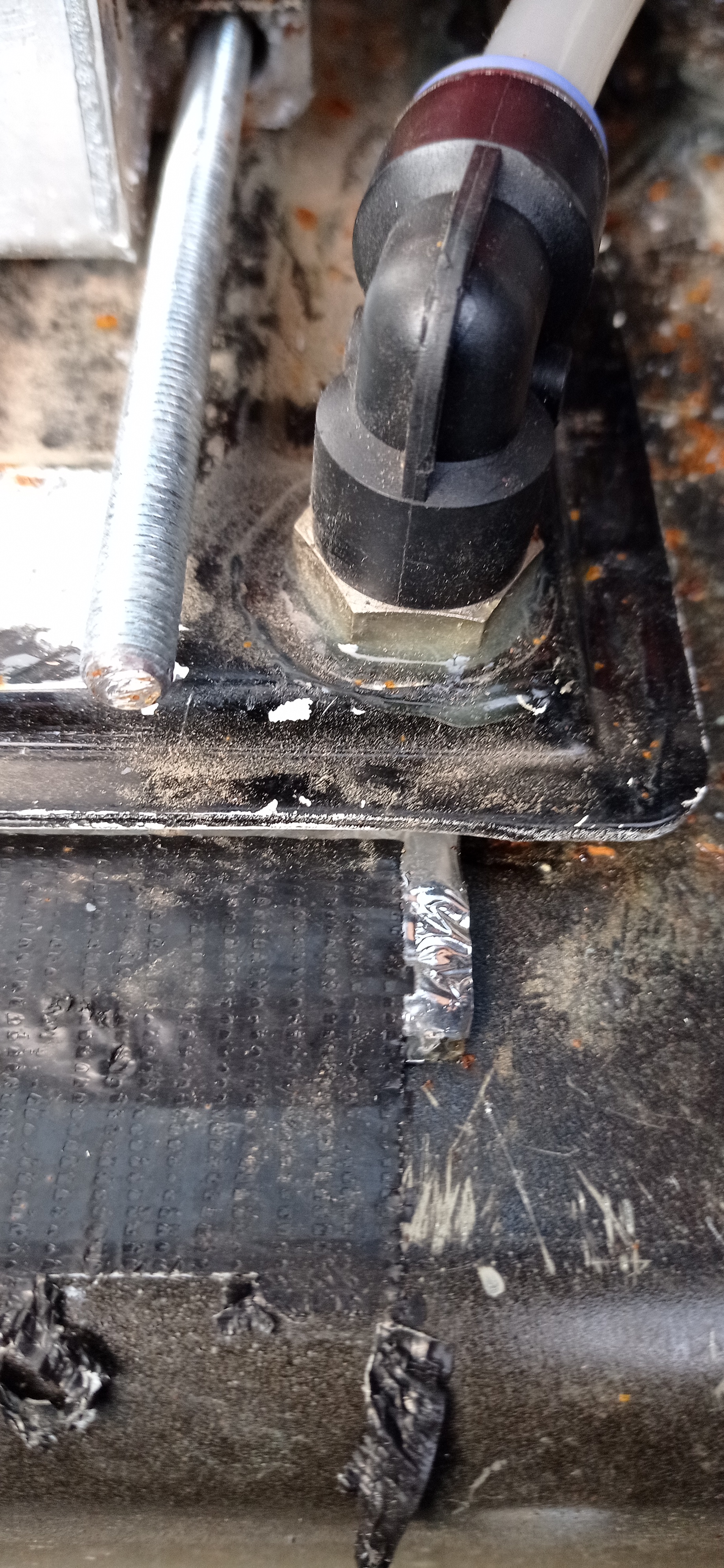

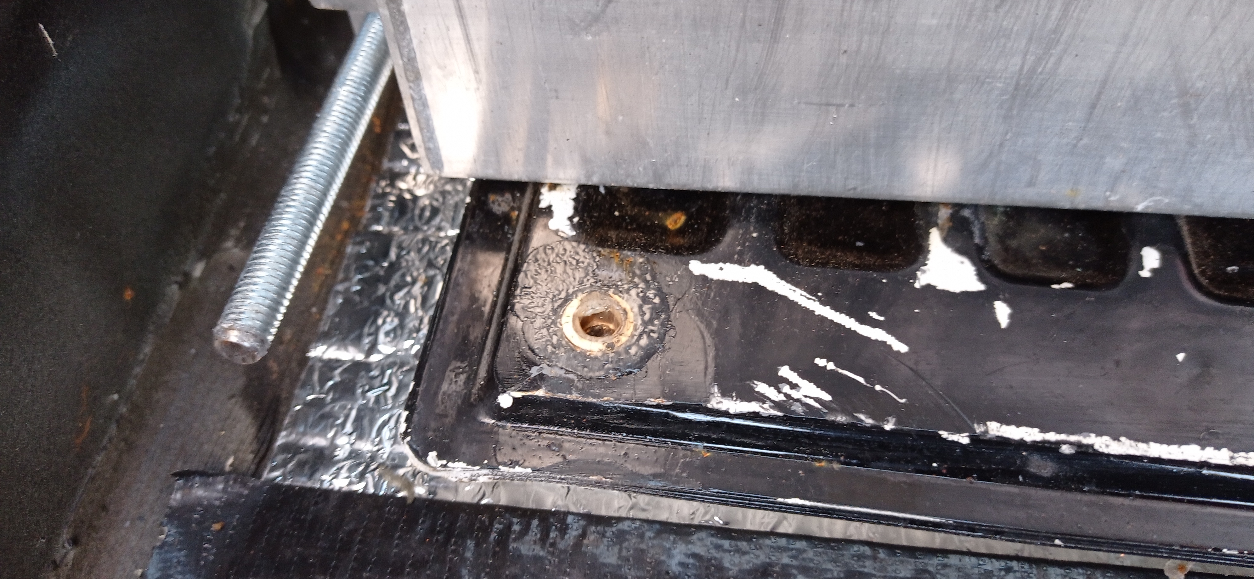

Original Jaguar cooling solution is built into the battery box floor. There are section of pressed tubing across the bottom connected by hoses. Battery modules are connected to this through alu structure underneath. This by itself does not lend itself great reaction time, but it provides quite sizable thermal mass which can sink dT comfortably.
Jag cooling1.jpg (8.52 KiB) Viewed 16149 times

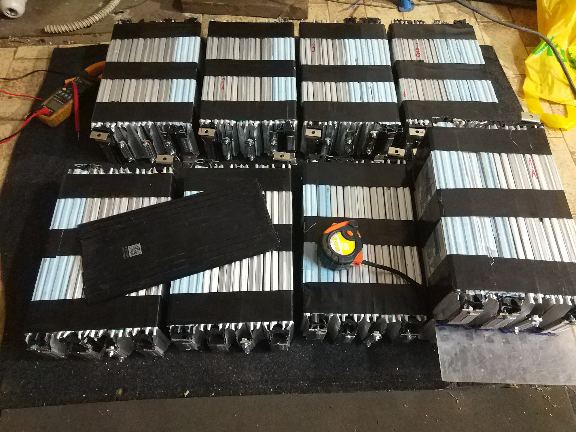

My idea is to take similar design to tiger82 with cooling plate between cells but horizontaly. Without racing application dT should not be too much. And cells would be cooled through top/bottom ends. This is also part of Jaguar cooling design...
My cell module configuration is built in two levels. Bottom module is made of 2P8S and connects to upper module of 2P8S. There are 4 modules in front and 2 modules at the back with possibility for expansion. All chill plates will be connected by silicon hoses to a common manifold which will then connect to common cooling system AFTER inverter and before motor and chargers. This way coolant will reach batteries just after being cooled. I may change this to self sustained system separate from motor-inverter cooling.

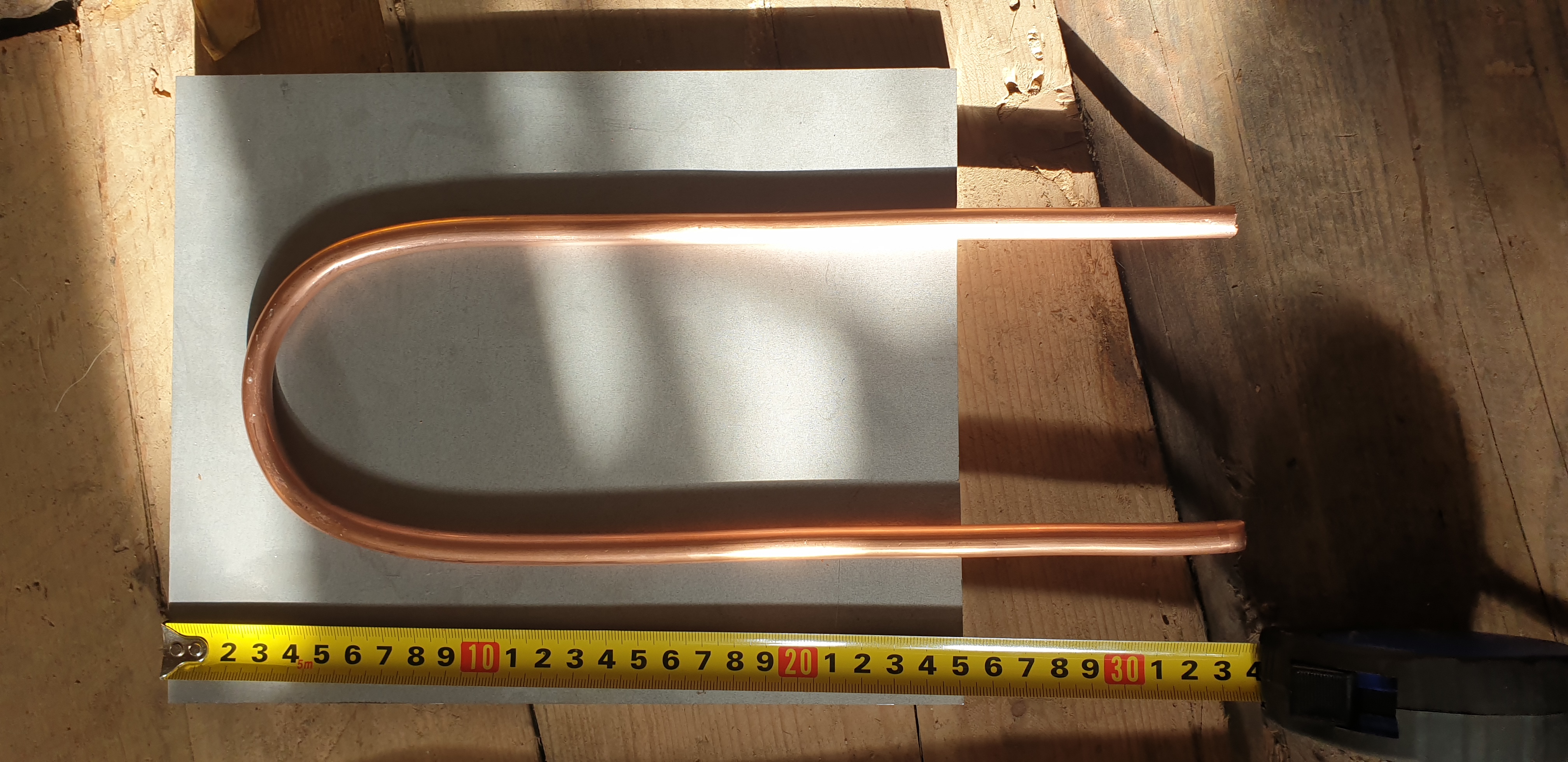

So i will make 2mm Alu plates to be fit between both modules and between them i will sandwich 8mm twisted copper tube which will move water between plates. To make a uniform sandwich i will fit 8mm blocks alongside tube bends and make countersunk threaded holes and torqued small M4 countersunk screws to hold everything together.
Copper tubing is easy to get and i can bend it at home. Alu plate is also easy to machine and i can get 8mm alu strips cut at local metal workshop.
This will raise my setup by 12mm. I am still comfortable with that under the battery box cover.

I may have changed my mind. I think i will try buying one 200mm x 250mm x 12mm alu plate, cross drill it with 8mm bore and plug adjacent holes. Then somehow glue in/out alu tubes as fittings and pressure test the thing with my pump.
Should be easy to make and good test setup. Just need to find someone with a large enough drill post. 😇
