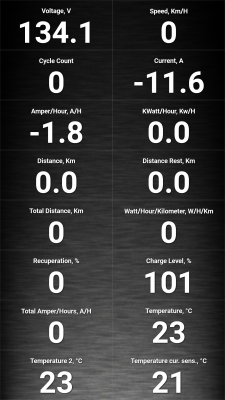

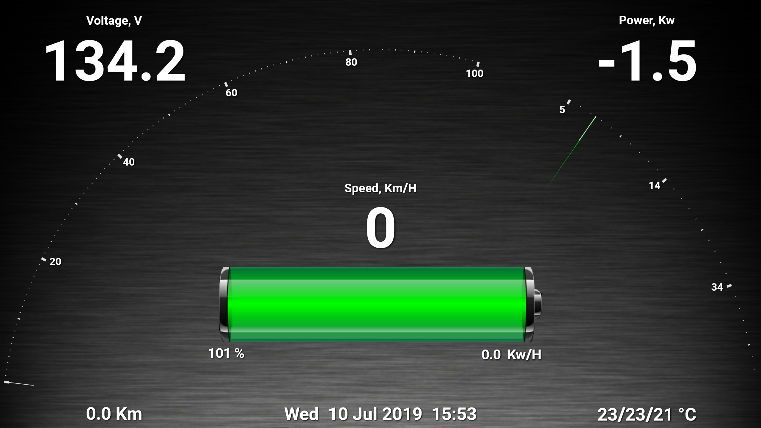

I'm pleased to announce cooperation with Yuriy Logvin, designer of the Powerwatcher Android display system, to integrate functionality for the open source Tesla drive unit and charger logic boards. I get asked a lot about a display for these products so it's finally on the way:)
The Powerwatcher will connect to the drive unit or charger or both over CAN and use any android device via bluetooth to display a vast array of information.
PowerWatcher website : https://powerwatcher.net/
The CAN firmware will be opensource so can be used to integrate other systems such as SimpBMS etc.
Obviously it will also be usable with any board running the openinverter firmware with CAN capability.
Estimated time to release 2-3 months.
Attached a few screenshots of a Powerwatcher running in my E36.

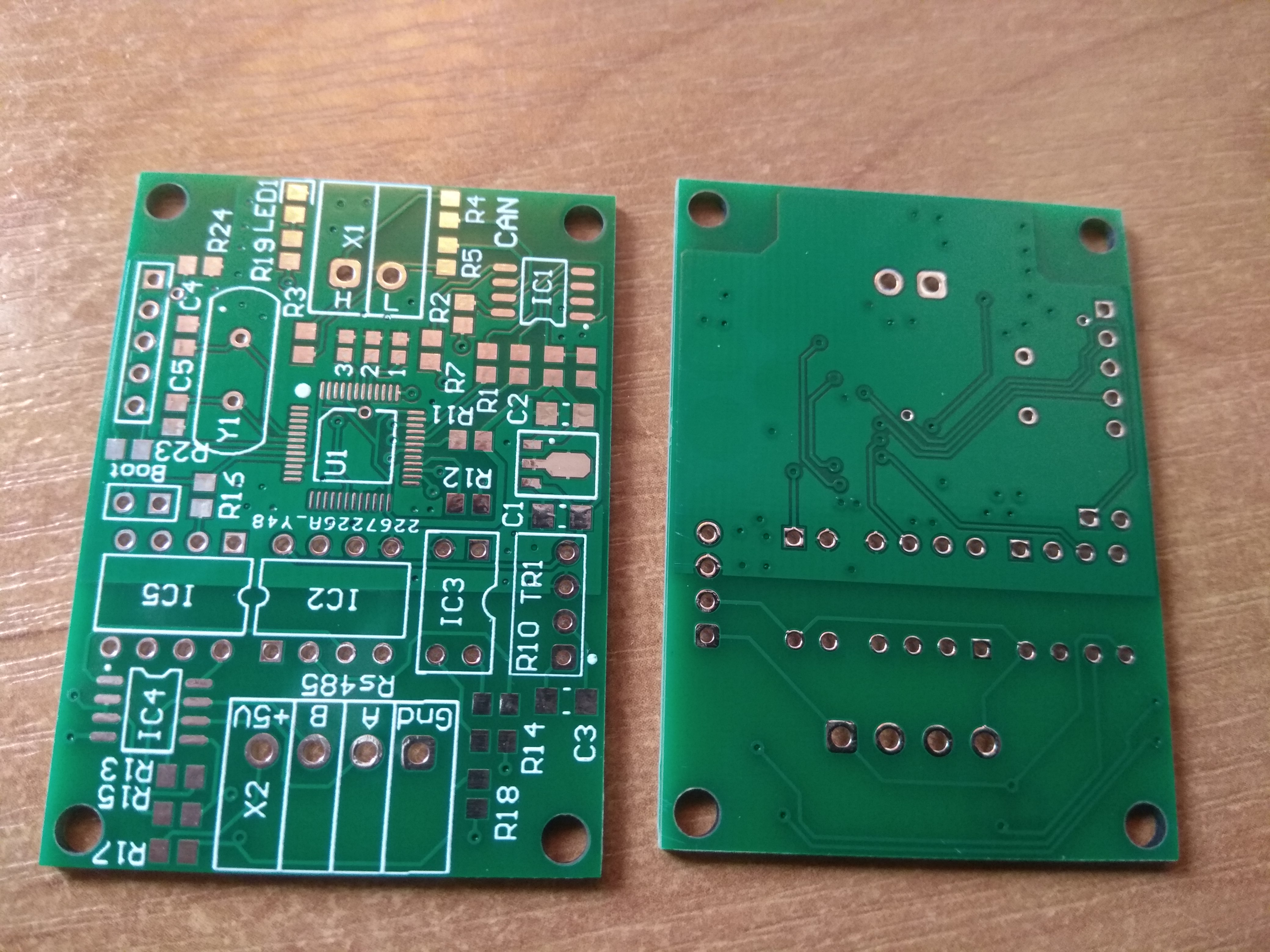

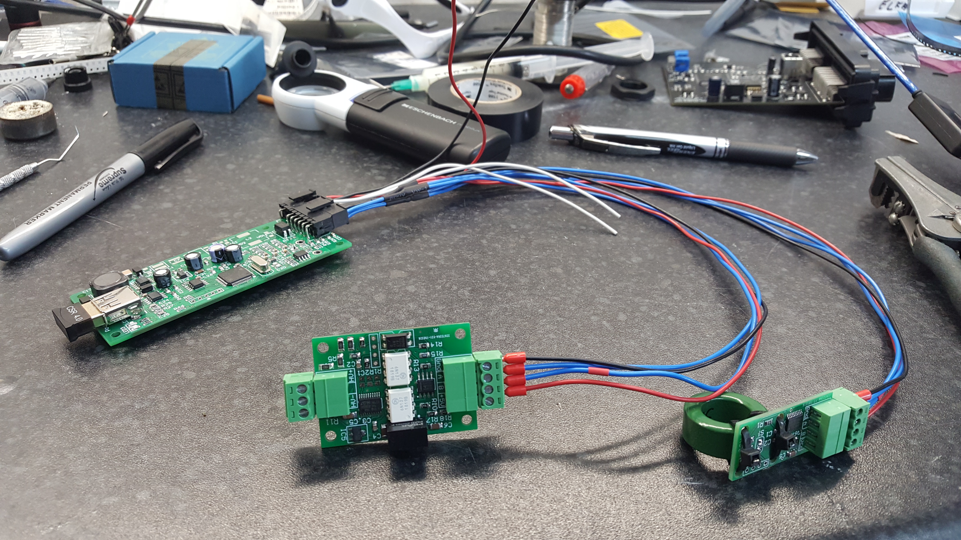

Bare pcbs have arrived with Yuriy for the Powerwatcher V3 CAN interface. The V3 uses RS485 modules for sensing. In the picture you will see one with isolated voltage and current sensors attached.
Would be great if someone could put together a can message list that we can all agree on.

CAN adapter schematic and firmware now on Github :
https://github.com/YuriyLogvin/CAN-RS485-adapter

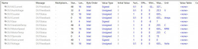

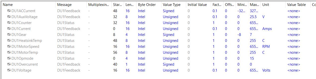

You could always use the Zero EV can messages for the DU as a base.
Currently populated two messages with the following

Ok then here is a stripped down DBC attached, also has the base Can info for SimpBMS and the open source Tesla Charger. I removed some info I received in confidentially.
Cannot upload '.dbc' that is why it is rar'ed
zeroev - Copy.rar
(1.24 KiB) Downloaded 442 times
