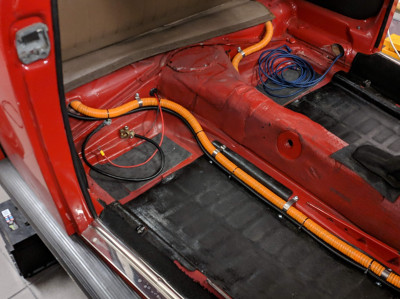

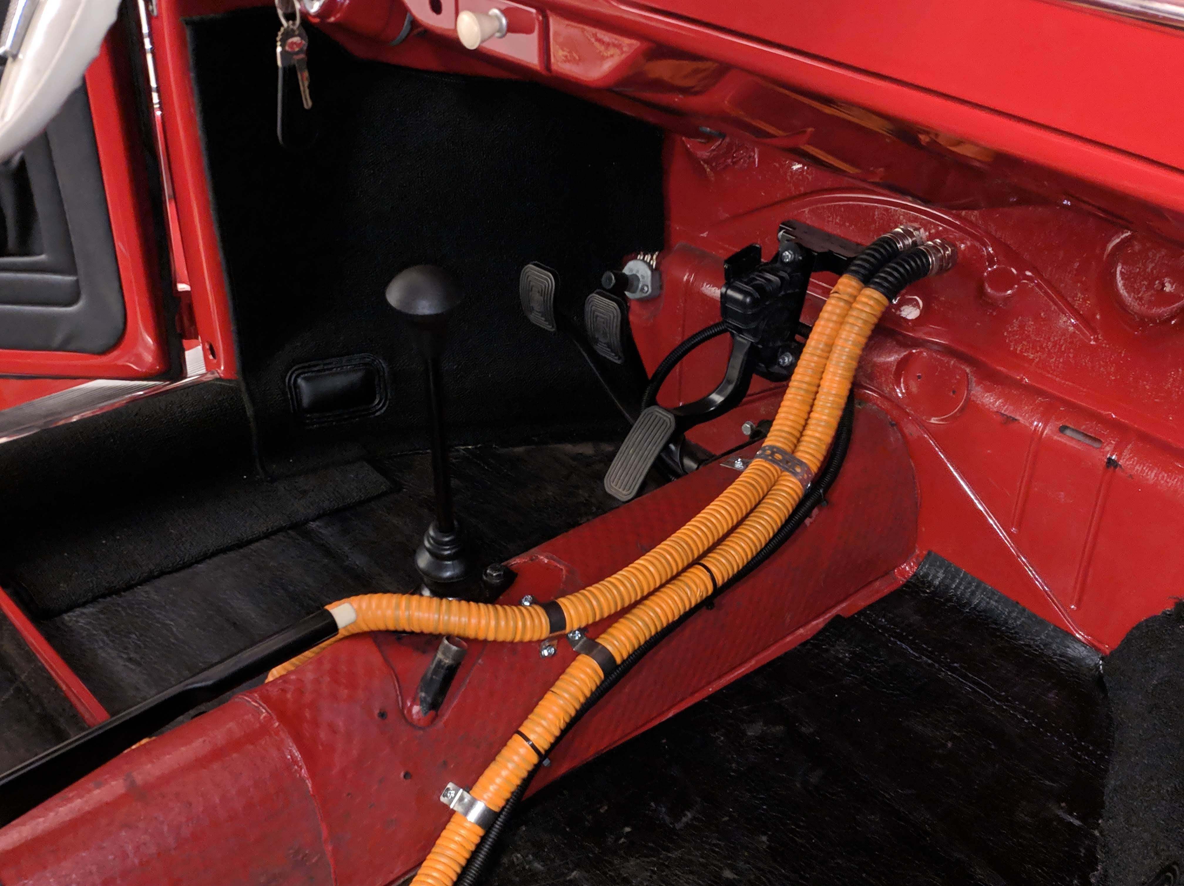

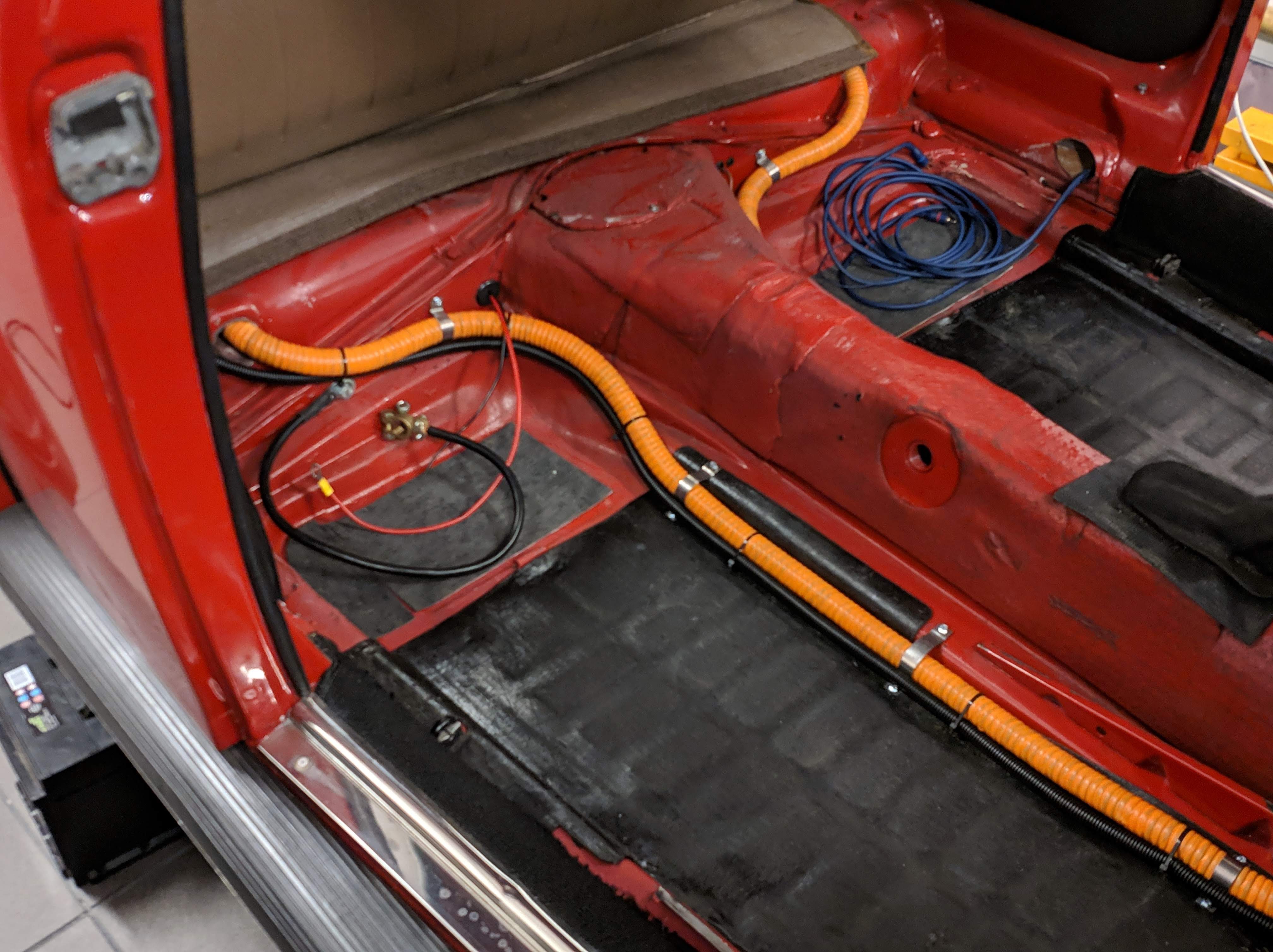

I pulled all my HV cables through a extra thick isolation pipe made of aluminum and rubber which I made orange with some orange isolation tape. See attached for how it looked before I hide them away under the carpets.

Some more wiring-porn for those of you that like that.
