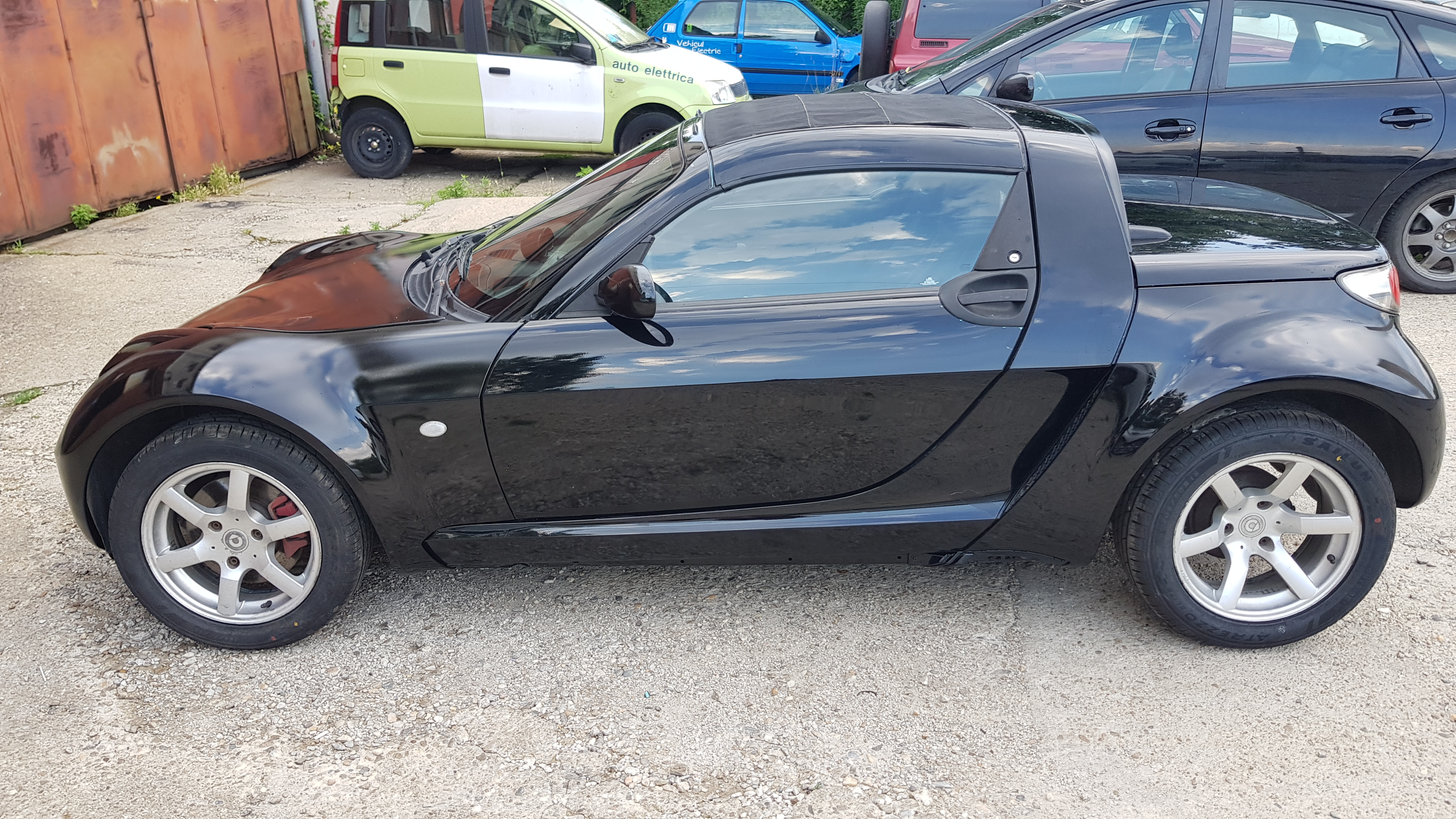

After much anticipation and testing on the junk leaf, i finally started my convertion.
The car : Smart roadster cabrio
Leaf gen 2 motor and inverter with johannes Leaf Board
Batterie from Mitsubishi outlander PHEV
BMS from Tom91 (Simp BMS)
Chager i haven't diceded yet, but probably a TC 6.6 KW or 3.3KW depending on the finances.
This week-end was very productive, i took the leaf drivetrain apart and isolated the motor/inverter stack.
Removed the rear craddle from the smart and put the leaf motor/inverter inside.
The rear craddle from the smart is very very convinient, 4 bolts, 3 cooling tubes, a few wires (Main ECU connector, ABS sensors and main 12V from the batery) and the brake lines.
I haven't figured out how to pu images on the forum, so the pictures are here https://drive.google.com/drive/folders/ ... sp=sharing.

Re: Leaf Powered Smart Roadster
Yes,the car drove 300km with johannes Board, i'm in the process of switching to Damian VCU, it's proven to be challenging.
So, i've been far from the car for almost 8 weeks now, i got it to drive very nicely with johannes board ( new and improved sofware) got up to 120kph
the leaf motor is a perfect fit for the smart, the motor has about the same ground clearence as factory and on the top i have 10-15mm to spare.
The range should be arround 60-70km ( with 8kwh with 8/10 modules from the outlander pack) i'm limited by the weight of the whole car (870kg without driver and passenger.
The performance is super super nice, compared with the old 3 cylinder 700cc turbo charged. The torque response is insane, (0-100kph under 8 seconds) and it's tuned down to be about the same power as original ( to be road legal) so about 60 kw but with the torque of a big diesel car, it's super nice to drive.
