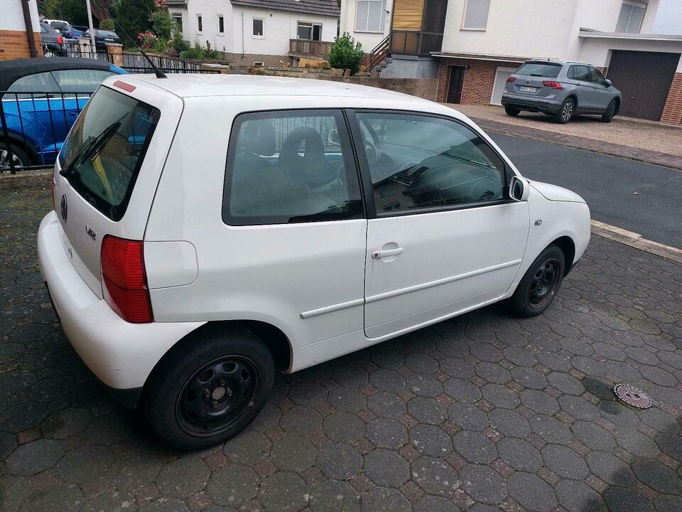

So, this thread is more of a question than an announcement :)
2 years after finishing the Touran I feel like getting my hands dirty again. No, I do not need another car, the whole endeavour is entirely pointless but I still want to do it.
We are looking into a budget simplicity conversion. I want to use the Prius transaxle with MG2 only and use the other inverter for charging. I want to go VCU-less despite the car having a CAN bus. I assume it's the same one as in Touran. The car has no climate control and no power steering, so more simplicity there.
I will try to fit the 24 kWh left over Leaf pack although I'm afraid that it is too large. Not sure if I'll stick with the centralized Leaf BMS because the battery will probably be all over the place.
Charging will be Type-2 only, I hope the Prius converter will sport 22 kW.
So, the only question: should I take it on or am I wasting my time? :P
