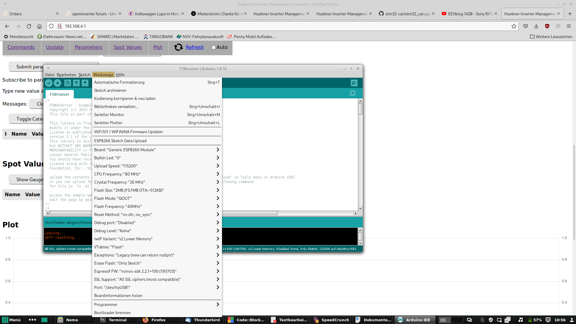

I got mine to work. It seems I got a batch with mostly the old flash (GH1634 25Q16CS10) but one module with the new flash (cFeon QH168104-HIP). I got it to work with the attached settings.

Thanks Johannes. Sadly none of mine will provide an ip address upon connection. Did you make any other changes?

No, just that. What does it say on your flash chips?
