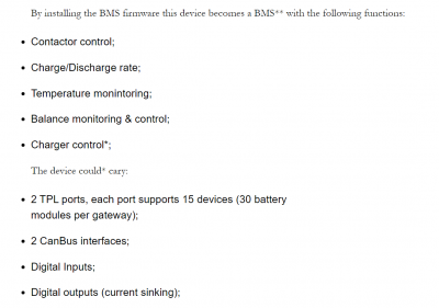

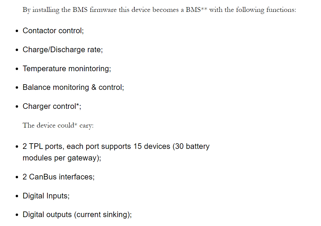

The idea is that over the CAN Bus we can interface easyly to the module and read/write the inputs / data like if they where in the VCU.
So basicly an IO extension device.
In my case i wanted to mount one in the rear of the car to facilitate for example the DC/DC converter which isn't CAN based (Chevrolet Volt) it needs PWM.
But the use cases can be extended to command and control pumps or whatever you need.
The idea is that its a simple IO device which we control from the VCU over CAN.
News:
- Support will be coded for SIMP BMS. So the module will act like a Slave to the Master module. If enough interest...
- Support will also be coded to enable relais and precharge and such stay tuned.

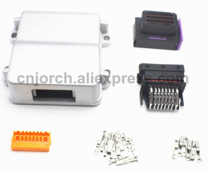

Re: Remote IO / Taycan CMC Master for Zombie VCU
Progress.
In order to interact with the build in Cell Module Controller we need a special interface from NXP.
So i made a CANBUS gateway to get the data of the Modules onto the Canbus.
The housing :
In order to give the device a double role and even more purpose i added some IO's.
The idea is that in the VCU we can read/write those io's. (RIO = Remote Inputs / Outputs).
The housing :

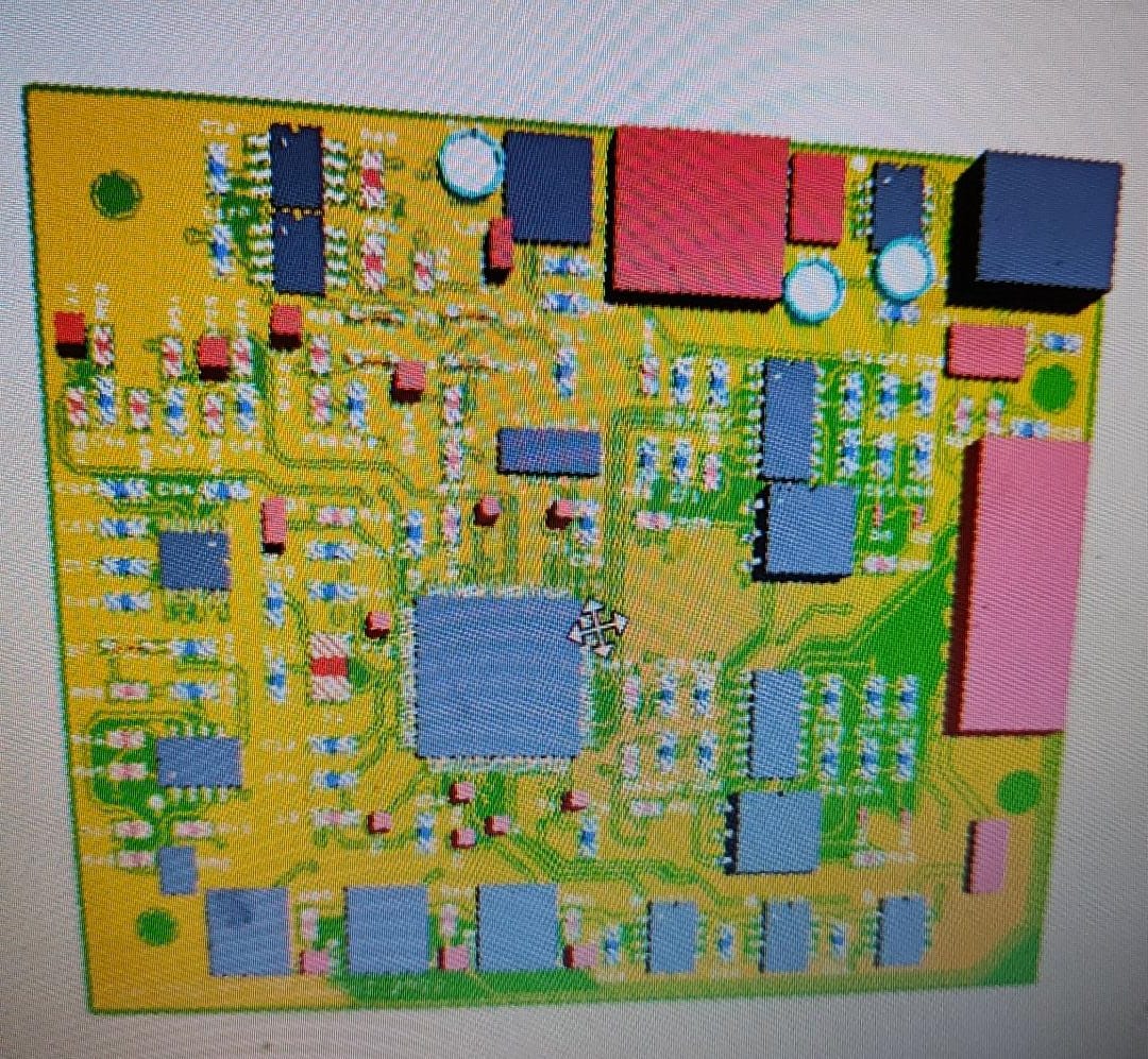

Ok boards are ordered at JCL. Hopefully they are "right" i took the GD CPU but i'm not sure if we should care about that.
I do need to find these components to complete the board but the most important one i already have

Ok so i have progress and i have good news and bad news. Lets start with the bad news.
The badnews, in my first ever PCB run i made some NOOB mistakes.
Like ground symbols not connected to GND net and some more.
(like i didn't know that you cant remap one pin, always the complete device function is remapped).
Yes i should have know but hey i was in a hurry to have Chips available at JCLPCB...

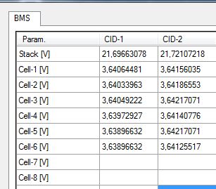

Now the good news after some pretty long debug sessions i made it work! I have a working taycan battery block slave controller!
Updates will follow as i progress to show something for that i'm working on a GUI app too.

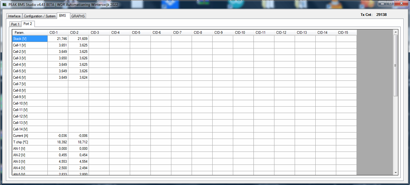

It works!

Very good progress. Did you write the software from scratch or are you running the example from NXP?
- EV_Builder
- Posts: 1205
- Location: The Netherlands
- Been thanked: 37 times
I'm running my software on my own board with an STM32F107 CPU and new C# GUI using the CanBus as interface. Next step is validating it on a GD32 device. Hard part is the crucial layer: spi chip --> driver.
If someone feels the need to influence how I should proceed shout your ideas I'm all ears. There is quite some data to transmit per block so we need something smart. I'm thinking a request of the master can change the PDO's of the slave? Or we should implement functions into the chip itself.

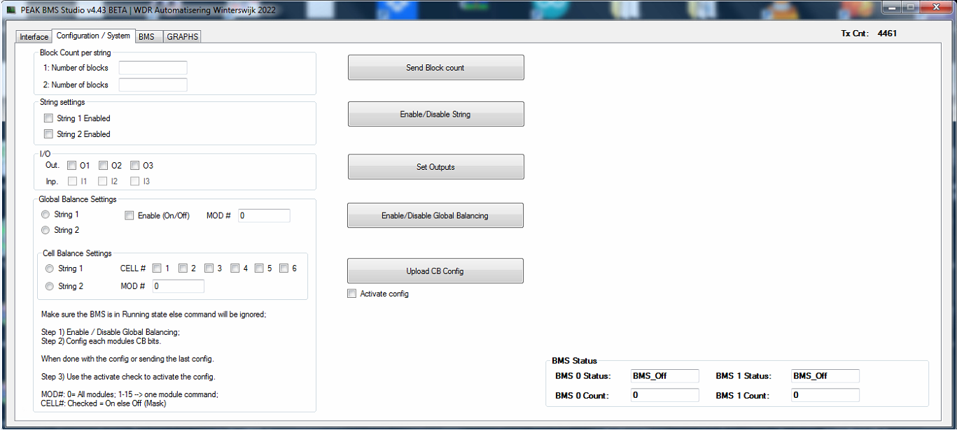

Progress V2.0 Validation:
CANBus 1: OK
CANBus 2:
String 1: OK
String 2: OK
GP Input 1:
GP Input 2:
GP Input 3:
GP Input 4 : NOK, needs small fix.

Ok lots of progress:
- Balancing command implemented en tested;
- GUI tool updated with all commands;
- BUSMUST CanBus USB support;
- 2High current outputs and 2Normal ones (4 outputs);

Your link points to a USB CanBus dongle which is supported by the GUI software and bootloader app.
What you need to talk to the battery is: CMC MC33664 Gateway (https://wdrautomatisering.nl/product/cm ... 4_gateway/).
The answer on your questions can be found in my github (see webshop).

That dongle is a generic dongle, but i implemented its API in the GUI tools. Currently i support 2 dongles: a profi one (PEAK) and a economic solution (your dongle).
Its use is thus for me in the GUI tools to connect to the TayCan battery CMC Gateway;
With the GUI tools you can check your pack and listen allong on the canbus.
