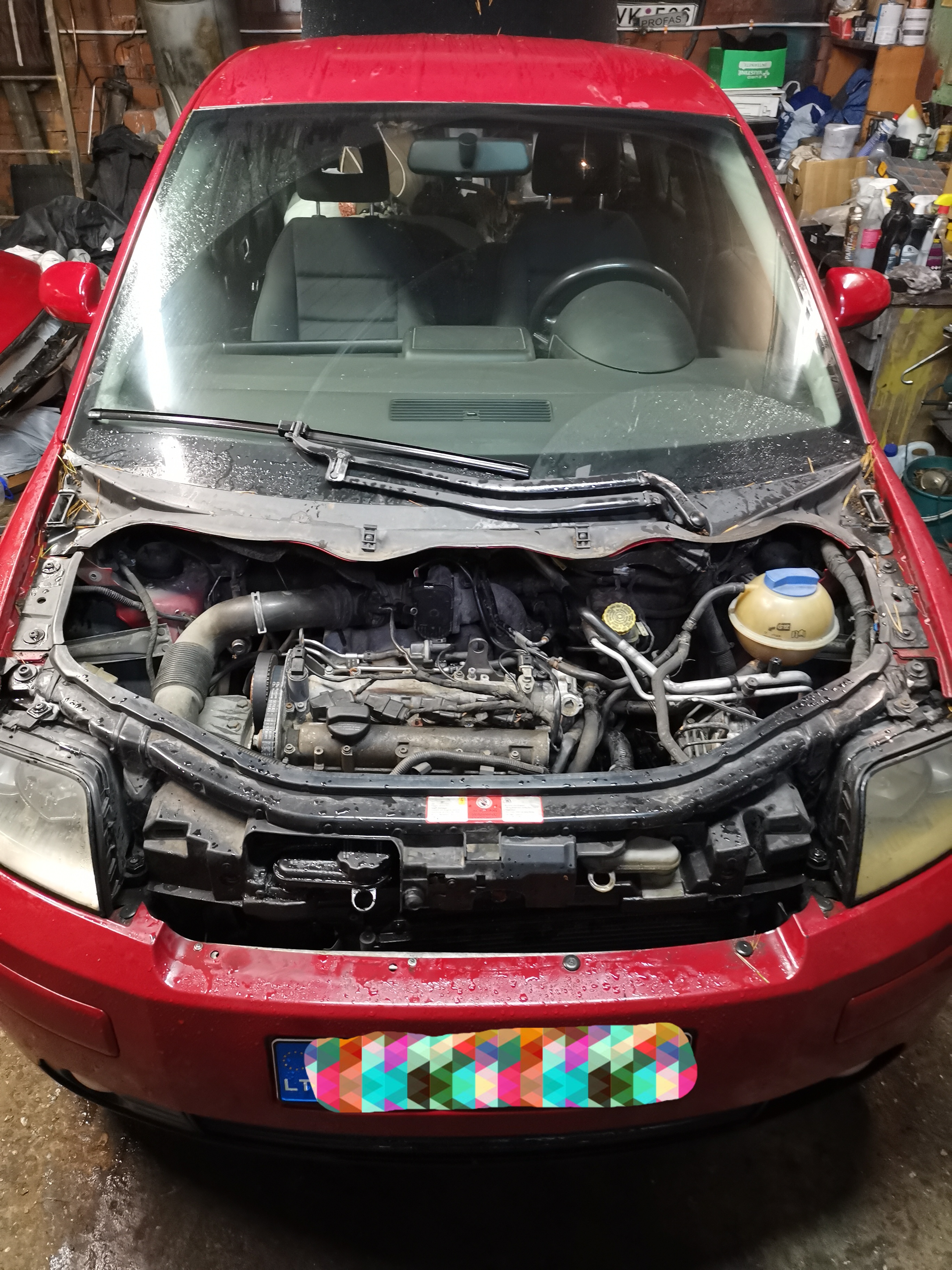

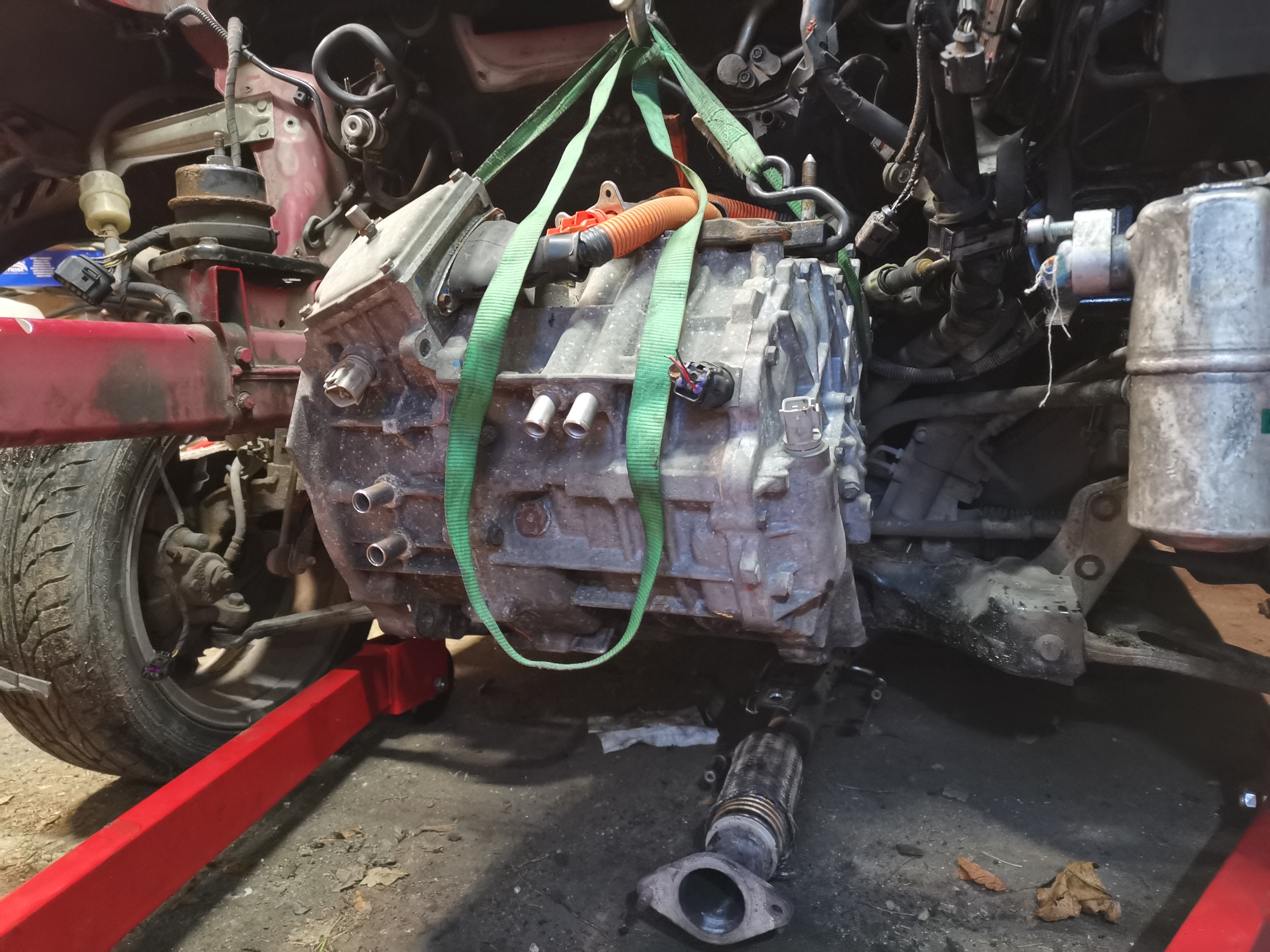

Hi. Starting the trial and error marathon :)
Audi A2 1.6fsi as a recipient. 550Eur.
OpenInverter VCU 180Eur.
Prius gen2 gearbox 100Eur.
Prius gen2 inverter 65Eur.
Chev Volt Gen2 80 cells 900Eur.
Prius shafts 50Eur.
Oil for gearbox 15Eur.
Total 1860Eur.
Gearbox was tested on the bench.
Batteries, will be sourced later. Anything from scrap.
Goal to test myself and do it very cheap.

I read you wrote "Prius transmission would be beneficial for registering, because no EMC testing is required. But I think it is too tall to fit,"
I measured it and I didn't find any issues to fit it. I plan to center Prius transmission, weld Prius driveshafts to A2 driveshafts.

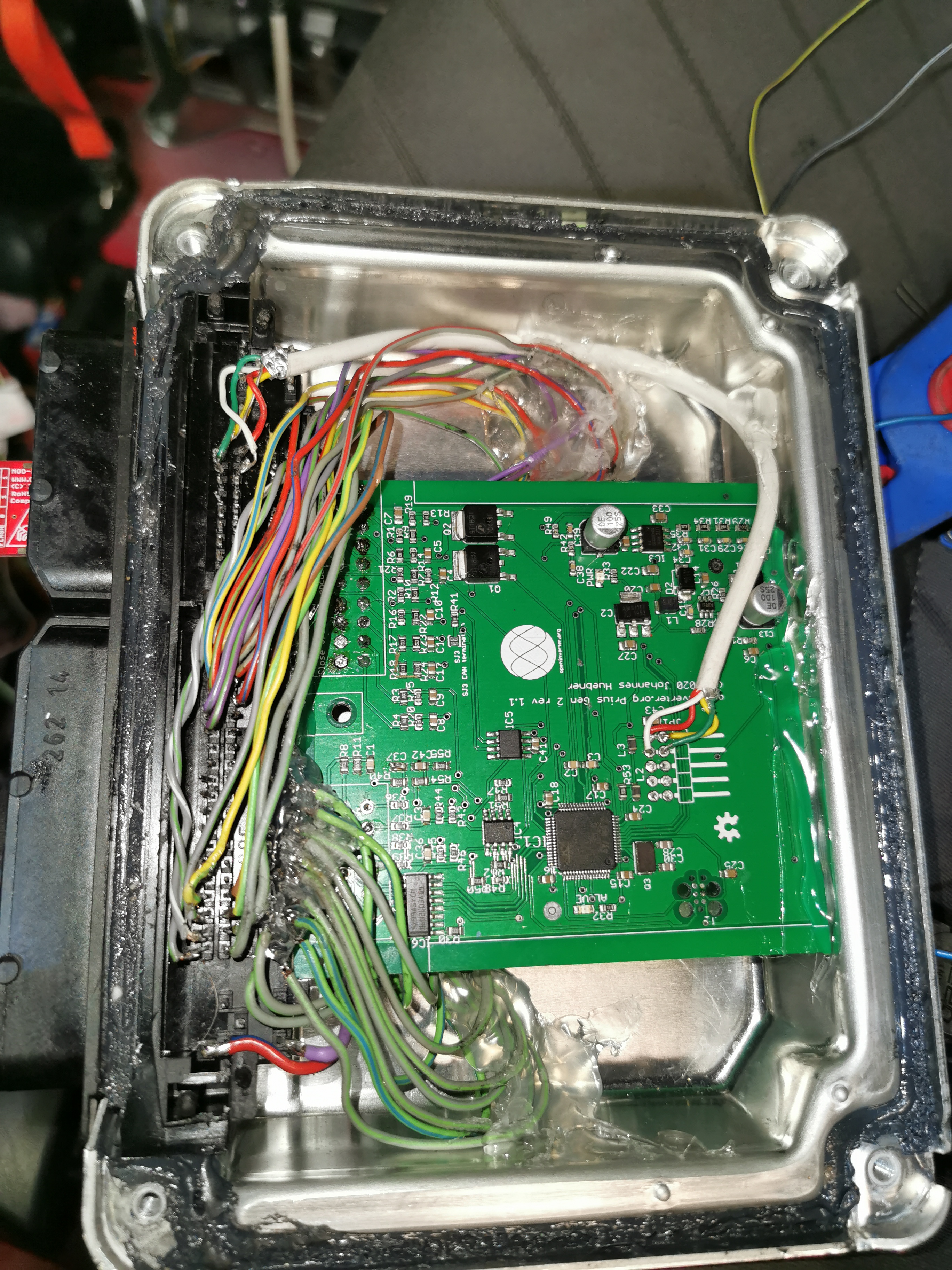

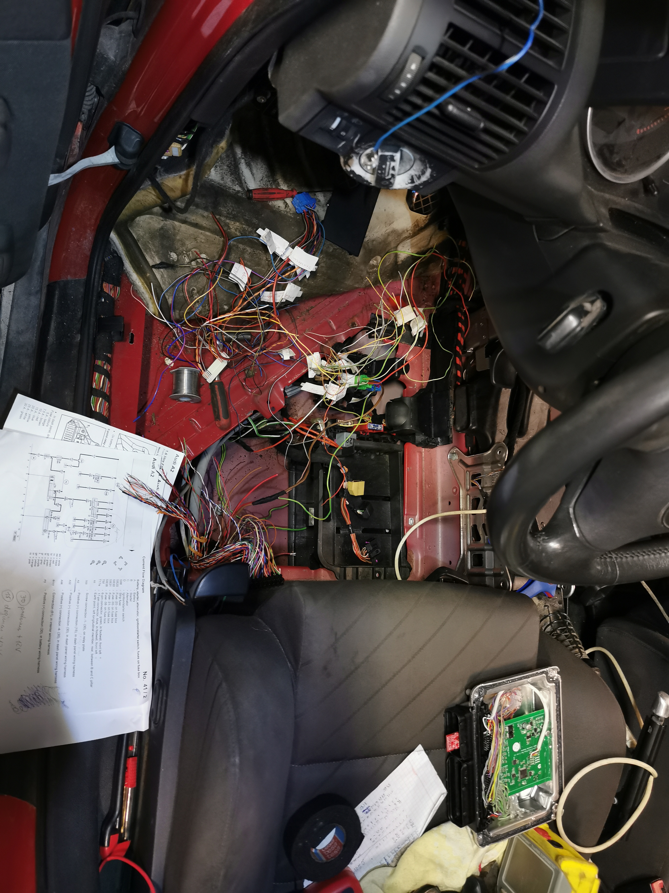

After long time made small steps forward.
Decided to put VCU into original ECU housing and use audi ecu connectors.
Car moves. Now need to fine tune SyncOffset and put Volt Gen2 battery pack.

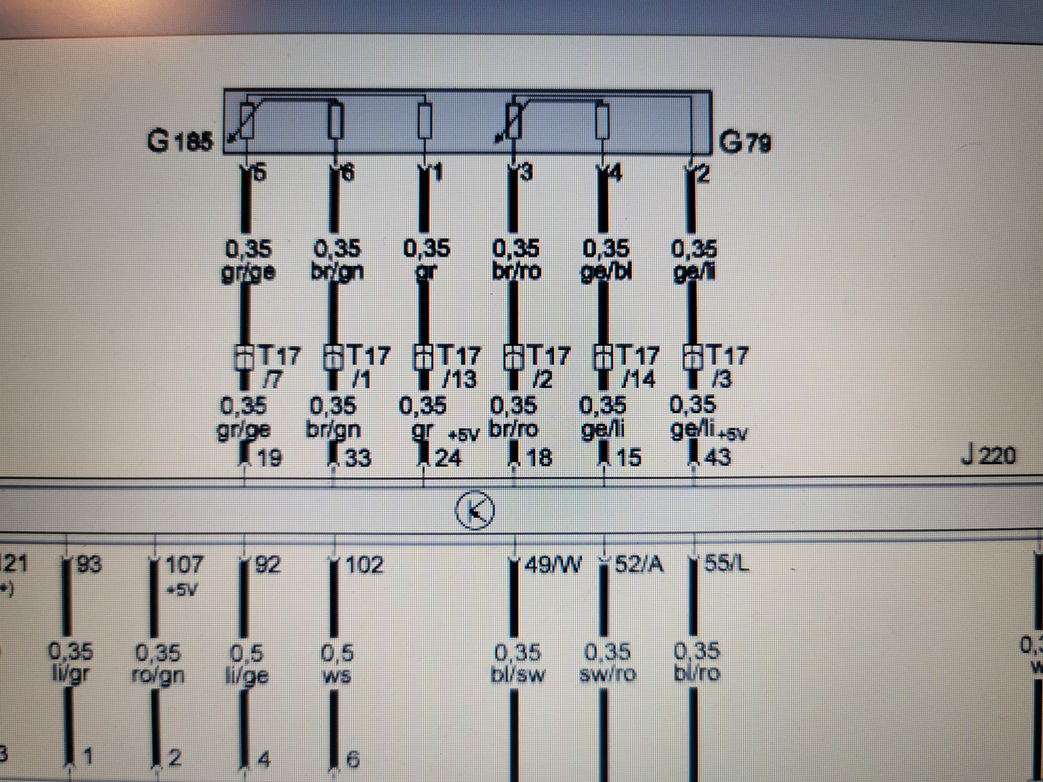

Audi throttle pinout:
First sensor 1 (24 on ecu) is +5V, 5 (19 on ecu) is Gnd, 6 (33 on ecu) is signal;
Second sensor 2 (43) is +5V, 3 (18 on ecu) is Gnd, 4 (15 on ecu) is signal;

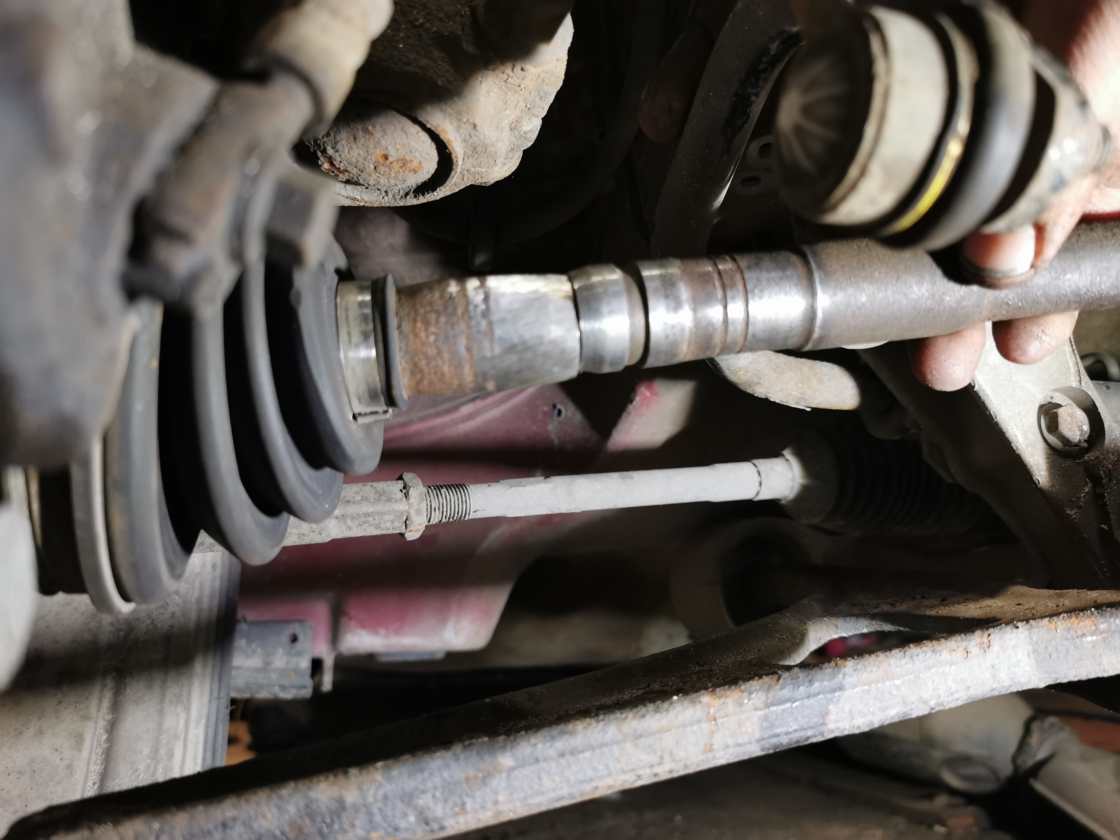

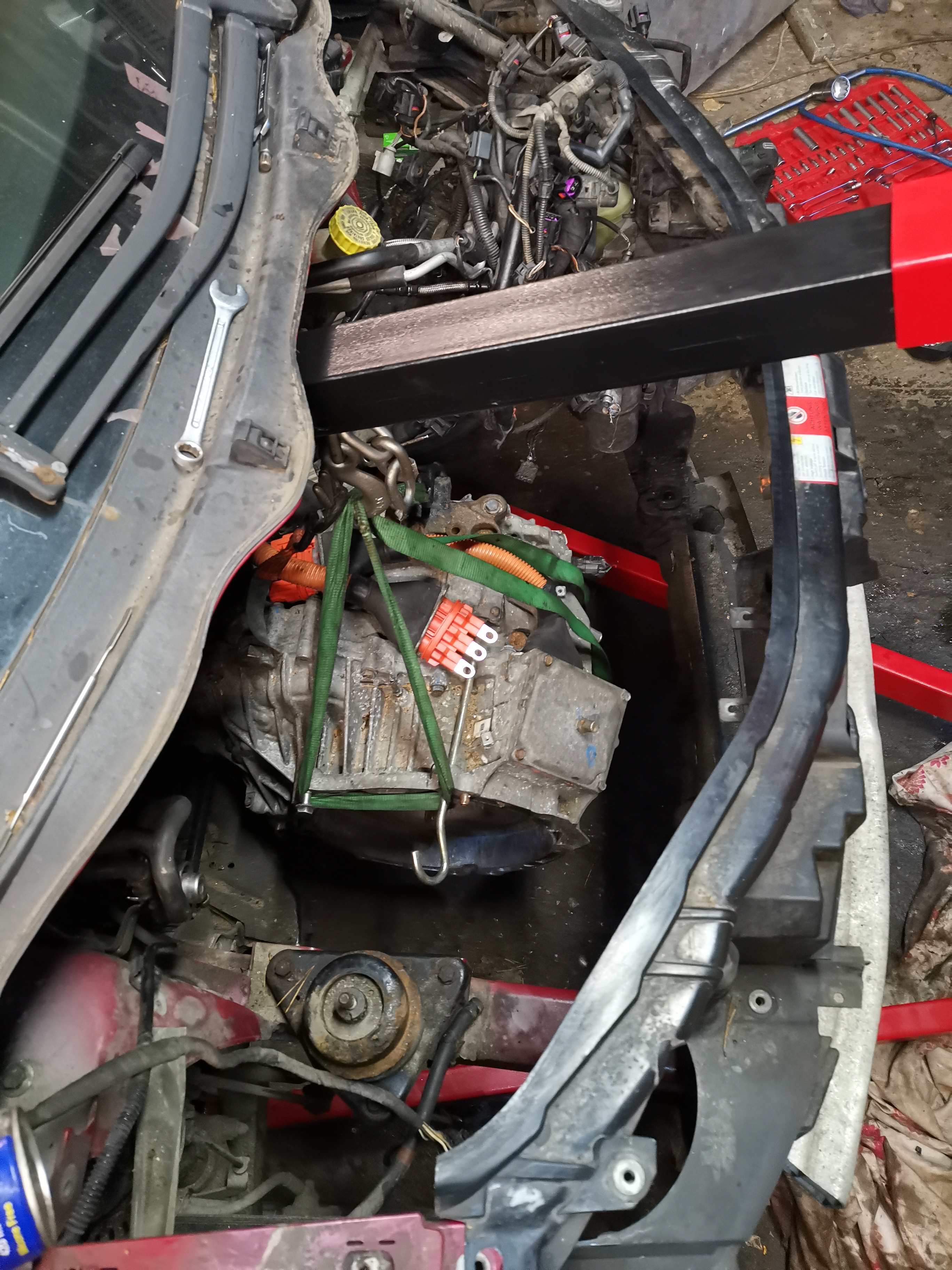

Shaft were made from Audi external and Prius internal shafts. Welded together with additional pipe pressed on them together.

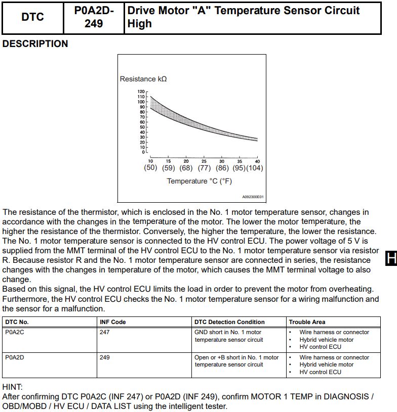

Some info to remember

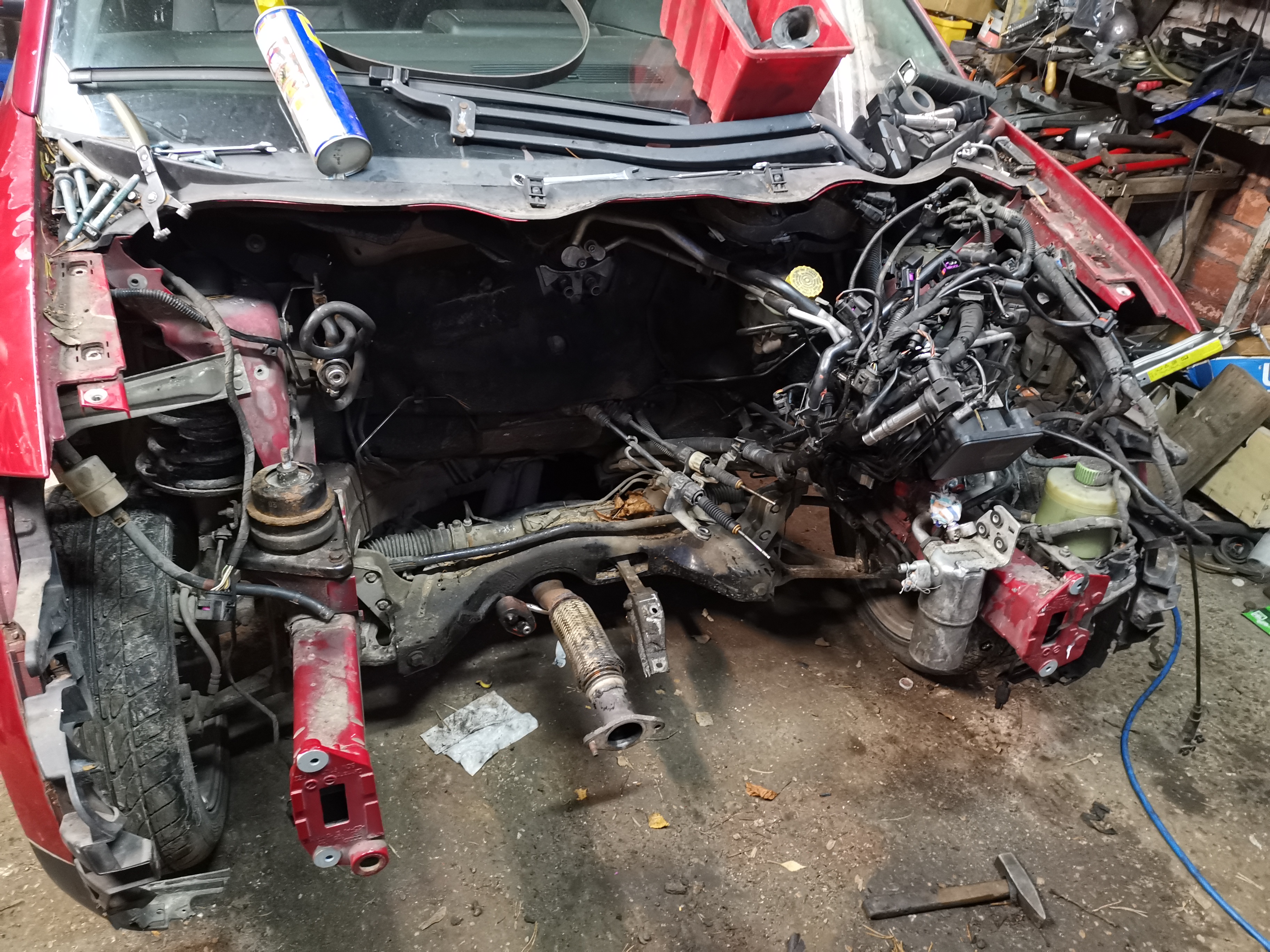

some test on the snow. Summer tires with no traction.
Also could make burnouts on the concrete.
Removed fuel tank, exhaust, fuel lines. In general nothing is left from the petrol system.
