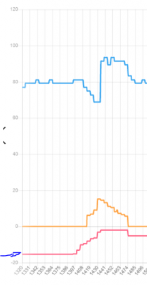

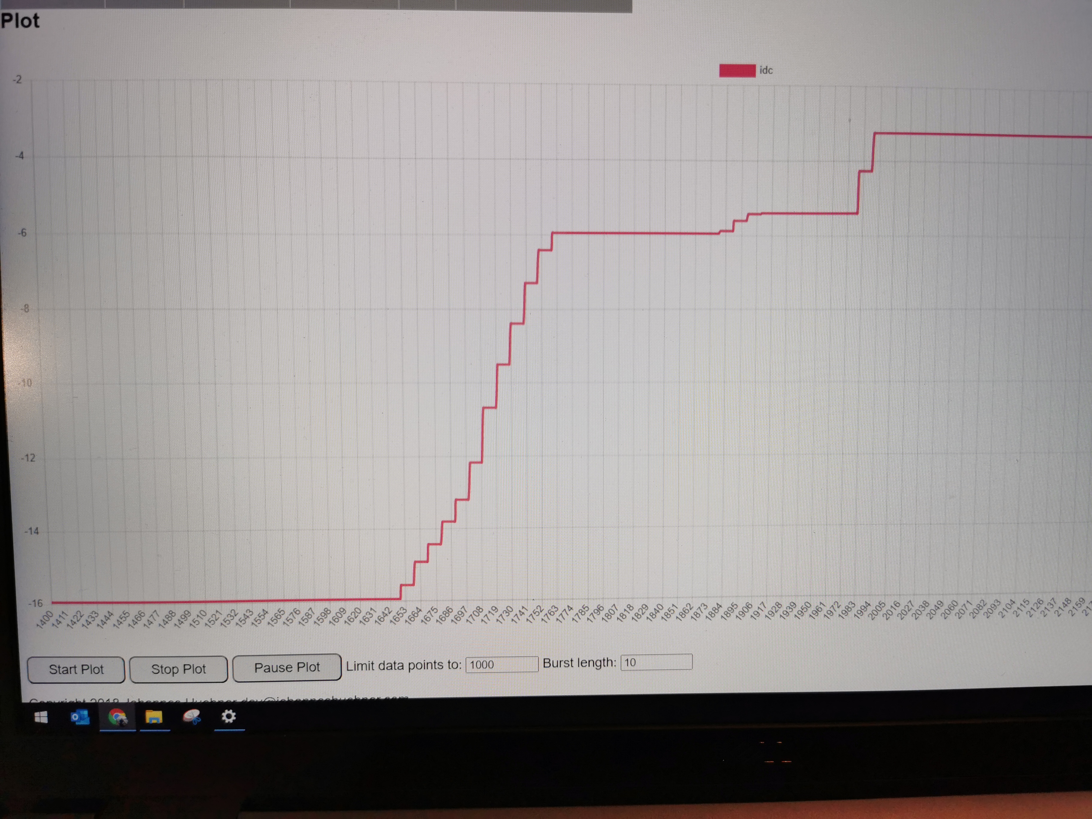

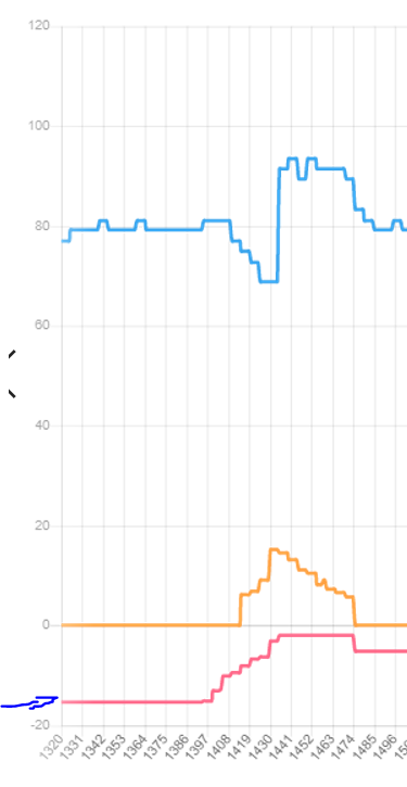

Get wrong Idc in 5.14, but all good in 4.96
At no spin is like -18, rises slowly to 0 when spinning. Older FW Idc was measured OK.

Posts: 6761
Has thanked: 383 times
Been thanked: 1581 times
Re: Inverter Firmware v5.14.R
I will have to test this but currently I'm out of office. Will check later this week.
The various lines are just pre-calculations, the final value is set in the Param::SetFixed() call
EDIT
what I can say for now is that since 4.96 the calculation was changed in two ways:
1. the d-current and voltage is also taken into account, before it was just q-current
2. The result is filtered to smooth out the DC current limiter
geduxaz
Posts: 141
Joined: Wed Jun 23, 2021 7:00 am
Location: Lithuania
Has thanked: 13 times
Post by geduxaz »
Sometimes IDC shows ok. Sometimes too low.
