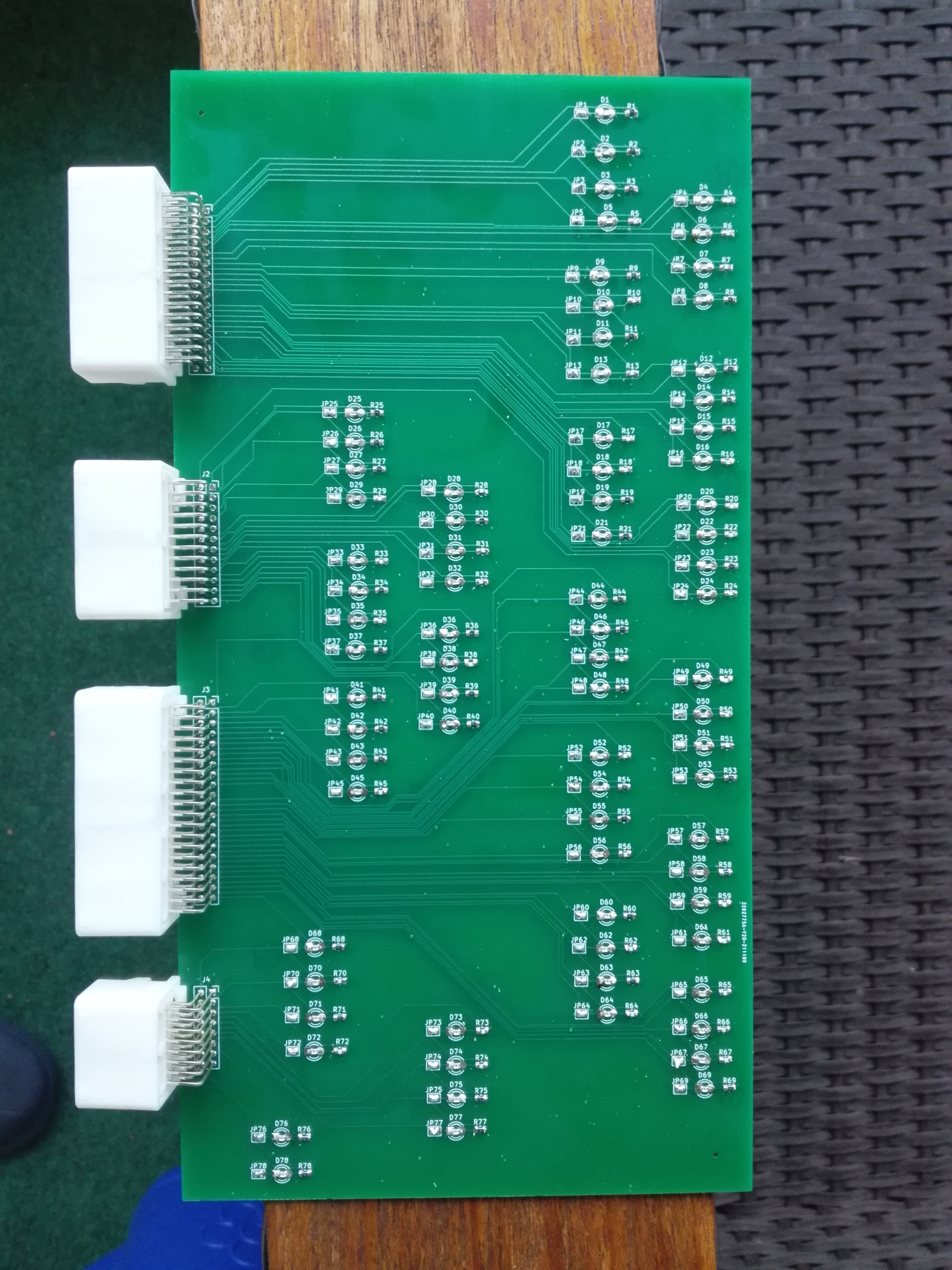

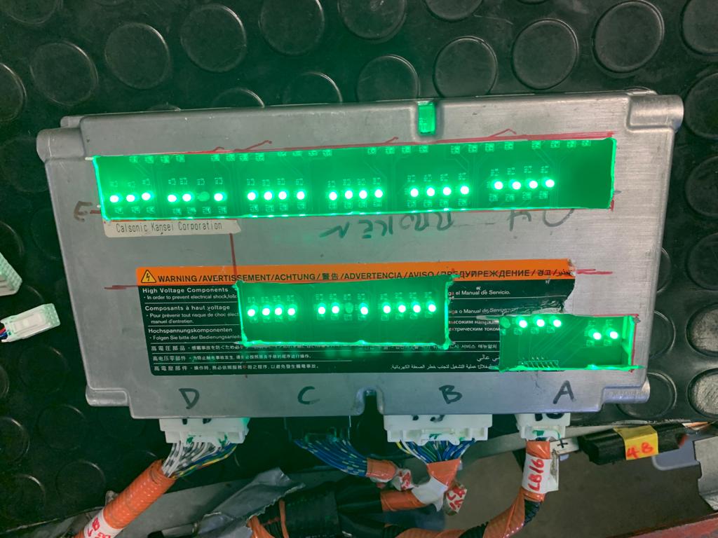

I made a simple LED array to test BMS Spaghetti wiring:
- if your connections are correct: all LEDs are on
- if you skipped a cell: you burn an LED out
- if you reversed a connection: the LED is dark
I made them in loops of 4, so you don't have a continuous connection of 380V, but sections of ~15V.
LEDs are THT, so easy to resolder if popped.

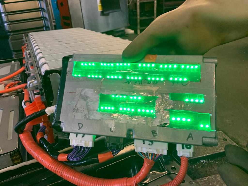

You can see in the photo below some LEDs are dark where I removed the bus bars while working on the pack.
Thoughts?

Very nice! Is that on a prototype board or an actual PCB design? I would have a use case for this.

I have some PCBs.
I can send you one of the boards to self-populate if you want.

Great idea and implementation!
Is this for GEN1 Leaf BMS or GEN2?

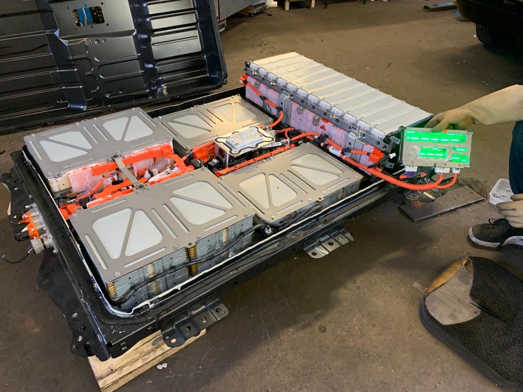

Yes, all the same like johu said, as a matter of fact the photos above are from a 24kWh pack ... and the ones below are from an otherwise untouched 40kWh one.
You can see one LED is off, thats where I made a wiring mistake on the board and connected both sides to the same cell. Everything else works perfect, on a full pack everything comes on.
I am just sending two boards to a school in Illinois today, if anyone want the last one, send me a PM.

Hello,
if you want to self print, the gerber files are attached below.
- D40 will not come on, that is a wiring error I made
- D51 is too close to the aluminium case, you need to "correct" the case there to make sure it doesn't touch!
Post here & let me know what your experience is! I hope it helps.
bmsmatrix-v01.zip
(122.29 KiB) Downloaded 469 times

@Ruudi: you can upload that zip-file at jlcpcb or some other service

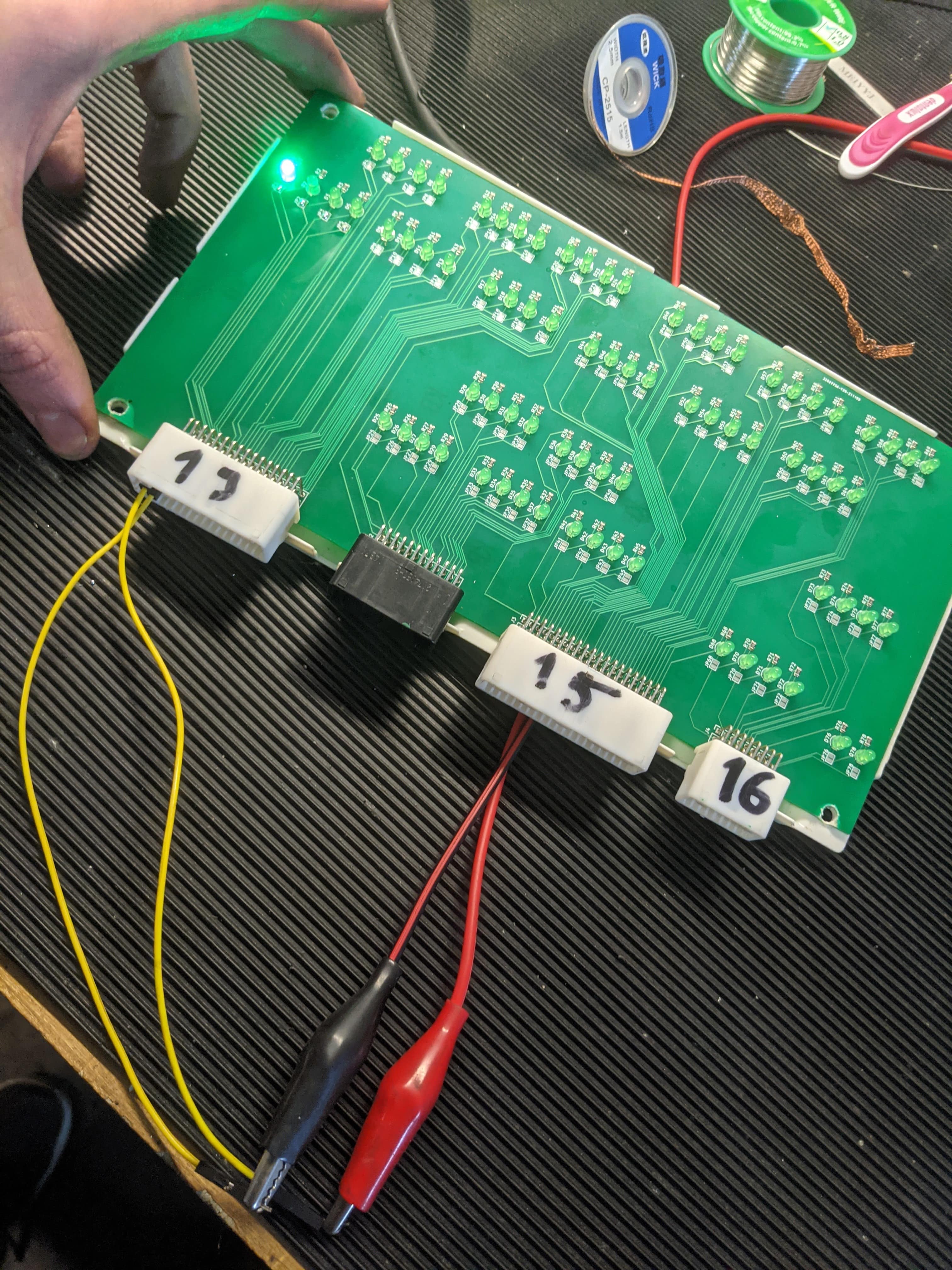

Populated my board now but that immediately brought up a question: how can you check 96 cell voltages with just 78 LEDs? Indeed some inputs do not light any LED

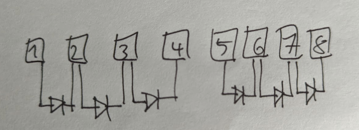

johu wrote: ↑Mon Dec 27, 2021 1:49 pm Populated my board now but that immediately brought up a question: how can you check 96 cell voltages with just 78 LEDs? Indeed some inputs do not light any LED
It is quite possible I made more mistakes, but see sketch below, there is some fenceposting going on with the loops of four. I am making sure I test every wire once, and not every individual cell. https://en.wikipedia.org/wiki/Off-by-on ... post_error
swapping individual wires
Simplified schematic with 8 cells, needs only 6 LEDs to check every sensing wire. You do not need to check between (4,5), because if you did swap the wires, the LED now connected to (3,5) should see 8V and pop.
swapping groups of wires
If you swap a whole group around (1,2,3,4) with (5,6,7,8), it would look as if everything was OK, while it is in fact not, but I assumed that was quite unlikely. The swap would have to land exactly on the boundary of loops on the board to be unnoticeable.
Simplified Sketch:

Alright, understood :) very clever. I'll actually be looking for "weak" wires, i.e. that measure normal on the multimeter but might collapse when loaded
Been thanked: 1918 times
Re: I made a Leaf BMS wiring test board out of a burnt BMS
All built and sort of tested. Now what was the issue with D40? It lights up but you said there is a wiring error

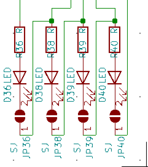

The last pin on LB14 is 48-
The first pin on LB15 is 49+
they are the same.
So if you connect it to a real battery pack, it will just remain dark because both sides of the diode are connected to the same cell. Not sure why Nissan decided to double them up at that one place.
There isn't a "fix" I think, just ignore it.
Looking neat, let me know how you progress. I like the SMD LEDs in the THT spaces.

janosch wrote: ↑Tue Dec 28, 2021 11:45 am The last pin on LB14 is 48-
they are the same.
Nissan did this because their maintenance switch is located between cells 48 and 49 in the middle of the pack, so they have split the BMS board similarly (you can see some optoisolators on the board for this). Otherwise when the maintenance switch was disconnected current would pass through the BMS - not favorable for longevity.
That makes perfect sense. I saw the division there before.

The board does not always show you a single loose wire. In the Simplified Sketch above, if you disconnect the wires to cell 2 and 3, you will still get all three LEDs light up there, because they are just in series. Brightness will be identical as well unfortunately.
Learnt that just now by testing a new pack, that had a loose wire, then plugged the test board in to verify and it still lit up all LEDs. So it is good for detecting swapped wires, not necessarily for individual missing wires.
